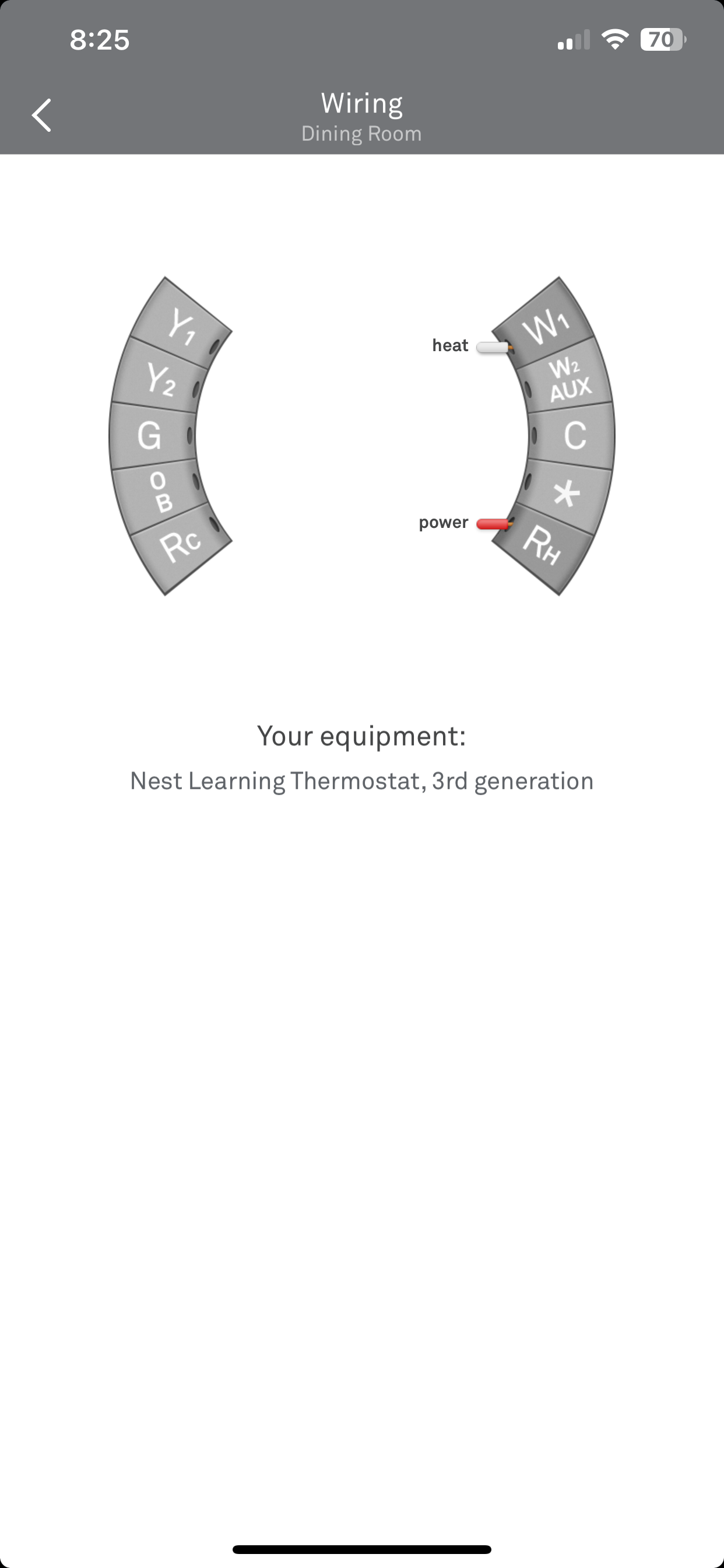

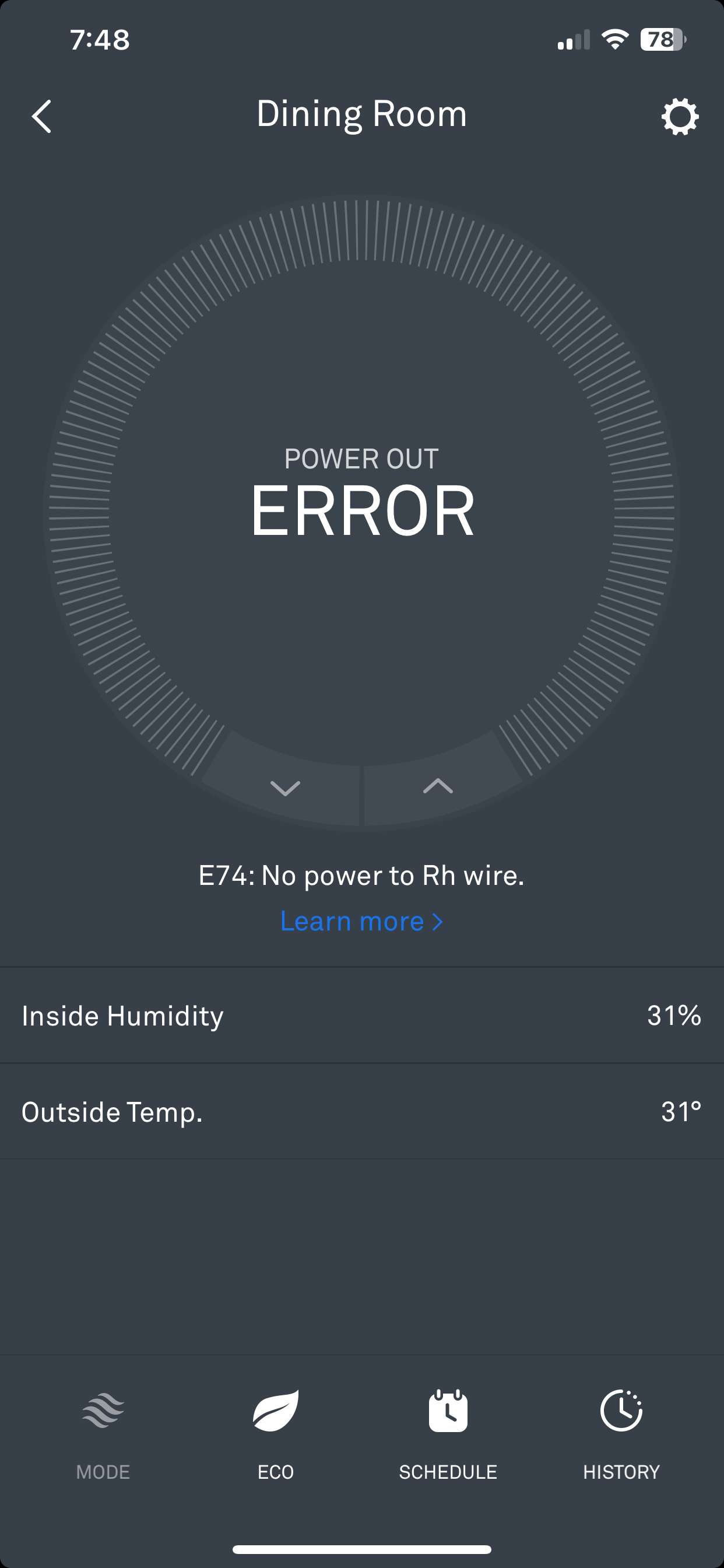

    Update: After trying to fiddle with a Beckett one (AFG), I went with Carlin 45000 universal. Put it on and connected back everything with ignition cable going to it’s own port on control box. Fired up and it turned on like nothing ever happened to it. One issue though, I don’t have access to my Nest app to see the temp or control the heat anymore. It says No power to RH wire. Trying to figure out what I did wrong. Any suggestion/tips would be helpful.

    Steamhead Posts: 19,007
    Try reversing the two thermostat wires.

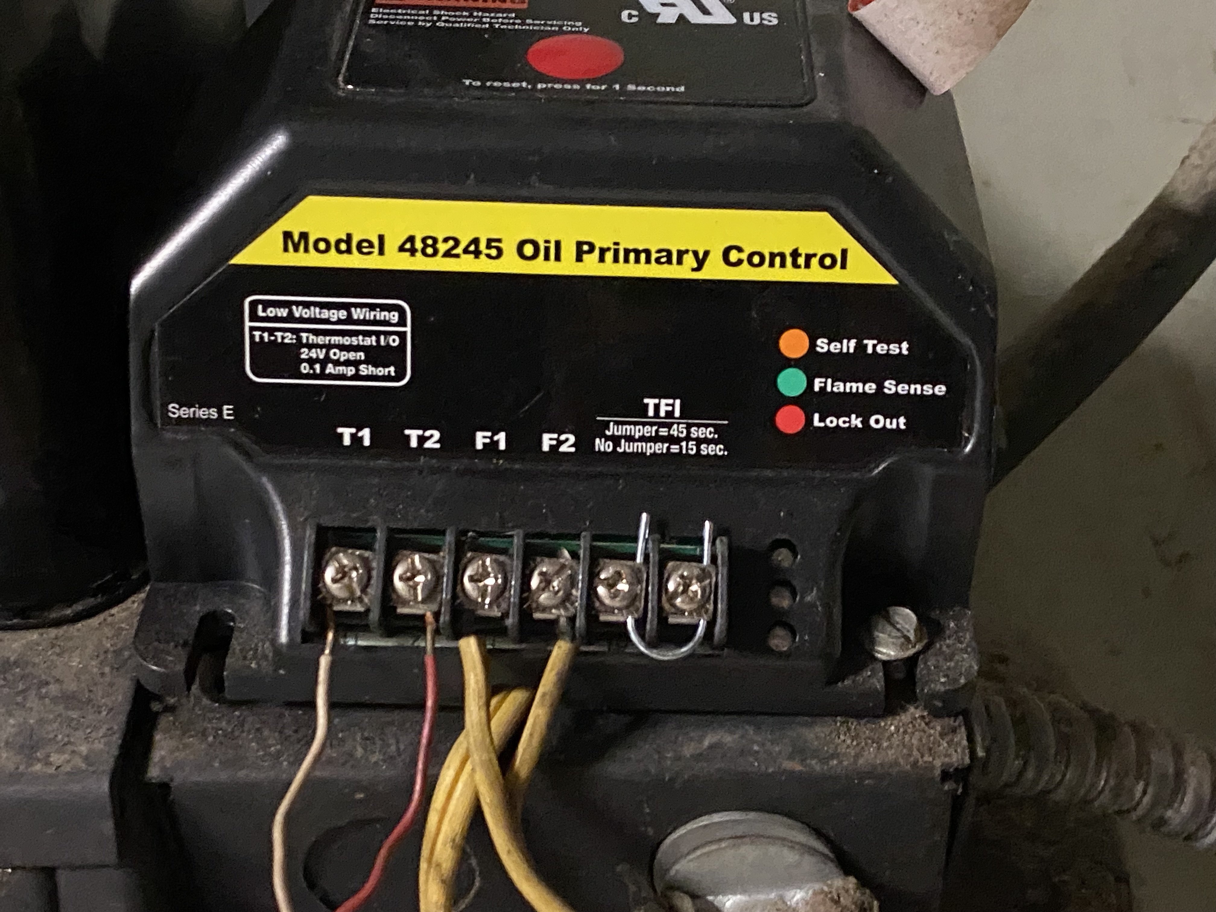

    Do the thermostat wires go directly to TT on the Carlin primary? Did you remove the wires from TT while wiring the Igniter? I wouldn’t use the transformer in an oil primary to power a smart thermostat unless it was rated for it.
  • Yes, they go directly. I didn’t remove the wires while putting on the transformer as I didn’t think it would cause any issue. I didn’t change anything else other than just putting the igniter cable on the dedicated igniter port on the control box. Burner is so far working fine locally with nest but no remote access. What’s your reason behind not to power a smart thermostat with transformer? If that’s not tje right away, how should I go about it? Thanks for the response.
    I doubt the transformer in an oil primary will power a nest. In fact, my nephew did this exact same thing. He hooked his tow wire nest to T & T on the oil primary.
    It worked for a year and the Nest went dead. The Nest has a large battery to charge. They are supposed to recharge with a two-wire system when the boiler is off. They seldom work.
    I installed a separate transformer and relay and that fixed it. Your talking $50 in parts. Supply House.com
