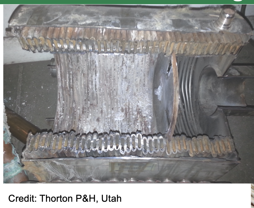

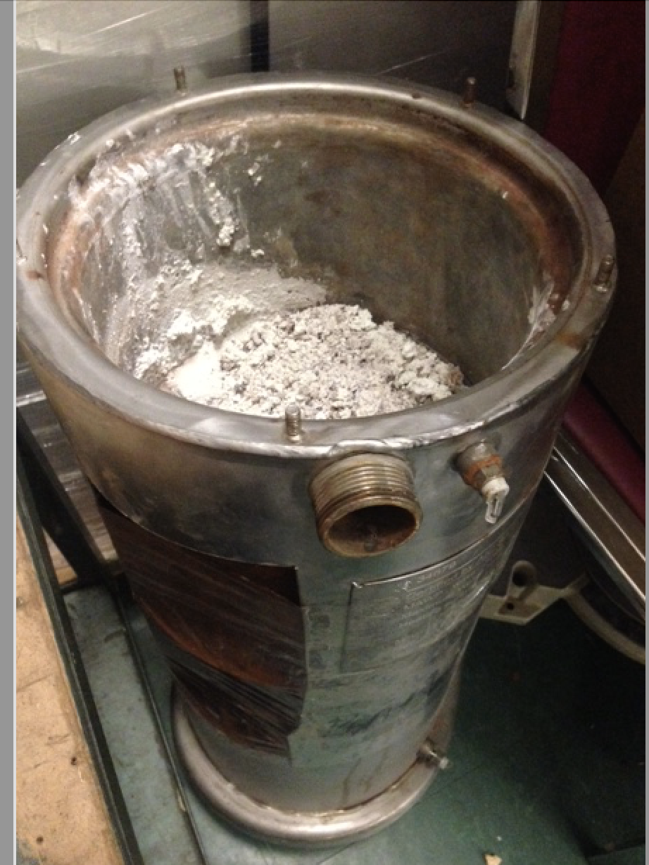

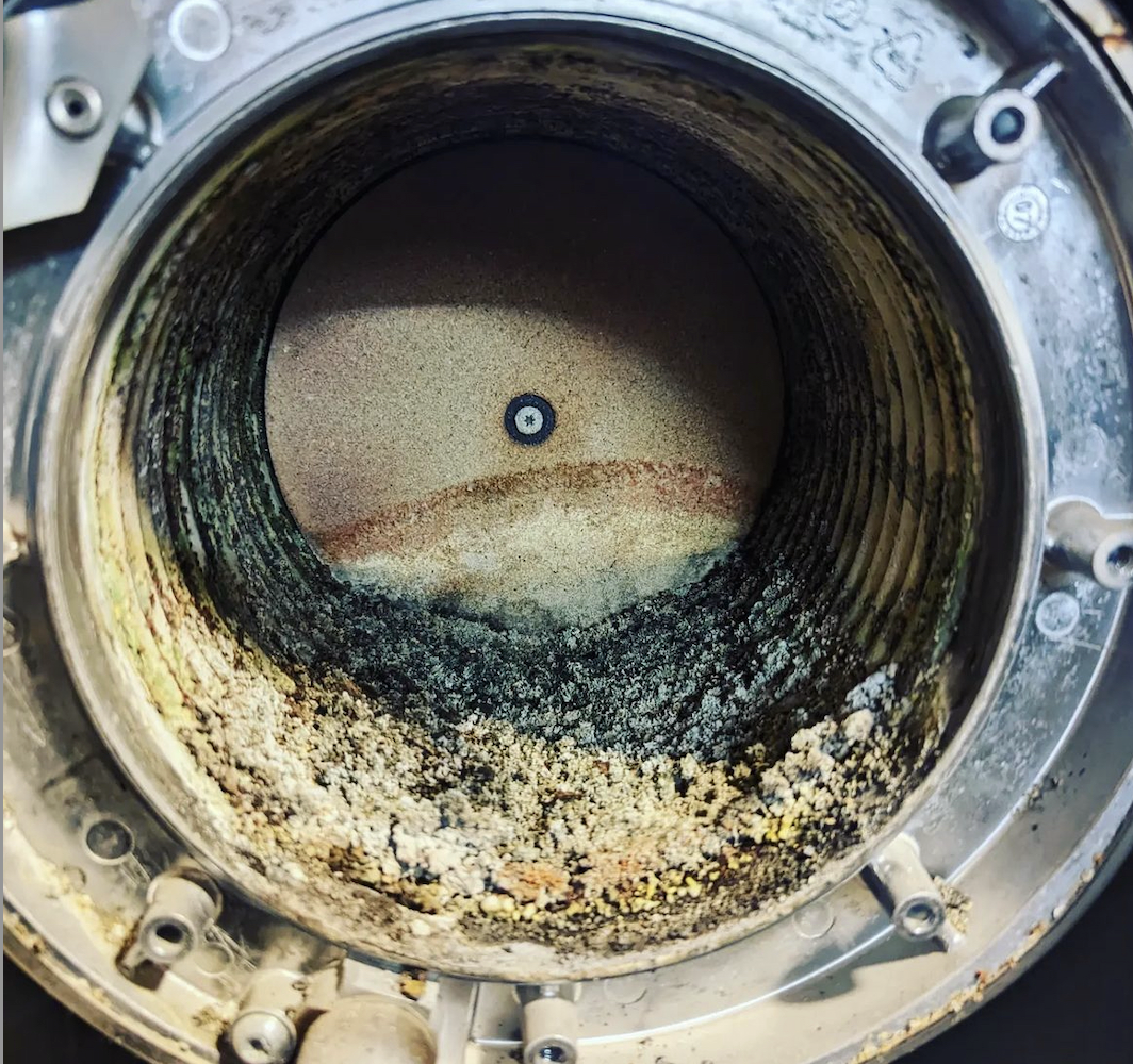

    Inside or out? Here is a pic of a scaled inside and a scaled outside.
    Screenshot 2025-12-07 at 9.34.42 AM.png Screenshot 2025-07-05 at 7.40.27 AM.png Screenshot 2025-12-07 at 9.31.25 AM.png
    Inside cleaning involves running a hydronic cleaner for a day or so at high temperature if possible.
    To clean the outside is more involved. Pull the burner use cleaners, brushes, @HomerJSmith feeler gauge trick if it is a water tube design.
    Axiom has cleaners and tools available.

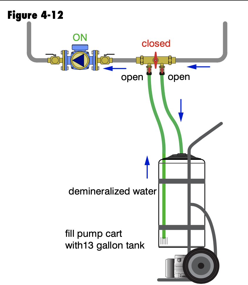

    hot_rod Posts: 28,708
    Yes, if you can circulate just through the boiler that is ideal, the cleaner will have more strength without the system fluid volume diluting it..After running just the boiler, let the cleaner go through the entire system to descale heat emitters.
    Actually those tankless water heater cleaner kits work great for boiler only cleaning. The pump included has enough umph for the boiler flow.
    A 5 gallon plastic bucket and the cheapest plastic sump pump Home Depot has is an option. If you drain and refill, I would get a DI cartridge fill the entire system with pure water, to prevent putting hard scale back into the system.

    clock the meter and look at the firing rate. i doubt the water side is scaled but if the fire side is plugged it will lower the airflow which will lower the firing rate.

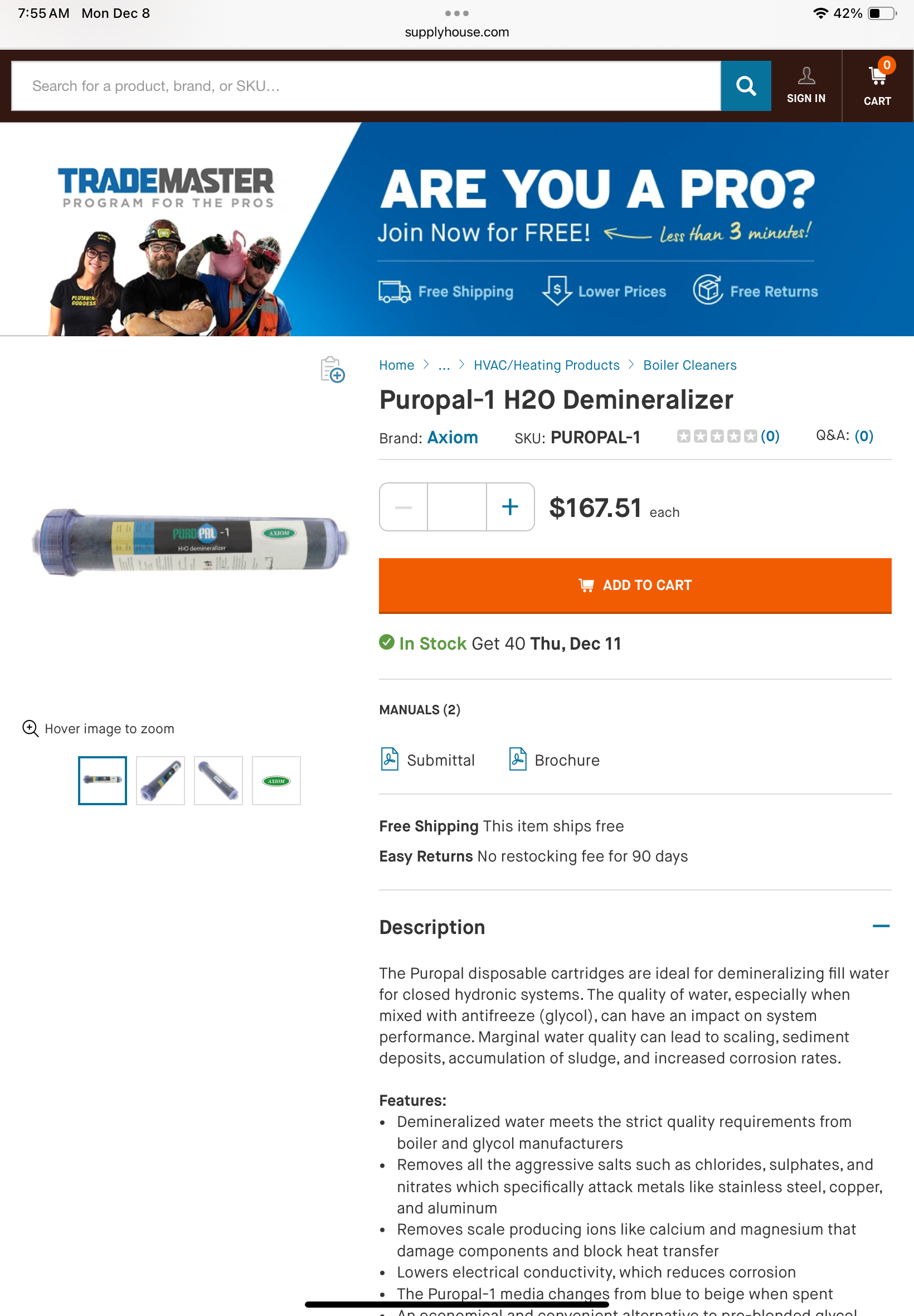

    it is good to know how hard your water is and the TDS, total dissolved solids.
    The boiler manufacturer typically tell you the acceptable numbers.

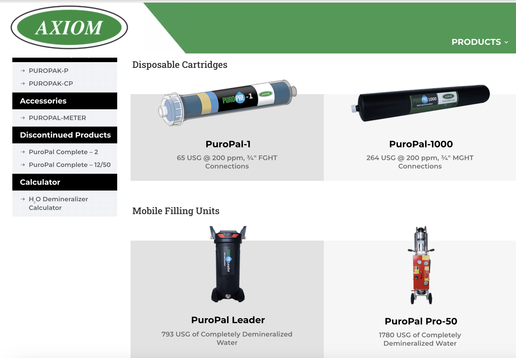

    I have seen these small cartridges for around 150 bucks. It shows 65 gallon capacity but it depends on how hard your water is to begin with. It has connections to adapt to hose thread
    Typical cartridge filters can handle dirt, smell, but will not remove hardness, that takes an ion exchange, or RO membrane
    you can also buy deionized water at water treatment companies. I had a 55 gallon plastic barrel that they would fill for me.
