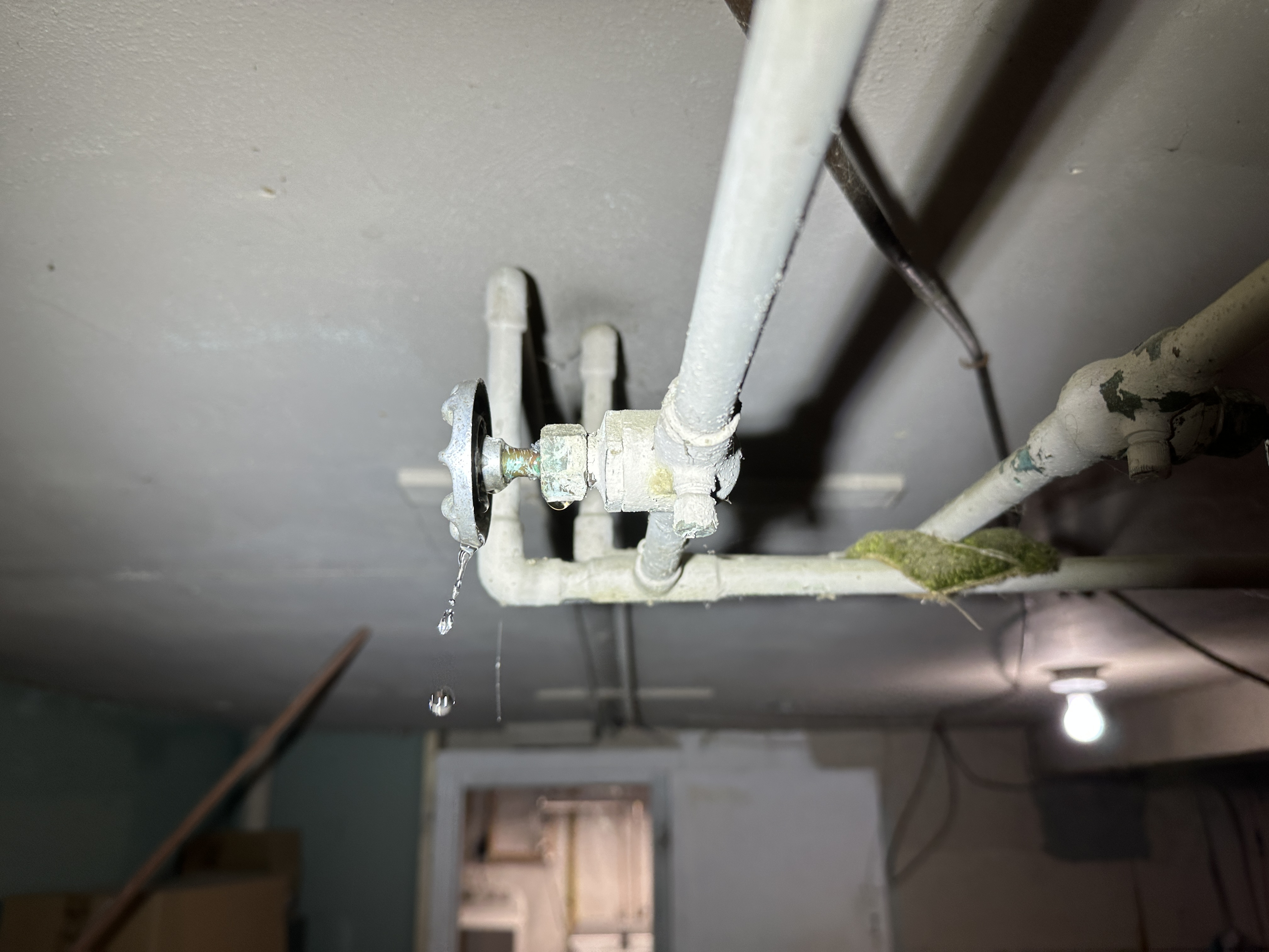

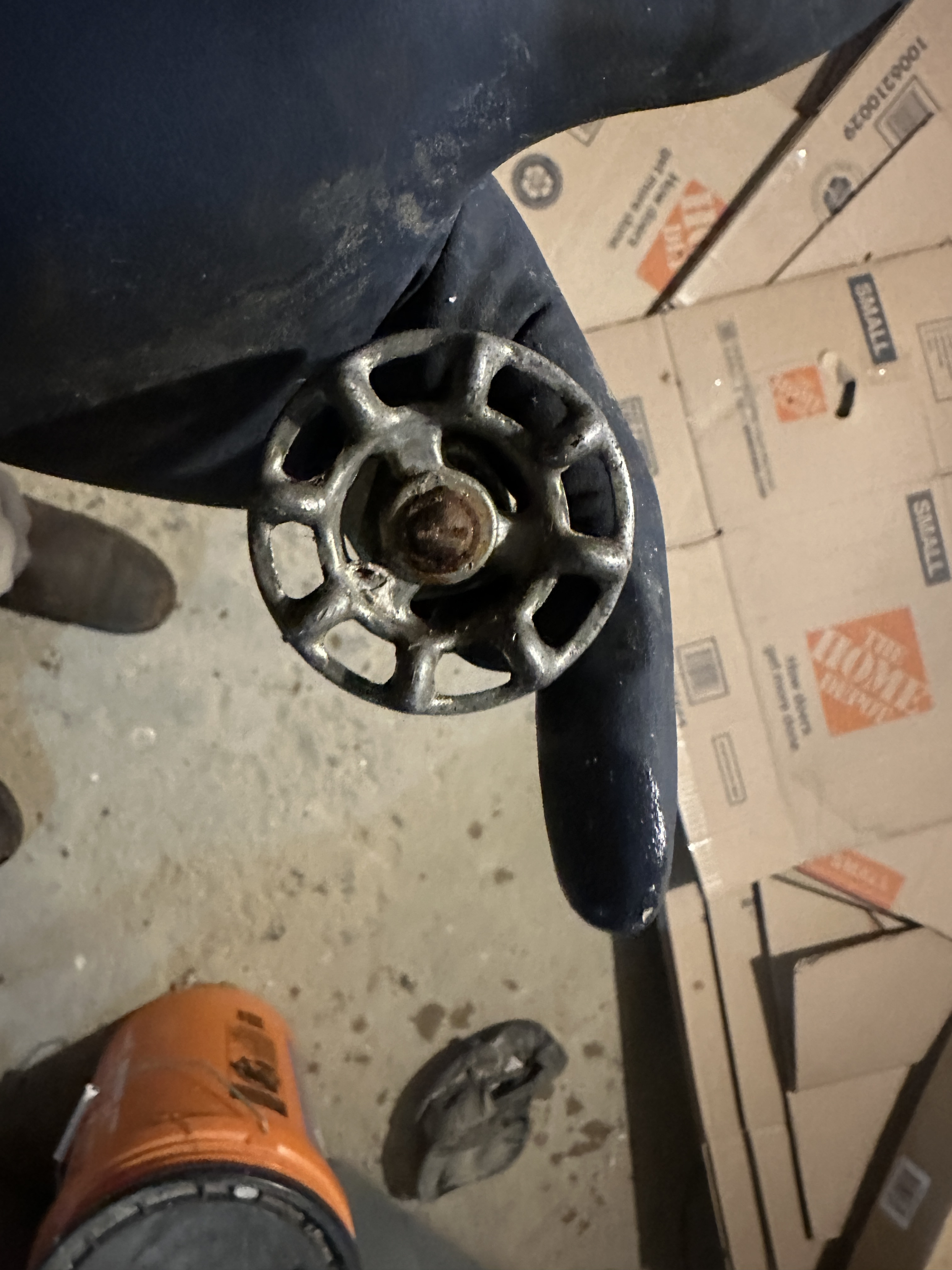

This valve located on a 1/2 copper pipe started leaking after I tried to close it to shut off the water supply to a pipe. Where can I purchase a replacement or get a rebuild kit for it?
    mattmia2 Posts: 18,433

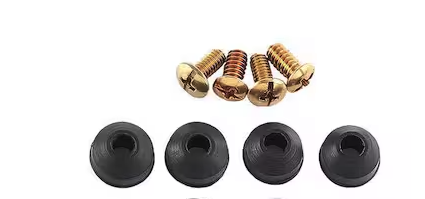

    just standard bib washer and string packing for the packing. can you get the screw out? clean out the slot, use a screwdriver the size of the whole slot that fits tightly, press really hard and turn more gently and carefully. probably would help if you clamp the stem in a vise, protecting it with some wood or a rag. use a stainless screw to replace the screw, can either get it in the plumbing section or with the hardware out of the bins.

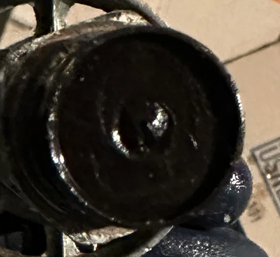

  • Are you referring to a screw on the end on this photo "img-3813" Not sure what is on the end of this? I could not really see anything. Assuming this is where the bib washer is located? I definitely need the string packing.
    109A_5 Posts: 4,783
    Can't tell from the picture but the rubber washer looks like it is missing. Sometimes there is a springy rivet type thing that holds the washer in place and not a screw, it just pulls out. Rubber washers come in many sizes, you may have to match it to the stem.
    Inspect the valve seat also, should not be any odd grooves or irregularities. There are tools to dress the seat if needed, often the seat can be replaced if you can get it out.

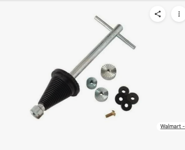

  • I am interested in what this tool is. Also when you say valve seat you are talking about the part that touches where that black rubber part touches? The part that I am unsure if there is a screw holding it on or not.

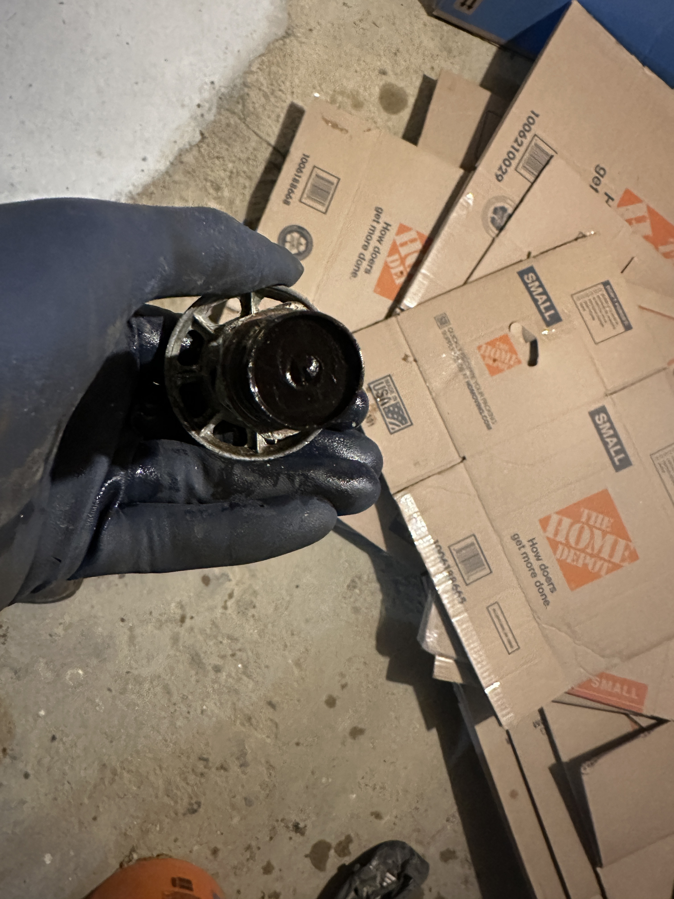

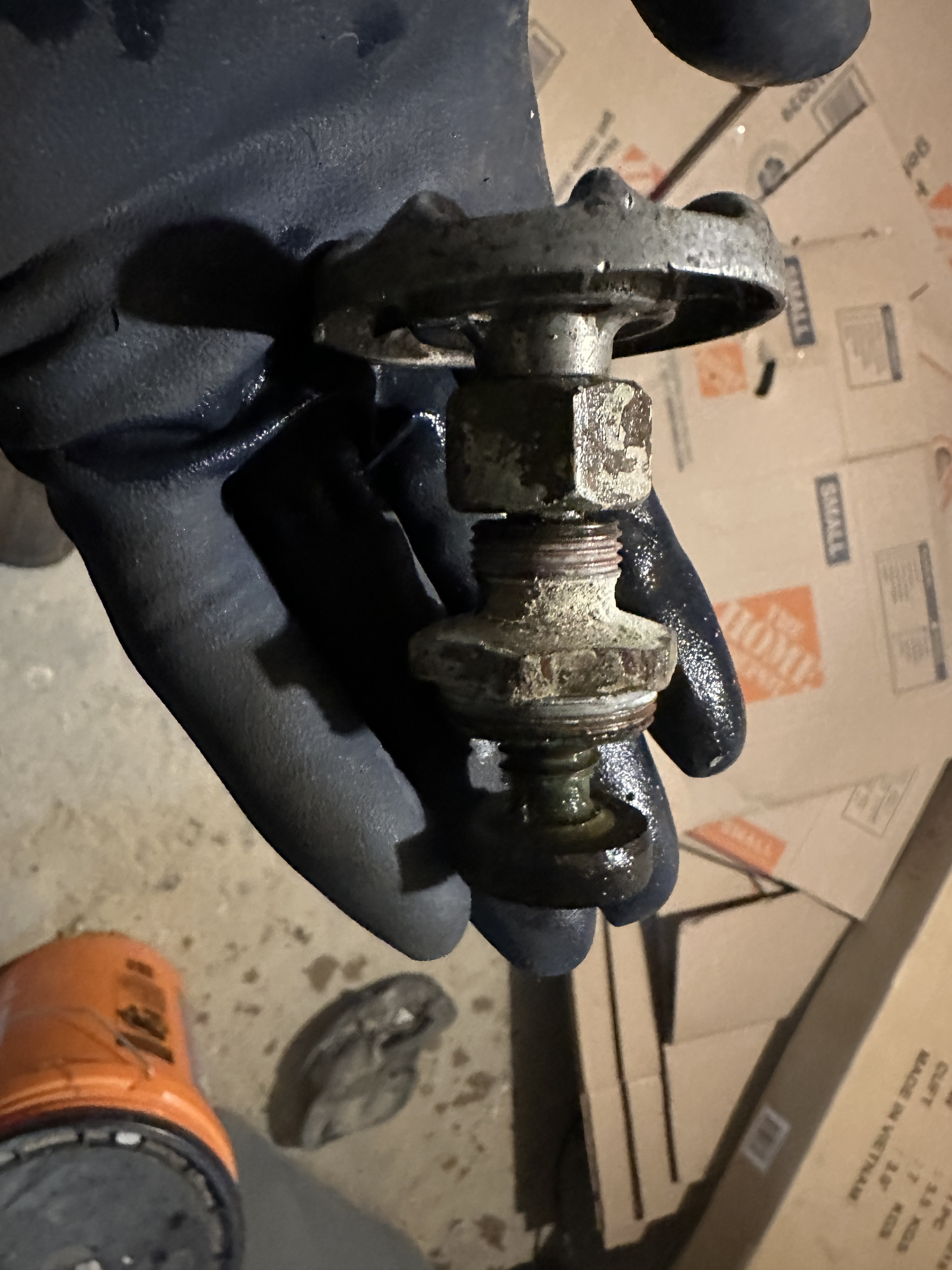

  • This is an image of the entire valve.
    109A_5 Posts: 4,783
    Sadly I can't find an example of the valve seat dressing tool, apparently no one does that any more, they most likely just replace the whole valve.
    With the leak in the picture (3801), I would have just snugged up the packing nut a bit. If that did not work I would have closed the valve (assuming it was installed in the correct direction), removed the handle, removed the packing nut, cleaned up the stem, replaced the packing material with the Teflon string and re-secured the packing nut. Once the Teflon string packing is compressed it may need another application for best seal.

    that type of valve usually doesn't have a removable seat. unless the valve was left closed and leaking a significant amount for a long time the seat usually doesn't get damaged but if it were to be damaged, replacement is probably the best option.
  • @109A_5 and @mattmia2 , I purchased some packing string and a container of bib washers. I might not need the washers from what mattmia2 said. Hoping that screw will come off so I may remove the packing nut. Getting that screw out will be the most challenging but I totally got it.

    The scerw, or what is left of it holds the washer on, which seems to be missing but your picture is underexposed so I can't really tell what is going on with the screw or washer. You probably need to buy the washer out of the bins at a hardware store, the assortments usually don't have washers that big.
    109A_5 Posts: 4,783
    Although it is hard to tell, I'd say the rubber washer is missing. I believe the rubber washer usually sits higher than the metal outer ring. With the shadow on the Right it looks like the washer is missing.

    what looks like a broken off or eroded screw in the steam is probably the hard part here.
  • Right that would be the most difficult. Depending on how this goes my plan B is to install a ball valve that connects with a shark bite.
    you might be able to grab it and turn it with diagonal cutters or drill it and get it out with an easy out or you certainly could drill it to the next size and tap it.
  • Thanks for these suggestions. I will give them a try.
    or possibly cut a slot in it with a dremmel and unscrew it but be careful you don't damage the rest of it doing that. I still can't tell from the picture if the bib washer screw is there or has part of a head or is broken off altogether. you can also get "no rotate" washers that snap in to the hole in the stem instead of being threaded.

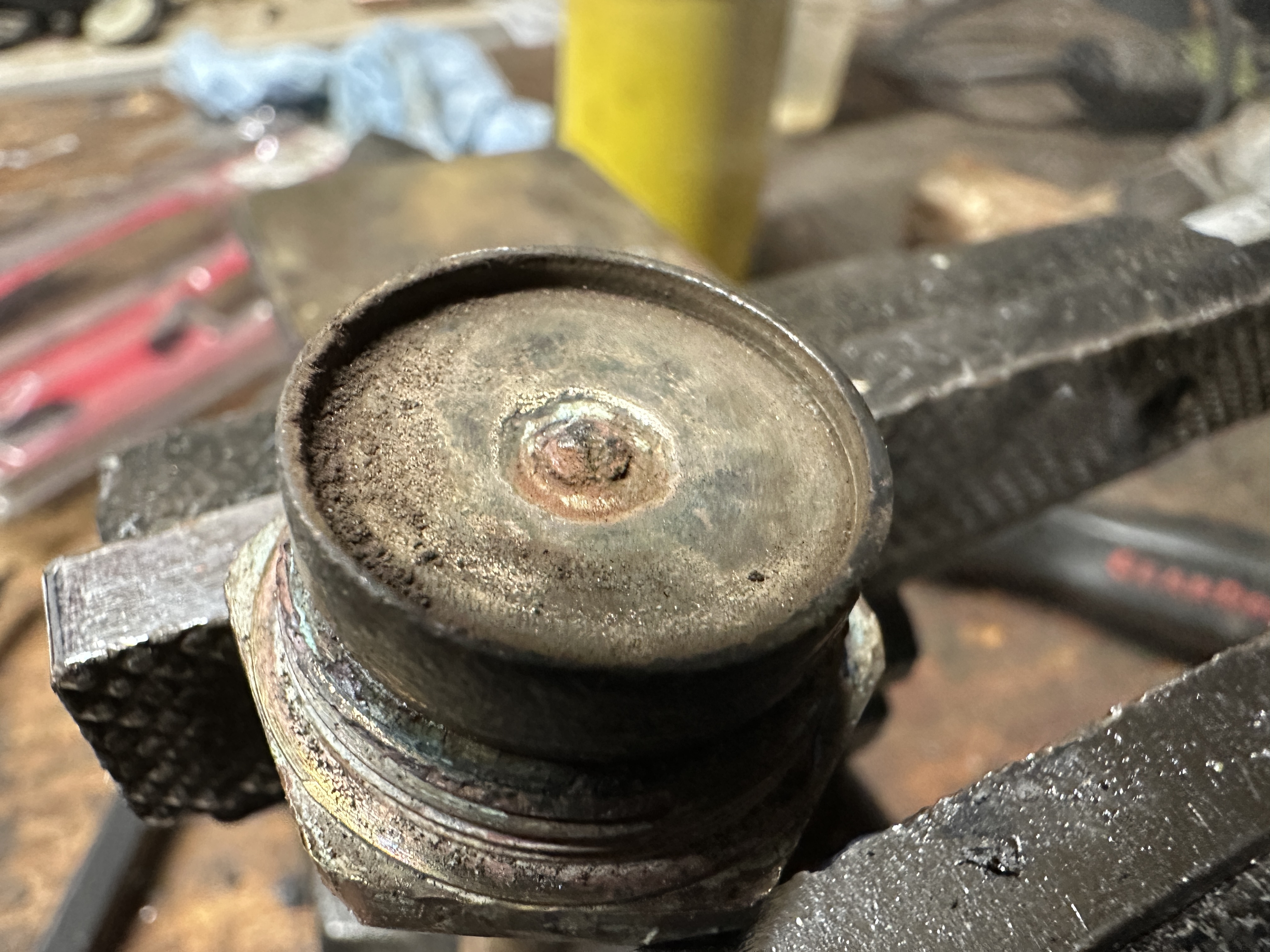

  • ] SOLVED SOLUTION [

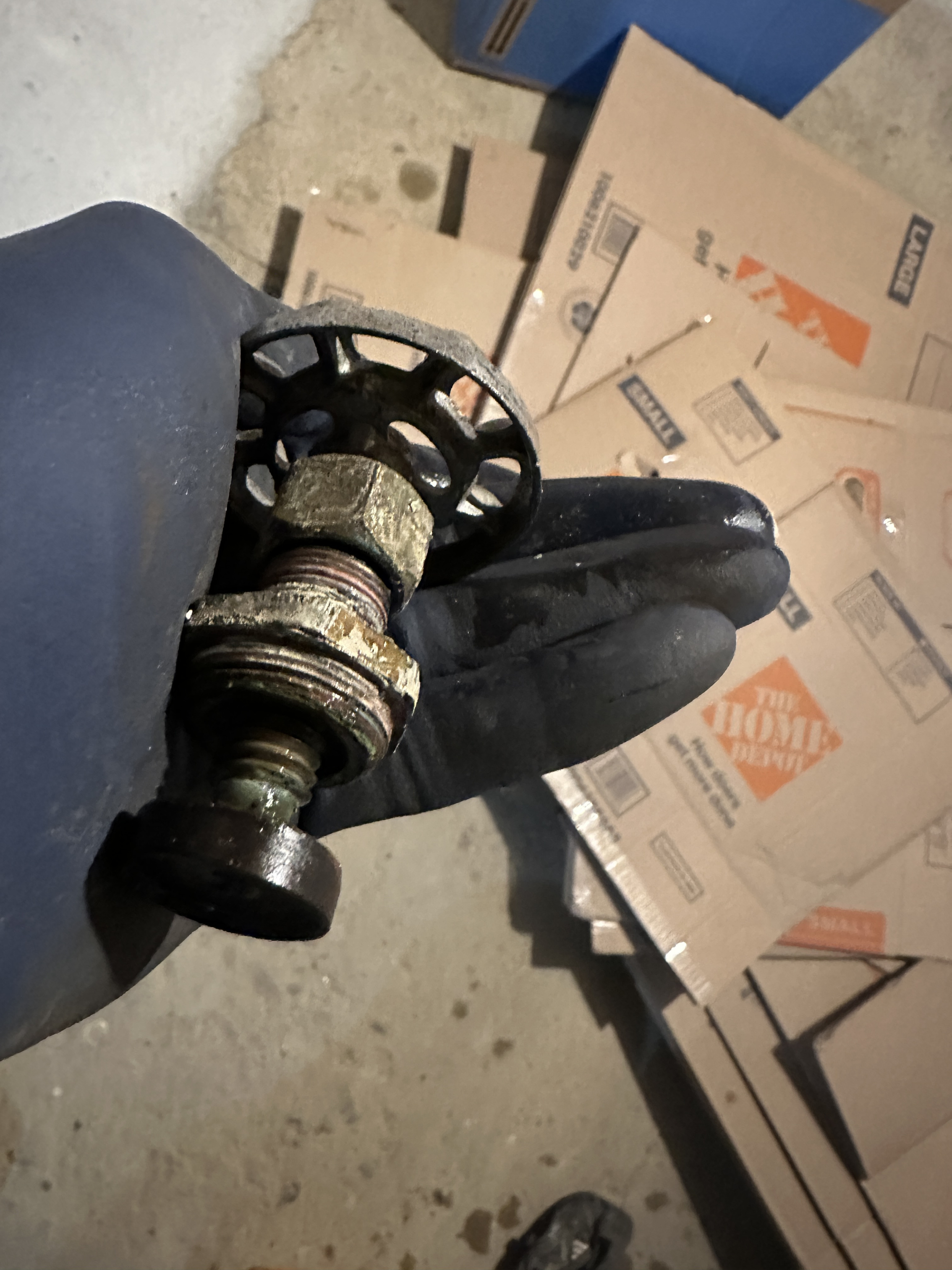

    Here is better photo of the broken off screw.
    After removing the valve I just used a little heat to get the knob off. That flat head screw was not coming off. Then I was able to remove old gasket material and clean out with a Dremel and small brass wire wheel. Used packing string as the new gasket three revolutions and install it. No more leaks and I never driller out the broken off screw and retapped it. I ran out of time. It is a useless shut off valve that no longer leaks. If time was not an issue it would have been done right! I hate doing things like this but I cannot control timelines and other people priorities.

  • @mattmia2 , I went to use my impact screwdriver on this today and my flat head was to wide. This was an example when I needed that 1/4 impact screwdriver. Either way a little heat help me just unscrew it.
