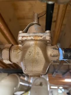

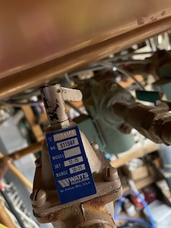

    I have a 2015 TT Prestige boiler. It is over-pressurizing and dumping water. It also has had a lot of air in the system. When I shut the dom wtr auto feed, it stays stable and I can bleed the air off with no reoccurrence…Is it just a bad DW auto feed valve?

    You are shutting off a feed only to a pressure reducing valve and not also to a heat exchanger for domestic hot water?
  • GPG77
    GPG77 Member Posts: 5
    It's the makeup water supply to the closed system.
    mattmia2 Member Posts: 17,905
    then the prv is leaking by. When fresh water is added and existing water is dumped out the relief valve, that fresh water that the prv lets in contains dissolved air, that is there your air is coming from.
    it needs to be replaced or rebuilt.
    only the coil in an indirect water heater or the heat exchanger in a combi water heater but if it stopped if you closed the manual valve for the prv and there is nothing else on that valve then it is a pretty good sign that it is the prv.
    that drip of water down the side of the prv isn't a great sign either.
