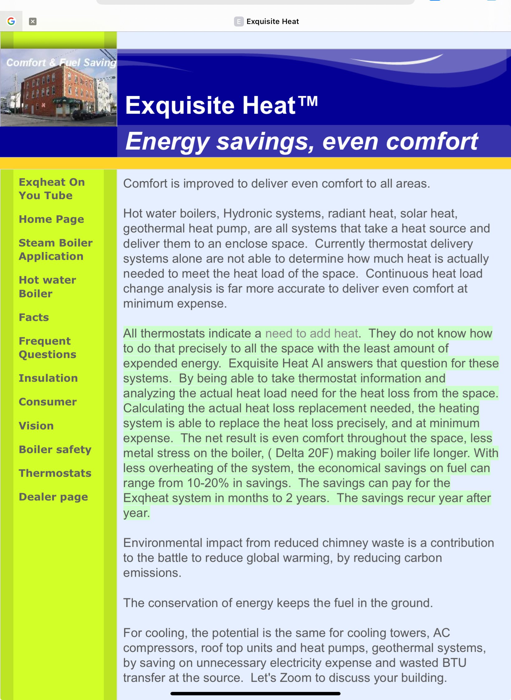

    John over at Exquisite Heat is a proponent of the indoor reset function and has built controls with this tech.

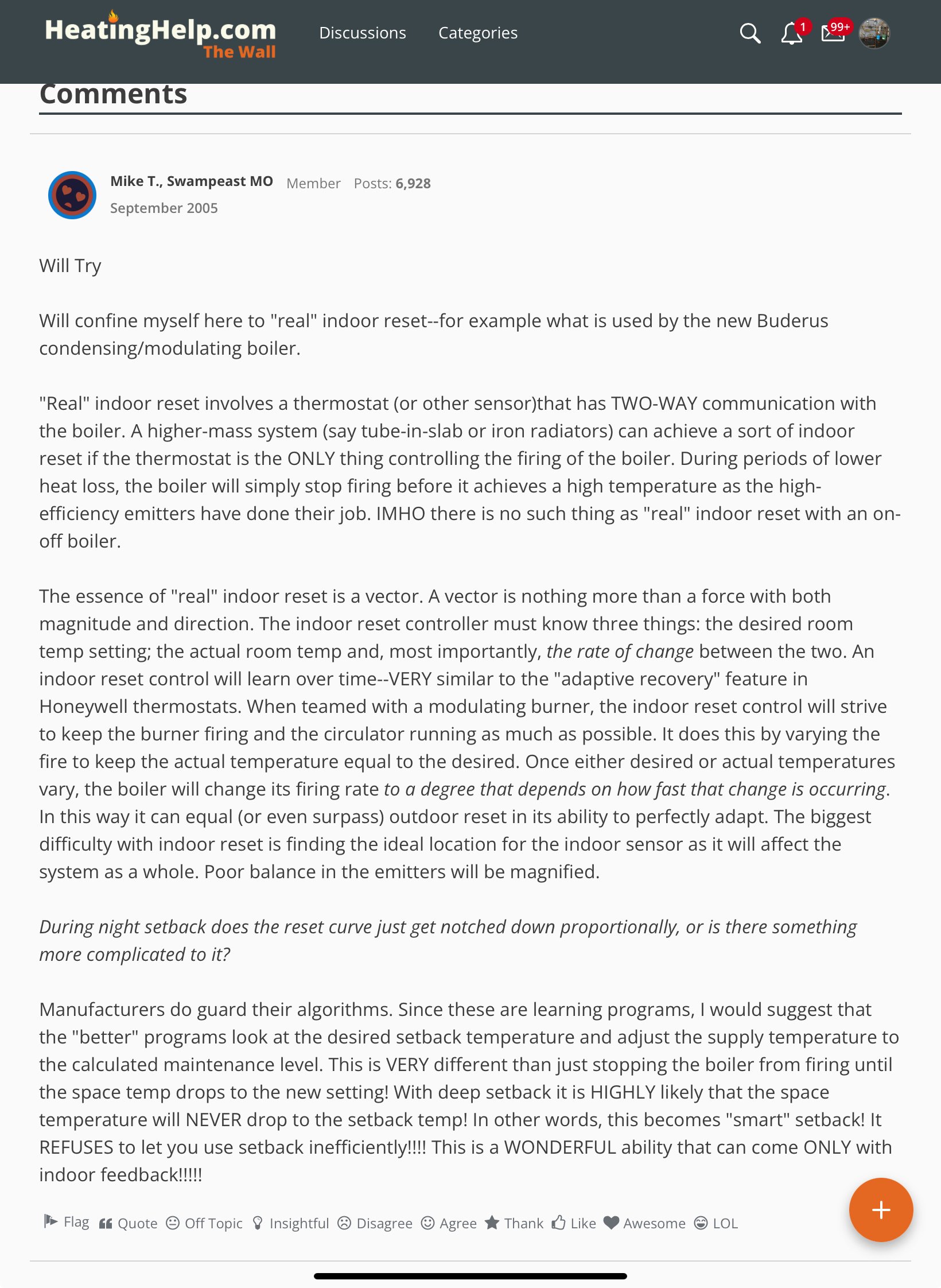

    Mike from Missouri had a good explanation

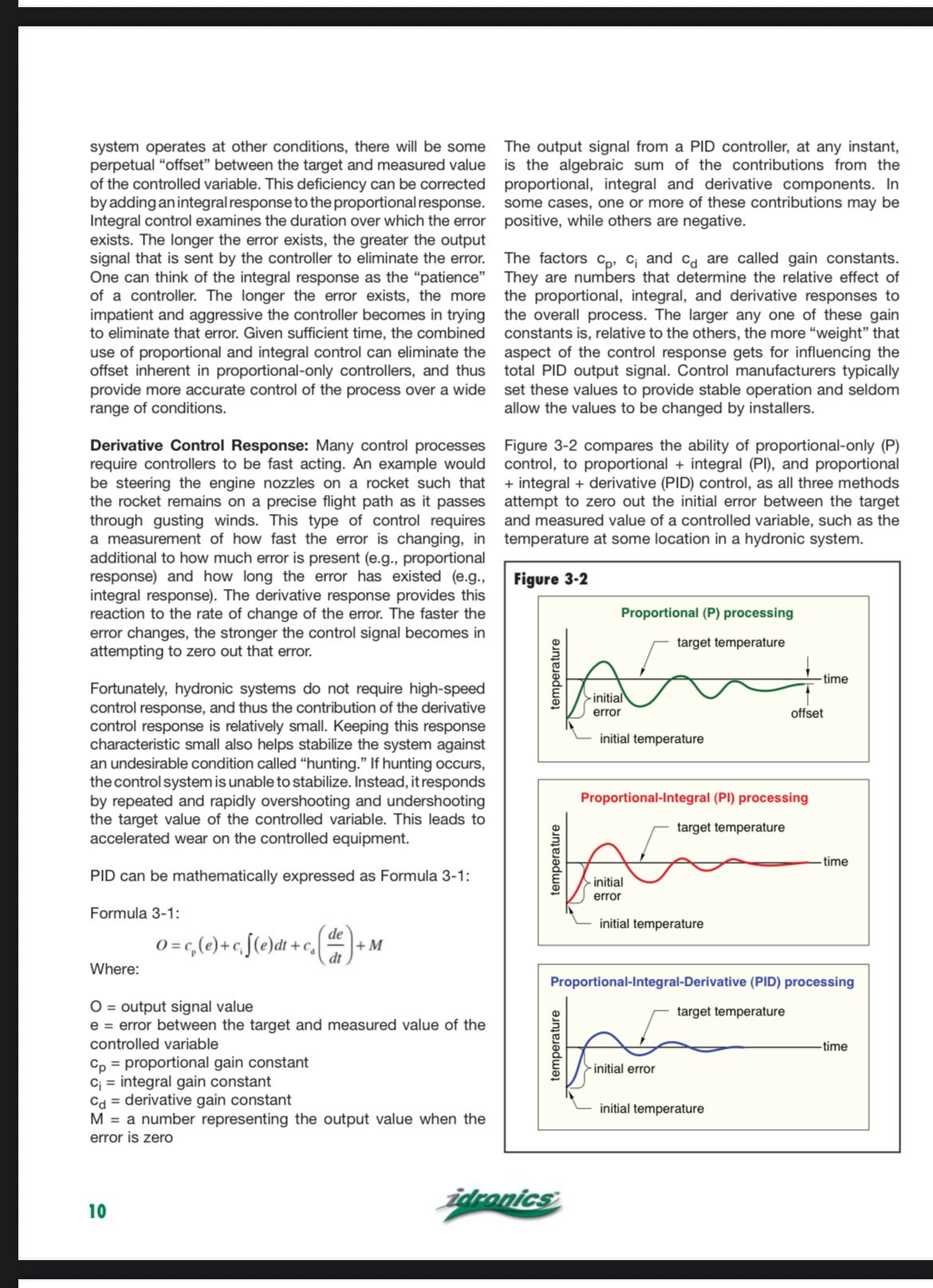

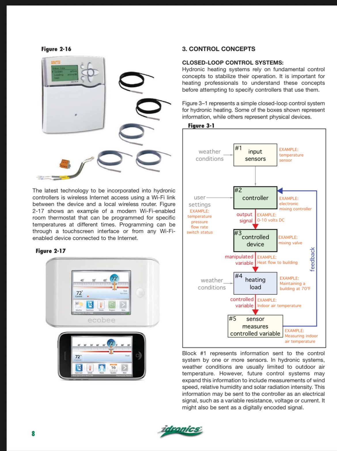

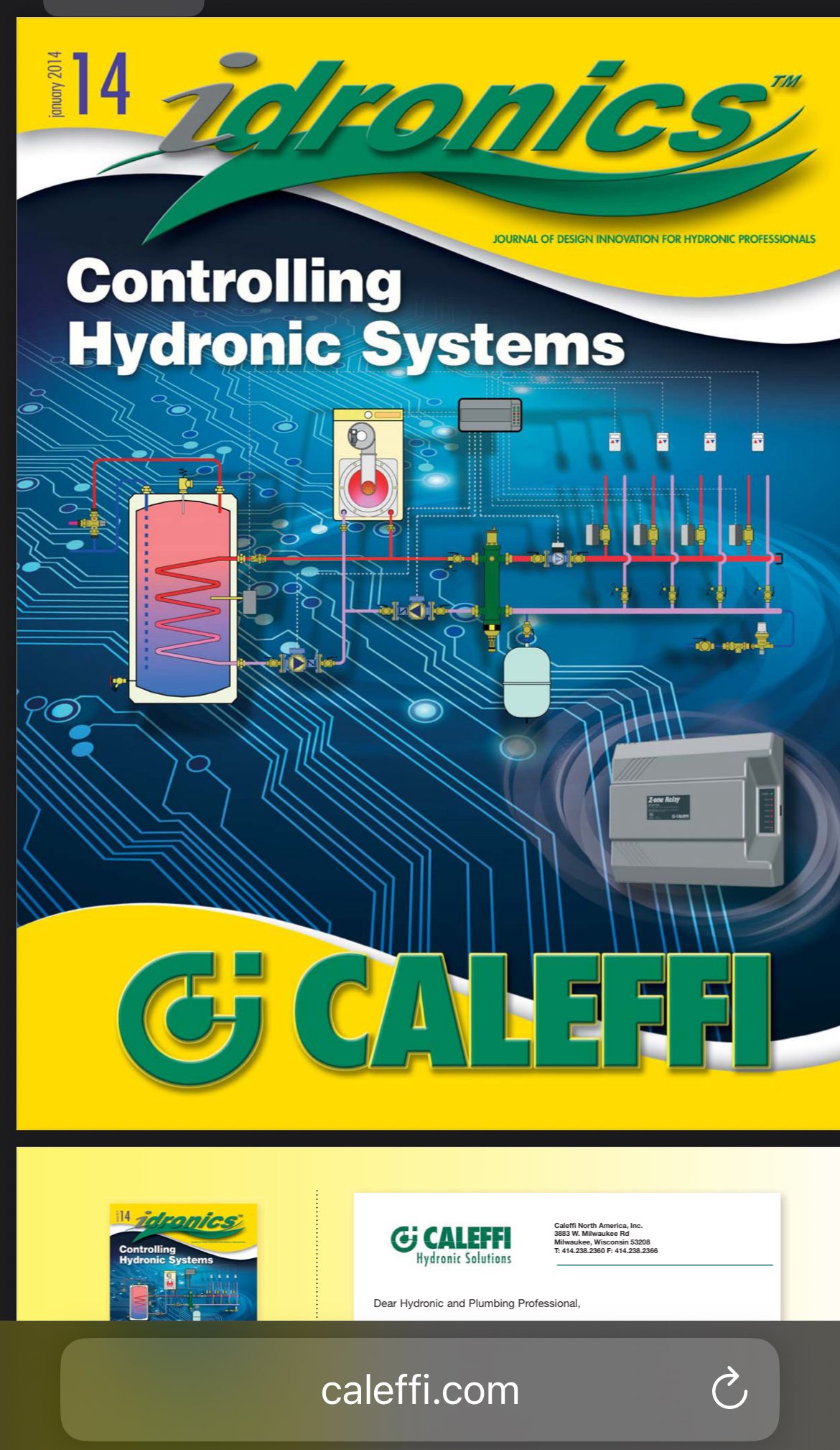

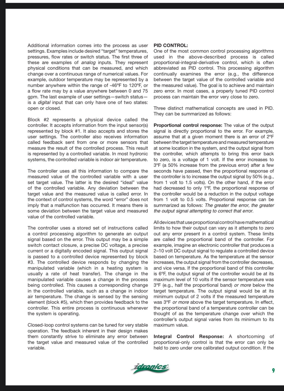

    this Idronics issue covers some if the more sophisticated control logics P, PI, PID used in hydronics controls
    Tekmar also has papers on these logics and how their control use the various methods
