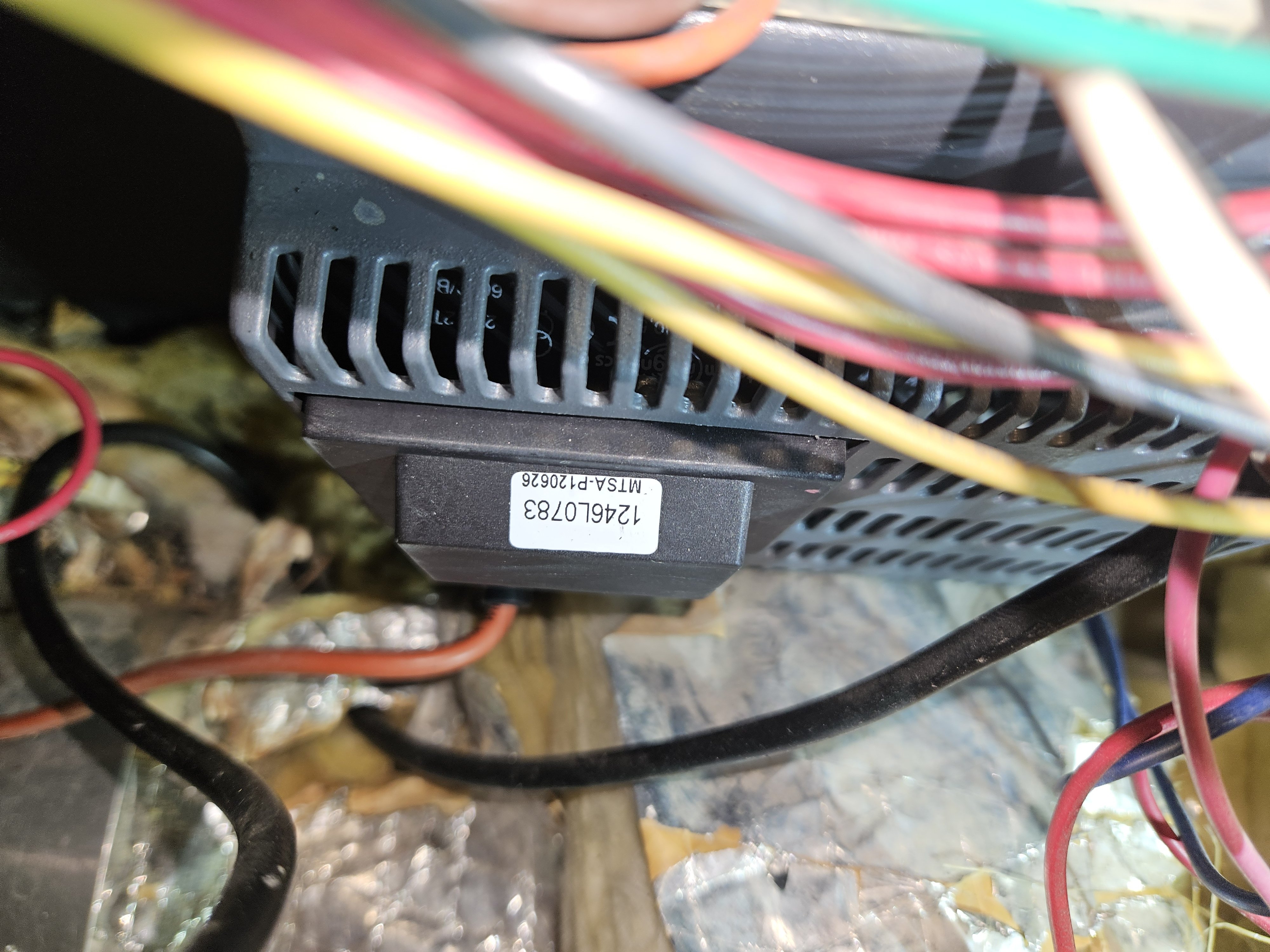

    Is this the controller number?

  • F09 was a common problem with older Munchkins. Replacing the control board with the upgraded 926 board (part #7250P-731) usually resolves the problem.
    I order mine from Jupiter Heating. Once you place the order, email them the model and serial number of the boiler so that they can program the board for your unit.
    https://www.jupiterheating.com/htp/parts/7250P-731.html

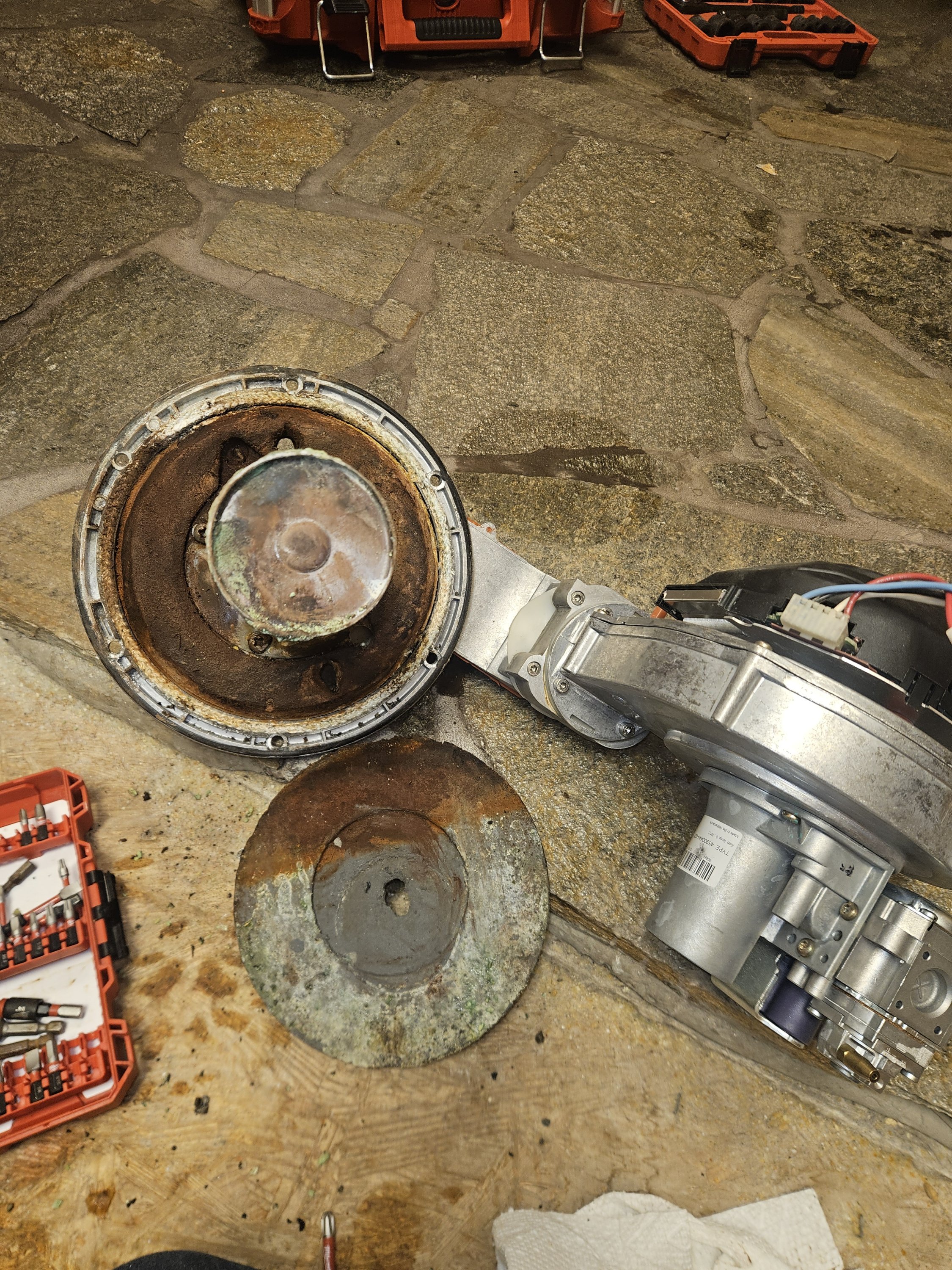

    II'll Open it up today and have a look.
    Thanks, much appreciated.

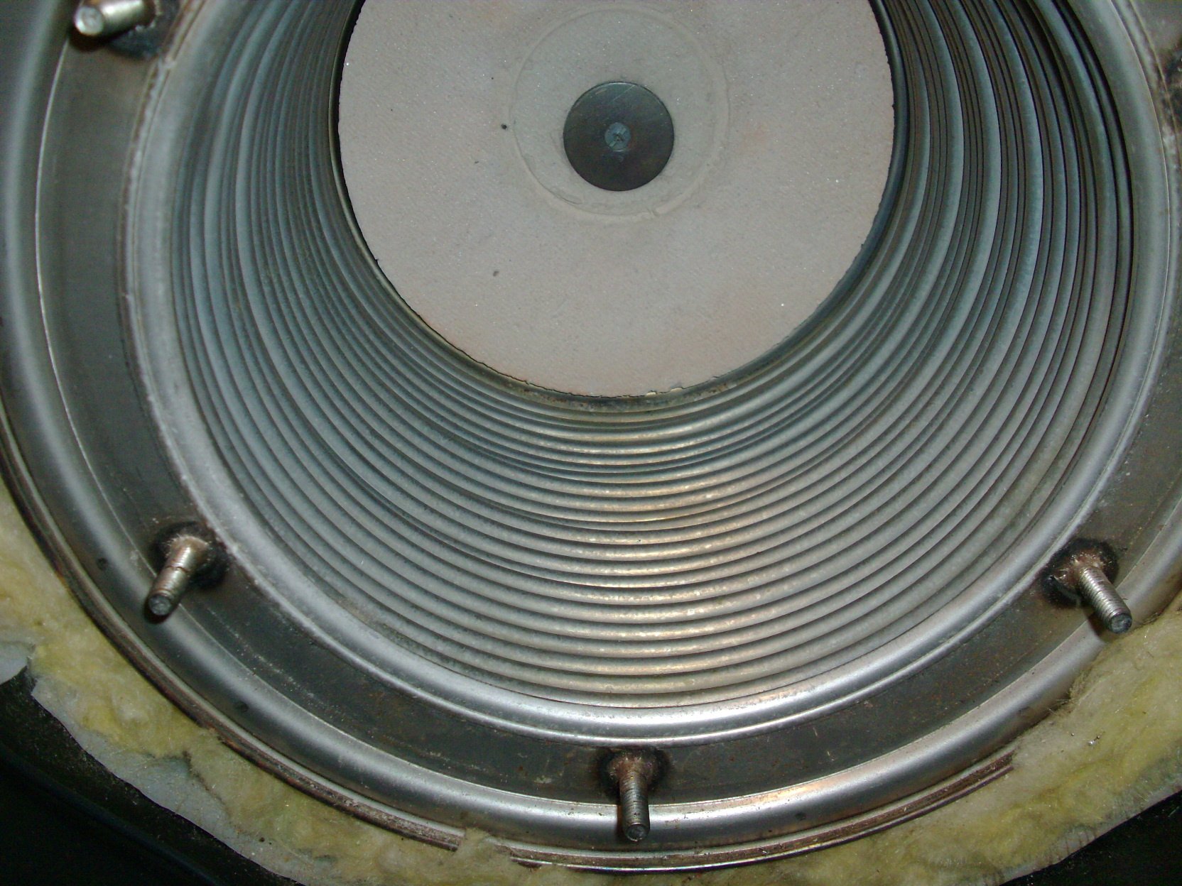

  • HomerJSmith
    HomerJSmith Posts: 2,837
    Ya! you have a condensate drain issue. I would replace the front and rear refractory, do a complete HX cleaning. Remove the refractories before hand. I use CLR cleaner in a squirt bottle and soak it well. Use a stainless steel scouring pad that I get at the Dollar Store to scrub the HX. Use a garden hose to flush the the HX several times until the condesate hose runs freely. I use a feeler gauge to clean between the coils. I also use a stainless wire wheel on a dremel tool and go over the whole HX coils. I bought these wheels at Harbor Freight. Don't use anything but stainless steel to clean the HX. Flush and spray often. It takes me about 3 hours to clean a Munchkin. The longest it took me to clean a Lochinvar was almost 5 hours. Take your time and do it right.
    Munchkins need a combustion analysis which is part of my cleaning process.
    On low fire the fan rpm is about 1400 and at high fire 3200 as I recall. You have to access the service mode to adjust the rpm up or down. The manual tells you how to access the programing and the code which is 925.
    This is what a Munchkin that I cleaned looks like.

    Ive got the ceramic pads front and back ordered from jupiter, will get it cleaned up and new gaskets next week.
