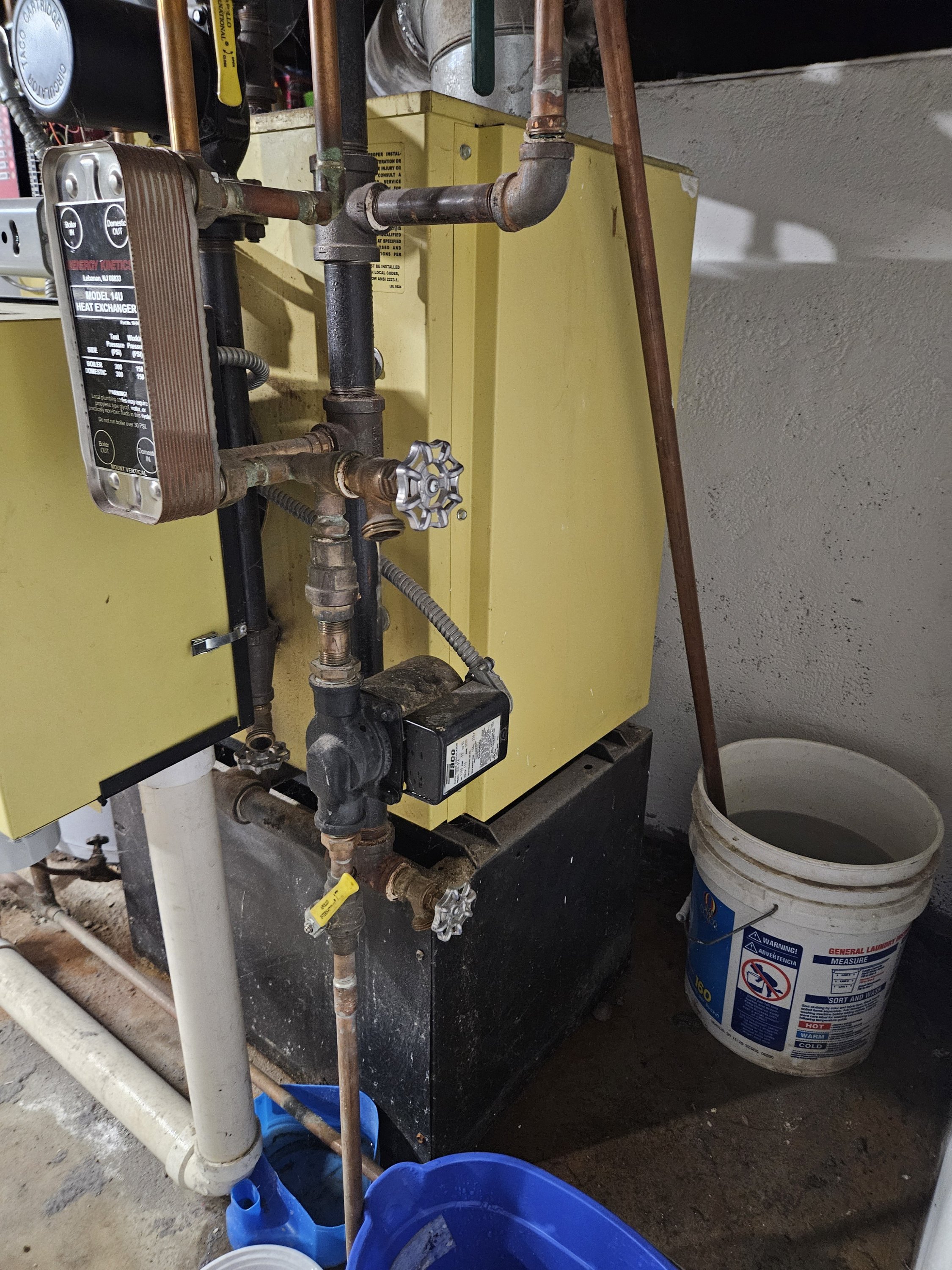

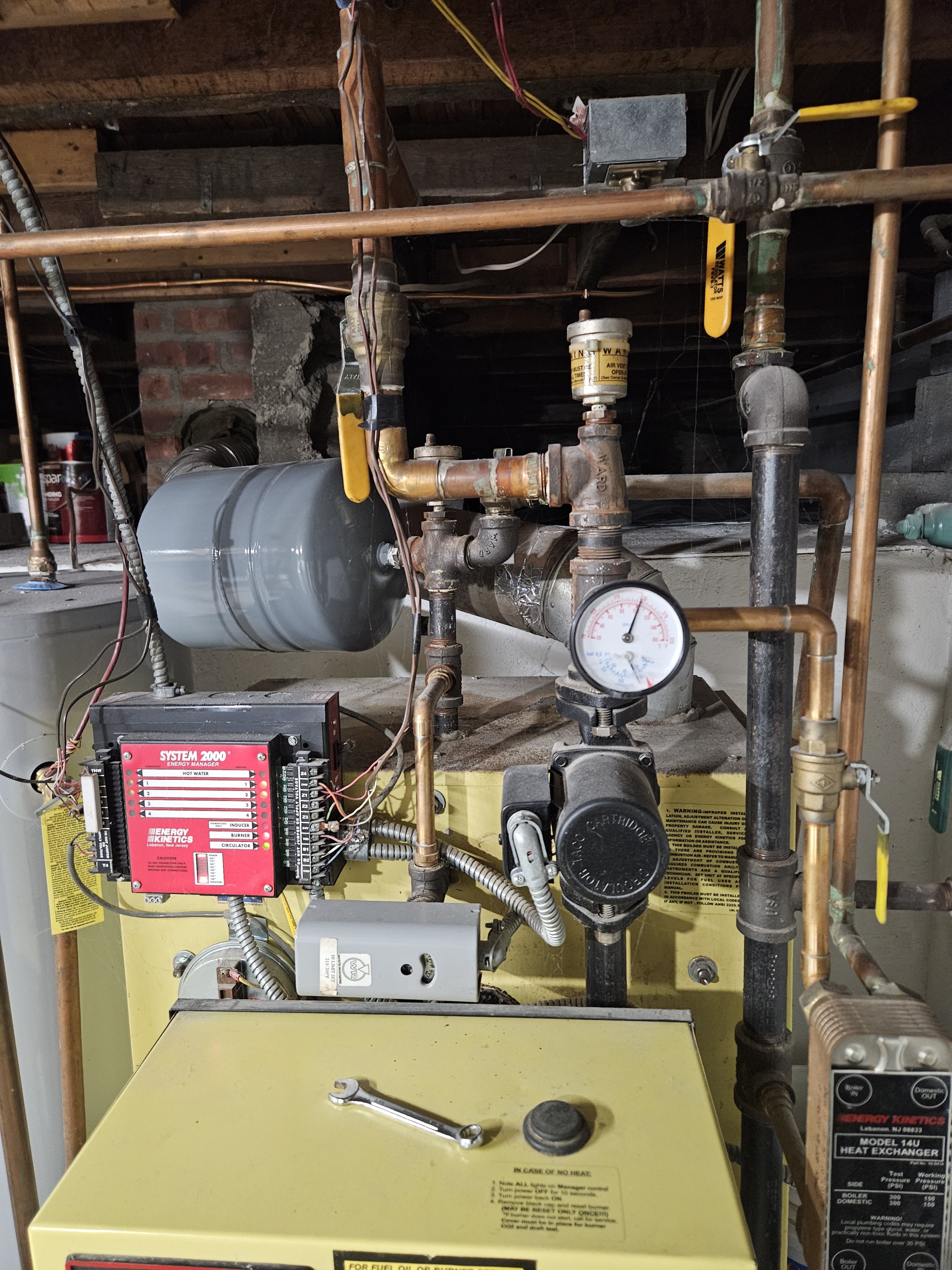

I added a more pics, sorry if they are repetitive. I see the pressure is high when it's running also. << apparently I had the same issue last year bc i see it was my last post. I really need to learn about this thing during the off season instead of always running into problems in winter. >>

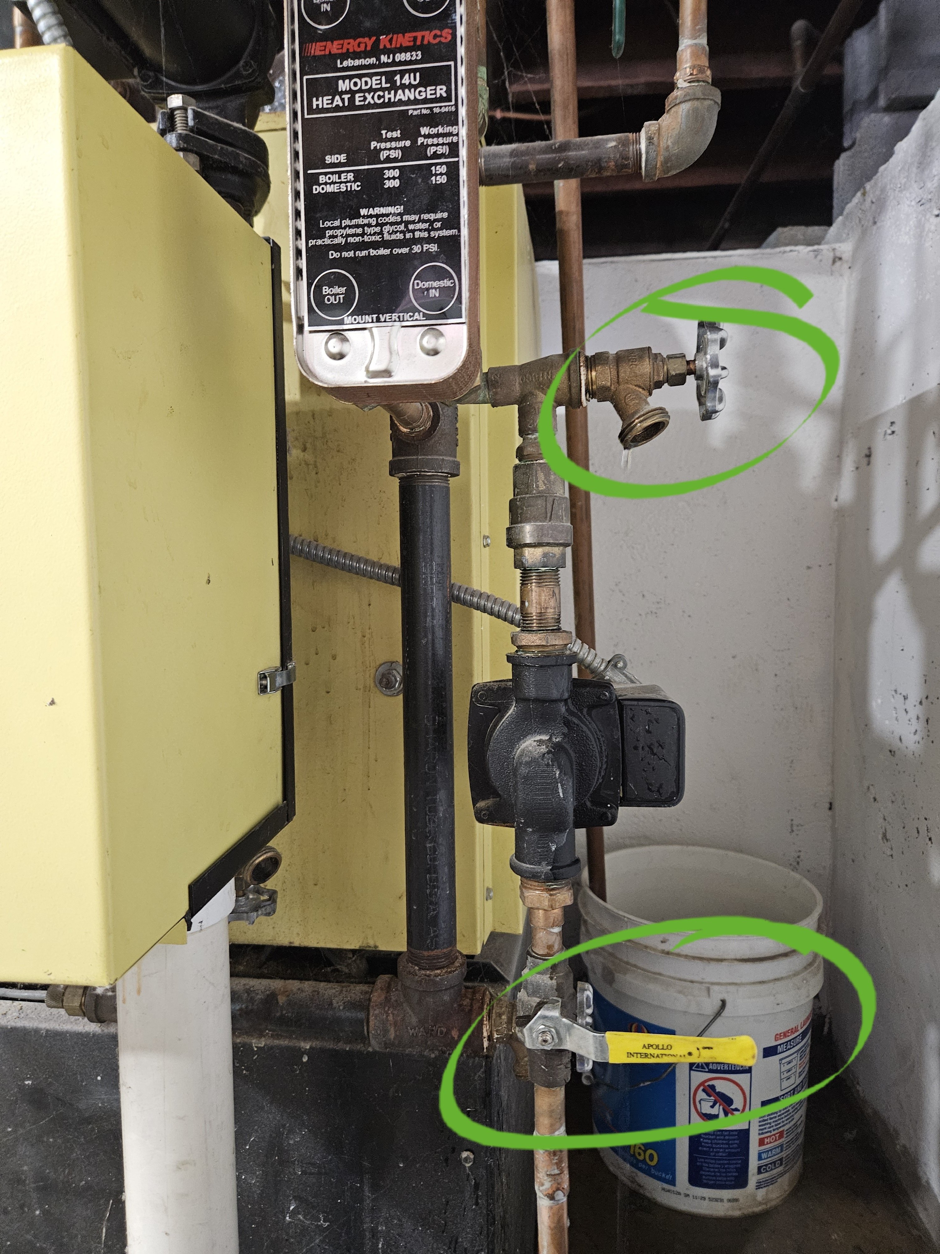

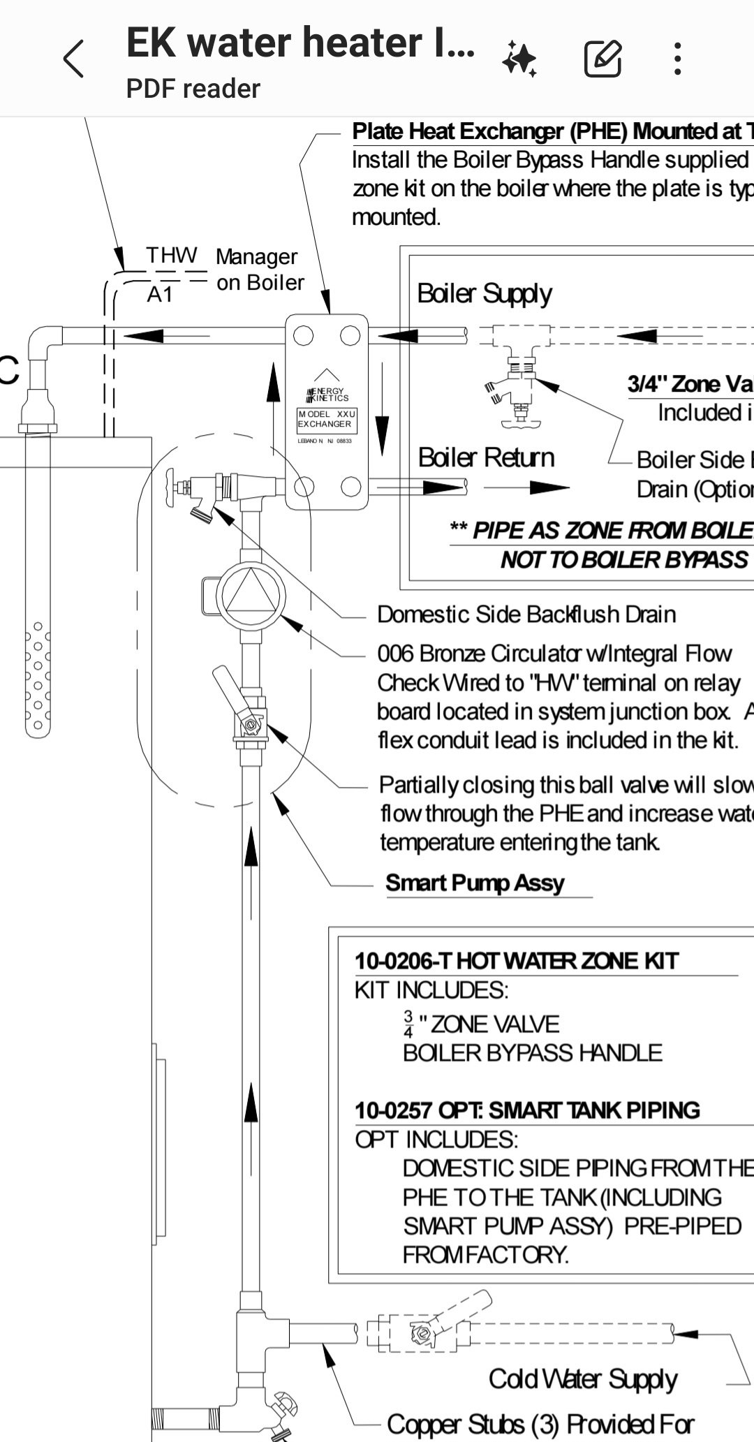

Original post: Please help me identify this part the water is leaking from and the lower handle I don't know if it should be open or closed, I may have caught my shirt on it while reaching between the wall & the unit and now I'm not sure if I moved it or not.
    the upper part is a boiler drain. you can put a hose thread cap on it until it is more convenient to drain that part of the system and replace it.

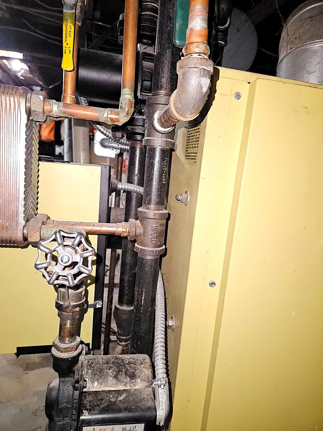

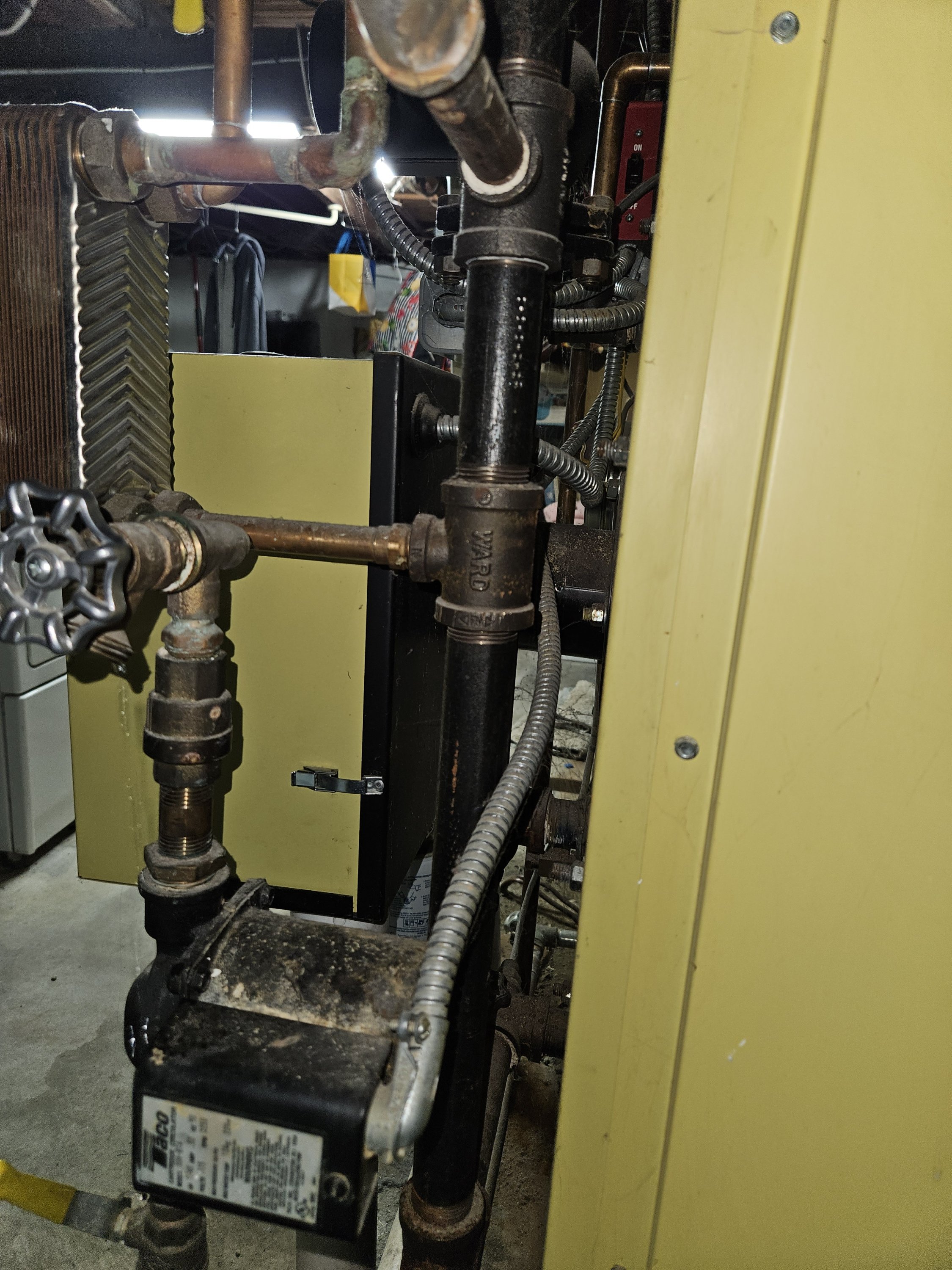

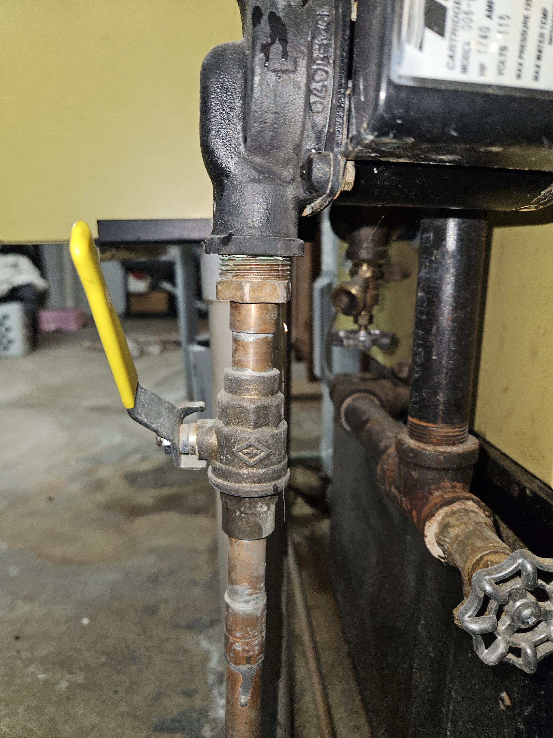

    can you show a couple pictures of the lower valve from a couple different angles, especially from the right side, i can't quite tell how it is connected to the other piping.
    I think the lower valve is just a ball valve but can't tell 100% that it isn't a 3 way valve or something.
    HVACNUT Posts: 7,784
    The drain valve should obviously be closed. The ball valve should be at least be half way open. It tempers the hot water entering the water heater.

    I think the ball valve was halfway and maybe that's why I thought I moved it. I will take more pictures when I get home, I had to leave for work and just put a bucket under it and turned down the heat. Thanks!
    @mattmia2 when you say drain that part of the system and replace it. Do you mean replace the boiler drain part b/c that's whats leaking? Okay it sounds dumb when I say it but is it just that simple... the part isn't working properly anymore?
    @Juggatweet The handle on the drain valve try turning it clockwise and see if it sops leaking. If it doesn't you can pick up a hose cap at a hardware store or at the big box. Tell them you want a brass hose cap and a washer. It is the same thread as a garden hose.
