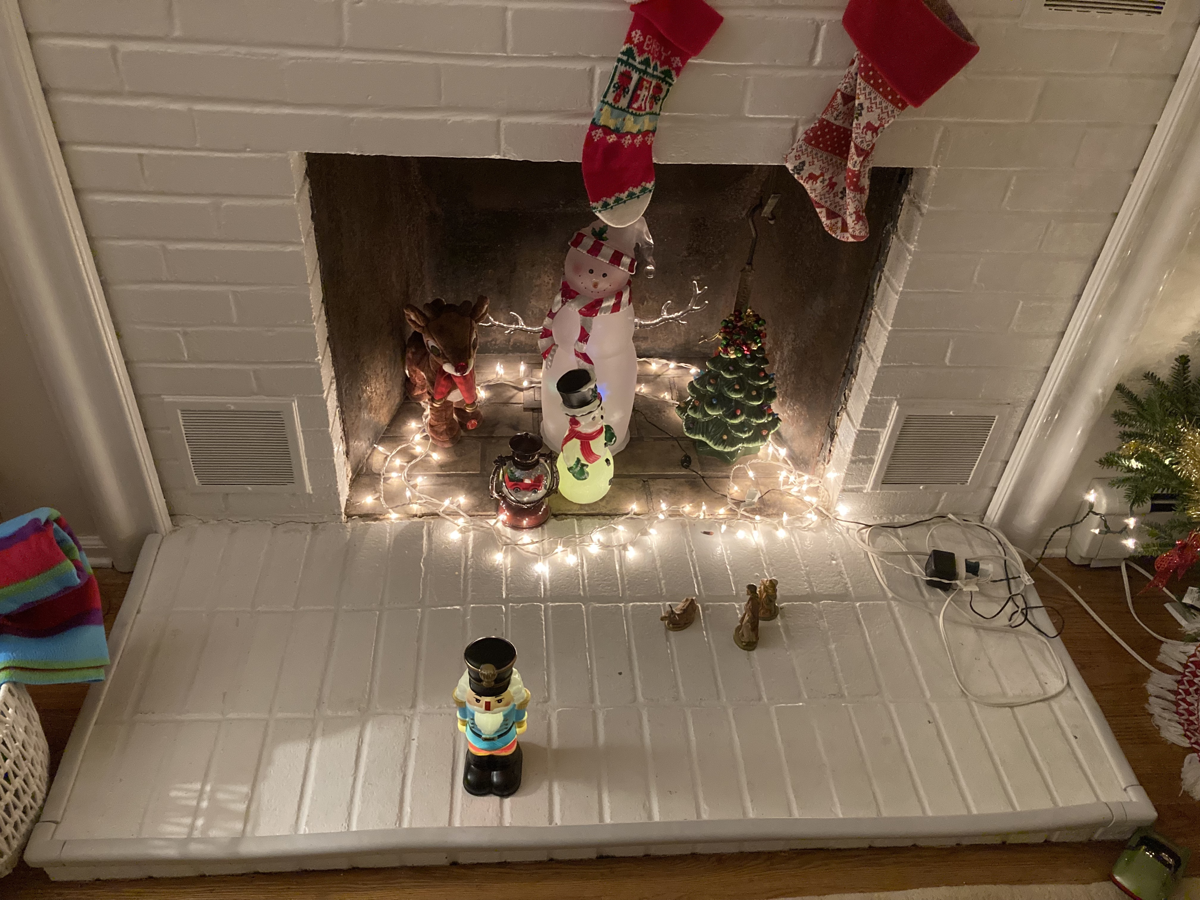

I sell the i2450 and its a solid, basic non-cat stove. No frills, just heat. I recommend you consider who the local authorized dealer is in case you need warranty support or parts. You can get just about any stove brand if you try hard enough but who is going to support it and who is authorized to sell it? Buy local. Talk to your local chimney sweep. Make sure you understand how it is to be swept from below. Some stoves can only be swept from above. Install the insert of a series of 1/8" steel rods like rollers. This allows easy installation and removal by one man. Remember you need 16" noncombustible floor protection from the face of the stove and observe mantel clearances or install a ventilated heat shield per NFPA 211. The chimney should have a level II inspection prior to relining anyway.

Hi Bob,
Thank you for this super thorough response. That's what I have been reading about the i2450 and what I'm learning towards. We had the level 2 chimney inspection, and did the necessary repairs. I definitely want to buy local from a dealer who also does installations so it can be under warranty and I have someone to call if need be. We have 26 inches of brick noncombustible floor protection, but our chimney sweep was not sure if it would pass inspection. Adding a picture here. I'm not familiar with the installing of the insert of a series of 1/8'' steel rods. Also, just confirming- you are recommending to go with a 316 liner which is 6'' round and to install a barometric damper at the top of the liner/chimney? I'm still new to this so I am unsure of some of the parts.
