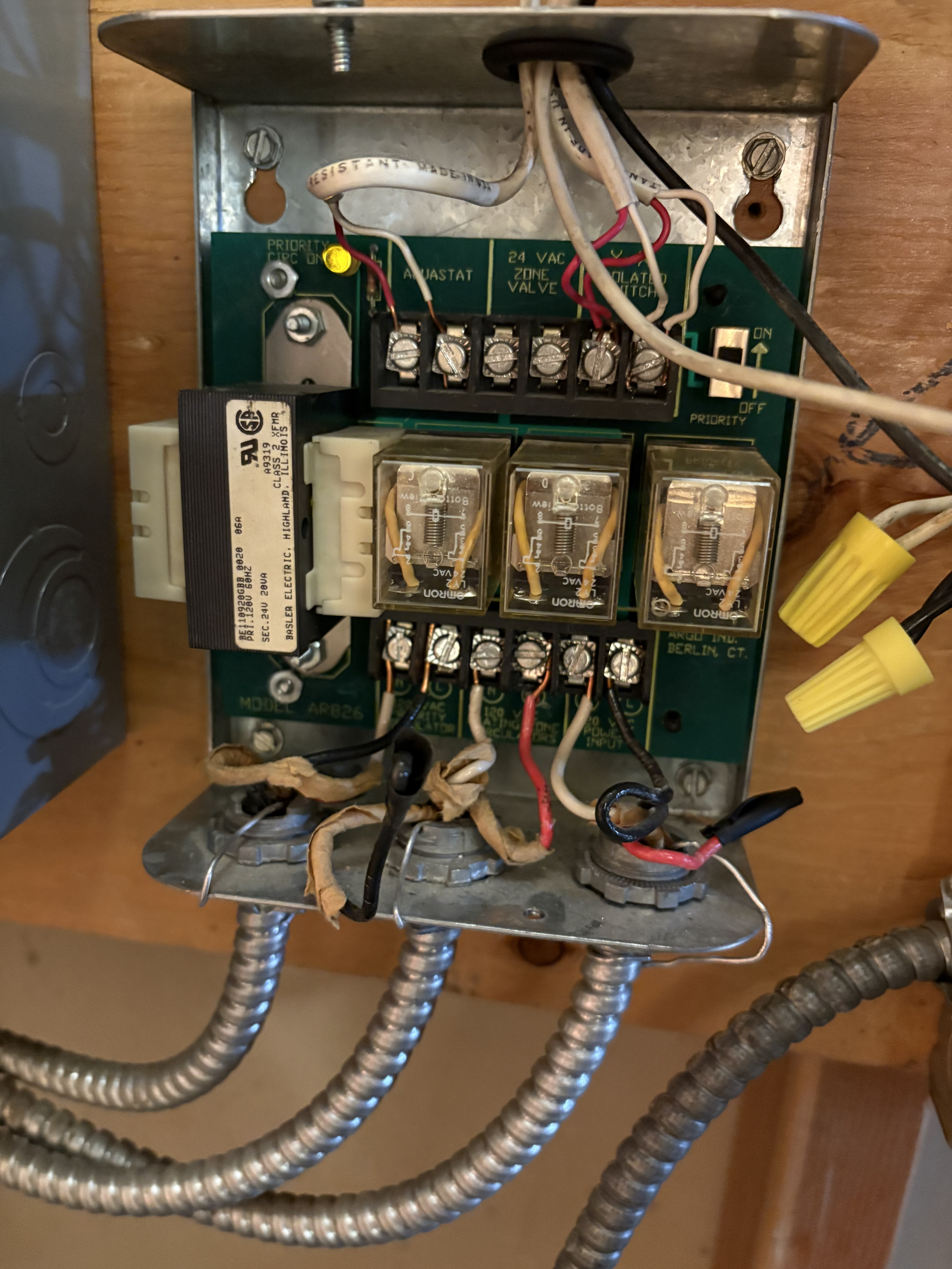

  • Here is the controller in question. Will need to take pictures of overall set up tonight. It is a mess. No schematics on covers. Problems has been around since we moved in 10 years ago. House built in 83. Problem is in summer, there is heat pumping into the air handler and that offsets AC. Tired of working around this and would like to fix it.

    Looks like it is in Priority when the picture was taken. I assume the switch is up for priority.
    Your actual issue may be elsewhere. That box may only just provide Priority for the DHW (Domestic Hot Water) circulator. When there is 'No Priority' it may simply provide power for the heat zone circulator which may be controlled by another device. That box (the AR826) does not appear to provide 'Thermostatic Control' for the heat zone circulator. It other words it only interrupts the power for the heat zone circulator to favor DHW circulator.
    There is multiple pairs of wires connected to the X-X terminals which leads me to believe there is other control equipment.
    You can inspect the relays (the contacts) if they are in sockets and if they are the same part number you can rearrange then to see if the symptoms change. Mark their original location.
    The "24 VAC Zone Valve" terminals has me confused as to their purpose (and not used in your case).

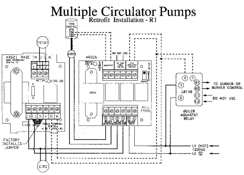

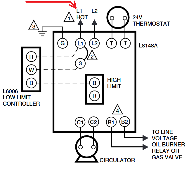

    Found this in the other thread posted above. Interesting the image states DO NOT USE for the "24 VAC Zone Valve" terminals.

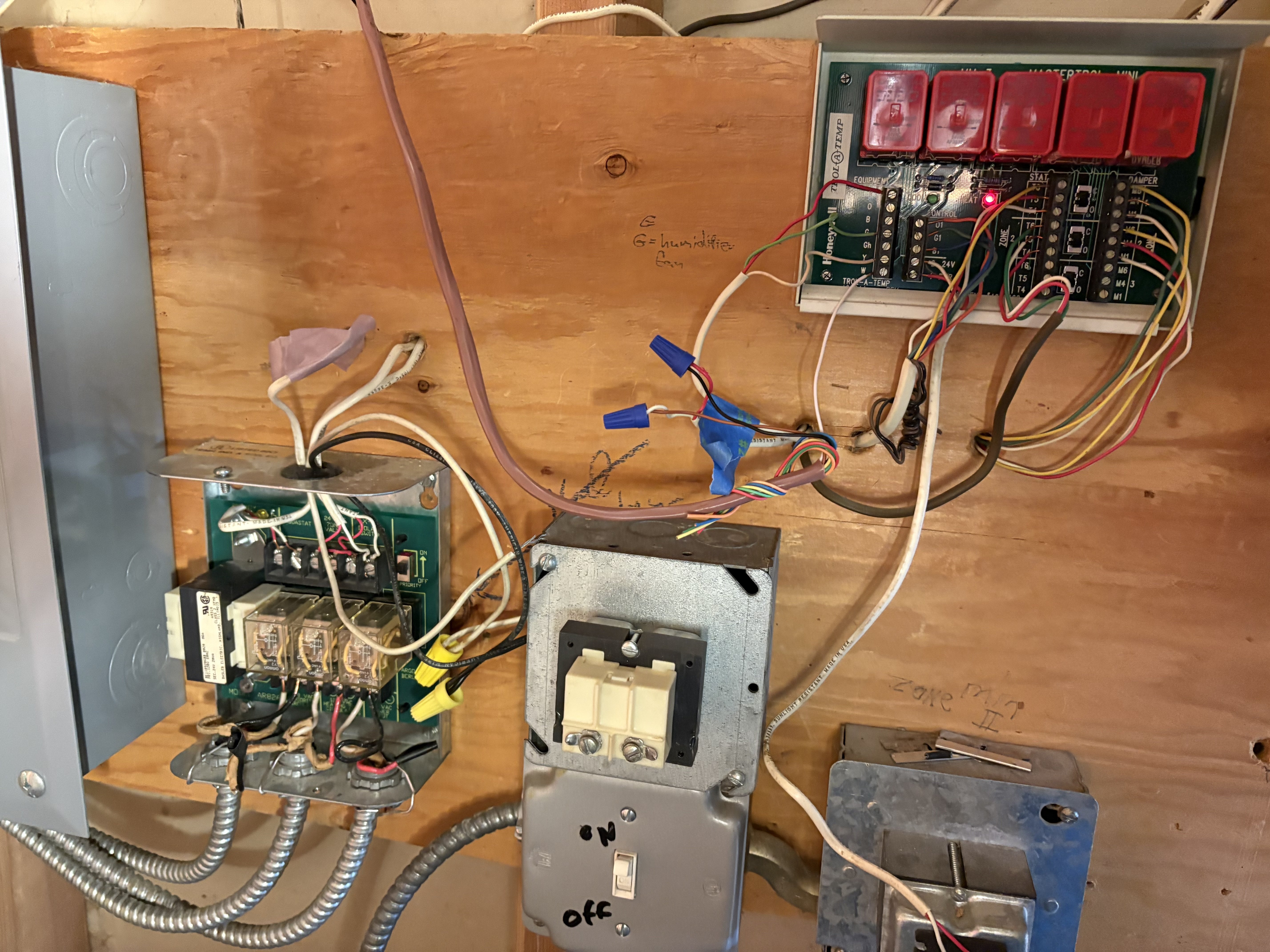

  • Boiler is used for heat and hot water. Relays appear to work and not stuck. The relays switch when priority is called for.
  • I had looked at that thread. Your questions are similar to mine. Confusing. Surprised the spec sheet or owners manual hasn’t made it to Google in this day and age, lol. I will post pics of the other controllers, you will see the mess I’m dealing with.

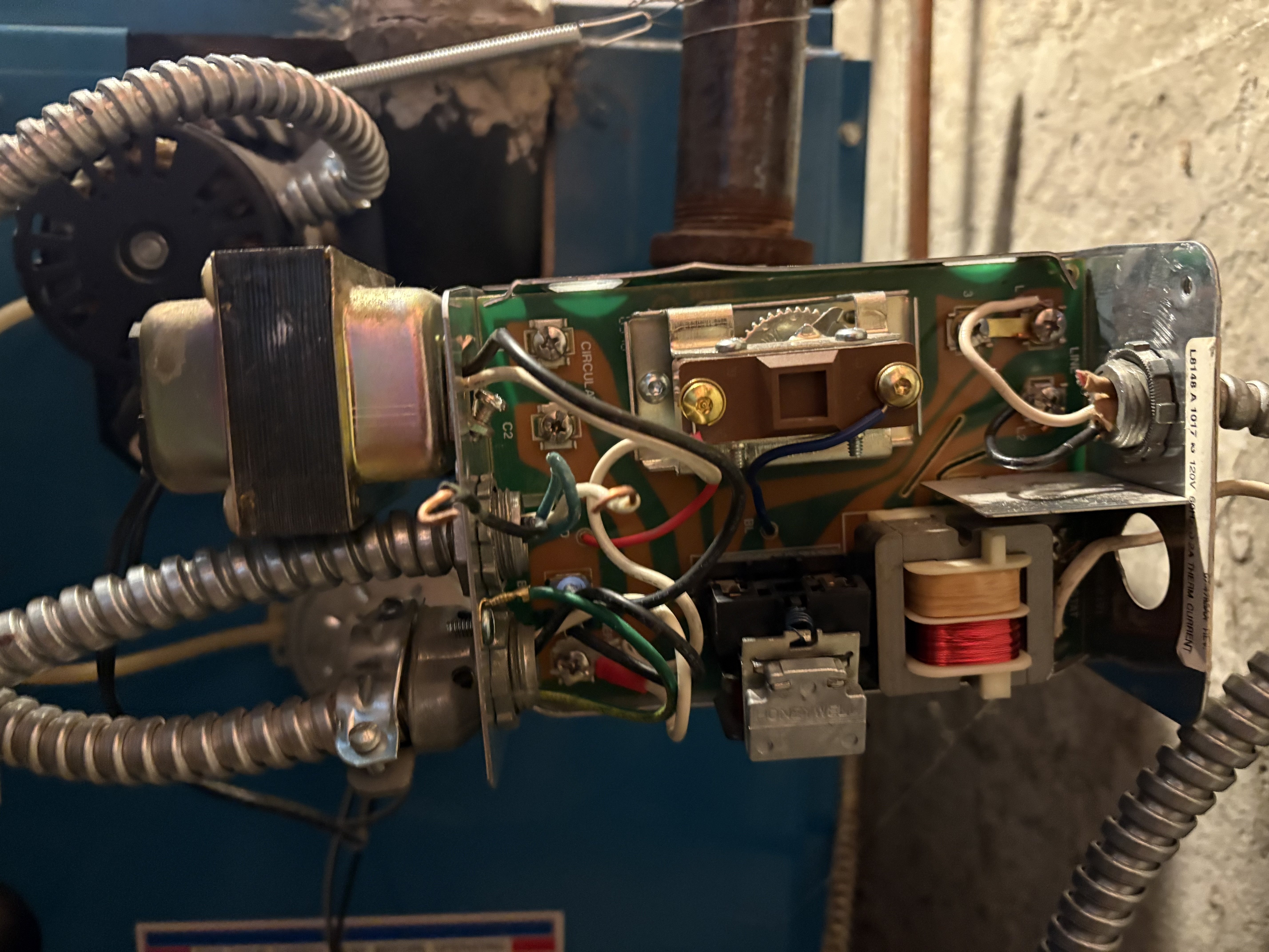

    So, have two circulators off the boiler, I would like both off when no demand. Picture 1 is boiler control. Picture to shows the previously mentioned Argo AR826 and the main zone controller. I’m starting to think…as suggested above, that the 826 was intended to work with another Argo controller. I did find a document in the Argo historical files that shows some interconnects, but not the combination I have. May have to add another relay to the wall to get it to switch off…. Will get back on it this weekend..

    what is the Honeywell Trol temp being used for? That was typically for zoning hvac dampers
  • There are two air zoning valves for upstairs and downstairs.

    Well I can't see how the BX cables and the low voltage wiring interconnect between things. So I can't tell what controls what.
    I'd say this is the intent from Argo but there is too many wires in your L8148A for it to be this way.

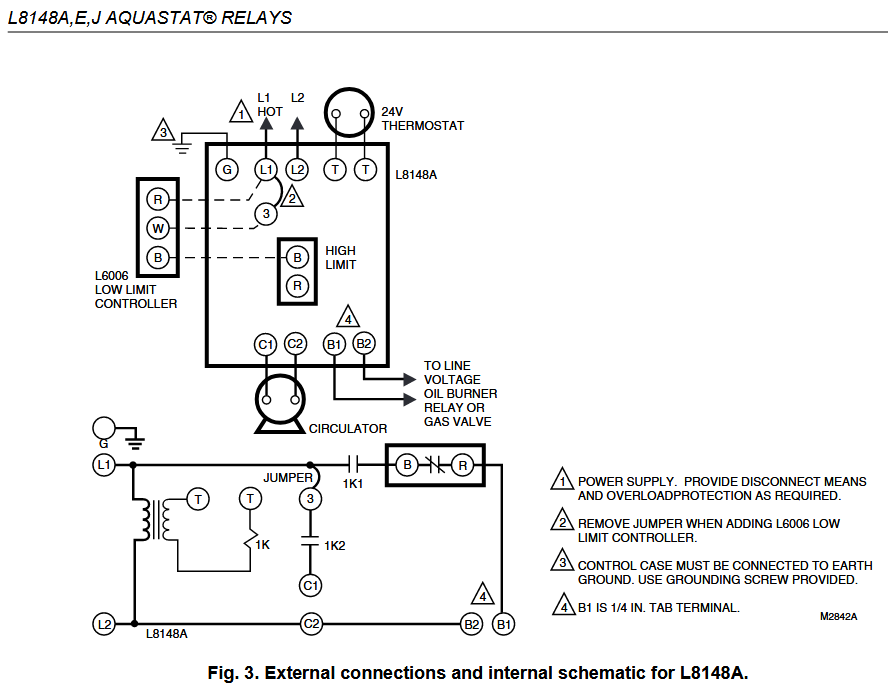

    I'm thinking the L8148A Aquastat should have the ultimate On-Off circulator control. The AR826 just steers which circulator is used and is the DHW call for heat to the T-T of the L8148A Aquastat.
    During no call for heat the L8148A Aquastat should shut down all power to the circulator(s). However that may disable the DHW independent autonomous priority.
    I fear the way they have it wired, you have a 'Which is first the Chicken or the Egg' circulator power situation. since if the L8148A Aquastat kills the power to the AR826 you loose the ability to have an independent DHW call. Not good.

  • This is all actually very helpful. The schematic for L8148A gave me an idea…. I’ll have to think on it, but will certainly share if I ever sort this out. The right answer would be a new control system, but I hate to be beaten by this now….

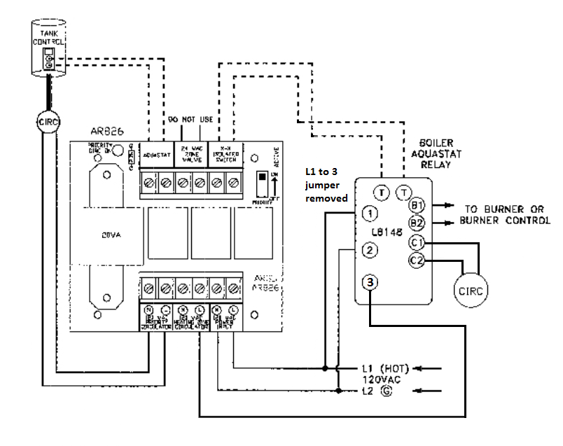

    Looking closer at your L8148A Aquastat C1 and C2 are not connected to anything.

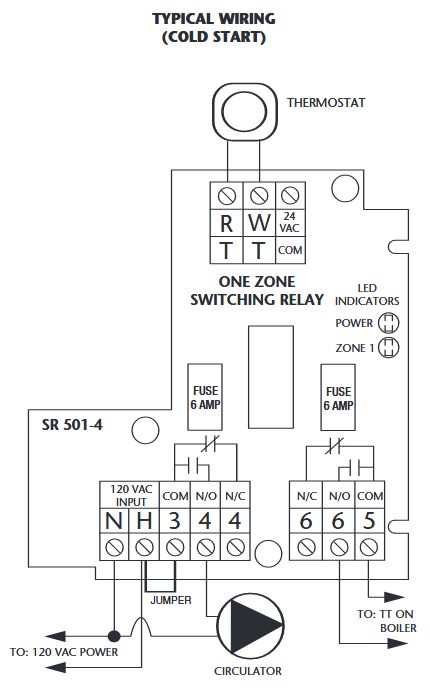

    The easy fix is this diagram using a AR821. However the AR821 may not be available, a Taco SR501-4 may be a good substitute (there may be others). There are more expensive options that would replace the AR826 and the AR821 combination. However I like socketed (easily to replace) relays so I'd be inclined to keep the AR826 and add an appropriate switching relay to control the Heating Zone circulator.

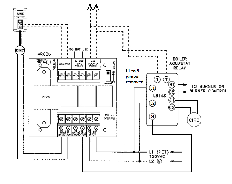

  • Thanks guys. The problem has been there since we bought the house. Would unhook heat circulator in the summer, but got sick of that. I had the air handler and AC replaced this summer and suggested to my guy we should do boiler and controls. He talked me out of it. Of course, I assumed these things would get sorted out…. Anyway, I decided it needed fixing.

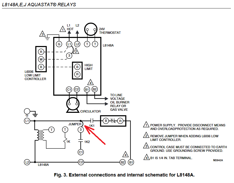

  • Now for the good news. Thanks to the assist here, I got it working. The solution was remove jumper between L1 and 3 on the L8148a. I then ran the circulator output for the heat from the AR826 to term 3 on the 1K2 relay on the L8148a relay. Then ran C1 and C2 to the circulator. Seems like problem resolved. Both circulators off with no demand, and appropriate circulator appears to be working as demanded. Just need to clean things up now and add in the humidifier that was disabled when they put in the air handler. :-(. Thanks again for all of the help!
    109A_5 Posts: 4,759
    With the Jumper L1 to 3 removed what powers the Heat Zone circulator ??? With the jumper removed there is no L1 to C1 connection via relay contacts 1K2. C1 should never be energized. Also see note 2, Jumper removal, it for a external controller.
  • power now comes into the relay from the 826, through the relay and to the circulator. I can try to mark up my schematics tomorrow to post it.
    109A_5 Posts: 4,759
    edited December 2025

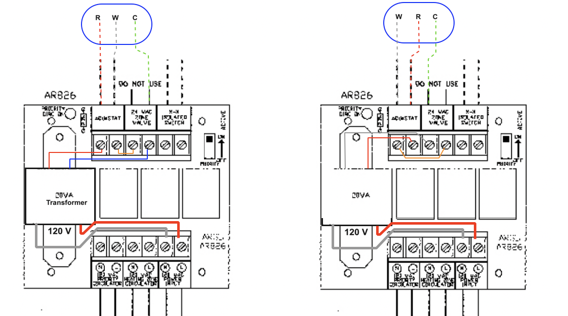

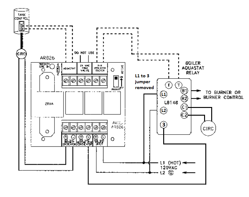

    So I believe this is what you did ? Not perfect… OOPS, I looked it over closer.
    Maybe it is perfect!!! I like it, I think it will work good. I'm surprised the original Argo documentation did not use that method. Very nice, I'm disappointed I did not think of it. Everyone learned something.

    I just noticed this. Typically L1 is the Hot wire (Black) and L2 is the Neutral (White).
  • Hello, good eye. I did swap hot and cold wire before rewiring. Yes, that what you show is effectively what I did! Your diagrams gave me that lightbulb moment!
