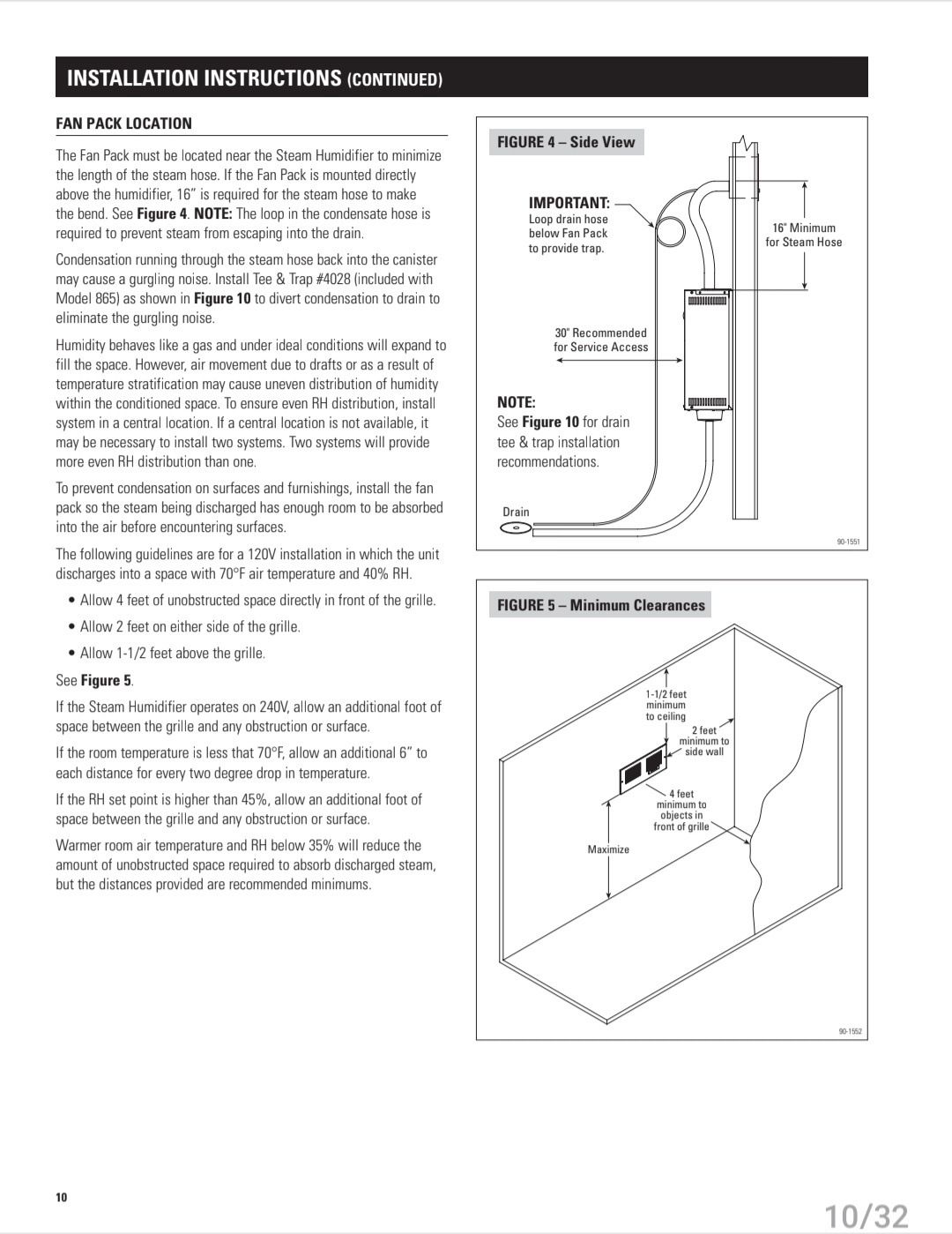

    i don't know but i can say the steam humidifier distribution box needs to move a lot less air than the evaporative humidifier because t is just moving it around, it doesn't need to keep the air at the plates dry enough to evaporate the water.
    the instructions for the fan pack claim 50 db

    With the 800, if there's no HVAC ductwork to install the steam tube, its going to need a Fan Pack.

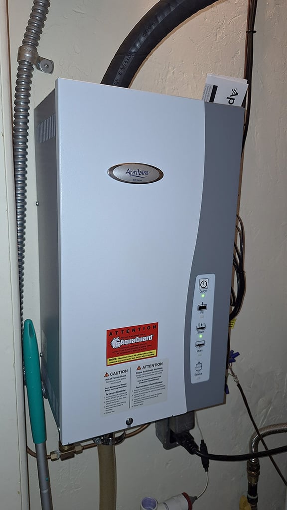

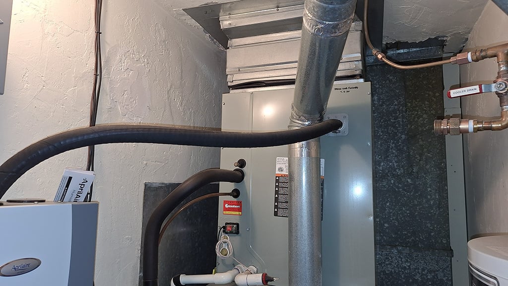

    We have enjoyed the Aprilaire 800 in our gas forced air system for 10 years. It's the best thing since sliced bread. Even with Tucson's mild winters, it's always very dry in the house.

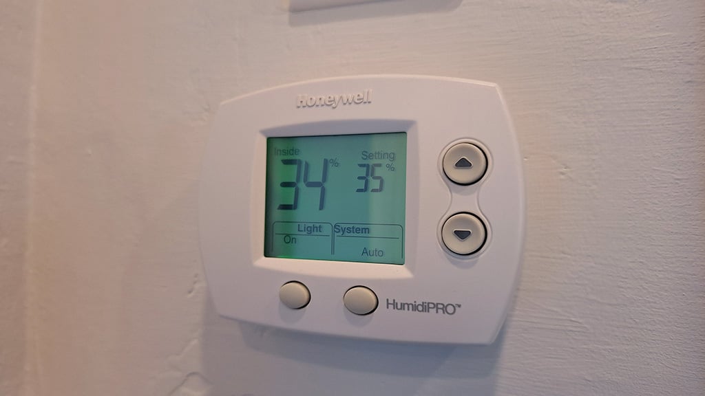

    Our 800 is set to boil the lowest amount of water for the 2200 sq. ft. single level house. Yes..., it uses a decent amount of electricity and I estimate ~$20-30 / month in the winter. The provided comfort is worth every penny. The canister only fully drains if there hasn't been a call for humidity in 72 hours or if the 800 is shut off at the control panel. From time to time, some partial draining does occur. With our use (humidistat set to 35%), the canister lasts 2 seasons. I change it before the system forces a canister change. The old "heavy" canister is full of calcium & magnesium.
    The insulated steam line gets hot and only steam is released into the ductwork (a bit above the evaporator coil). It should operate in a similiar fashion with the fan pack. With the fan pack, the 800 will run whenever there is a call for humidity. In our system, I keep the ECM furnace blower running at a low "air circulate" speed 24/7 (for air filtration). The 800 will run as needed without a call for heat. Even if I had the fan set to "auto", the 800 will command the furnace blower to start when there is a call for humidity.
    After 8 years, the soleniod controlled drain valve did begin to leak. Over time, the hot draining water eroded the non-replaceable plastic seat. It was a $400 part, but not a difficult job to replace.
    I can only say good things about the 800. IMO, it has first class design, engineering, and manufacturing.
