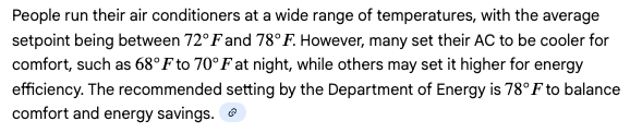

There are people out there, maybe on this list that run AC at 72.
A 72° degree tile floor when you step out of a cold shower feels like an iceberg.
So yes people with money to spend or warm toes desires run their radiant bath floors while the AC is cooling the room.
