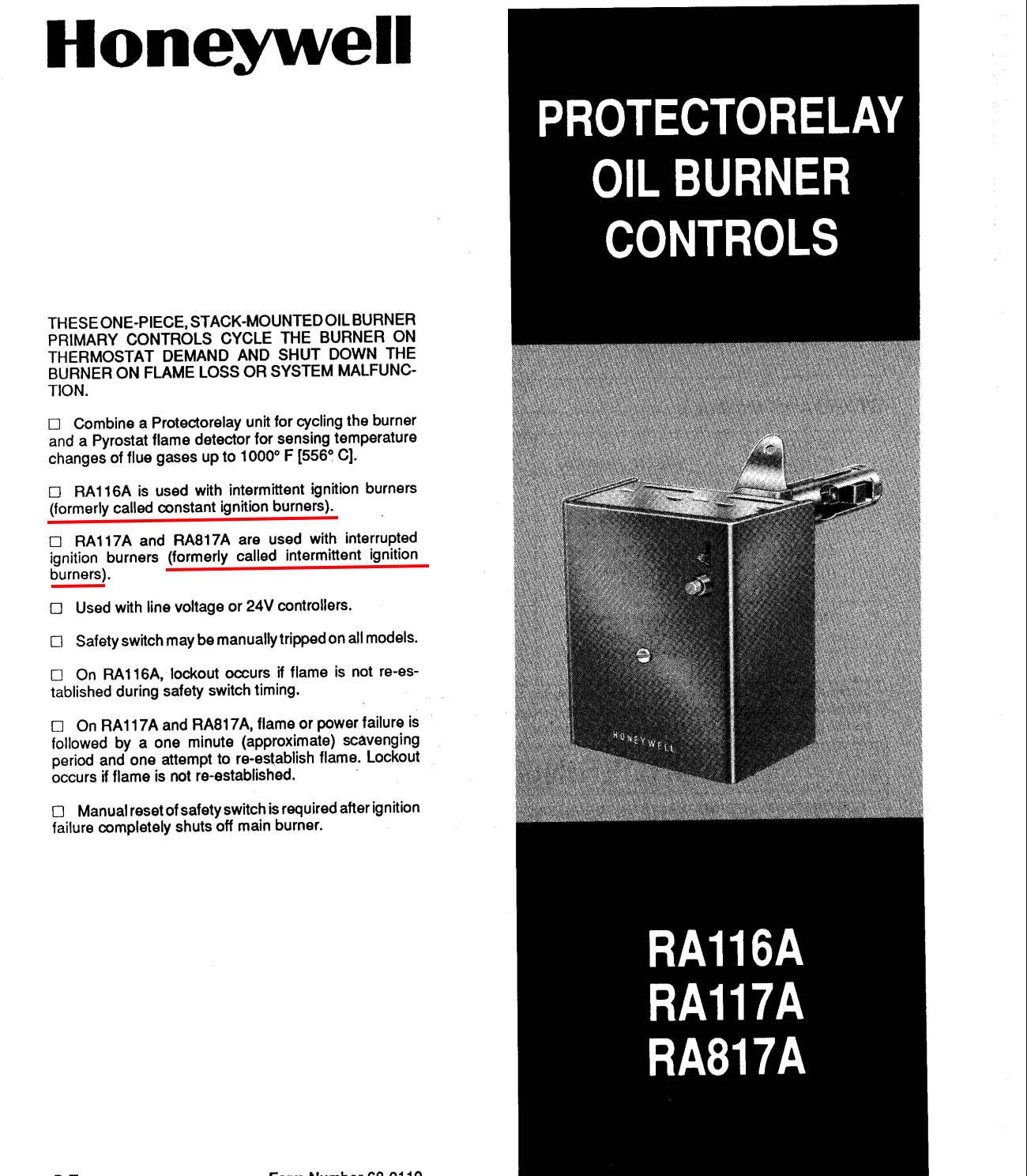

    75 years ago the oil industry was the king of home heating taking over from Coal from 100 years ago and older.   Since all the gas boilers and furnaces used standing pilots, that was just the way it was back 75 years ago, so it did not need a name like "constant ignition".  All the heaters had pilots.  The oil heat controls were set up so that the ignition transformer was always on with the burner motor.  That meant whenever the burner motor was on the ignition was constant.  So the RA116 stack mounted relay was used for constant ignition.  And it said constant ignition right on the box.
    Some oil burners operated better if the ignition transformer was not on the entire call for heat, so the RA117 Stack mounted relay was used to let the burner operate without ignition.  That was called intermittent ignition and it said that right on the box.  Once the burner flame was lit, the sensor in the stack dropped out the relay that operated terminal 4 and the ignition transformer no longer was powered, so no spark.
    Now fast forward from the 1950s to the mid 1970s and you have an energy crisis.  Gas furnaces were made with spark ignition and hot surface ignition and spark to pilot ignition.  And all sorts of other configurations. Some oil heat folks were also doing gas heat work and vice versa.  This became confusing so Honeywell and other oil burner control manufacturers decided to fix it.
    Now you have a constant ignition that is a standing pilot that is on constantly 24/7.  That was inefficient.   So constant on oil controls were not the same as constant on gas controls. But that was the way it all used to be, and we now need to call constant ignition on the oil burners where a spark is involved something else.
    Spark the whole time the burner is operating is now intermittent ignition (Formerly constant ignition) and it said that right on the new boxes of the R116A relay and any other control (like the R8184G relay for oil heat)  This was confusing for the old timers that only worked on oil heat but eventually they got over it, (or died off).
    Then there were gas controls that sparked or heated up only until the flame was proven, then the ignition dropped out as the flame continued to burn.  On oil burners that is now called interrupted ignition (formerly intermittent ignition)  and it said that right on the box for the RA117A oil heat control and many other oil heat controls that performed the same way.
    It has been long enough that the “Formally constant" and “Formally intermittent” are no longer printed on the box because all the old heads that remember the old names are retired by now.
    • Constant ignition = 24/7 ignition (standing pilot)
    • Intermittent ignition = ignition lit as long as the main burner is fired (spark to pilot or Spark for oil burner on the entire time the burner is flaming)
    • Interrupted ignition = Spark or HSI to get it started, then ignitor or spark goes off when main flame is proven.
    Hope this makes it as clear as mud!
