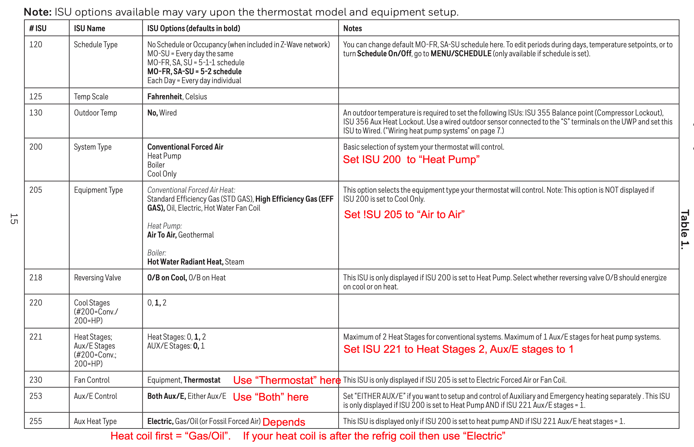

  • here is the Installer Setup (ISU) chart for the TH6320ZW2003 T6 Pro.
    Depending on your heat coil location tou will need to select the correct opetio for ISU 255.

    If you set the equipment type in the T6 to "Heat Pump", the selections for 220 changes to "Compressor Stages", which to simplify this for now I've set to 1, and the selections for 221 changes to "Aux/E Stages", which I've also set to 1. I have all others set the way you describe; 255 is set to "Gas/Oil".
