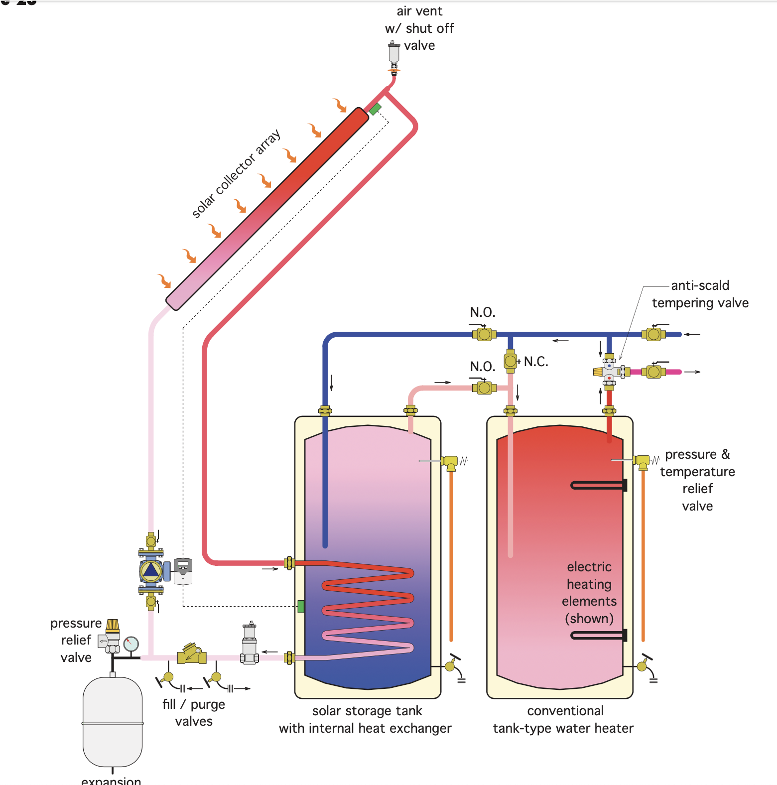

I need to replace two gas water heaters and I am thinking of putting in two SuperStorUltrMax s, with a 20 tube ThermoMax solar water heating system. The heated solar antifreeze will go through both systems. Of course, the first tank will get more heat than the second, but I'm trying to keep it simple. I guess I could put in a valve. Any advice would be welcome.

    Are these for preheat or are you getting the electric element version?
    During no sun conditions the electric element will not deliver what the gas fired tanks will
    I would consider one solar tank, series with a gas tank

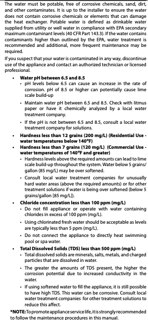

    Also test your water to be sure it meets the water spec for that stainless tank, here is the SuperStor water spec. The chloride spec is important with stainless steels.

    A typical 2-tank solar pre-heat piping, with electric of gas heater

    hot_rod Posts: 28,769
    the electric element in solar tanks is 1/2 the way up the tank, sometimes in the upper 1/3
    So when it is heated by just the element you get 1/2 the tanks capacity of hot water
    I would go with an 80 gallon tank so you get about 40 gallons of useable hot water
    another tip is to run the tank hot, maybe 150- 160 on the solar control, use a good quality mix valve set to 120 as shown in this piping. That way you maximize the solar and extend the drawdown
    If you have an evac tube array you nay get more solar than you need in the warm summer month
    Most of the digital solar controllers have over heat function in them, as well as evac tube settings
