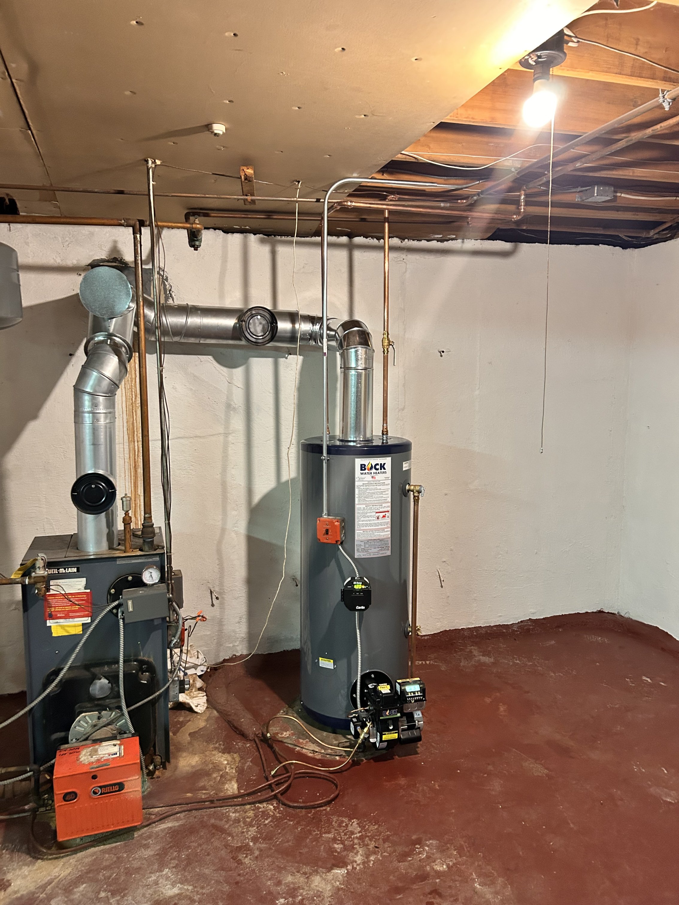

A couple weeks ago I replaced an oil fired water heater. He had an old John Wood 50gal with a Becket burner .75 70 degree nozzle. I put in a 32gallon Bock with the Carlin burner matched to it running a .6 60 degree hollow nozzle.
I don't work on oil equipment normally and wanted to do an indirect instead as the boiler has to maintain anyway (leaks when cold).  He wanted to go oil again with the understanding his oil company has to do the final tuneup on it. I put it in and did the limited setup I could. Zero smoke, you have to close the air shutter to about 15 to even get smoke. Factory sets it at 45 and doesn't want you to deviate more than five so I left it at 40. Draft is about -.25 to -.03 at the breach.
This thing has been locking out seemingly randomly. Sometimes it will last a few days, other times it will be a day. Always fires right back up. Anytime I check it it's loaded with errors for lost flame (for which it will reset) and one or two for failure to ignite (when he has to push the button). Oil company came out, moved the shutter down to .35 and said everything is fine
I replaced the entire burner due to a defective air tube which was welded at the wrong position clocking the whole burner to about 1. That rules out any bad components. I can't figure out what the heck is going on with this new one that wasn't going on with the old one. The boiler right next to it runs just fine as well.

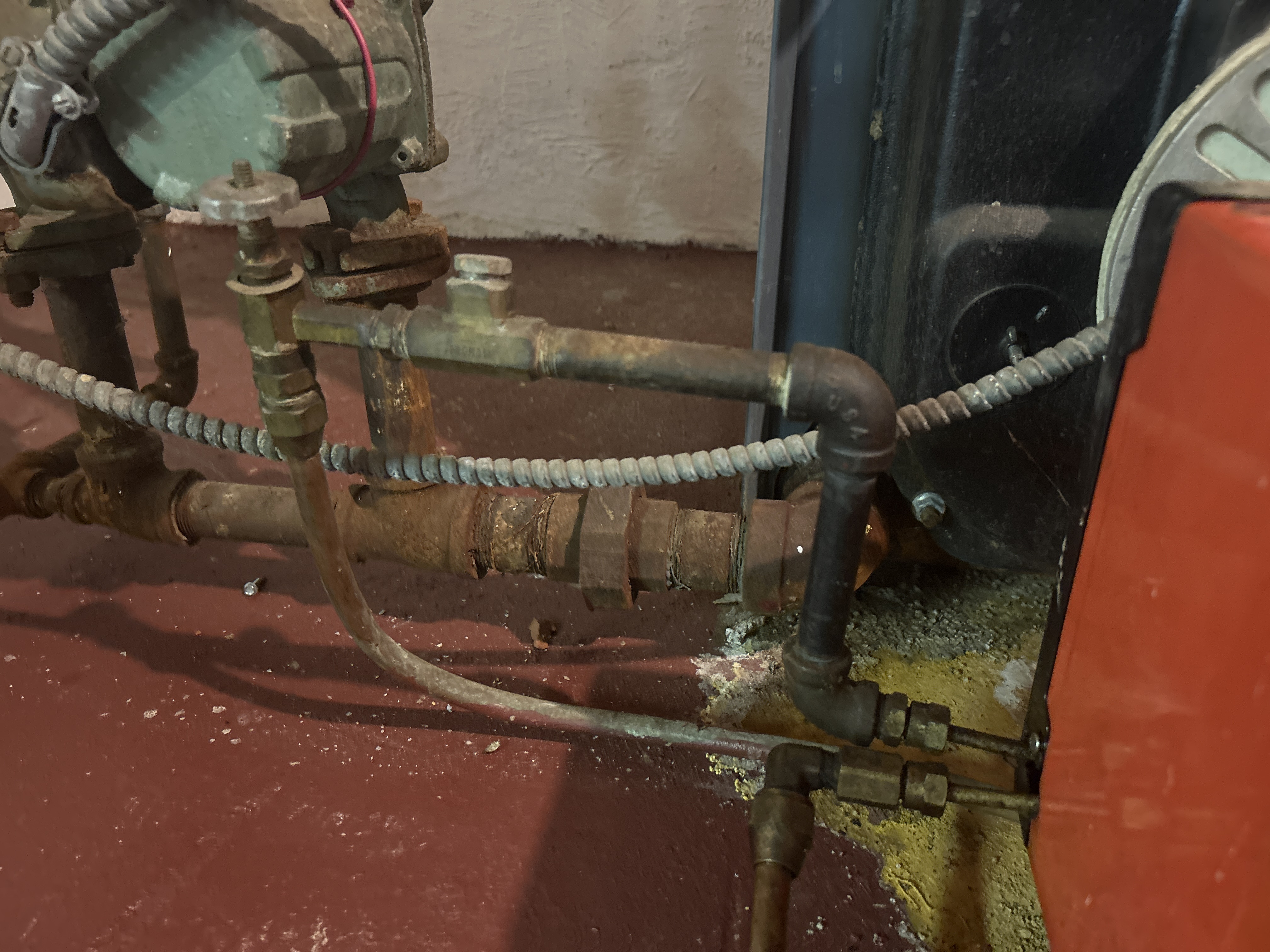

It's a two pipe oil setup (yes the plug is in).  1/2" lines run to the boiler from the underground tank about 70' away with 1/2 x 3/8 tees about 2' from the boiler for the water heater. The boiler has a Riello burner and a 1.0 nozzle. Ive sat there for an hour with this thing running and no issues. The boiler fires while the heater is running and vise verse, no issues. I've thought about putting a tiger loop on the water heater to try and rule out the boiler possibly pulling the oil from the water heater when it doesn't run for a long period. I feel like it would have to be bleed if that was the case and not fire right back up I also don't love the smoke pipe setup though the old heater ran fine with it.
Here's a photo incase I'm missing something glaring here.

    Two burners on a two-pipe system is no good.
    One burner pump will always be stronger than the other. One burner runs it pulls oil from the other. A separate suction line for each burner is the way to go. If you have little to no lift it might work but if you have lift you will have issues.

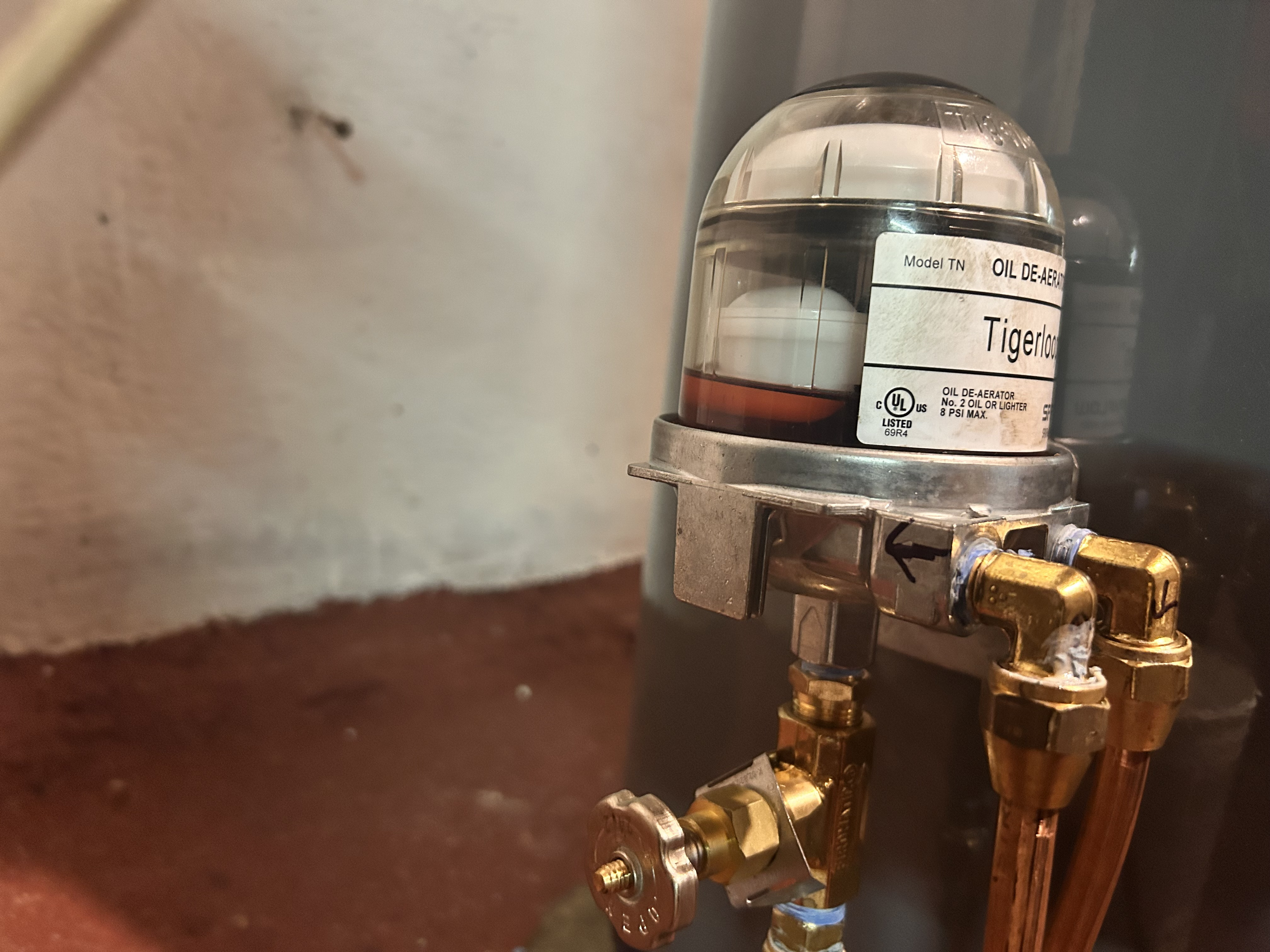

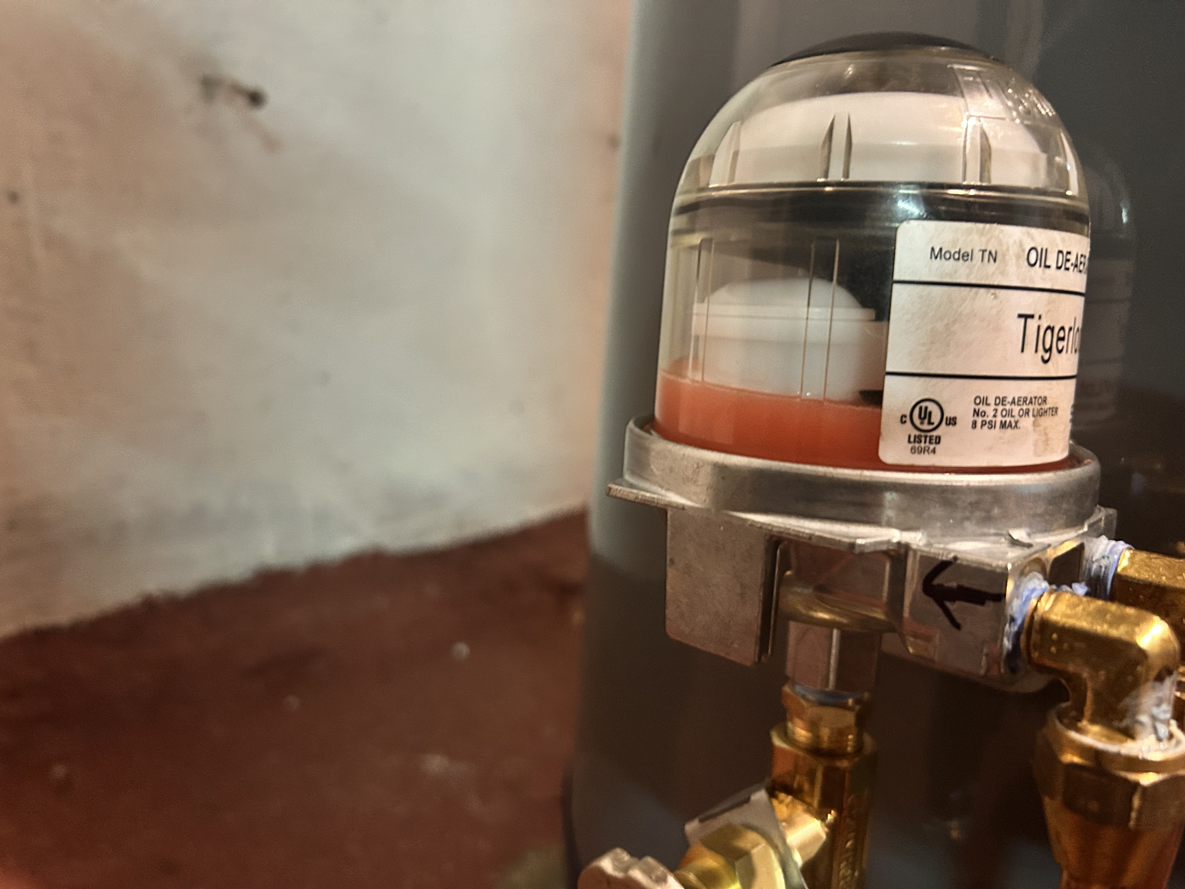

    So the tiger loop is on the water heater. Kind of interesting to watch it now. First pic is with the water heater running. Second pic is with the boiler and water heater running. You can watch the color change as the boiler cycles on and off.

    The lower lighter colored picture looks like air in the oil to me.

    It certainly is air in the oil. Somehow it gets kicked up when the boiler runs.

    On another note. I found out the chimney liner went in right before the heater change. That 7" reduces down to 6" in the wall. They also capped the chimney with a ventilator for some reason.
