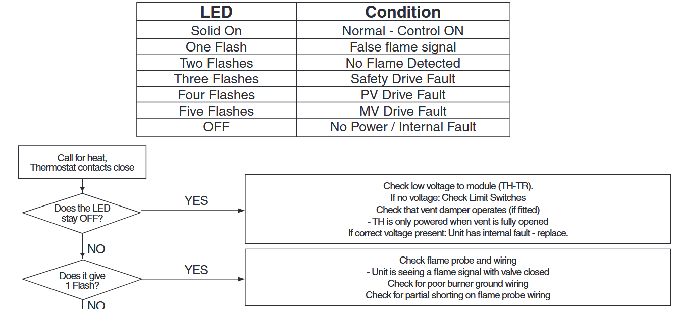

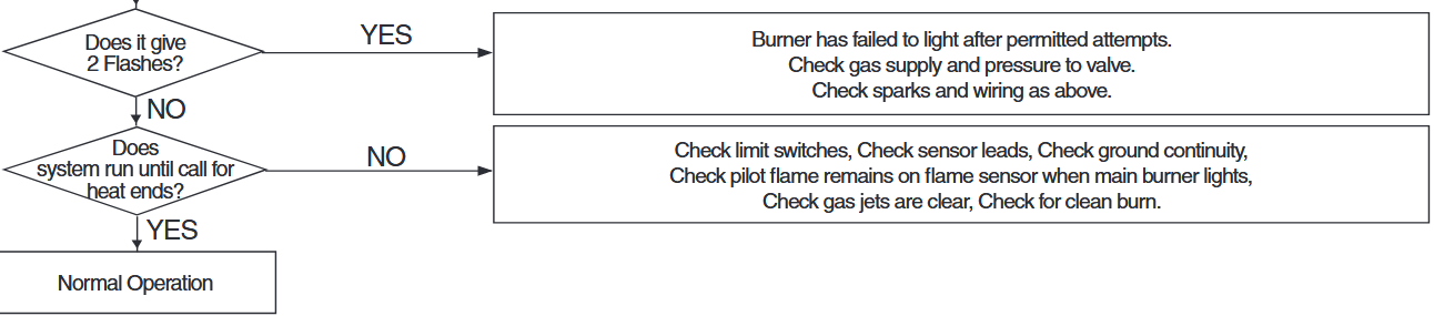

    Really to troubleshoot it correctly and give you good direction, you need to catch it in the act of creating the error.
    Is the flame actually lit when it should not be.
    Or
    Is the module erroneously detecting a flame when there is none ?
    Boatster
    If you go to the Laars website, you can download the manual if you don't have it. i read it and it doesn't tell you much of anything about faults.
    And I don't know if the new manual applies to your older boiler.
    From what I can see you have an ignition electrode that sparks to light the pilot and also acts as a flame sensor.
    Those things are pretty bullet proof as far as flame sensing. I have never heard of a flame rod type sensor giving a false flame signal.
    The only thing I can think of is the pilot valve in the gas valve could be leaking by causing the pilot to stay on.
    I would run the boiler and then shut it down and see if the pilot goes out immediately or hangs on.
    You might disconnect the pilot tubing from the gas valve with the power off and see if the valve is leaking gas out the pilot connection

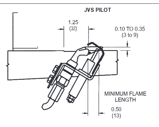

    I'd inspect the high voltage wire and clean the insulator at the pilot assembly.
    Boatster
  • @109A _5 I was down there recently when it tripped. The boiler had been on and then it just fell silent except for the pump continuing to run after the flame went out. I looked over and the single red light blink for 'false flame' had come back on.
  • @EBEBRATT-Ed Those are good ideas. You were very helpful in Jan '24 when this was happening before. I just replaced the gas valve two weeks ago but will check the other places you mentioned for leaks. I also ordered a new pilot assembly. I'll try cleaning the existing one (installed 2021) and if that doesn't solve the problem I'll swap in the new one.
  • @mattmia2 We checked all the wiring and found no shorts or physical damage. The insulator seems to be fine, too, although we did find that the pilot assembly from 2021 was installed crooked with screws that were too long. Fixed those issues but still getting this never-ending 'false flame' message.

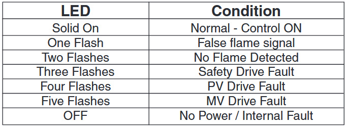

    You might want to call Laars. I don't understand at all their reasoning behind a "false flame" light on a system with a flame rod. It doesn't make sense.
    I have worked on every kind of flame detection system made.
    Cad cell, stack switch (heat), photocell, lead sulphide and ultraviolet work on oil.
    Flame rod, ultraviolet and lead sulphide work on gas.
    Of all these different systems the flame rod (like you have) is considered to be the safest (although not the most reliable IMHO).
    The reason for this is it is pretty much impossible to get a flame signal without a flame as the flame circuit current has to pass through the flame itself.
    I see where the info @109A_5 posted above they say to clean and inspect the flame sensor. You can also run a separate ground wire from the pilot back to the control
    Since it worked for a while, this probably isn't the issue but it looks like the control can be set up for direct spark which I would think would be constant pilot and it would only spark when there is no pilot. Or intermittent pilot which the pilot would light each time the boiler starts. It gets confusing.
    Just wondering if you think the set-up is correct.
    Maybe White Rogers can help.
    maybe the dip switch or whatever selects between the 2 is intermittent.
    the way you could truly get a false flame signal, if it actually looks for rectification through the pilot vs simply conduction, is with a connection of the sense wire to something corroded that acts as a diode like the cat's whisker on a crystal radio. It happens pretty commonly in antenna systems, something corrodes and acts as a diode which mixes some other signal in the area with the intended signal and produces a mixing product on some 3rd frequency.

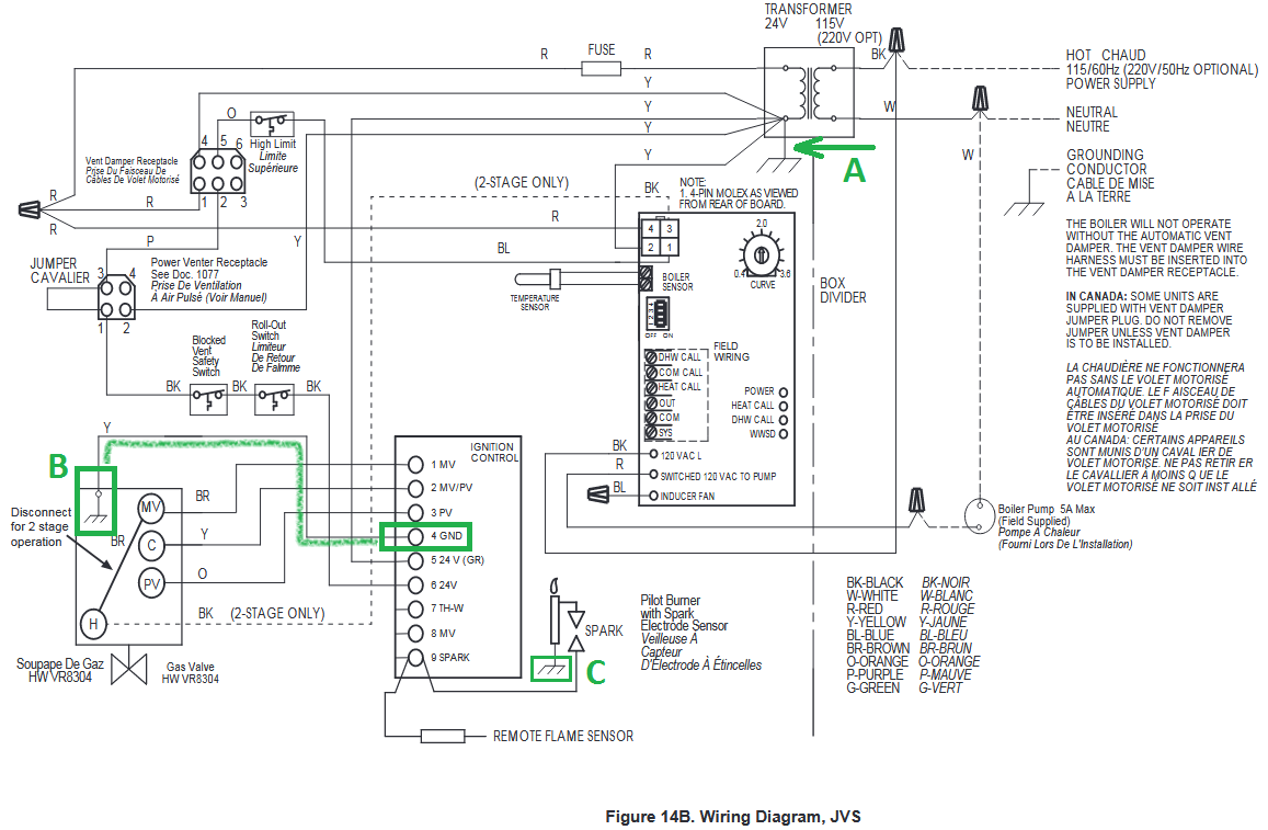

    I'm wondering if the ground integrity (ignition module or flame sensor) changes when things warm up. Agitating things (by replacing things) can temporally heal things, but the problem usually comes back. Bad crimp connections and other mechanical connections are notorious for this issue.
    109A_5 Posts: 4,759
    edited December 2025

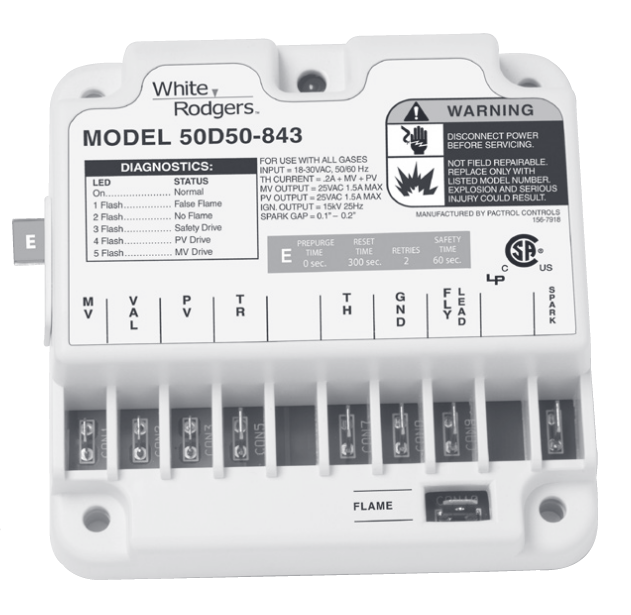

    From this wiring diagram the Ignition Control Module is grounded at the gas valve assembly. That point 'B' has to have a good connection back to 'A' for proper operation. This connection may be via the boiler jacket and other mechanical means, since the wiring diagram does not show a dedicated wire for that path. The Gas Valve solenoid coils are grounded through the Ignition Control Module (2 MV/PV then to 4 GND then to 'B'). The flame detection return path to the Ignition Control Module is also via 'B' to 4 GND (Ignition Control Module). If the path integrity is not sufficient the flame signal could be modulated (or corrupted) by the AC voltage drop from the gas valve solenoid current through the poor connection. This condition may result in the Ignition Control Module shutting off the burner and triggering a fault event. The ground path integrity is important, often overlooked and awkward for some folks to test.
    This picture of the 50D50-843 and the wiring diagram don't quite agree. So the the gas valve solenoid ground may be separate, I'd still verify all the grounds are in good condition. Maybe the two ground wires are reversed ? Assuming TR is actually a ground as the 50D50-843 manual shows.

  • @109A_5 The wiring diagram you show is from the more recent Teledyne-Laars JVS-225 manual. I've been referring to that but also to the White-Rodgers 50D50-843 ignition control module manual since most of the wires come from there. That unit actually has four different wiring diagram variants (first PDF attached) and my system seems to be wired as in Fig. 4., which is described as a "typical hookup for White-Rodgers replacement with direct flame sense through single spark/sense probe" as opposed to separate flame-sense and spark probes. Then I have wiring diagrams from the manual (second PDF attached) for the White-Rodgers 36H series gas valve that was installed two weeks ago — a general one (Fig. 4 on p.5) and a more specific one (fig. 6 on p.6).
    So I went down yesterday to do a quick wiring trace and this is what I came up with for the ACTUAL wiring from all eight ignition control module (ICM) terminals to terminals on gas valve (GV) or elsewhere.
    - fm MV on ICM, brown wire to H1 on GV. (Looks correct, but should the jumper wire be connected when it has a sticker on the wire warning not to use it with spark-to-pilot systems?)
    - fm VAL on ICM, yellow wire to C (Common) on GV. (Is that GV terminal same as GND? Seems to be based on fig 8 in GV manual.)
    - fm PV on ICM, orange wire to P (pilot/redundant) on GV.
    - fm TR on ICM, thicker yellow wire to nearby terminal on a transformer.
    - BLANK SPACE
    - fm TH on ICM, thick red wire to terminal in box to left of ICM.
    - fm GND on ICM, green-then-yellow wire to ground on GV.
    - fm FLY LEAD on ICM, short black wire jumper to FLAME terminal just underneath on ICM.
    - BLANK SPACE
    - fm SPARK on ICM, very thick red wire to pilot spark/flame sensor assembly inside boiler.
    So you can see why my head is spinning. But it also seems to me that the problem easily could be either something mis-wired or one or more of the wires has gone bad. I'm particularly worried about the high-voltage ignition cable, and whether it's lost integrity, and the grounding wires.
    Finally, your explanation for how ground integrity can be impacted by a warming system really has my attention. The boiler will heat fine for a few hours now, then I get the false flame blinking red light and have to reset. It used to be I could go a few days between resets. So it works for a while then doesn't — and that interval has been getting much shorter recently.

    That is a complicated control. From what I can see I think your wired right. Might try changing the ignition cable. have you ever checked your flame signal?
    I thought you had but after rereading I don't see any mention of it. Maybe if you checked that you would see if you are getting a flame signal when you shouldn't have one. Looks like the control has test pins to check the signal
    If you look on line WR has an ap you can download to your phone. Its supposed to be able to tell you haow the control can be configured and has troubleshooting information
    109A_5 Posts: 4,759
    @EBEBRATT-Ed Its not a 50D50U-843 its a 50D50-843, confusing.
    @Boatster Still reviewing your data.
    109A_5 Posts: 4,759
    "- fm MV on ICM, brown wire to H1 on GV. (Looks correct, but should the jumper wire be connected when it has a sticker on the wire warning not to use it with spark-to-pilot systems?)"
    Well it is a different gas valve. The one wiring diagram shows the Main valve solenoid connected in parallel with the second stage solenoid. The new valve document seems to show it unused in a single stage situation.
    I believe this jumper should be removed, if it exists.
    In general it seems the 50D50-843 appears to be wired correctly.

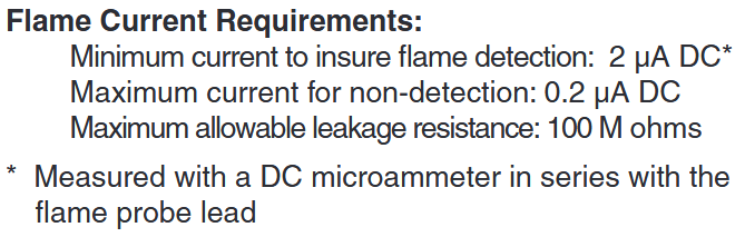

    If your meter can measure microAmps. I'd be very curious about this;

    Sorry to hear there is no good resolution. You don't live near an AM broadcast transmitter or some other odd device or situation that could cause interference with the ignition module ?
