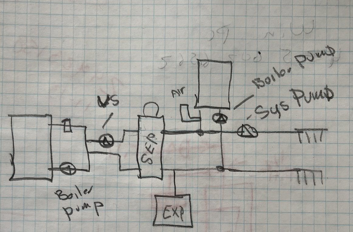

So I have been bothering poor Hot rod with this and he as always has been very helpful. I am putting this out here in case others have been through this or have good ideas.
I am finally getting to the point where I can start building the boilers for the 50x100 building. It's got all 5/8 tubing in the slab. The customer has a lot of waste oil so they would like to heat the building with it. So it will be a energylogic waste oil boiler and a condensing boiler as back up. The ignition control on the burner of the waste oil has and alarm so I was going to tap into that to bring the gas on when the waste oil locks out. The waste oil is primary and will do the majority of the work, but when or if it goes down the gas will back it up.
I am thinking I would like to do an injection style setup and use a tekmar 356 I attached my idea, so let me know any issues you see. The mix control is not on the pic but it will be there, the feeder and expansion are also not there, as well as the multitude of misc, just a rough draft.

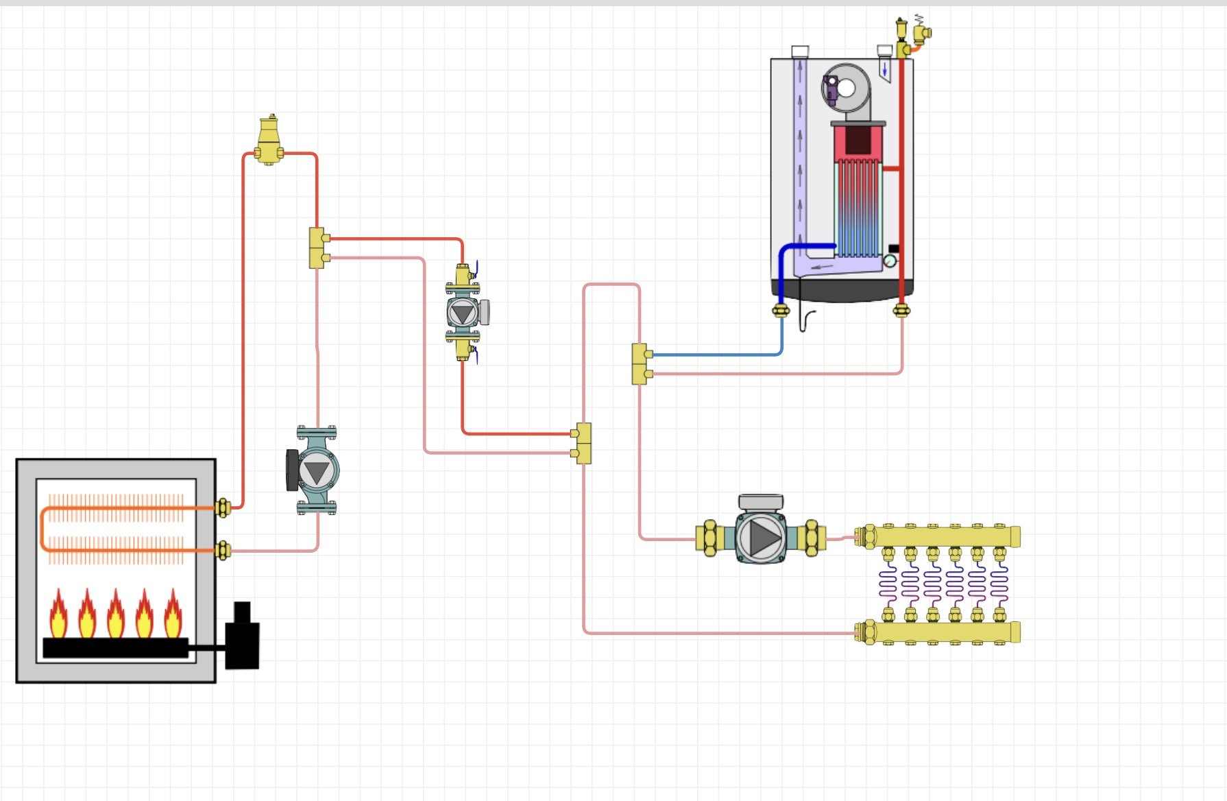

    That works.
    Or use a sep to get air, dirt, magnetic and hydraulic separation. It gets you a couple more gallons of buffer for the waste boiler.
    Maybe an additional air sep under the mod con.

    Thats doable as well! I kind of like the Condensing boiler on closely spaced tees, I guess Im just a little nervous of flowing through that boiler when i dont want it to? Probably not a real problem.
    I also assume by doing this I dont have to worry about a thermostatic 3 way on the waste oil? The tekmar should keep the temp going back to the boiler from getting too cool.
    Since this will be a big COLD slab, would a reverse injection be better to try to keep the water coming back to the waste oil warmer?
    Tom

    A check in the mod con pump, a second on the supply side would give you 100% flow stop through the mod con.
    Close tees always has some blending, piping the boiler direct to the floor assures the lowest possible return temperature for highest condensing efficiency. It should run high 90% with radiant return temperatures.

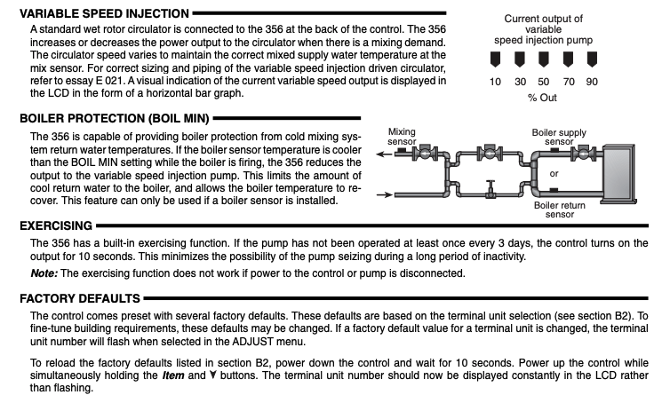

    Yes tekmar does show how to use the sensor location and programming for boiler return protection
