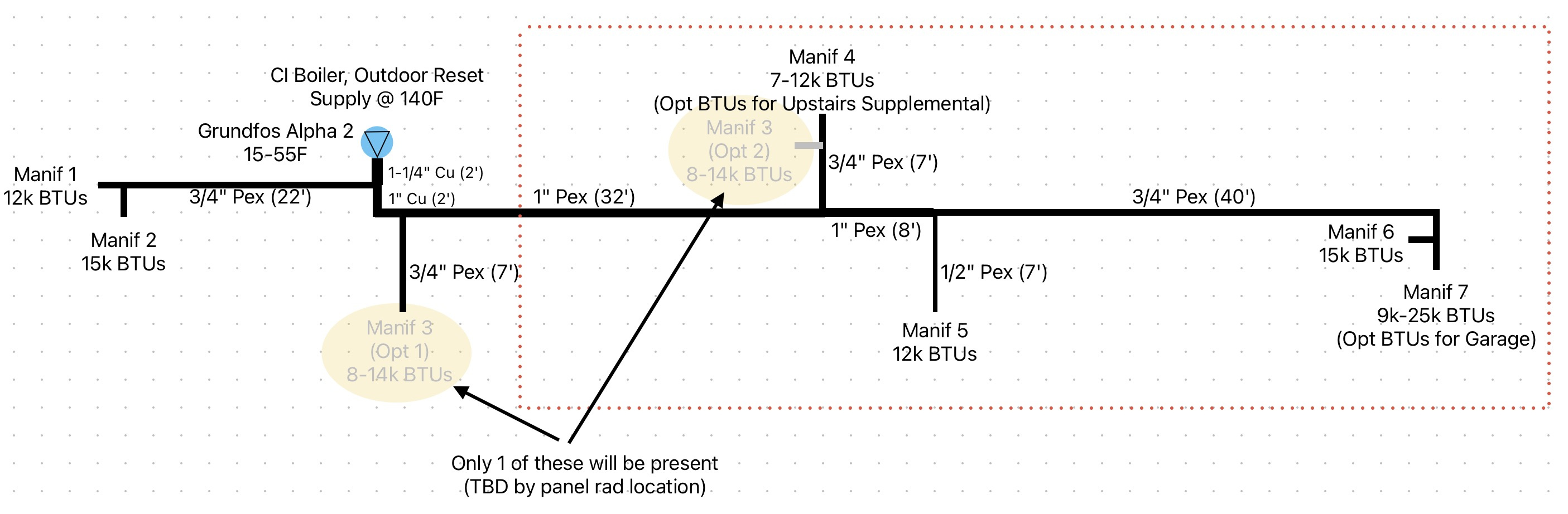

I have some design questions relating to the two temp system I'm installing with the rebuild of our home. There will be some radiant floor upstairs and panel rads downstairs and possibly upstairs (where supplemental heat may be needed).
Backstory is I put the distribution and manifolds in the 50% below grade basement several years back, and the basement didn't get finished. With HePEX left exposed to UV, I'm now replacing it, and the heating plan has now changed, which has been a cluster. I greatly appreciate your support on this!
Q1: For the below manifold supply design for the mid-temp, are changes needed, or the supply oversizing in a couple locations fine? With 12F temps forecasted for tomorrow night, I need to reinstall the section in the red dotted box today (already removed).
    hot_rod Posts: 28,705

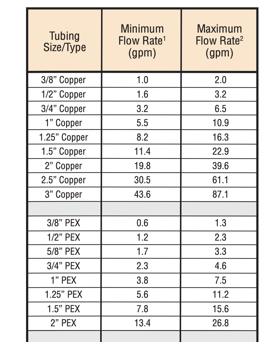

    to make the math easy turn btu into gpm to size tube
    Manifold 1&2=27,000 btu/hr. running a 20 ∆ divide by 10,000 so you need 2.7 gpm 3/4 pex is fine.
    You largest combination is
    garage 25,000
    manifold 6. 15,000
    manifold 5. 12,000
    manifold 4. 12,000
    So 64,000 6.4 gpm 1" pex can move 7-8 gpm or so without a problem
    No if you chose to run a tighter delta maybe 10- 15 on the radiant, then you need more flowrate. I think you have enough wiggle room in all your sizing examples.
    Max. flowrate is at 4 fps feet per second velocity, a comfortable flow rate for pex.

    Thanks @hot_rod ! Yes, 20deg DeltaT. I wasn't sure if any of those supplies to the manifolds needed to get necked down, for pressure equalization or not. For instance if manifolds 6&7 needed to go to 1/2" where they tee off, or if manifold 3 needed to go to 1/2". It's been a while since the initial calcs, so my memory is a bit rusty and this was a good help.
    It sounds like overall I can re-use the brass fittings as-is, and not worry about any additional reductions. I'll come back with some related more nuanced questions, but for now, gotta go install :) Thank you.
    Edit: The 12,000 BTUs for the garage on M7 are only when-in-the-shop use, so that also gives some wiggle room.
