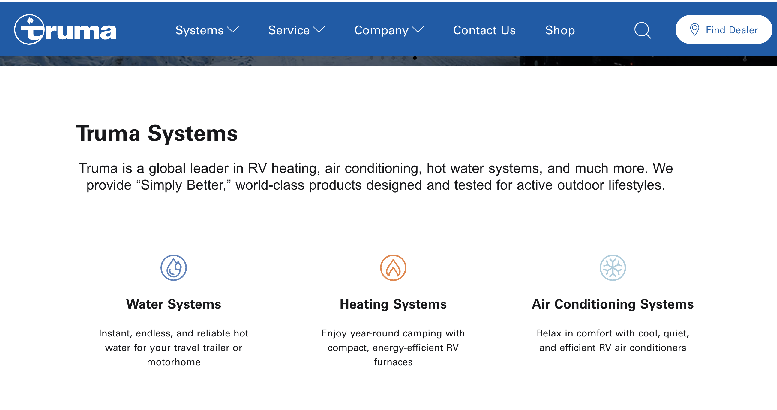

    hot_rod Member Posts: 27,705
    edited November 2025
    Look to the boat, Dickinson Marine and RV industry for gasoline and diesel heaters in small sizes. You will find air, hydronic and some combined heaters for DHW and heat.
    There are also some wood fired versions. I have. Cubic Mini wood burner in my camper, originally designed by a sailer for his boat.
    Screenshot 2025-11-28 at 8.26.10 AM.png Screenshot 2025-11-28 at 8.26.59 AM.png Screenshot 2025-11-28 at 8.27.43 AM.png
