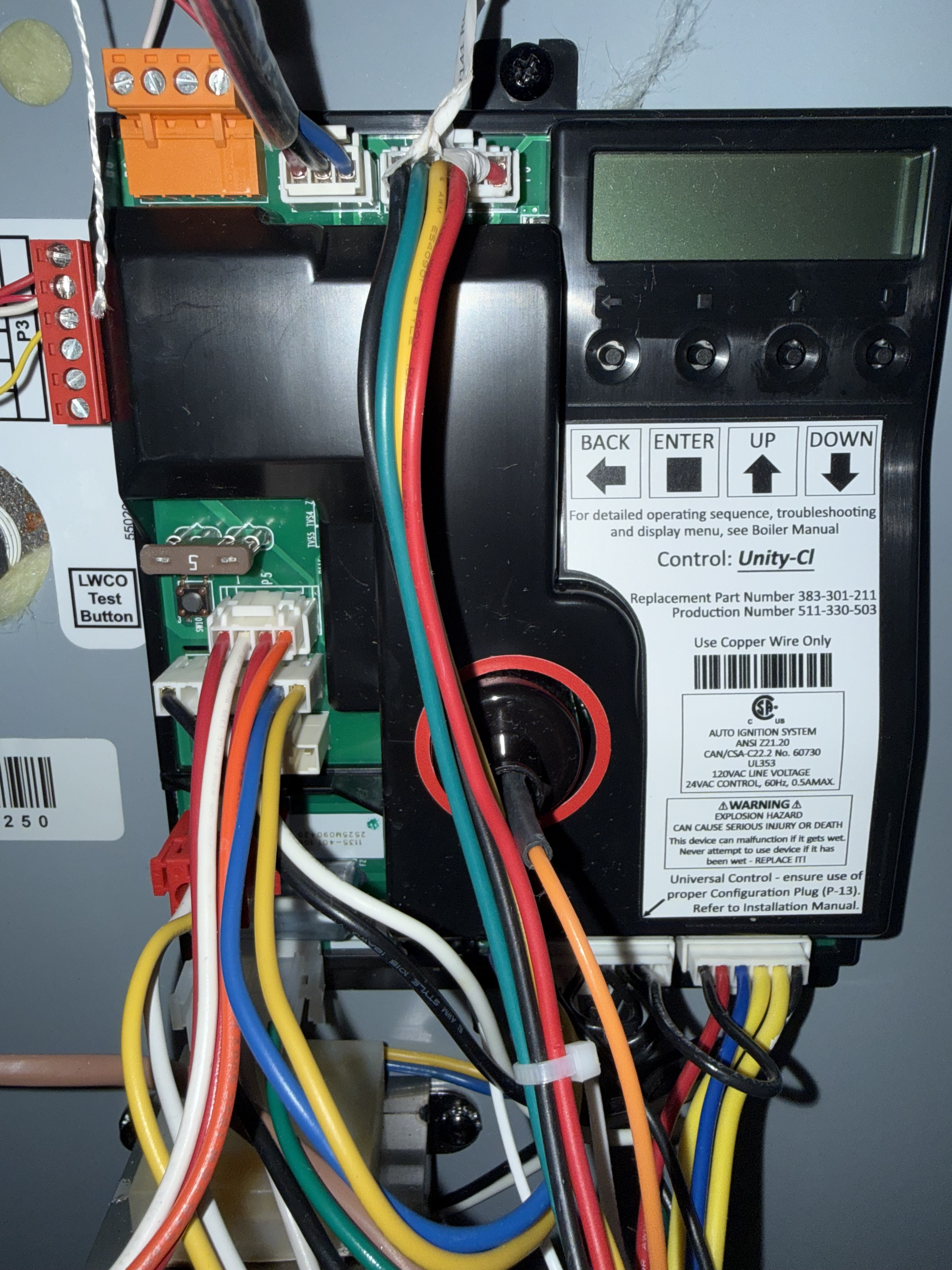

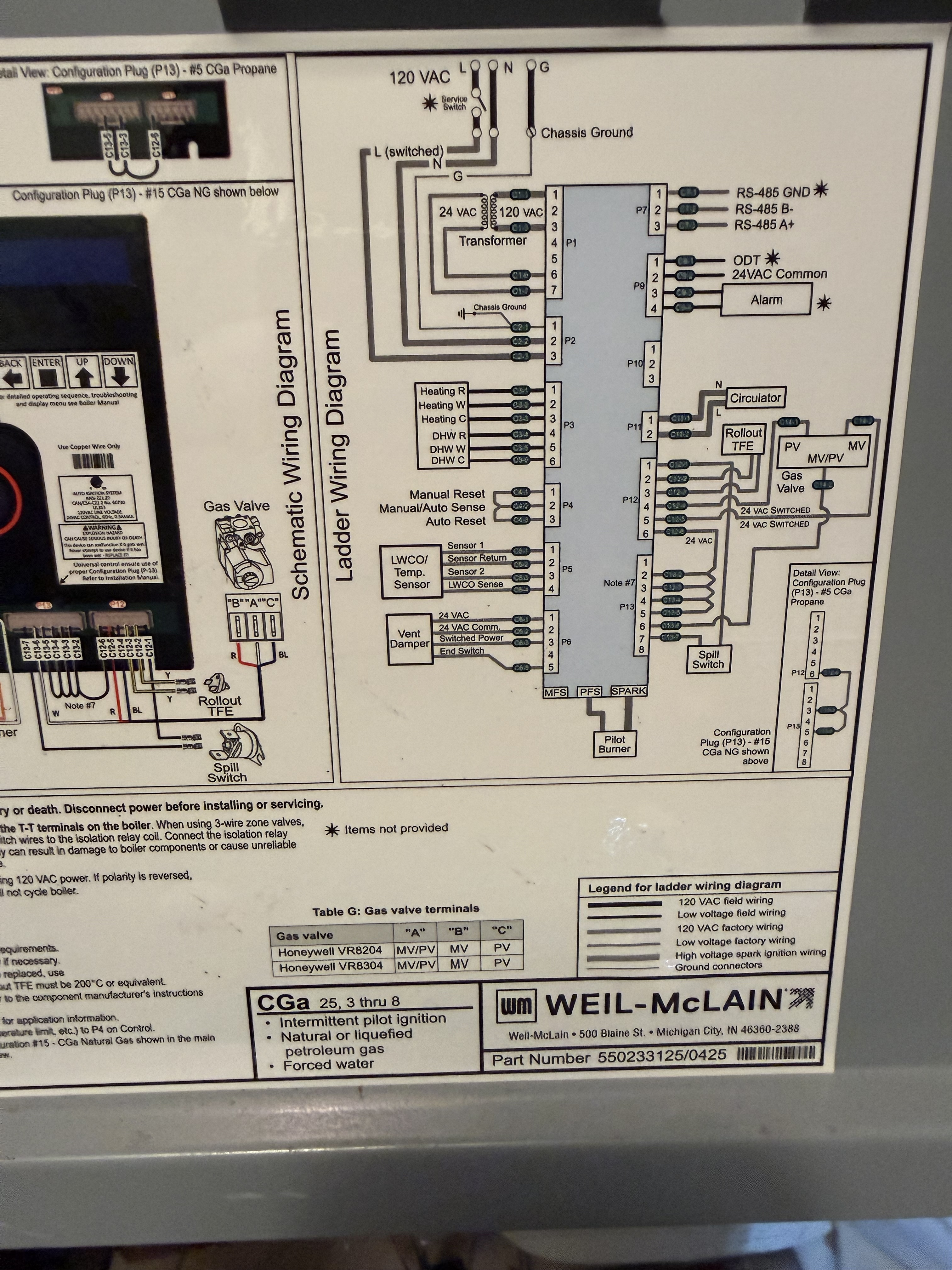

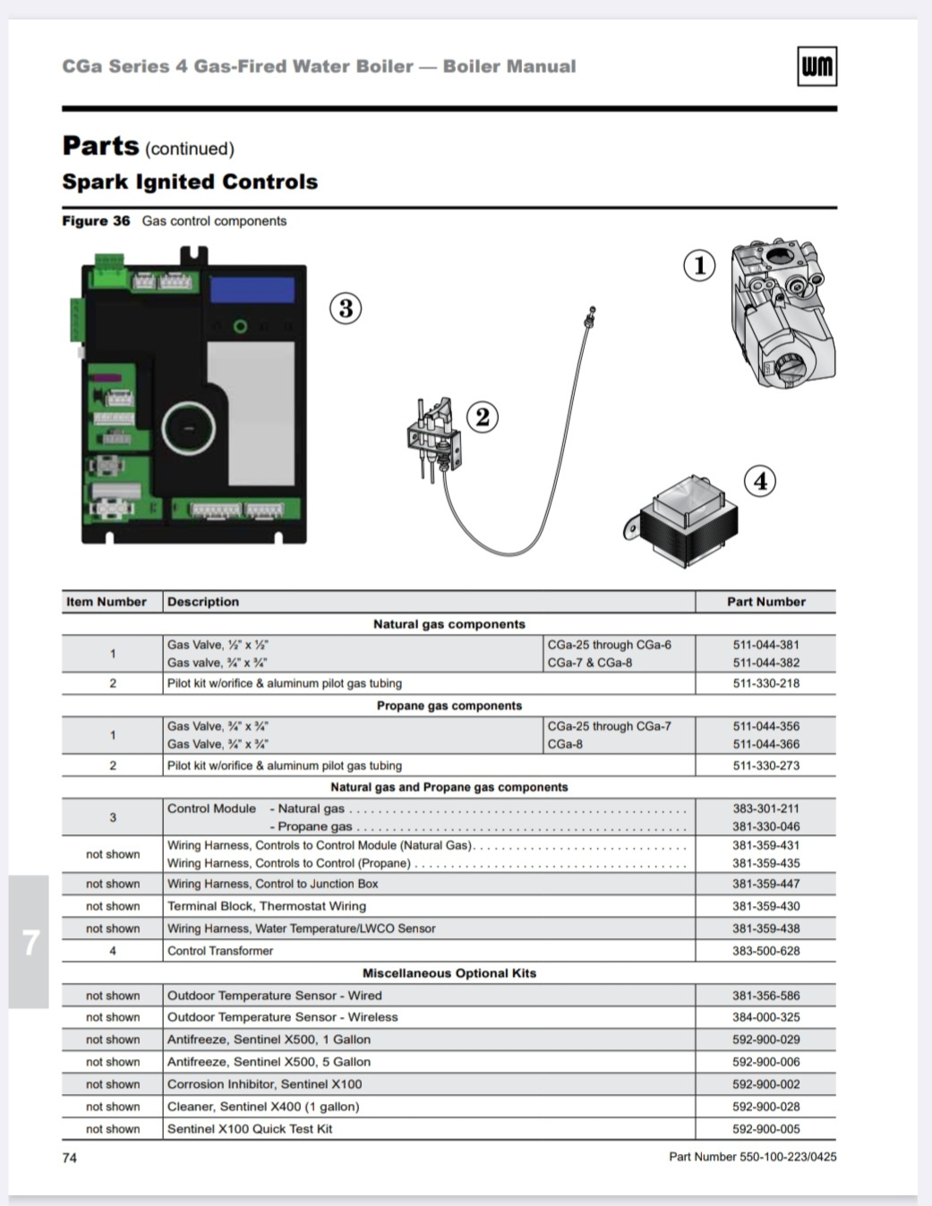

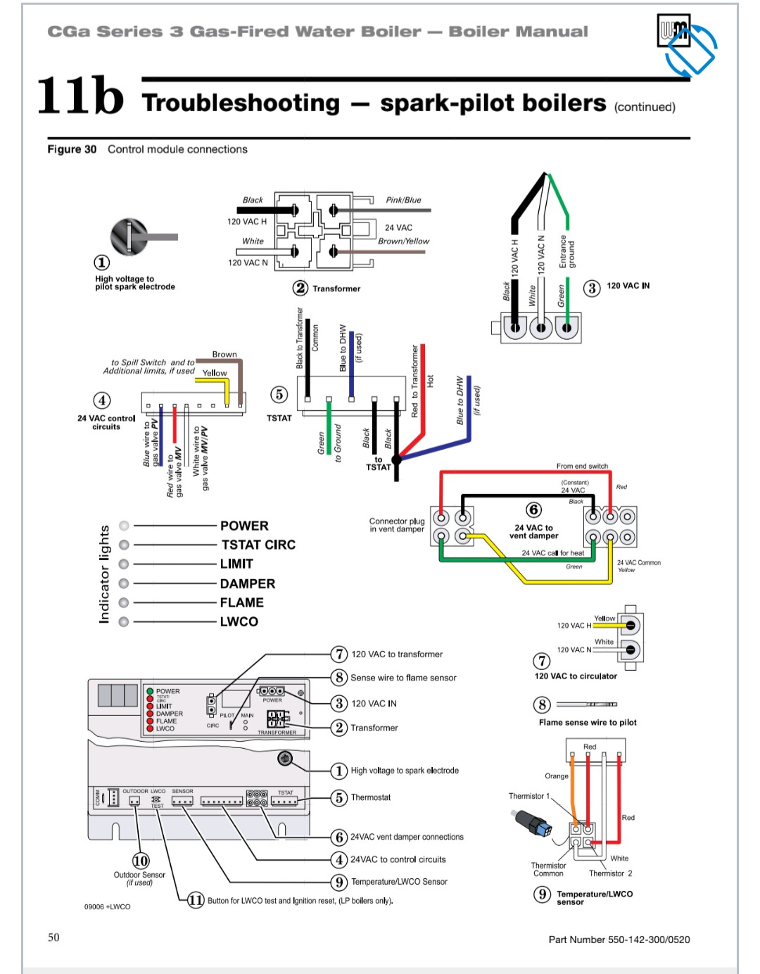

Hello, I am having difficulty finding information on how to connect the Outdoor Temperature Sensor Kit, 381-356-586 to CGa4-PIDN series 3 boiler control unit. There is no drect plug in where I can connect the harness provided with the kit and there are no instructions how to connect it. I have not found any information whether an outdoor reset kit is also reuqired. From what I could find, it would seem I should be able to connect the sensor to the contiol unit directly.

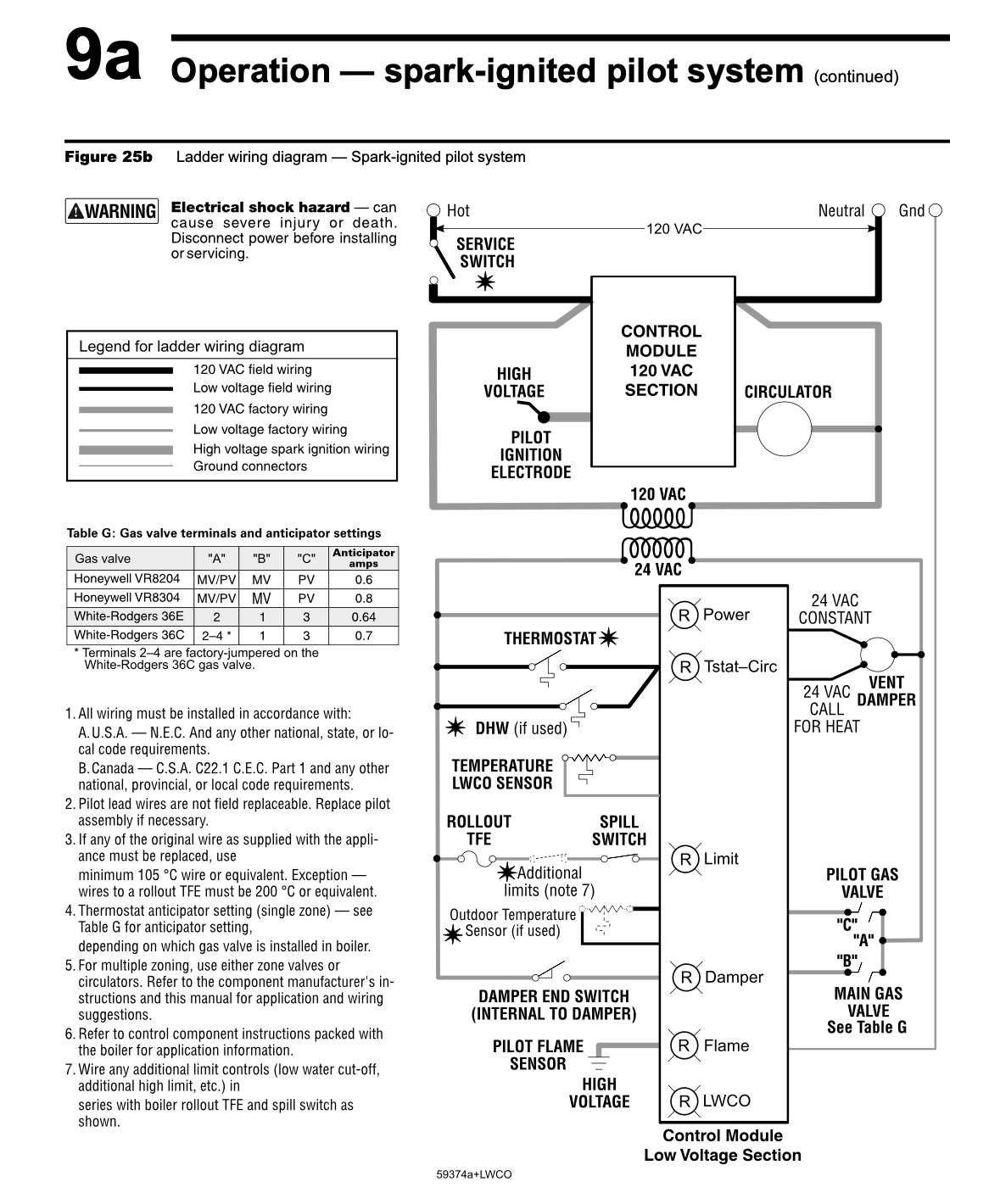

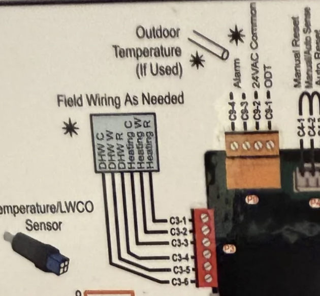

The control unit has ODT terminal for 1 wire which seems to be outdoor temperature sensor at C9-1 (same as P9-1 on the other wiring diagram), but I have no idea where I should plug in the second wire and whether C9-2 24VAC Common is the right spot (same as P9-2 on the other wiring diagram). Or I may be misreading the diagram all together.
Any heklp is apreciated and I am including pics of the diagram and control board.
Here is the manual diagram, there is no connection to the harness on the control board:

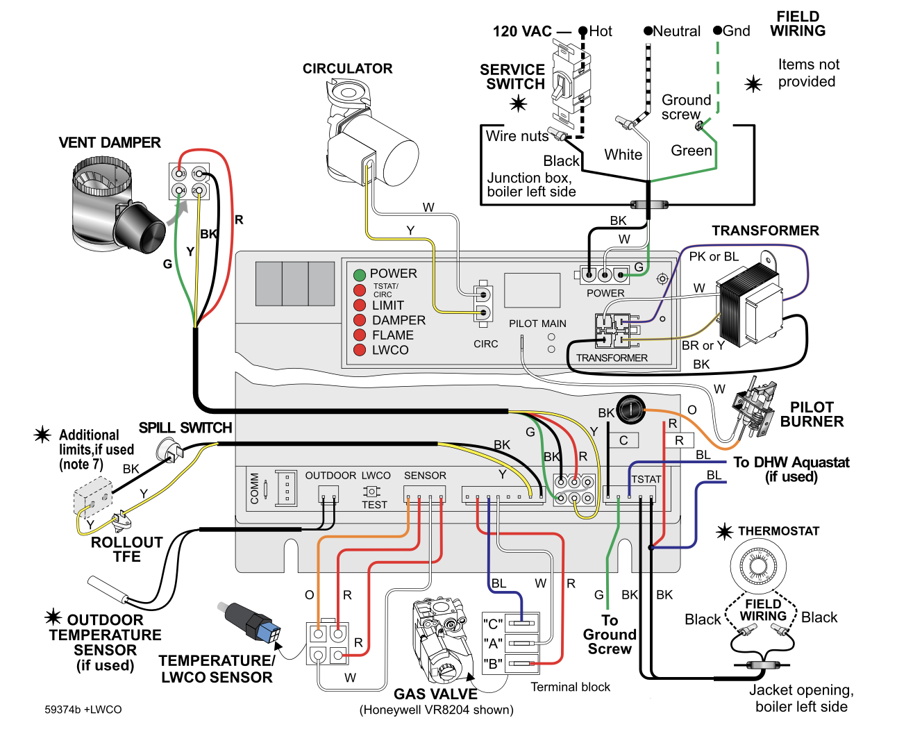

Here is the diagram from the boiler

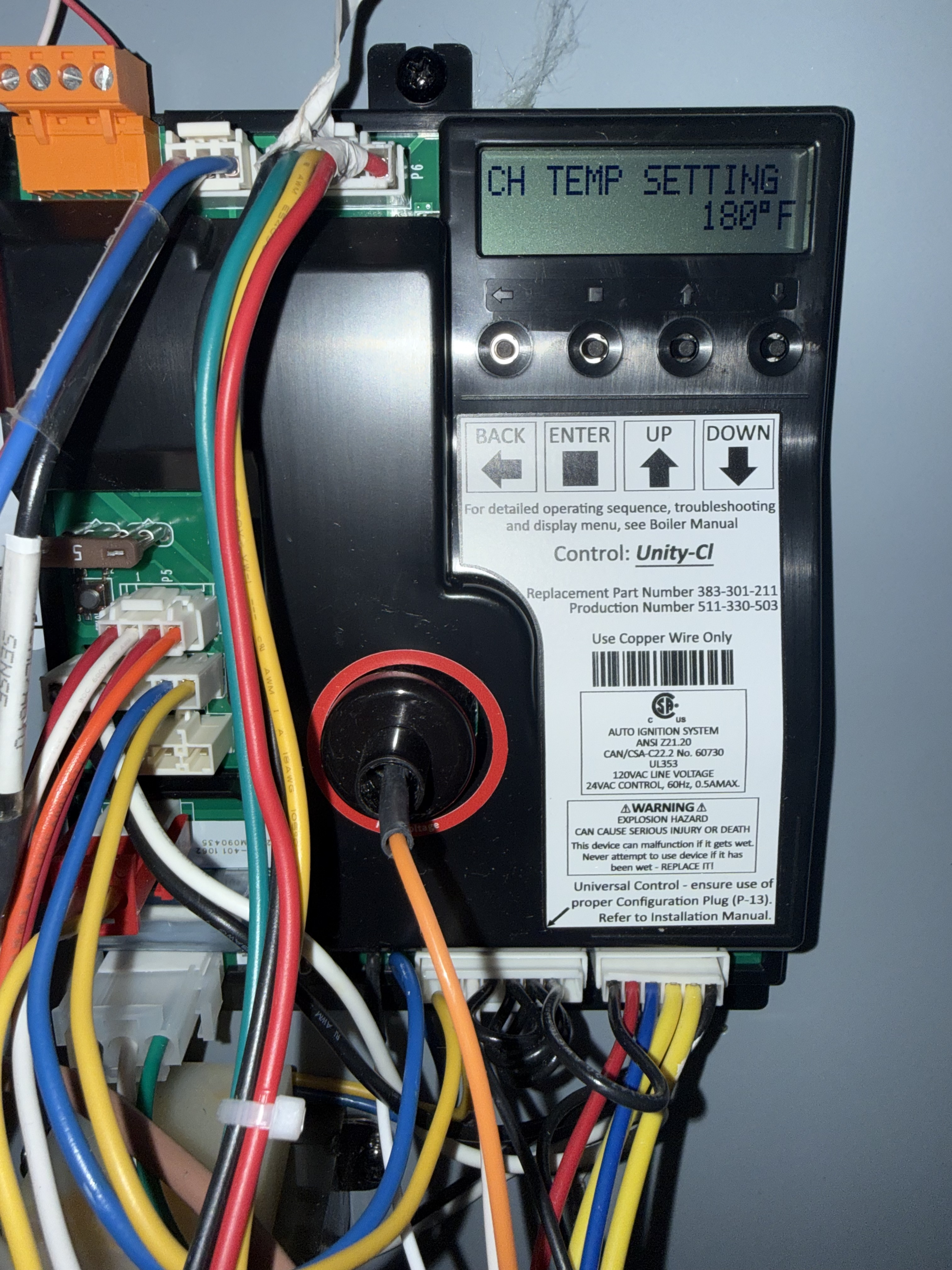

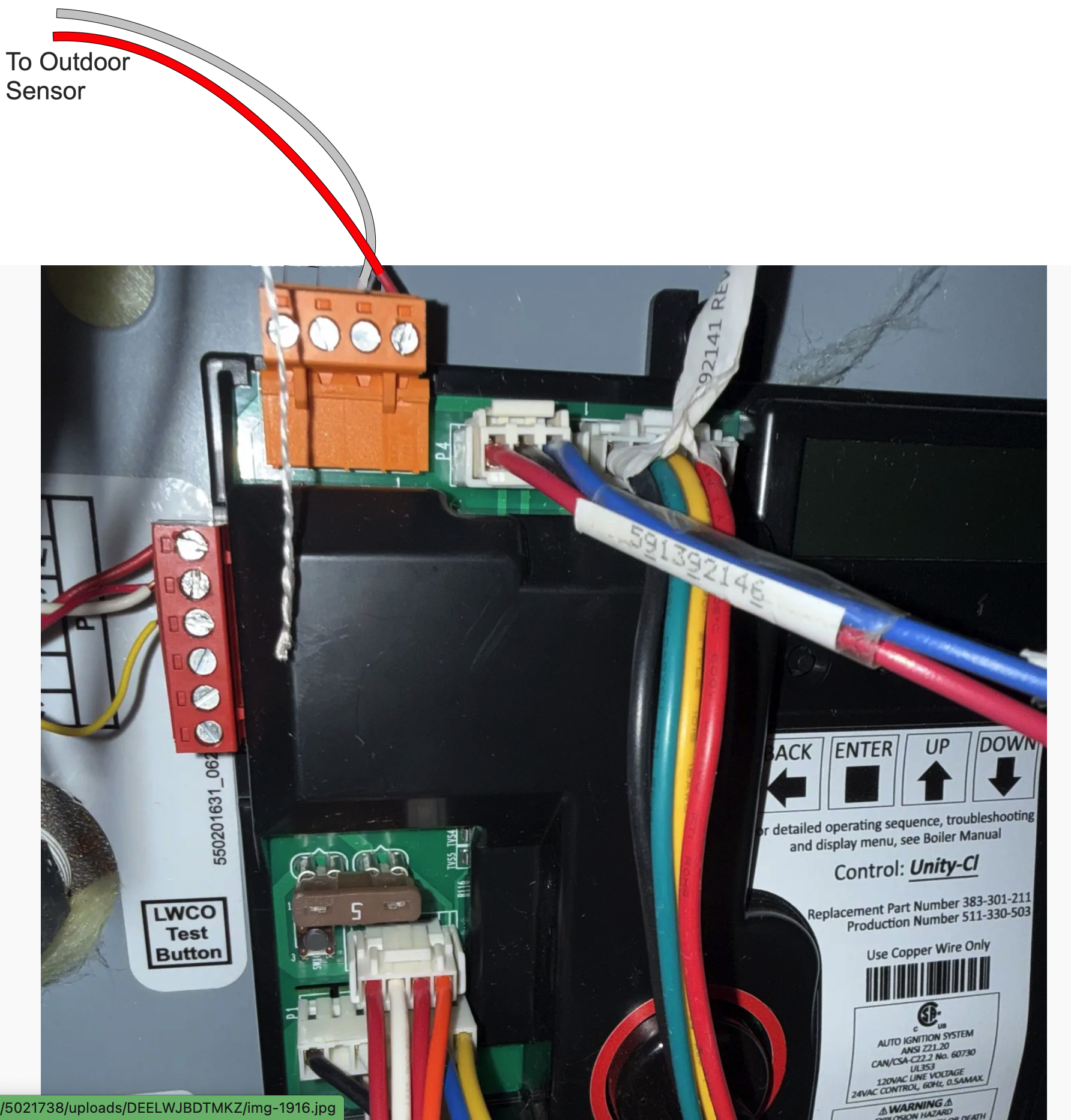

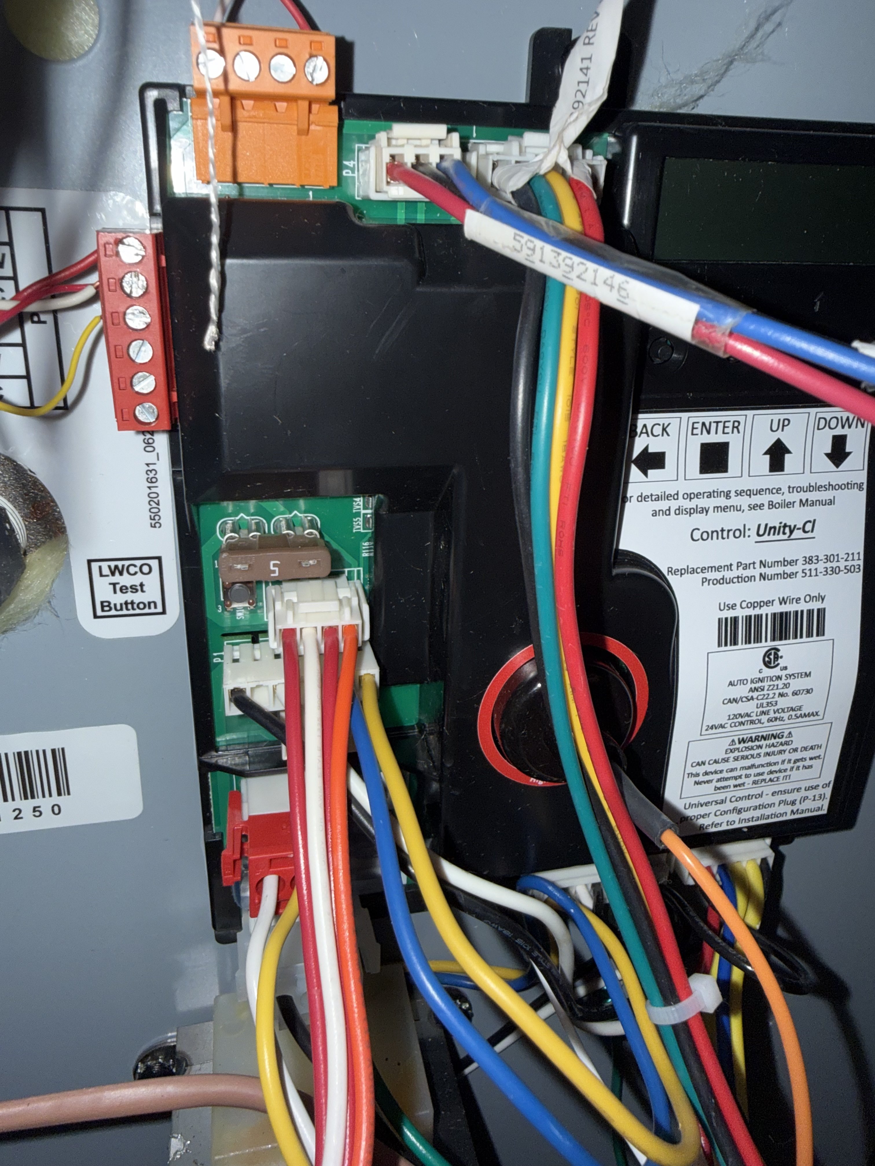

And here is the pic of the control unit

I think you connect to the orange plug at the top left corner of the control. But it looks like you already have a wire connected to the ODT terminal a red wire. I would guess the other ODT wire would connect to the common.
I will check further. Where does that red wire go now?
It sure looks like the two right side terminals 1 &2, on the orange block?
Living the hydronic dream0 -
Yes I think the orange block 1 and 2 (C9-1 and C9-2) right now, the sensor is connected to 1 (red wire) and 4 (white wire) so moving the white wire from 4 to 2.
You actually have a Series 4. I see a different control module used in the Series 3.
1 -
You are correct, apologies, it is the Series 4 boiler with the new Unity-CI control without the plug in terminal for the outdoor sensor
C9-1 and C9-2 is the place to connect that ODS
