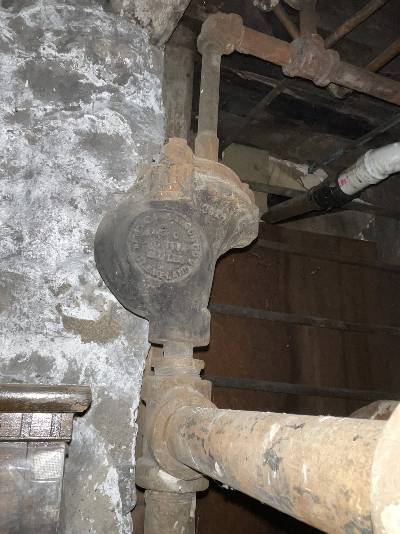

V.D.Andersen air trap

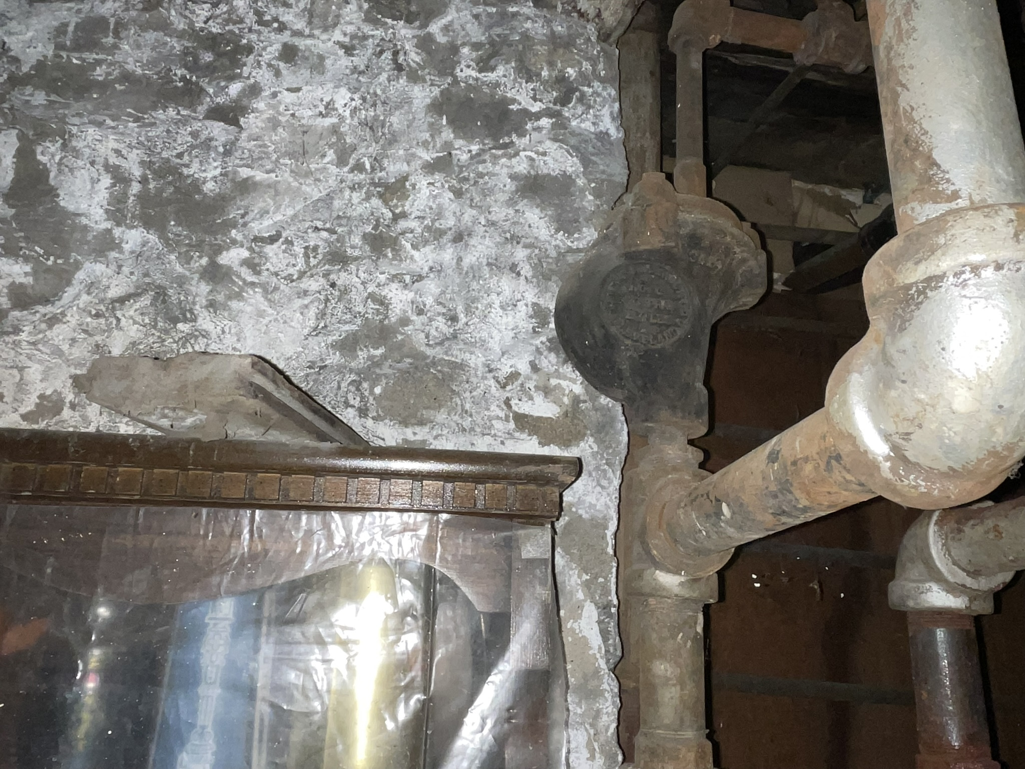

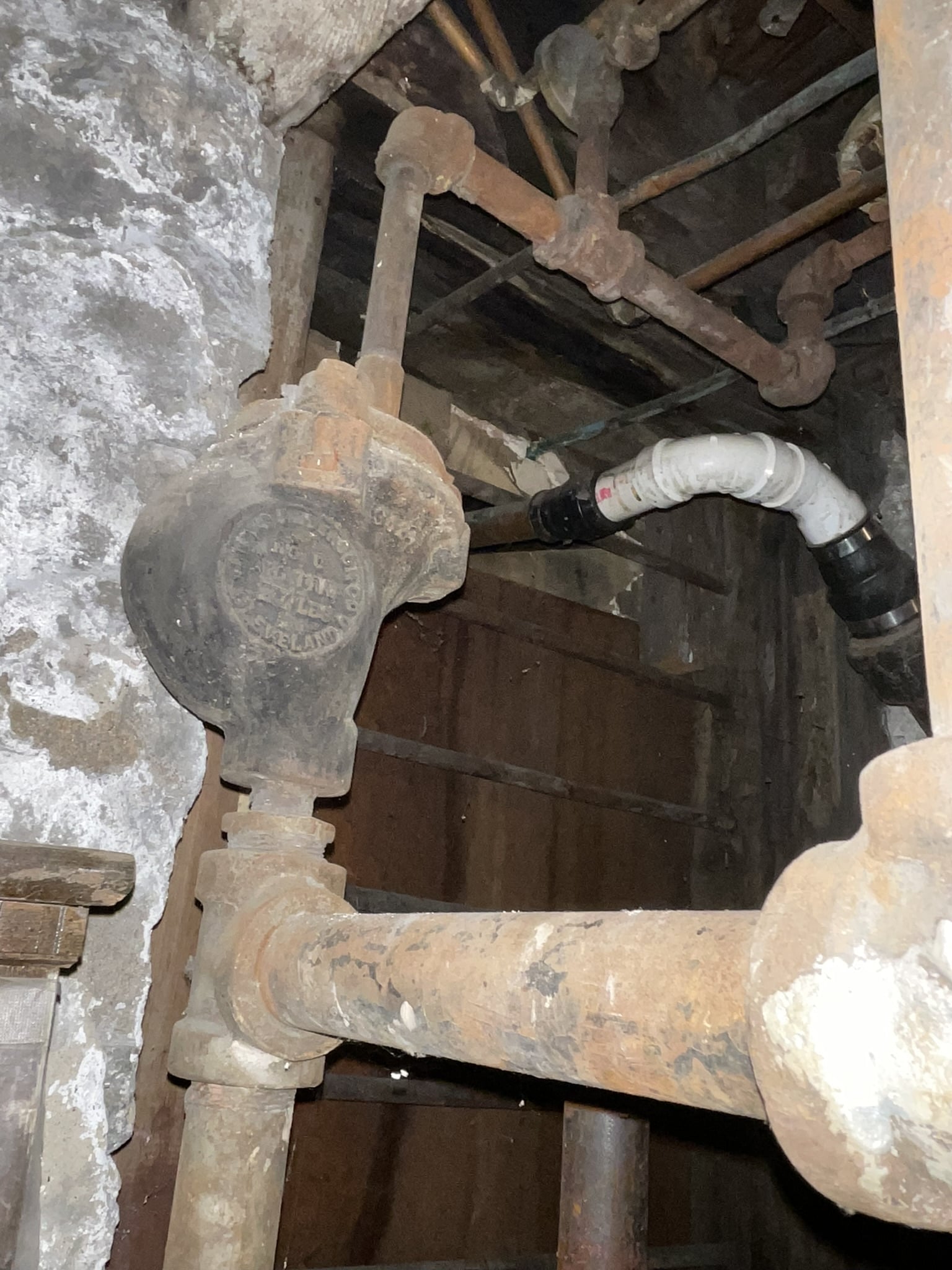

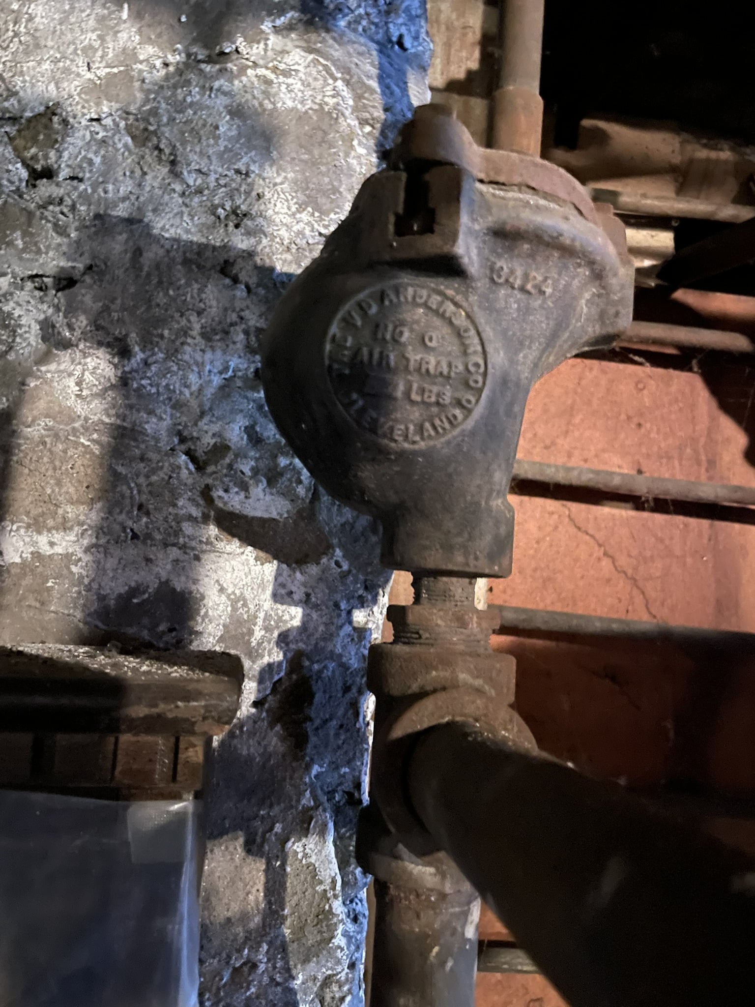

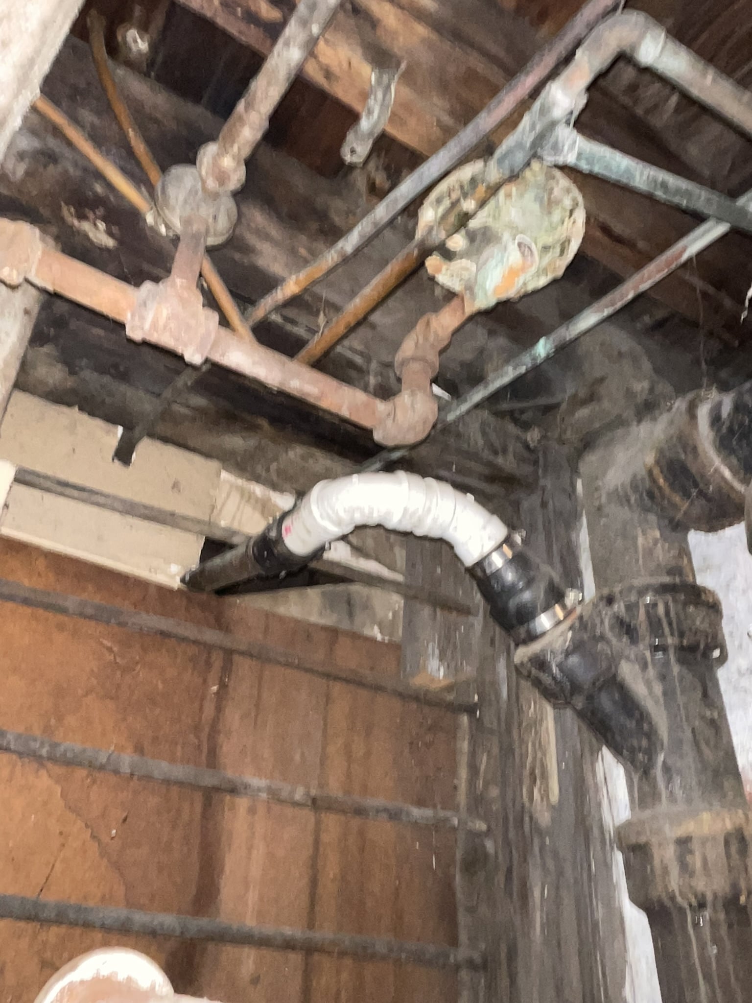

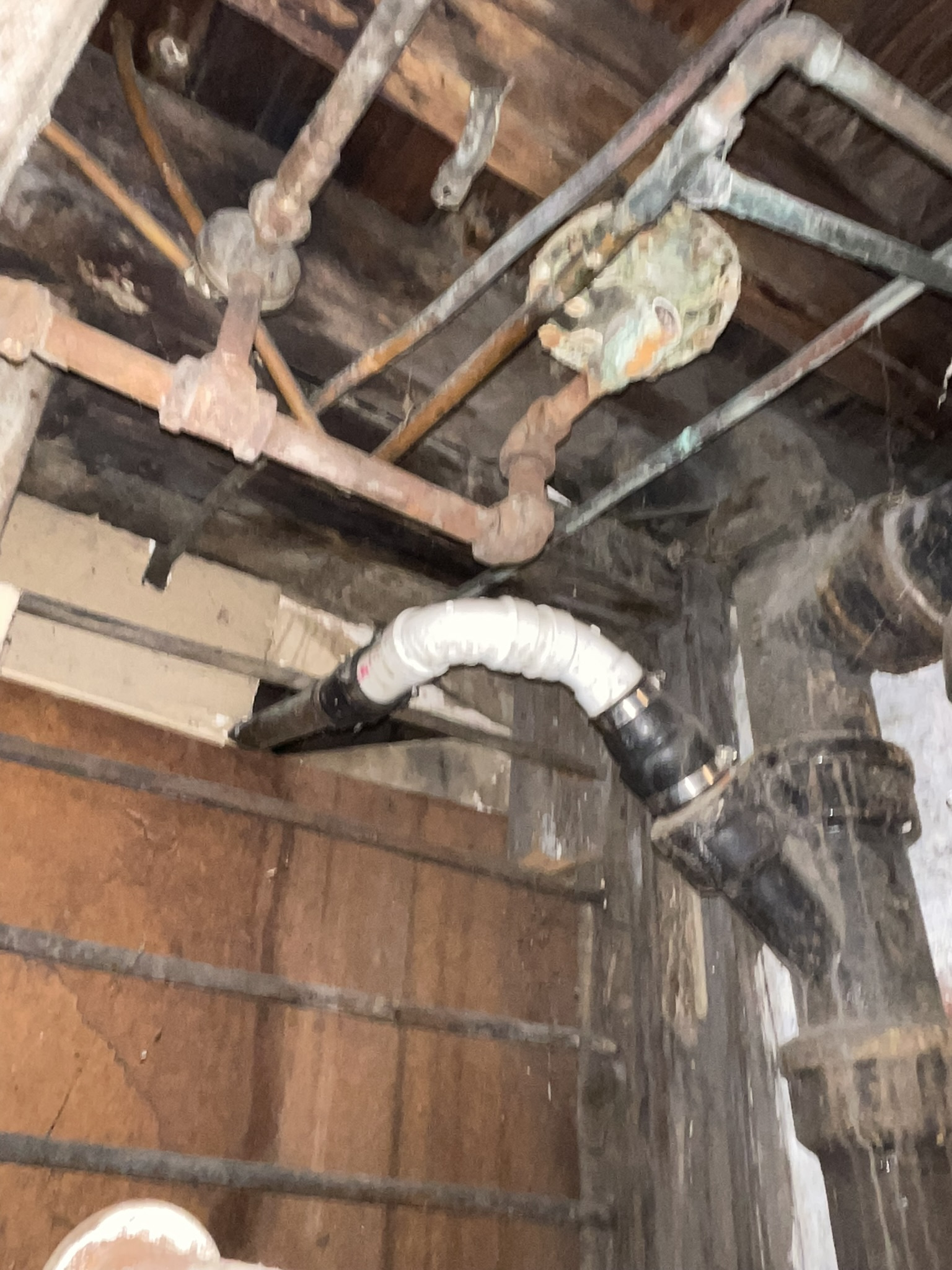

Any information on this apparatus would be appreciated. Two pipe system, return on right and right side of building heats. Left side return tied into this air trap doesn't heat except for a bathroom radiator that someone put a Gorton "c" vent on.

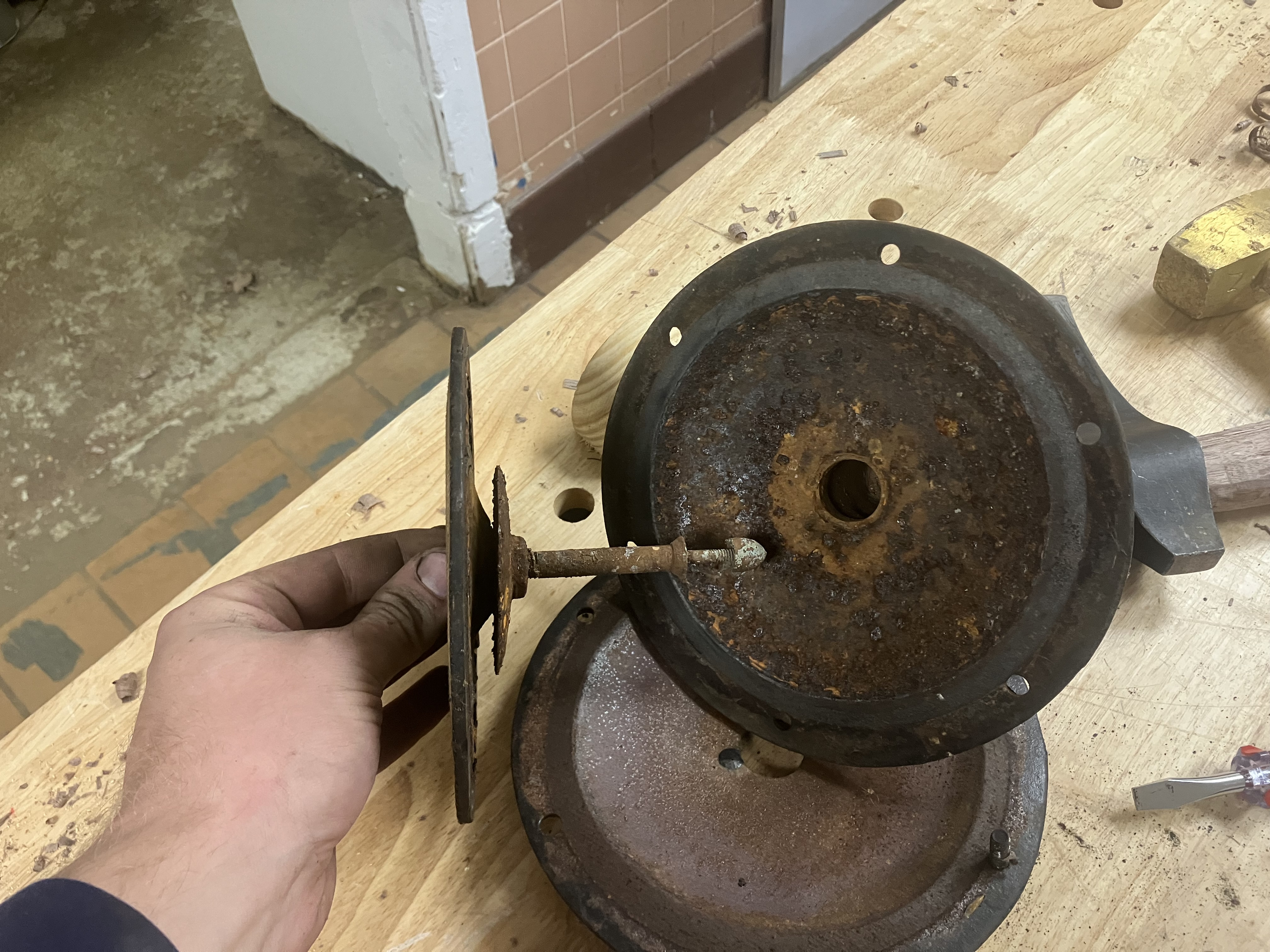

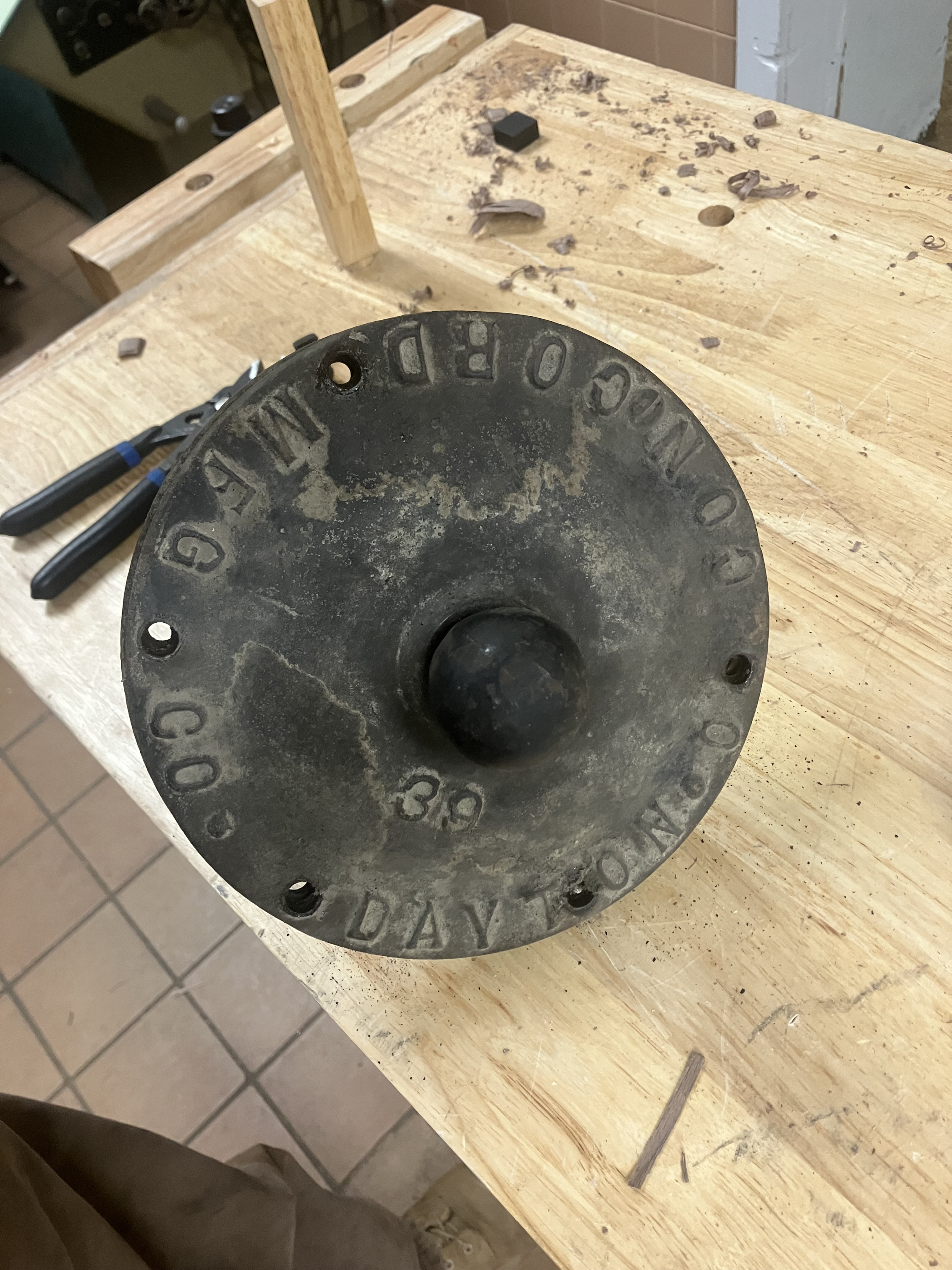

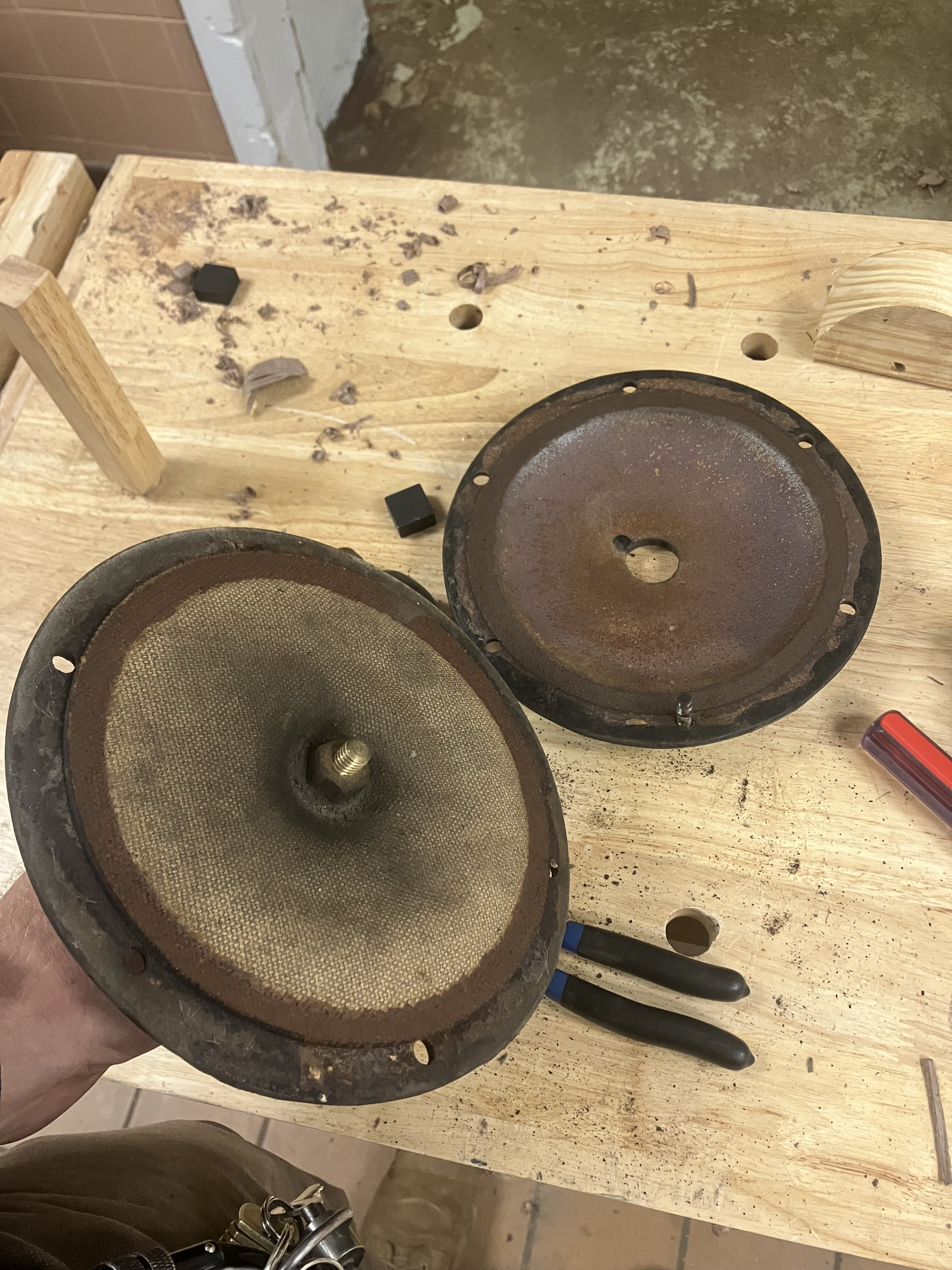

  • We just worked on a system with the space ship looking thing. We ended up opening it up and putting a new gasket in it and cleaning up the rust. It has a weight on the top that is calculated to push down with a certain amount of force I think. I would take it off as it doesn’t do anything useful. We kept it on our system because it looked cool. You could just put a trap in place of it incase steam ever reaches that location and that would be better. Add a line to a drain incase condensation comes out.
    Here’s pics of what it looks like
    These are pictures of before we repaired it

    @AJCimino , I've seen these- they're basically main vents. Is there a pipe coming up of the top of it?
    Semi-retired

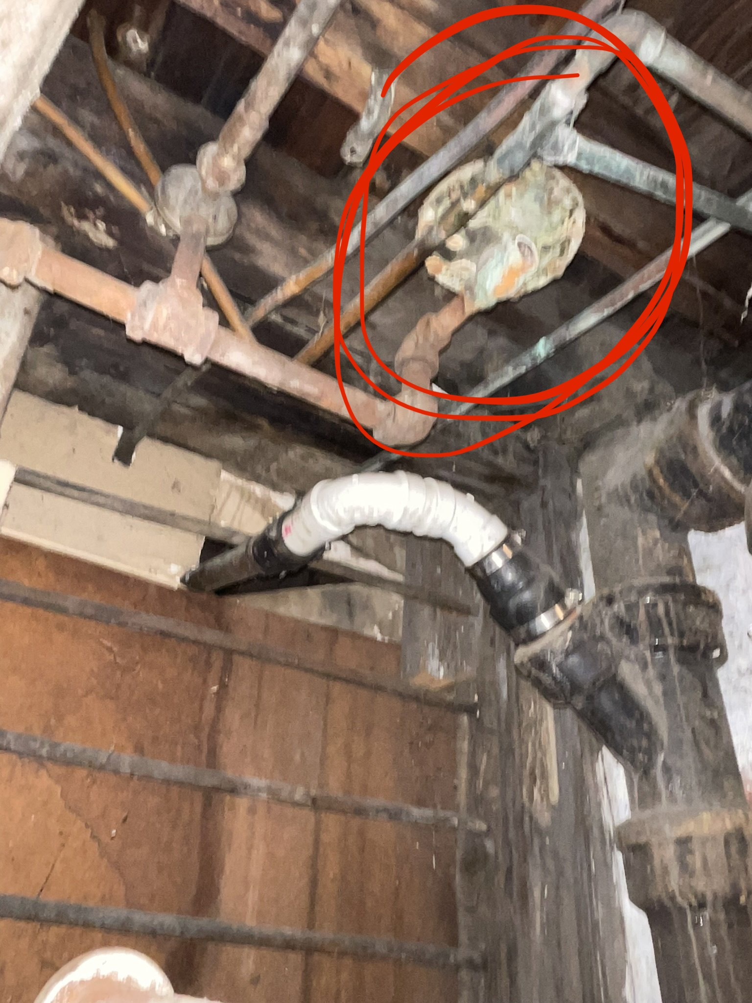

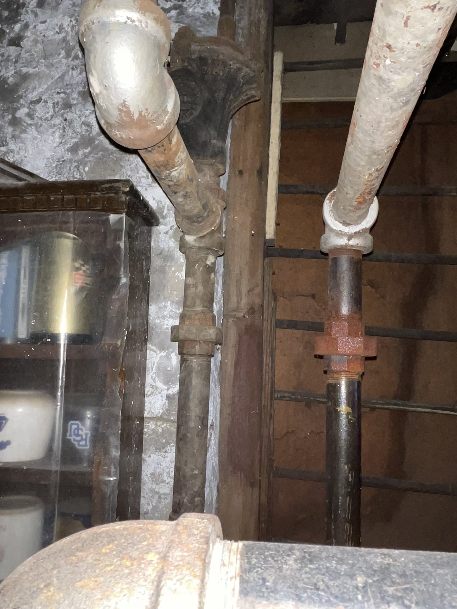

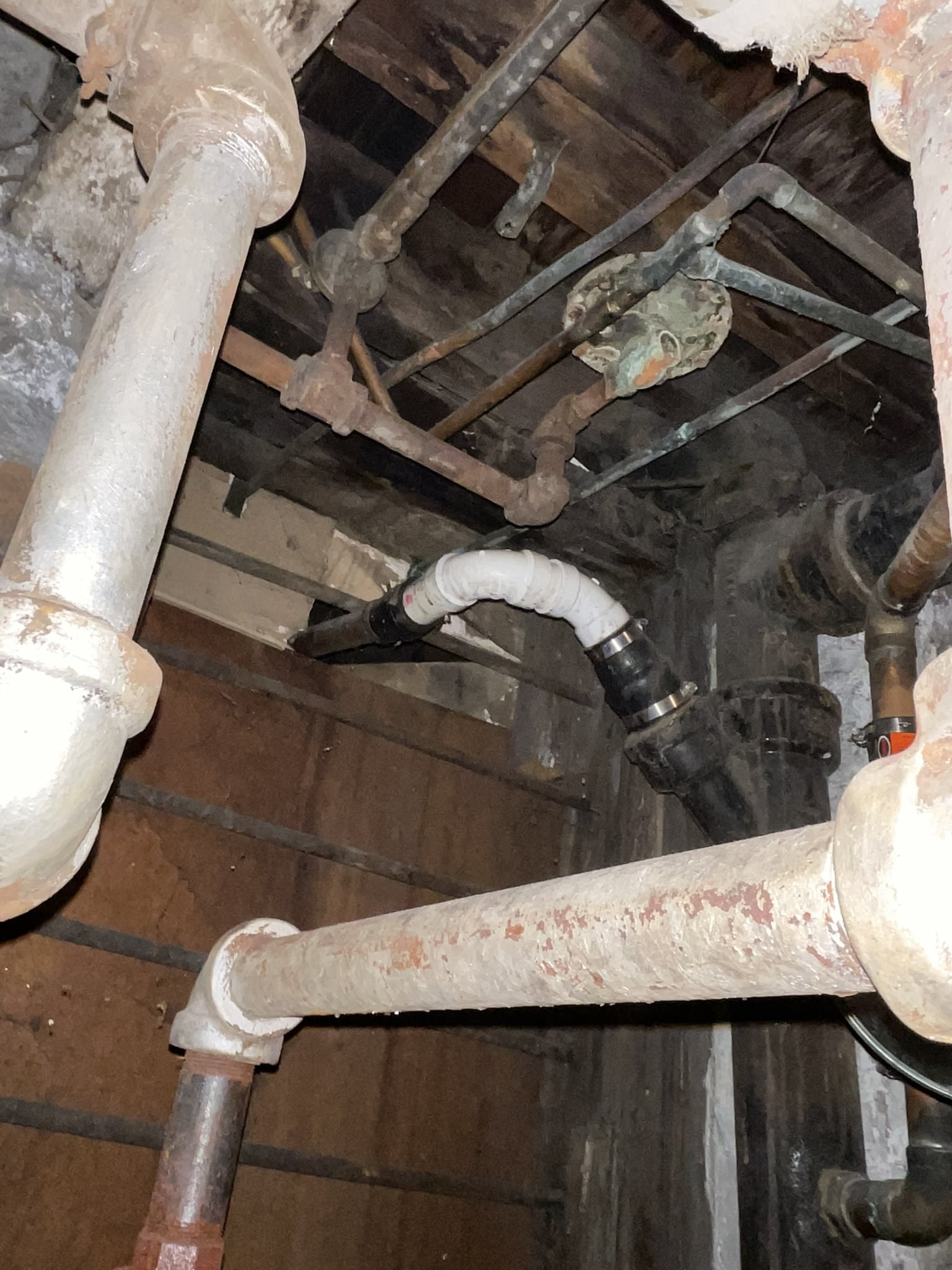

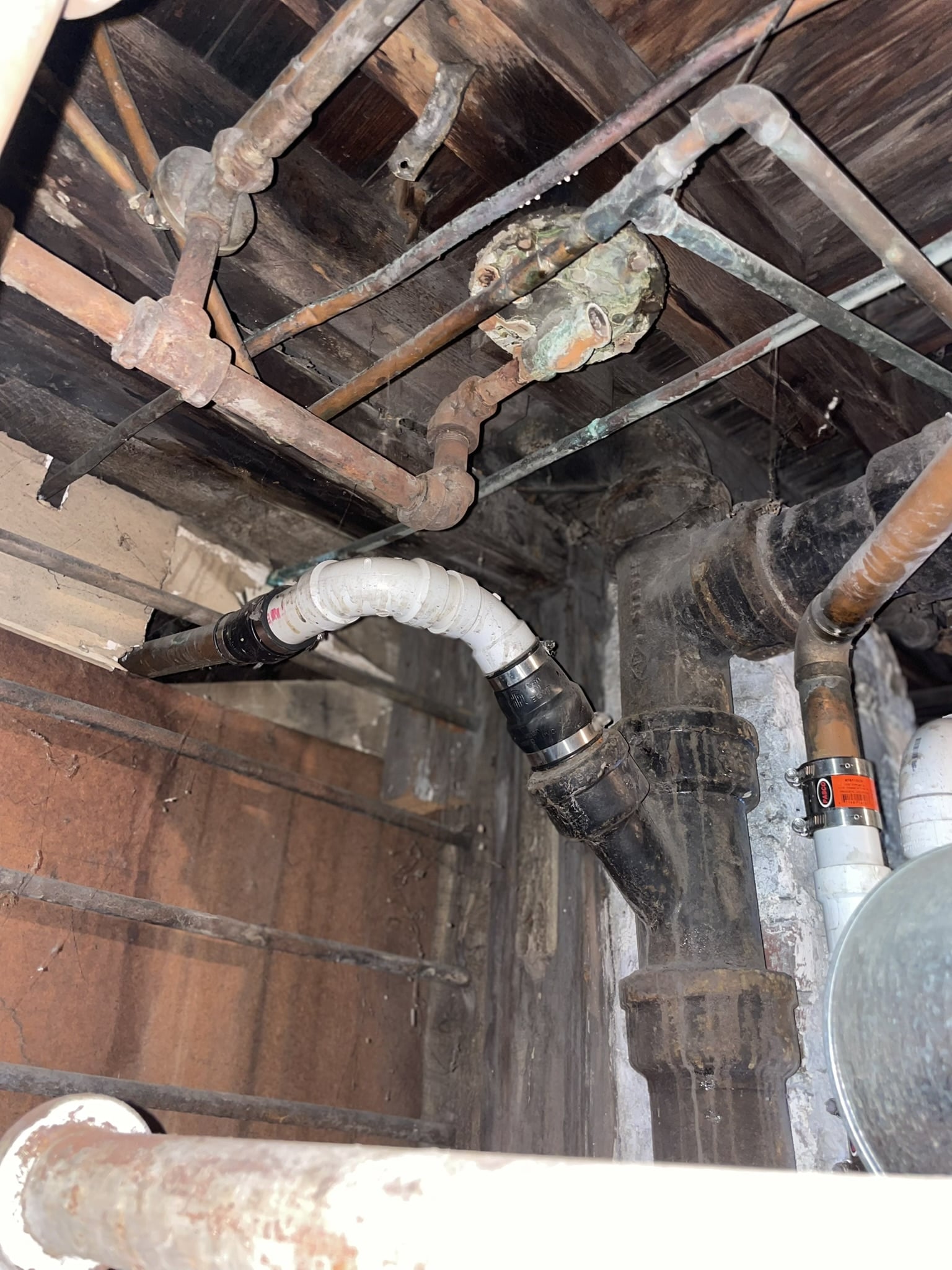

  • Steamhead,
    There is a pipe coming out of the the top that goes to a vent that vents the system. As stated, the right side of the house heats, the left side that is connected to this air trap does not. I thought that is was just a vent, but have no idea why its only serving one side of the house.
    Thanks for the reply.

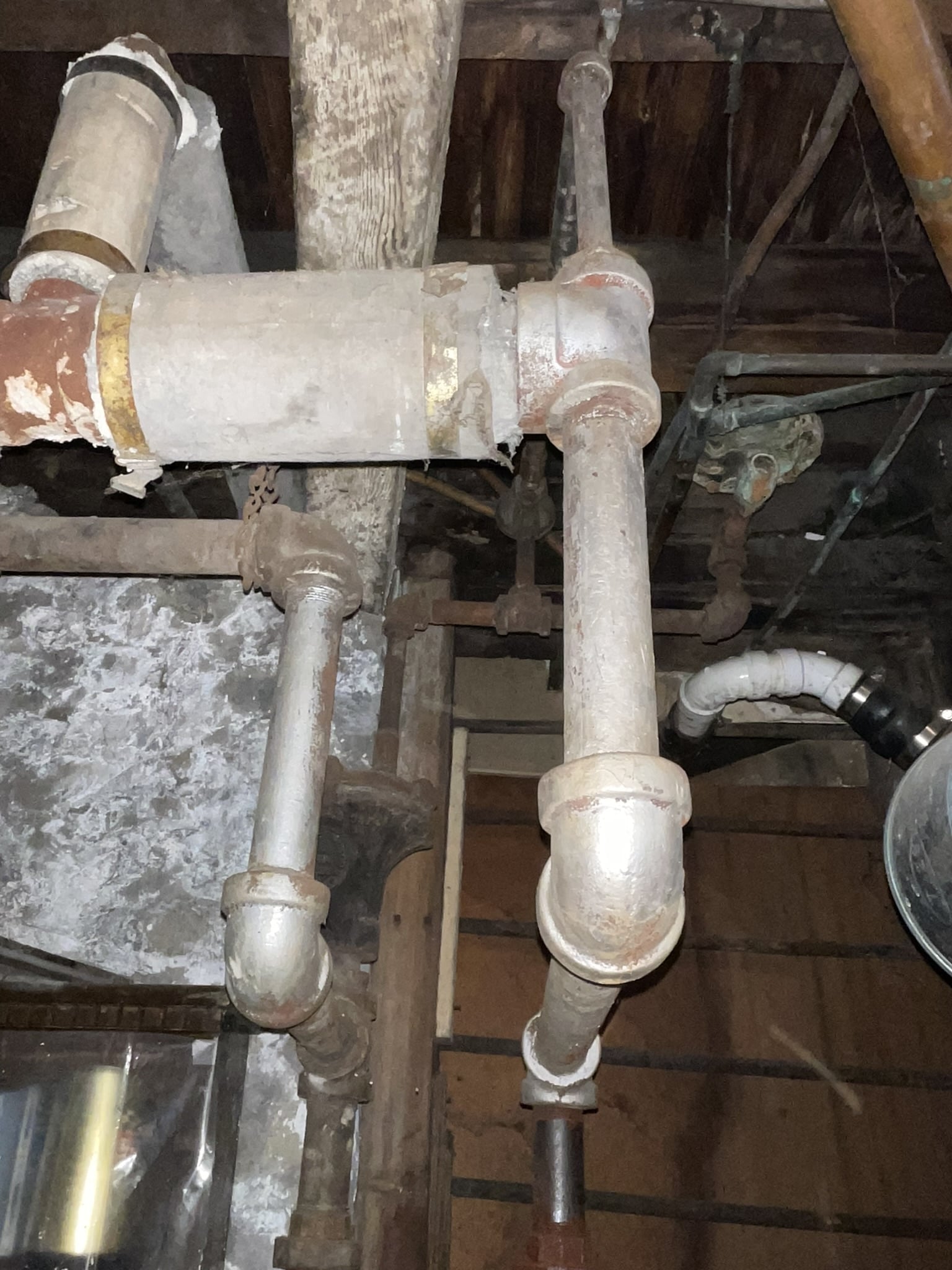

    Steamhead Posts: 19,007
    So, the pipe comes up from the air trap and then turns right, then there's a tee going to what looks like an Illinois or similar outboard radiator trap, then the vent?
    Are both sides of the house connected to that vent?

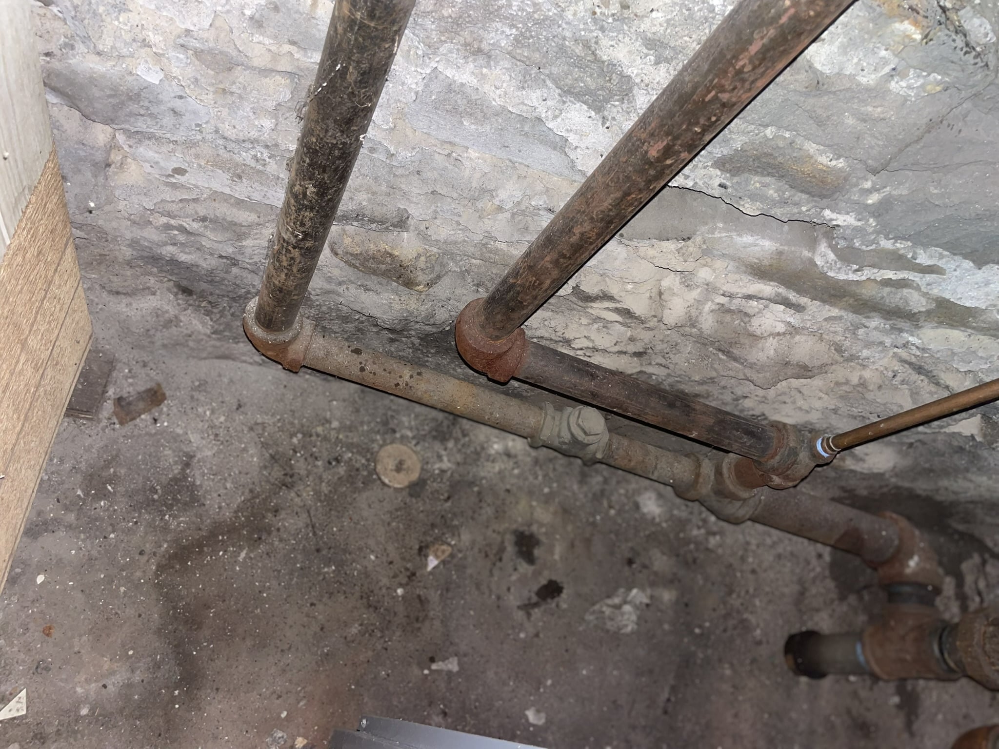

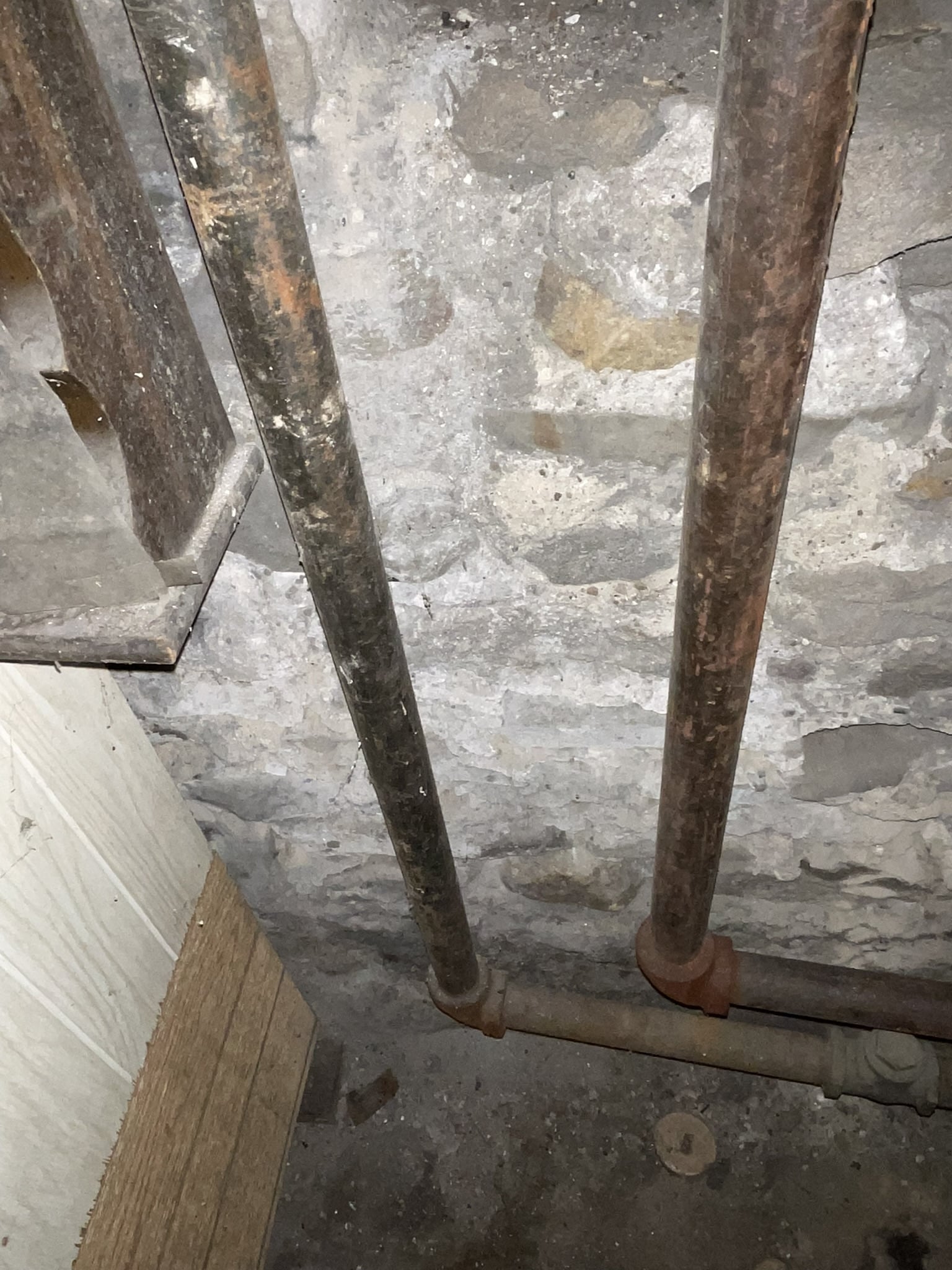

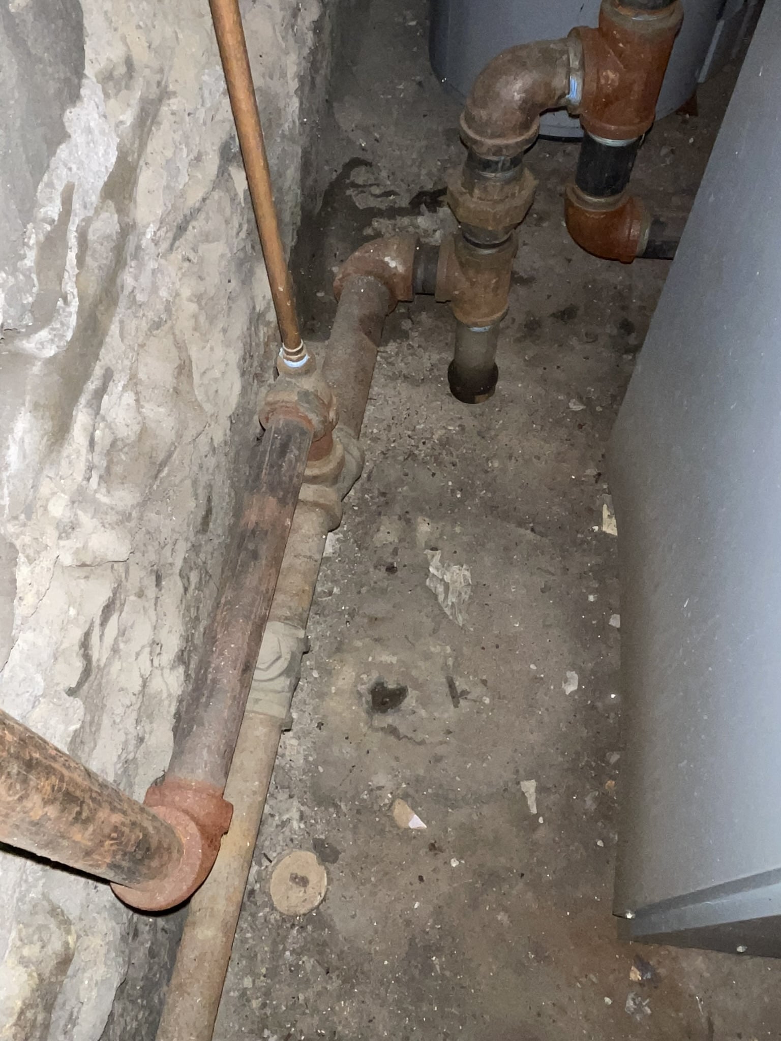

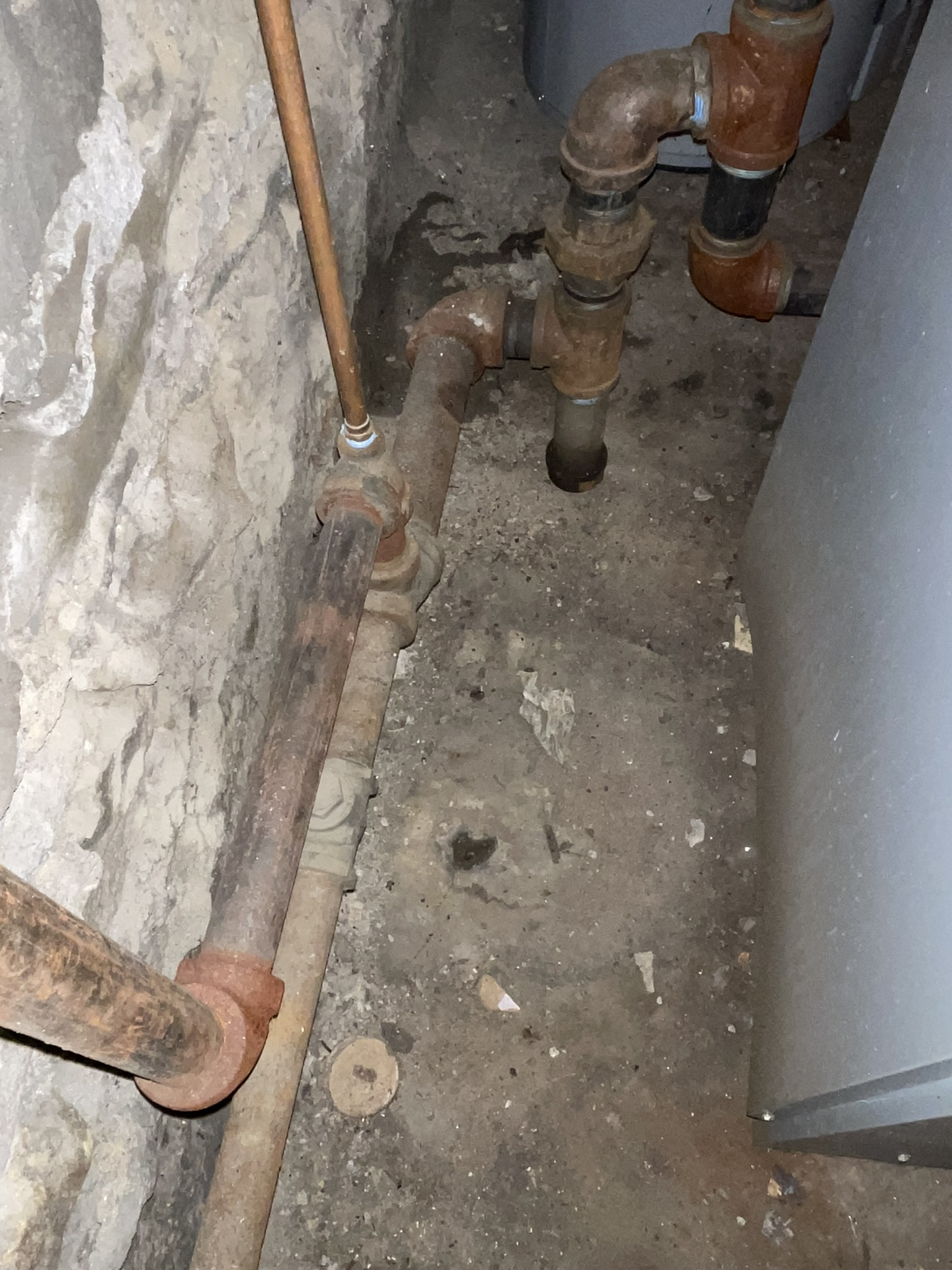

  • Steamhead,
    Only the left side is connected. That inlet branch of that tee is connected to the right side return and from floor it looks like a thermostatic trap connects to the tee.. The pipe continues to the apparatus further right. This is where air is released. Again, the right side not connected to the Andersen trap heats.
    4.JPEG 729.8K
    I think it will. But before I tell you to, a question: Does the Anderson vent trap sit on top of a dry return or a steam main?

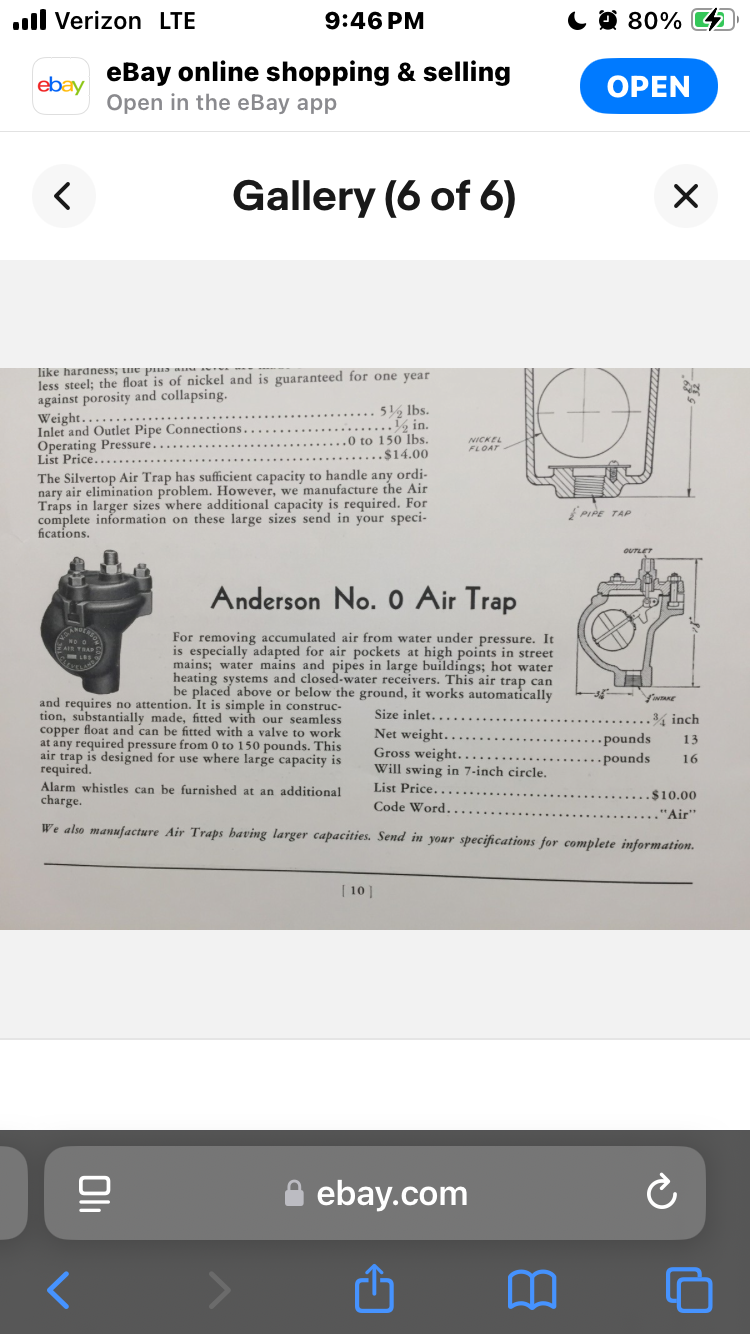

  • I was researching more and even debated AI about this specific “Air trap” Now there is not a lot out there on this trap but from what I could gather, this V. D. Anderson Air Trap No. 0 is technically for hot water systems not steam systems . I even found someone selling a book on EBay and they just so happen to have had the picture of the page about this trap.
    I think the set up for this system is odd if the condensate is entering through the outlet port of the air trap. After seeing that, I do think the air trap is the issue but only if it being on a steam system is an incorrect application for it.
    What do you think Steam head?
    Maybe the house was originally hot water and then got converted to steam?
    edited December 2025
    @DanielDAY , apparently there were two versions. I've seen the steam version before, it closes against water but not steam. I bet this one is stuck closed.

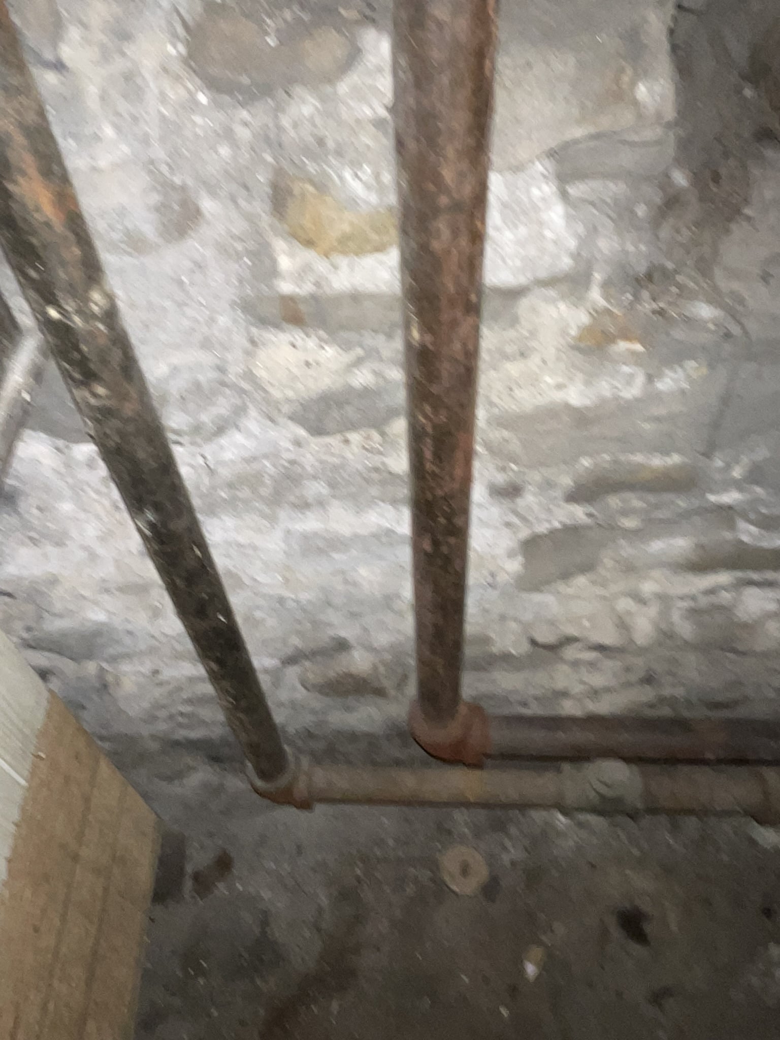

  • Steamhead,
    The trap does sit on a dry return, and here is no steam connection to the trap. Interestingly, the two dry returns drop down below the water line, but only the return from the Andersen trap has a swing check. My feeling is that its only there to vent air and as you indicated it may be stuck closed. The right return is vented into that overhead tee and then to the device to the right with a thermostatic trap to shut off any steam that makes its way to the return. At least that's what I think.
    Yes, you can remove it. You'll have to cut the pipe above it, then unscrew it from the tee underneath. You'll need a long wrench and a cheater, and you'll probably have to heat the base of the trap at the pipe connection, to get it loose.
