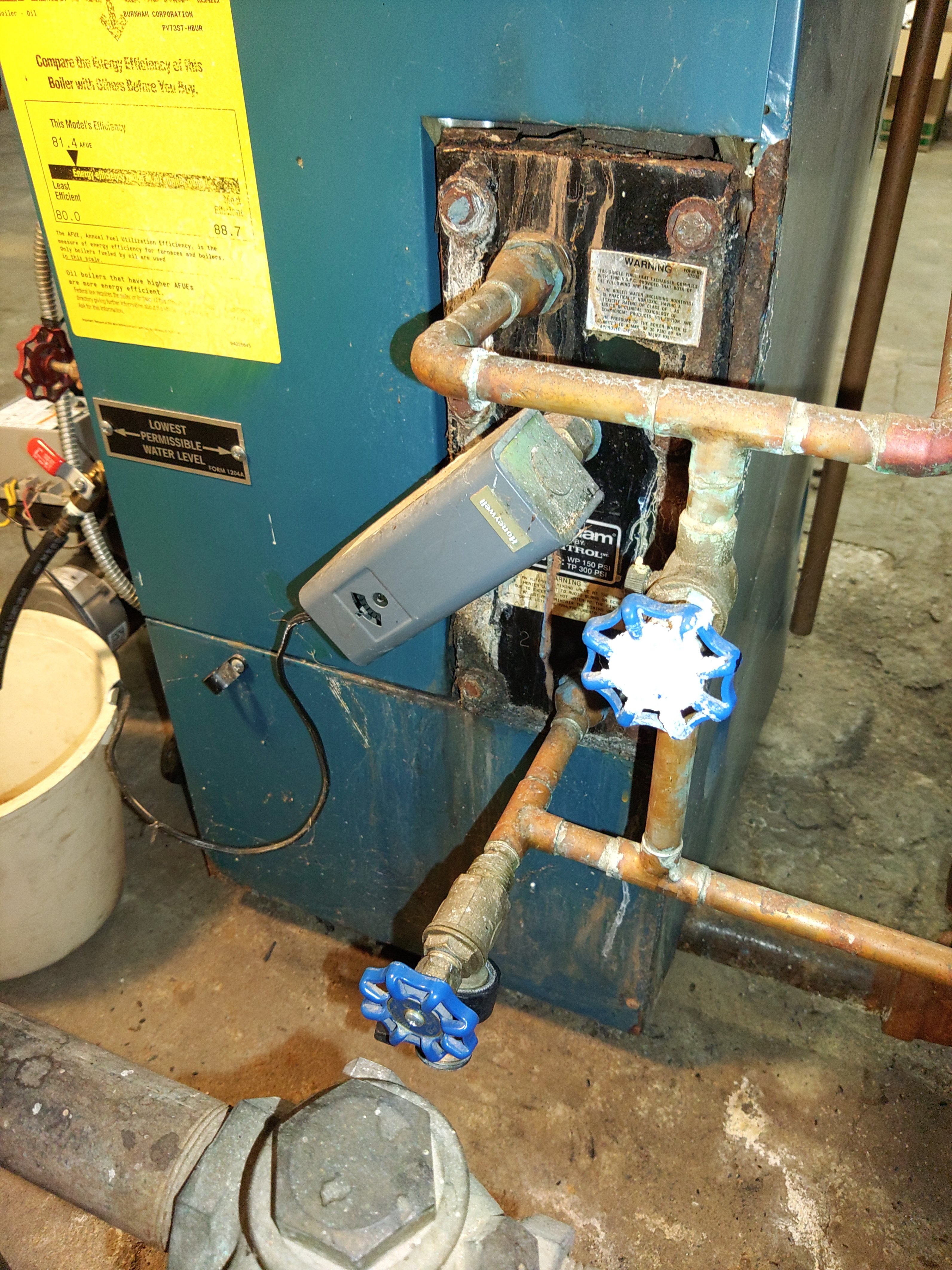

Current domestic coil piping:
I don't know why the installer piped the hot out from bottom when it should be coming out of the top.

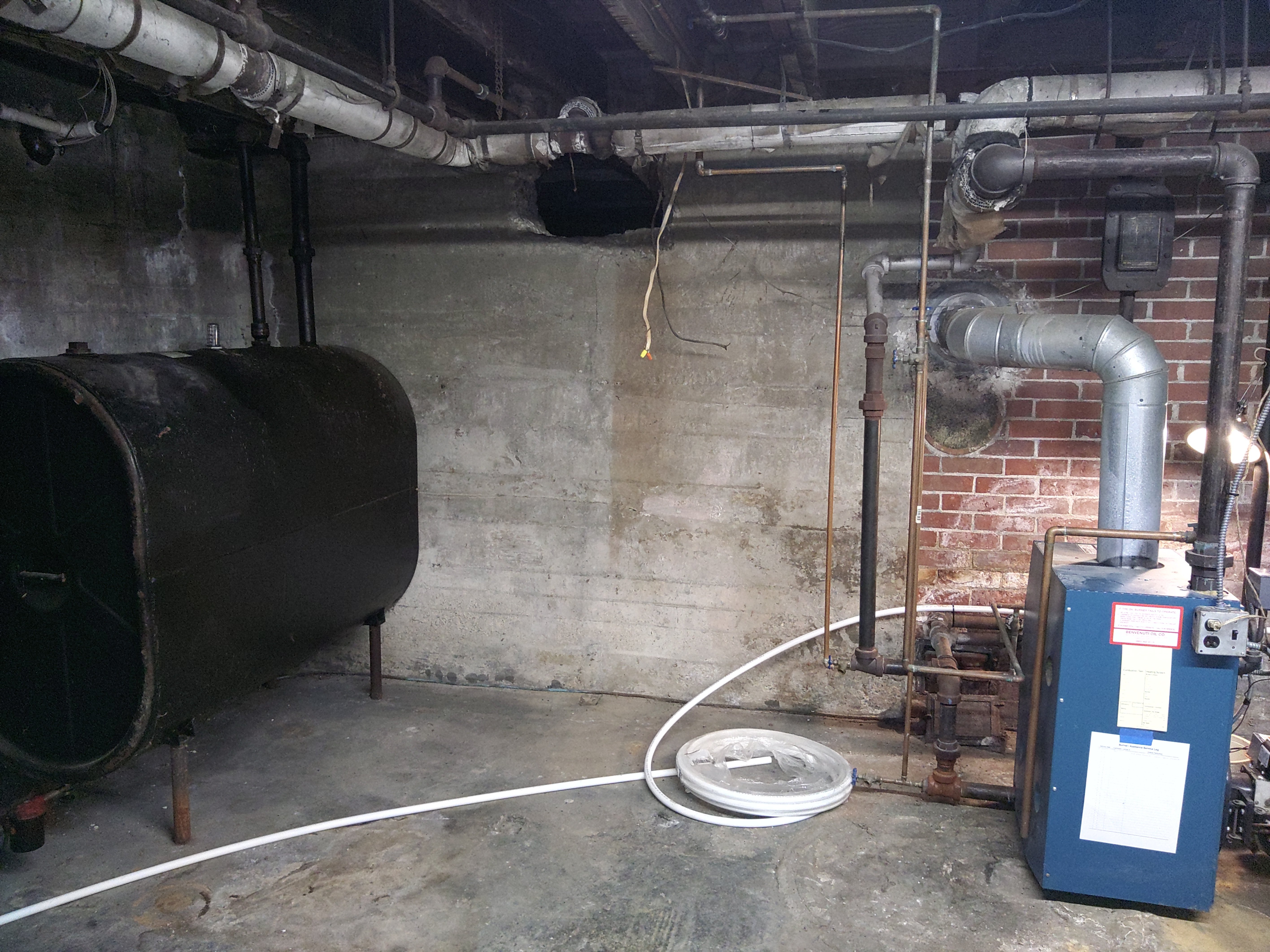

Planned installation spot :
House used to have I believe it was an 80 gallon regular tank electric water heater so I already have a 30 amp circuit that is run to that spot and is dead ended inside of the panel and I've already run 3/4" pex to the sump pit for the condensate drain from the HPWH and I've run it along the steam system wet return. I have already done some checking and the wet return only ever gets warm to the touch during an extended call for heat.

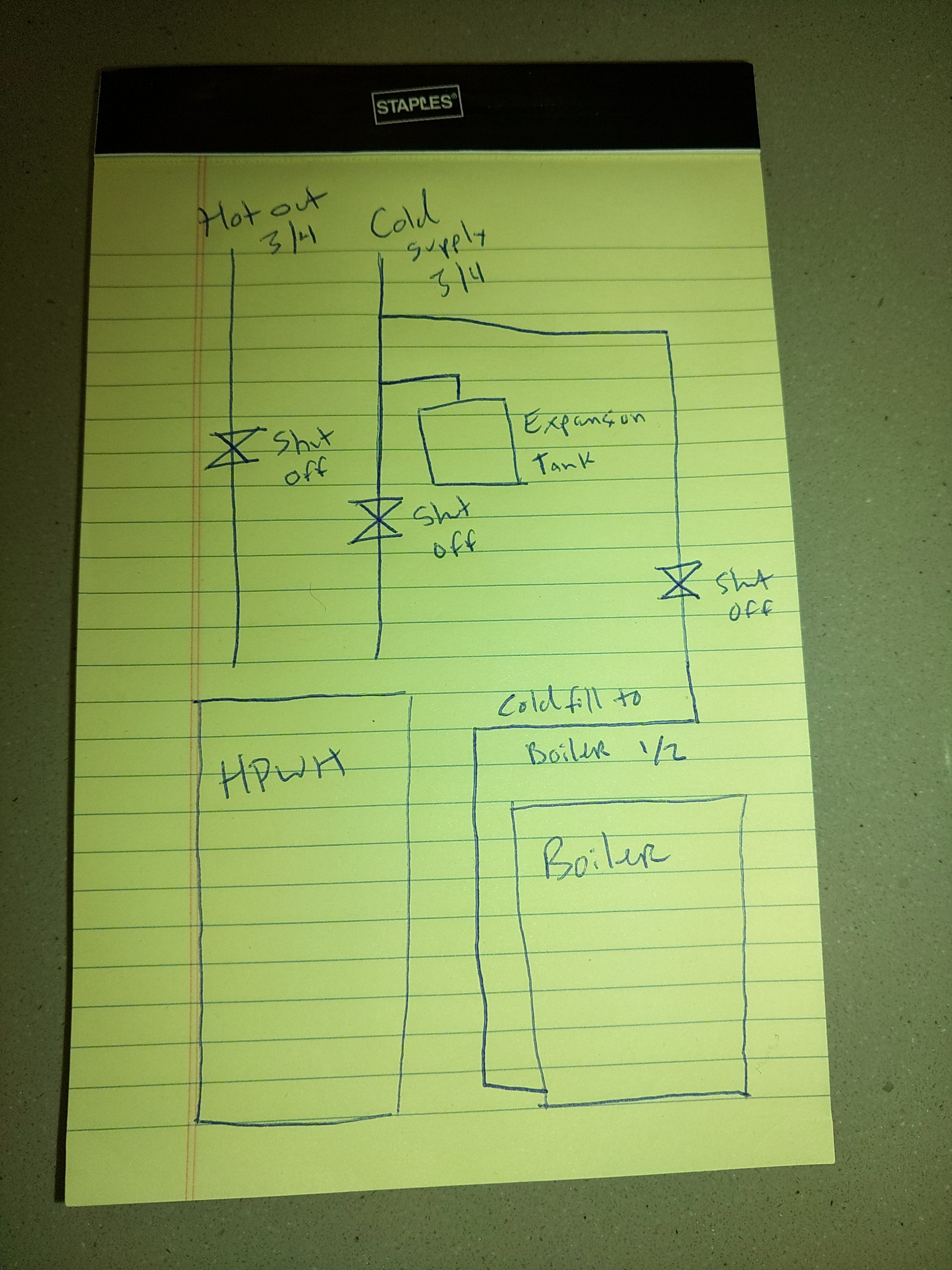

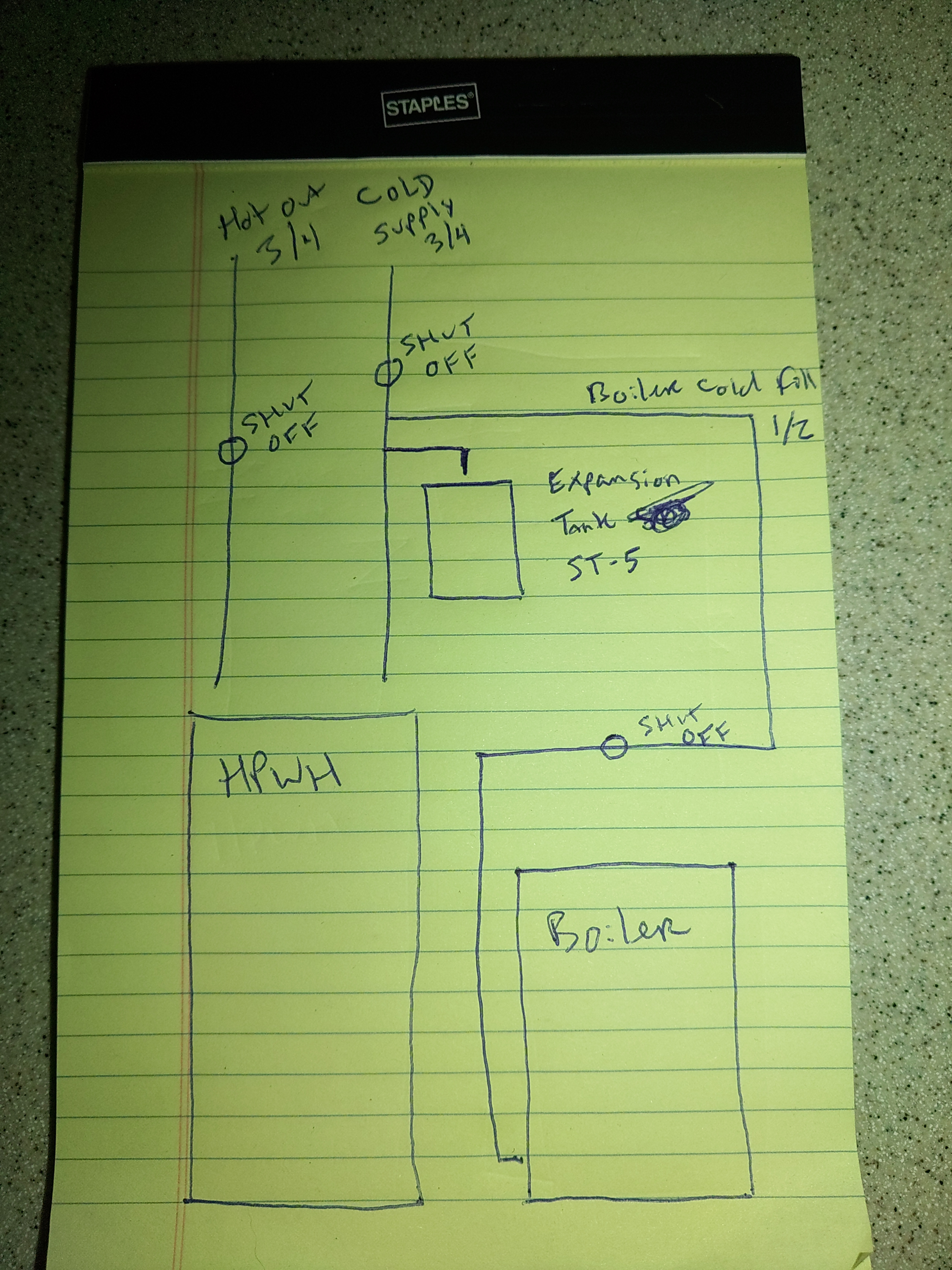

    Per the advice of @Intplm. , I'm going to run the HPWH as a standalone unit. Drew up a quick piping diagram today as well. Even though I am on well water with a 32 gallon pressure tank, the manufacturer still wants an expansion tank by the tank.
    hot_rod Member Posts: 27,445
    the expansion tank should be below the shut off valve to the hpwh
    bburd
  • WilliamGwiazdowski
    WilliamGwiazdowski Member Posts: 151
    Thats just how I drew it. When I do it I'll make sure the expansion tank is below the shut off for the tank

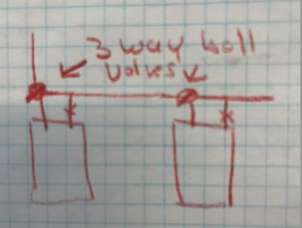

  • Larry Weingarten
    Larry Weingarten Member Posts: 4,093
    Hi, Here's a quick sketch of how I like to valve things. HPs like cold water, so I'd put it first, then you have the coil as backup if needed. The three valve approach has been around a while for isolating and bypassing equipment.
    Yours, Larry

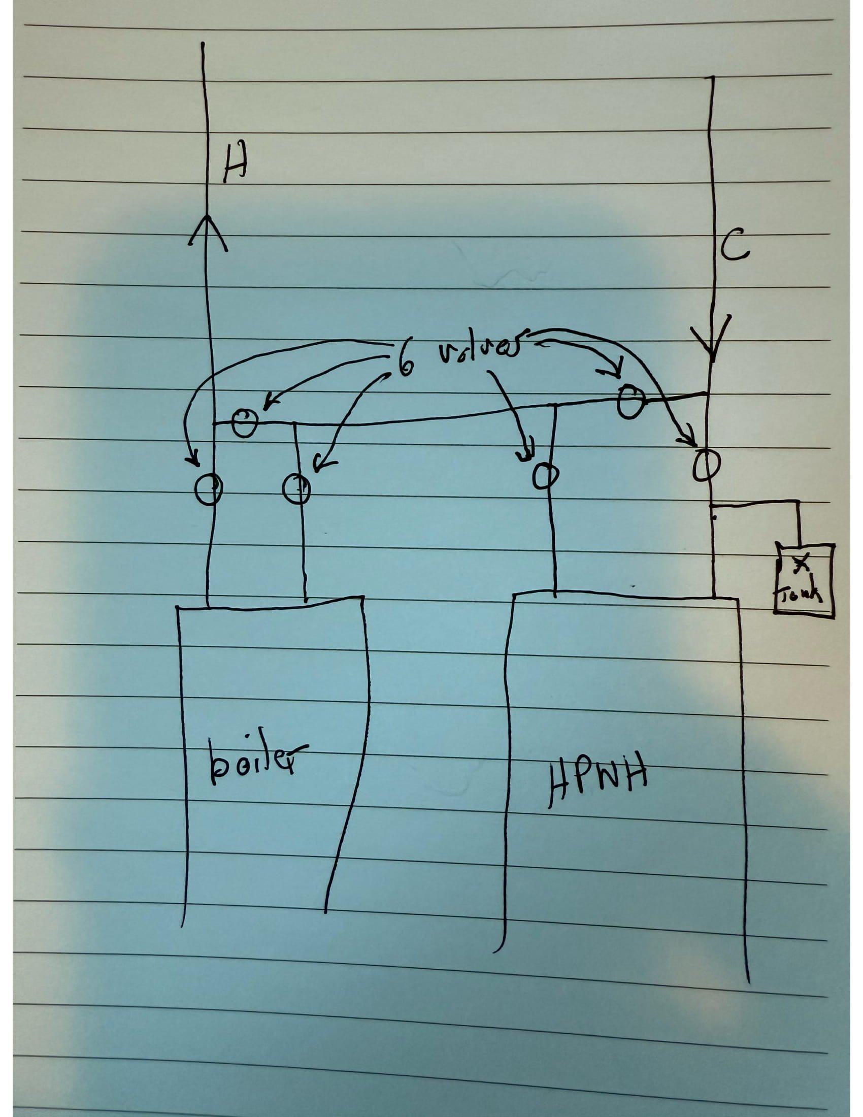

    I like Larrys thought process. It could be done with 4 valves also. Use 3 way manual ball valves to do two jobs with one valve. If you go that route make sure yo get the correct 3 way, they come on L or T versions.

    Thanks gents however in the interest of simplicity I'm going to not even include the coil in the piping. Just straight into the HPWH with a tee for the boiler fill and a tee for the expansion tank
    Re drew my piping diagram
