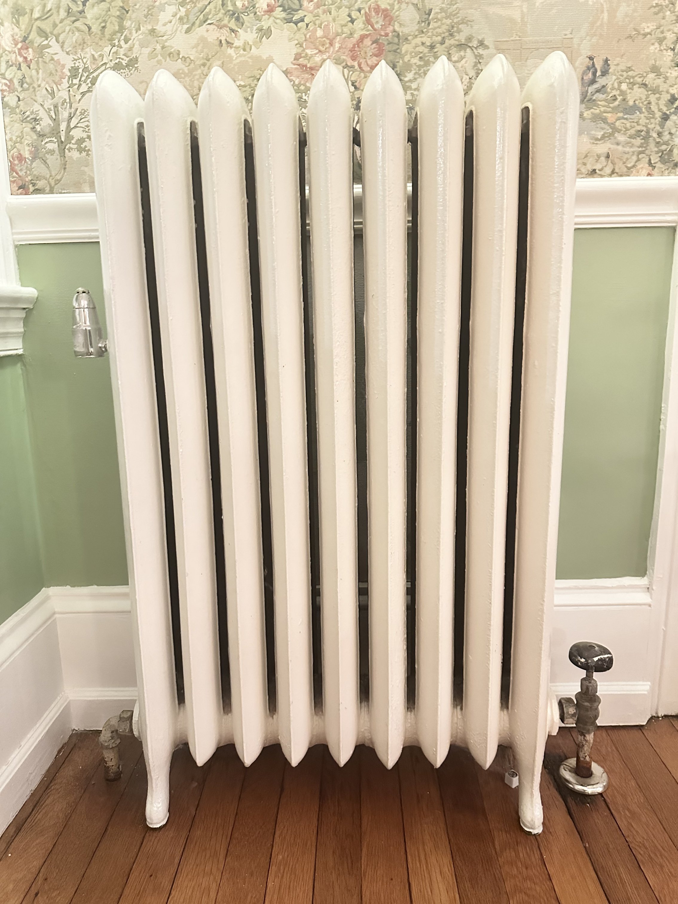

What type of steam system do I have?
Posting a picture of a typical radiator in my house. It has pipes on both ends and a steam vent as well. Is this a single pipe or a 2 pipe system?
we need to see what's happening in the basement. it could be 2 pipe air vent or it could be various forms of knuckleheading.
@cd1 any idea of the house age?
Two pipe air vent usually has valves on the inlet and outlet
I’ll post a picture of the basement shortly. There are 2 main vents in the basement from what I can see. There are about 20 radiators in the house and they all have this exact configuration in the picture I posted earlier.
It’s about 113 yrs old and has always had steam heat from what I can tell. The boiler was replaced about 10 yrs ago by the previous owner.
we need to see where the supply and especially where the return goes and what happens at the end of the steam main
