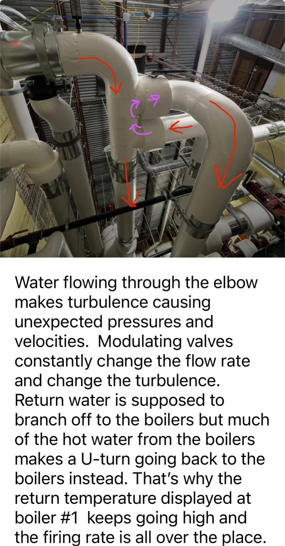

First of all greetings everybody. I’m in my second year as building engineer at my old high school and need expert opinions. I understand that there should be a decent run of straight pipe upstream of a circulator because a 90(edited) can cause turbulence. (I’ve seen this phenomenon firsthand with forced air. The new register won’t blow because the starting collar is immediately after an elbow.)
There’s an issue with a pair of boilers that serve the athletics areas, including air handlers, and heat Exchangers. Water to and from the building that I’m calling primary looks mostly correct. Return water enters the boiler room past the thermometer that’s usually showing about 110°-120°. Water flows past a T that goes to the pair of boilers and then past another T from the pair of boilers then through the air separator and circulator, and then back out to the building. Boilers operate in stages with the more efficient boiler as stage one. Target is 160. I would expect boiler one to settle into some equilibrium firing rate most of the time but instead it’s always going from its minimum to 100% and it shuts off quite a bit. Second stage boiler comes on for two or three minutes at a time. The other odd thing is that the return water to from the boilers is constantly moving between 120 and 160.
Here’s what I think is going wrong. The T sending water to the boilers is immediately after a 90° elbow. The T returning water from the boilers is immediately after the first T. “Closely spaced T’s” are not helpful here. Turbulence immediately downstream of the 90 is causing unexpected pressures where water is supposed to turn into the T. To make matters worse, modulating valves make the rate of flow to and from the building fluctuate so the turbulence keeps changing.
I’ve concluded that water from the boilers is making an unexpected unintentional U-turn back to the boilers because of turbulence from being too close downstream of the 90.
Thoughts?

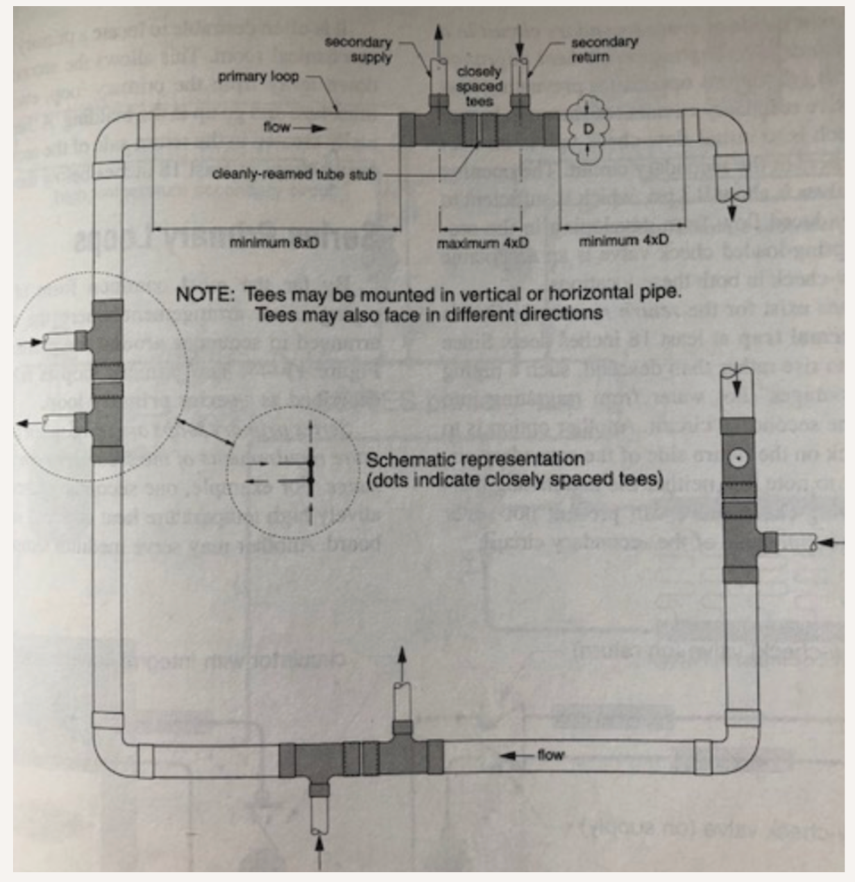

Ideally you want pipe dimensions along this line.
Too close would not cause the symptom you describe.

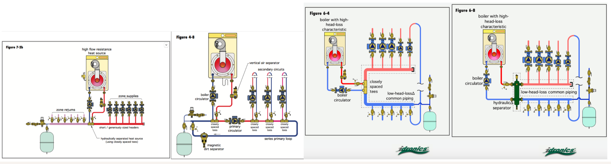

Is there a dedicated loop with a pump, like this, fig 4-8?
A sketch may be a better view.

BTW the upper left part of the black-and-white image shows a 90 upstream of a T. The section of pipe connecting them has its length indicated as “minimum 8xD”. Again, I can’t help but thinking that crazy stuff is happening in that T caused turbulence from being too close to a 90.

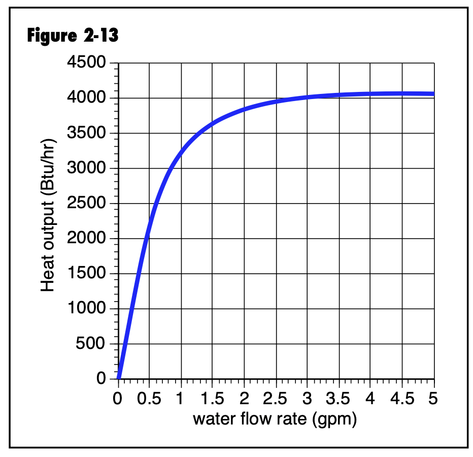

This graph will look the same regardless of the type of heat emitter, obviously these low flow conditions would be a residential system, but even with 50 gpm flows, the curve would look the same. This is the challenge with varying flow to change heat output. Sometimes called a hockey stick curve :)

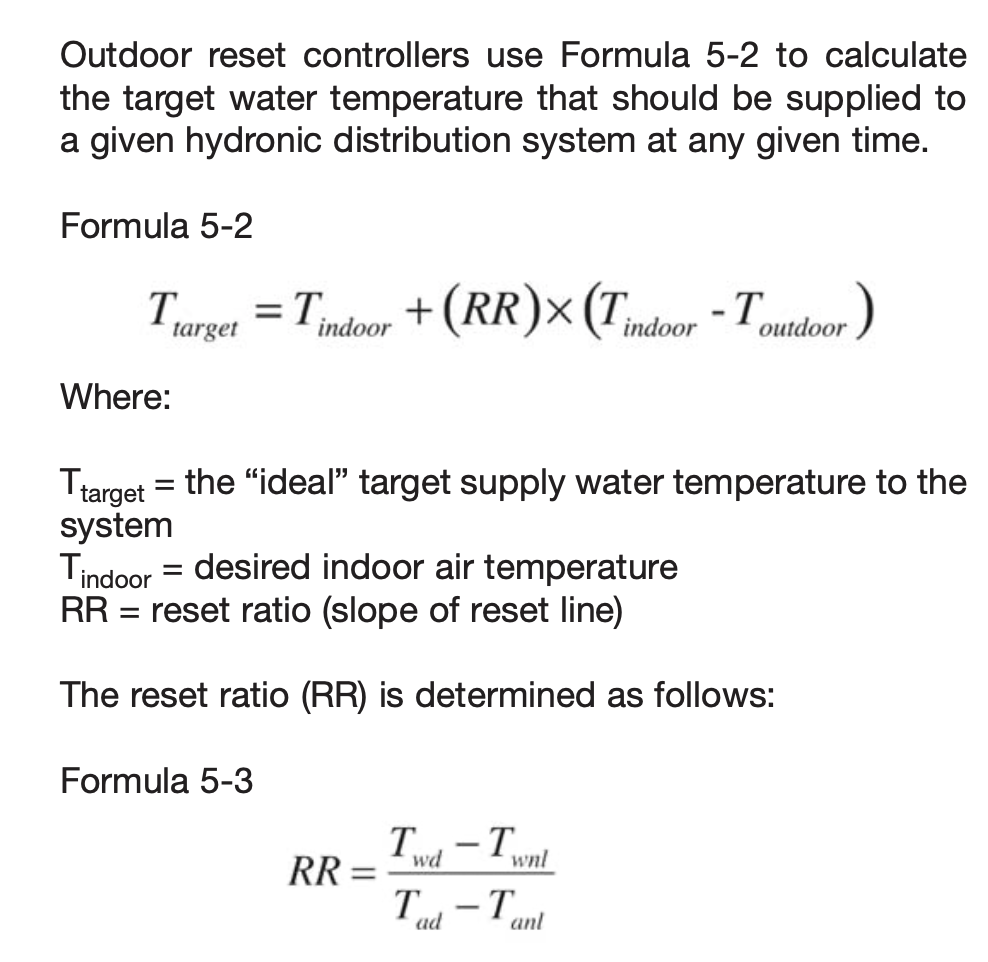

Changing heat output to the system is easier, more stable with temperature modulation as it tracks with loads closely, looking at ODR curves you see that relationship.
In a perfect heating control, we adjust the heat input to exactly match the heat loss at any given point.

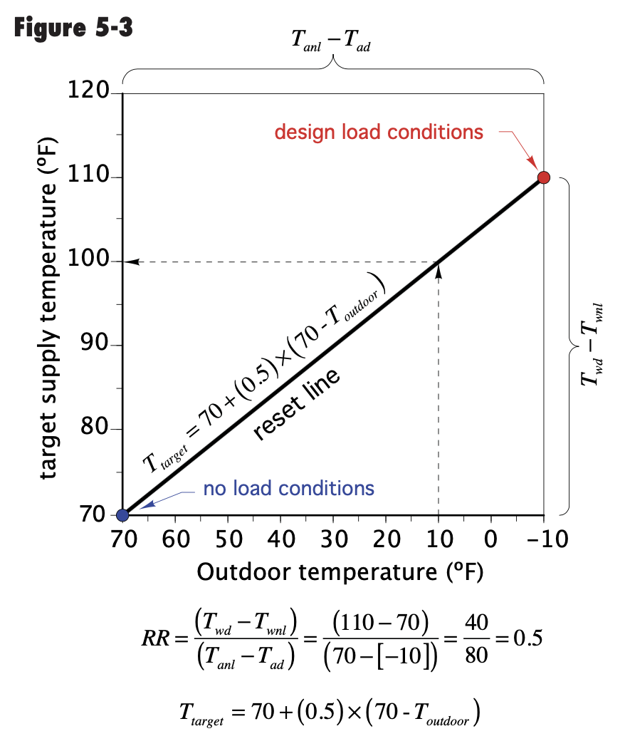

Are the boilers on outdoor reset? Or what brings on a second boiler, a drop in supply temperature to the system? What control is handling that task?

While that close ell/ tee is not picture perfect, I don't think this is that temperature blending problem. Look more into what controls the pump speeds.

Thanks for the hockey stick. Heat transfer varies with flow rate but diminishing returns happen eventually. Graph is good to reinforce the concept.
Outdoor reset?
You’re preaching to the choir but it’s not used here. Boilers are trying to make 160° always. I don’t think there’s a target for the supply water out to the building, just whatever the boilers can do.

So, Mr Rohr, you don’t think that the tee being immediately after the 90 is causing the problem that I’m describing. That is the answer I was looking for although I was hoping that someone would concur with my conclusion or have dealt with a similar experience. Again, I appreciate the best experts suggesting other things to check, but still, I can’t fathom how the wrong flow rate or the wrong firing rate or the wrong boiler target temperature would ever cause the temperature of the water going to the boilers to exceed the temperature of the water going to the building. I do agree with the installers and with everyone here. I wouldn’t expect water in the boiler loop to go past the water in the building loop in the opposite direction like the arrows I drew on my photo. Yes, that seems farfetched. Still, the distance between the 90 and tee being about zero pipe diameters looks mighty suspicious.
