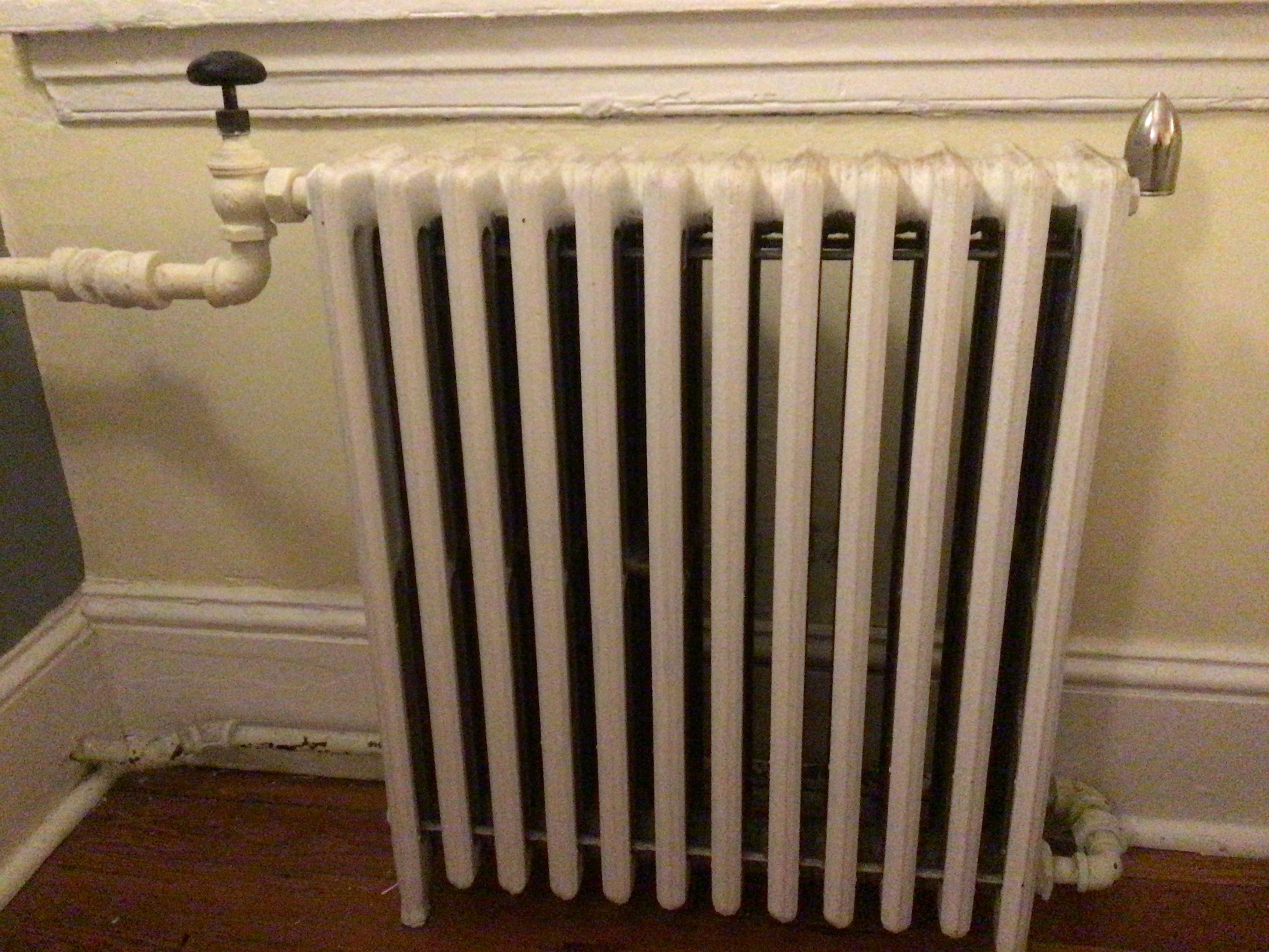

It appears that I have a couple of radiators whose air vents keep hissing even after the radiator has reached max heat. They eject steam.
The type I have are the pointy curved cone type. They have some kind of bimetallic diaphragm that bends at some threshold temperature and blocks the steam. Some work and some don’t in my house. So I plan to replace the faulty ones and maybe get a couple extra to swap out later.
I see there’s a few different types on Amazon and elsewhere are any especially good and reliable?
FWIW, I got 2 pipe radiators where steam comes in on one side at the top and the condensate pipe is at the bottom on the other side. The weird thing is that my air vents are not in the middle like you see in the texts, they’re mounted at the top (on the other end from the steam input). Is this a problem?

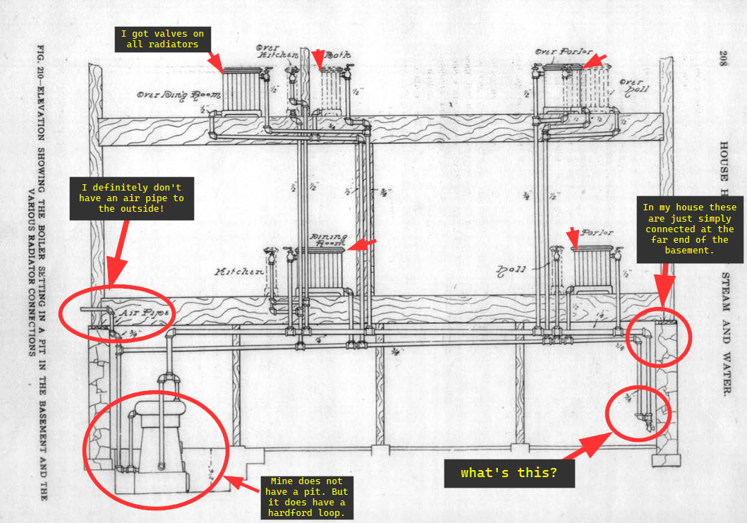

    Almost all of my radiators are like the photo i just added to post. The boiler is a modern Columbia, about 10 years old. The piping adjacent to the boiler is a mix of cast iron and copper segments. I just insulated the long runs of the copper this weekend.
    The house is 100+ years old, no idea when the steam heating was originally installed!
    I should add that the only vents are on the radiators, there is NO additional vent near boiler at all (is it called an “air trap”)? I expect that my system has had some bad decisions made upon it over the years!

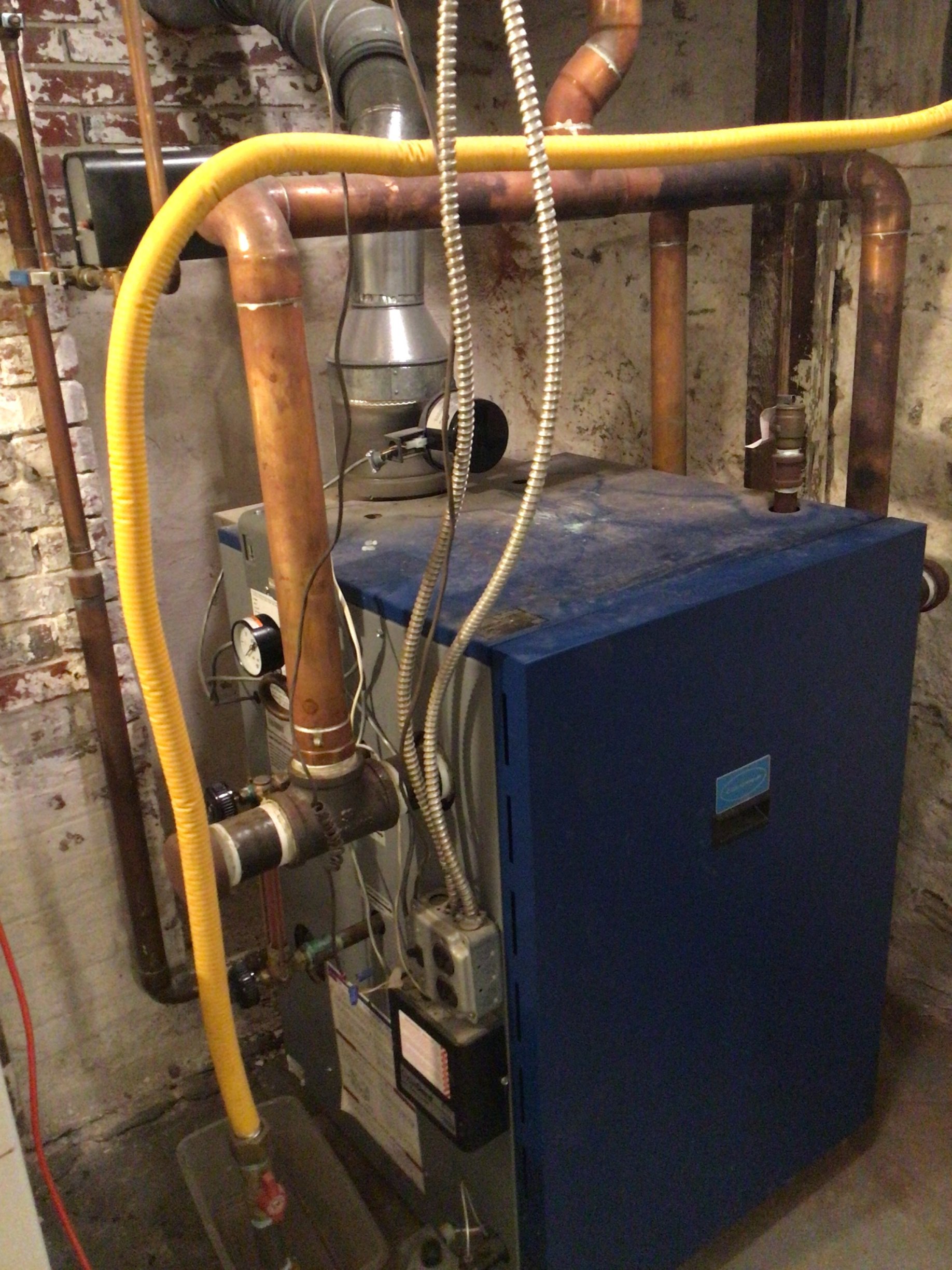

    We need pictures of the boiler and all the piping around the boiler from 8-10' back
    That system doesn't look like a two-pipe air vent system
    angelotrivellimattmia2
  • @EBEBRATT-Ed, Yes, those are copper pipes, and yes, the installer did not configure the pipes in the way recommended in the installation manual.
    The steam supply comes up from both sides of the boiler and then joins together before going up into the single steam supply line to the house. The condensate return goes down behind the boiler and a up through a hardford loop before entering the boiler.

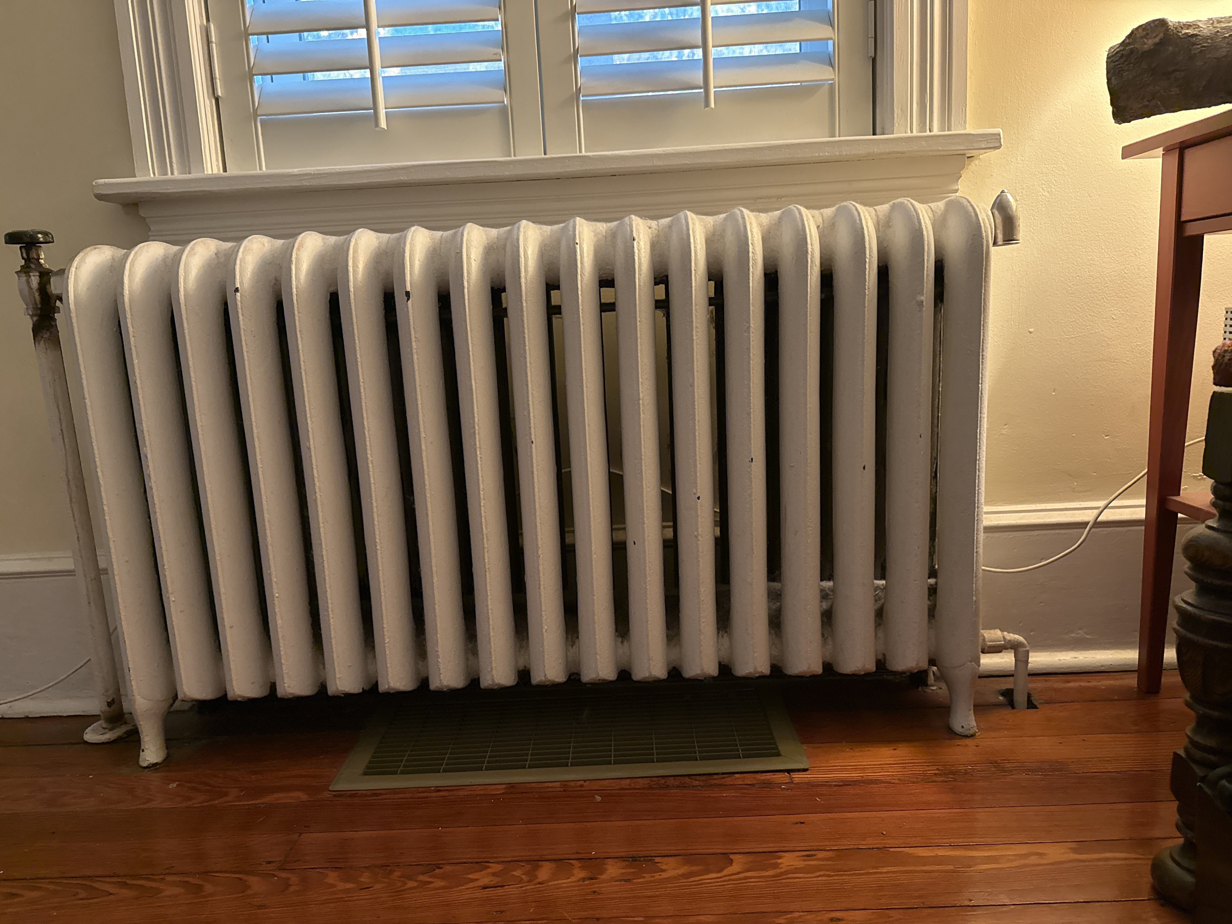

    can yu show us another radiator, maybe one that hasn't been moved. that radiator in your picture has been moved or added or something, that piping is really weird.
    109A_5 Posts: 4,759
    Without seeing more of the system I would say you would benefit from a main vent at the far end of the steam main. That way the steam propagation to fill the main is not restricted by the smaller vent rate of the radiator vents. Your system may have parts missing from typical or they were removed over the years, may never know.
    it looks like a gravity hot water system that someone stuck a steam boiler on, but we need to see more.
    here’s another radiator, this one is on first floor. It has a steam line and a condensate return, like the others. Also like the others it has a vent at the top and not the middle. The basement has 2 main pipes the larger one feeds steam to the radiators, the smaller one carries condensate back to the boiler. I will try to make a drawing later.

    Since there are no traps or other special elbows on the return, it's probably a variation of the Tudor system:
    https://www.heatinghelp.com/systems-help-center/european-heating-systems-circa-1907/
    Semi-retired
    Steamhead Posts: 19,007
    @angelotrivelli , you need to look for air vents on the return lines in the basement, most likely near the boiler. It's possible someone removed them during a boiler replacement- not the first time I've encountered this.

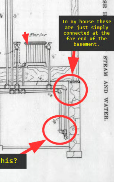

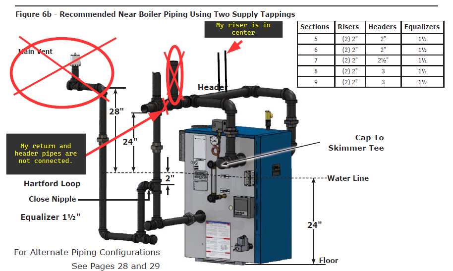

    @Steamhead, thanks that's very interesting. There are distinct similarities to my system. I've annotated the main differences below and also annotated the differences between my system and the installation manual for my columbia boiler. I am sure that I have no air vents (I've looked carefully). The only venting in my system are the radiator vents.

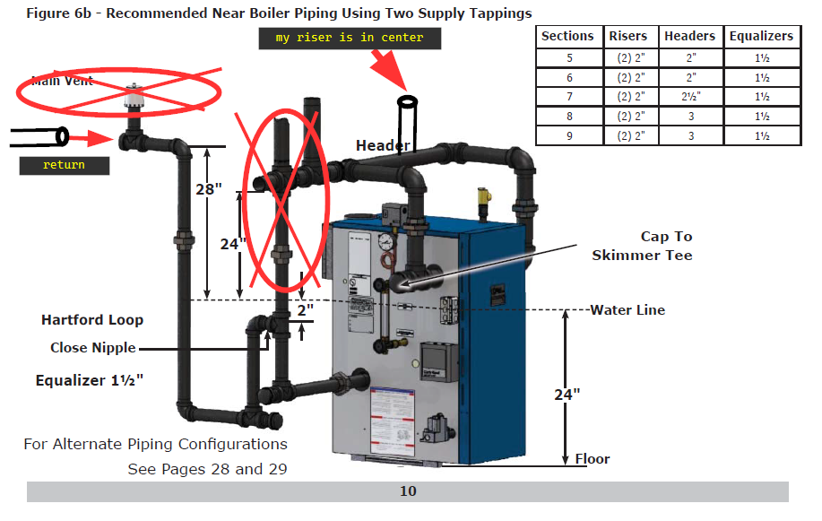

    This is the best I can do to describe the system without taking measurements! I started this post asking about air-vent recommendations, but it seems my whole system is now in question 🤣That's OK, it's never too late to understand what's going on in one's own house! Appreciate all the wonderful knowledge sharing here!

    Your vents are probably Hoffman 40's, a good relatively slow vent. You can still get those. Regardless of how incorrect the near boiler piping is and whether the system is as originally intended or not it is going to need main venting now to take the load off the radiator vents. Look for a place to add them either right after the last takeoff from the main or at the end of the return before it drops down. If you can give us the total length of your main and the pipe size we can suggest a main vent. Also, do the normal things like making sure your pressuretrol is set sufficiently low (cutout ~1.5psi and cut-in 0.5psi) and that you pigtail is clean so actual pressure can be seen by the pressuretrol and gage.
    The new rad picture looks like it has a copper return. Probably easier to add the vents at the boiler before the returns drop down.

    @dabrakeman Thanks, yes, they're Hoffman 40's. The pressuretrol lever is all the way down, the gauge reads just under 1 psi. Gauge goes all the way down when the system is cold, so that's a sign that it's OK. Unfortunately I can't clean it because I can't untwist the pigtail from the gauge and I don't want to muscle it and risk breaking the gauge and or pressuretrol ! Will have to try some WD-40 next time (or get a spare gauge/pigtail/pressuretrol in case I destroy mine).

    I have to agree with others on this one. There is such a thing as 2 pipe air vent systems, but they have differences from yours. First, the radiators are connected at the bottom on both ends. Second, they typically use larger piping than you have. In addition, the air vents on your radiators are in the wrong location, indicating addition at a later date. For me the top feed connection is a dead giveaway of this being a 2 pipe system.
    The pipe running to outside could have confused an installer so they disconnected it on boiler replacement and eliminated all air venting, then the system wouldn't heat and in their infinite wisdom they added vents to all the radiators instead of in the basement where it should have been.
    The circle you labeled as the pipes are simply connected at the end. Does anything in that area appear newer? That is a trap meant to hold water to keep steam out of the returns. That would be notorious for rusting out and needing replaced. Again a less knowledgeable installer may have not understood it as other steam systems are simply connected at the end, so they did that when pipes rusted out. Sometimes the presence of pipe dope or PTFE can indicate newer piping.
    The boiler piping as you've already noted is incorrect. Appears to be a colliding header which is one of the worst offences in near boiler piping. At this point I'd have it low on my list of issues. Getting the rest of the system sorted would be my priority.
    2014 Weil Mclain EG-40

    @KC_Jones , @dabrakeman , yes, the piping in the basement is mostly copper, but the vertical pipes (risers?) that go through the floors are still cast iron. I suspect that the copper piping was installed ~20 years ago.
    This i believe is just a water seal with some cleanout fittings at the bottom, it allows condensate to run from the supply to the return while blocking steam (and air).
    It sounds a whole lot like someone who knew nothing about steam tried to rip out and replace the mains (or scrappers got to the house and stole the mains). Stream mains should never be plumbed in copper.

    The mismatched radiators and copper return make me wonder if the radiators were missing too and were replaced with salvaged ones.

    I understand that it's bad to have copper piping for the boiler header because the cast iron and copper have different thermal expansion coefficients. But why is it a problem on mains? I have asked plumbers about this and they just say that copper is "better".
    FWIW, it's really, REALLY hard to find competent plumbers with steam experience willing to work on residential where I live (Philly). I basically feel like I am on my own.
    The conductivity of copper is a lot higher than black iron. It cools and condenses the steam in the mains a lot more than black iron.
    The bigger concern with seeing it is all replaced with copper it that it was clearly done by someone that didn't understand how steam works so they wouldn't have installed it to properly manage steam, condensate, and air.

    However, it would be good to replace the header and supply tappings on the boiler with cast iron. I would also consider to eventually have the main runs replaced as well. Unfortunately, I don't know anything about cast iron and it's probably illegal for me to do it myself.
    I would not tackle repiping during the winter. Check the pitch on all the piping and do what you can to see if it is pitched properly and add air vents as needed.
    Copper is what it is. It would be better if it had been steel pipe. Just live with it and hope it doesn't become an issue you can deal with it down the road.
    If you can get the pitch and vents done the system should work. Then you can deal with replacement. Maybe you can entice @Steamhead to fix it or consult.

    If you have vents on the radiators and put main vents at end of main and insulate the copper (guess you did that) I don't see why this shouldn't work. In essence would be no different from my one pipe system that has drip legs back to the main extension from each radiator.

    Two questions about the main vent(s):
    Should it go on the return pipe, right before the pipe turns downwards towards the hartford loop, or should it go at the "u-turn" where the main pipe "becomes" the return pipe?

    I am thinking about doing 3 things (I would probably have a plumber do at least the vent & trap):
    1. Add a crossover vent (aka steam-trap aka thermostatic trap?) at highest point of the main where it u-turns and becomes the return. A Hoffman 17C seems to be the right one for my 35 foot long main.
    2. Add a main vent at the end of the return right before it turns down to the boiler. I am thinking a Barnes and Jones "Big mouth air vent".
    3. If everything is still working, I will then replace all the radiator vents with plugs. I know that these are just 1/8 NPT fittings, so I would just use brass plug w/teflon-tap, after cleaning the threads with a tap.
    At that point, it will be a "2-pipe" system with the difference that the one pipe is at the top of the radiator and one pipe is that the bottom. If there's problems, I can always put back radiator vents (1/3 from bottom on the radiators that have a flat I can drill on).

    ""Add a crossover vent (aka steam-trap aka thermostatic trap?) at highest point of the main where it u-turns and becomes the return."
    I thought you had parallel flow mains (highest point is back at the boiler and they slow AWAY from the boiler (at least 1" per 20ft)?
    the connection to the returns with a vent is NOT the same as 1 pipe with a main extension. steam must be kept out of the returns because it can follow the return connection to the radiator and close the vent before steam has filled the radiator.
    you will also have to either keep the boiler pressure low with a vaporstat and add orifice plates to the radiators or add steam traps to the radiators to keep steam from passing through the radiators to the returns
