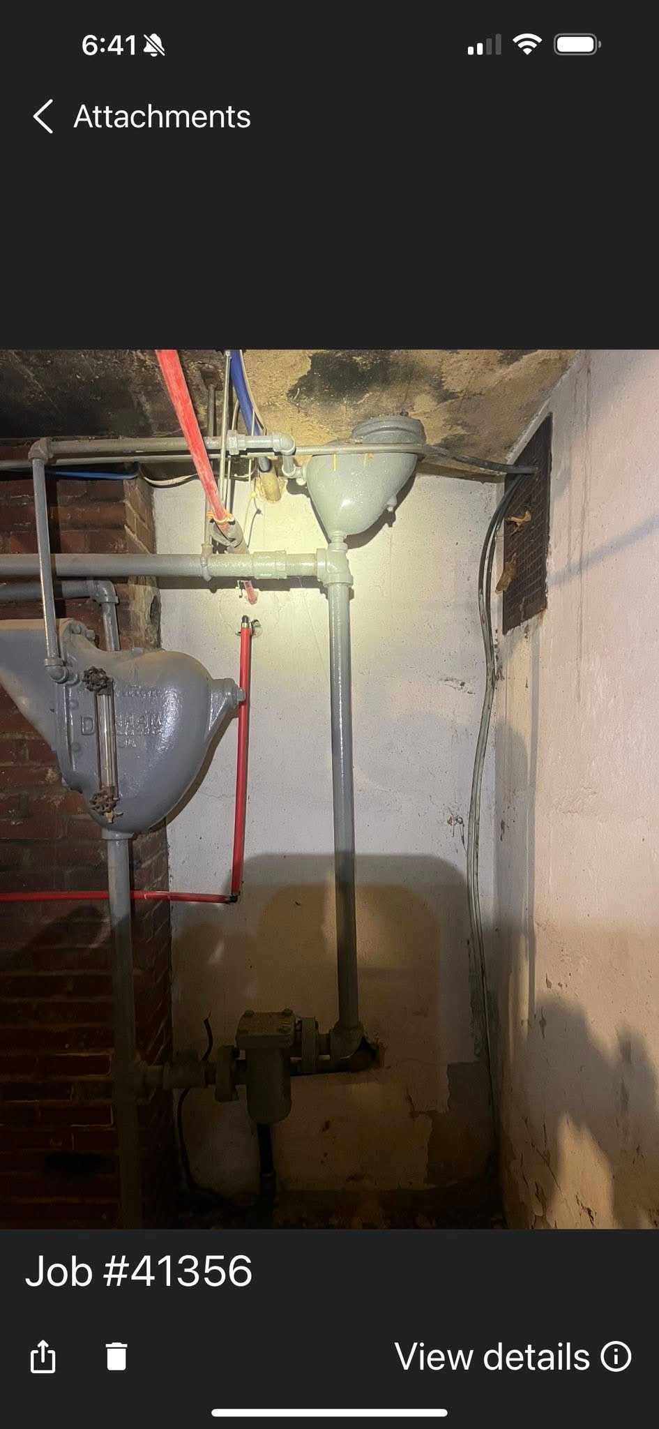

here is a picture of two traps at a house. The top one has a very small steam (vent I assume) on top of it. I found the patent here on the Dunham but didn’t see the gauge glass in that design. Any easy way to test them?
@DanHolohan book "lost art of steam heat" describes their operation. The one with the sight glass is an alternating receiver. It uses steam pressure to push condensate into the boiler.
1 -
the upper one i believe is an air vent. neither are steam traps as you would understand them it means this system is a vapor system and needs to be treated accordingly, not like an ordinary 2 pipe steam system.
