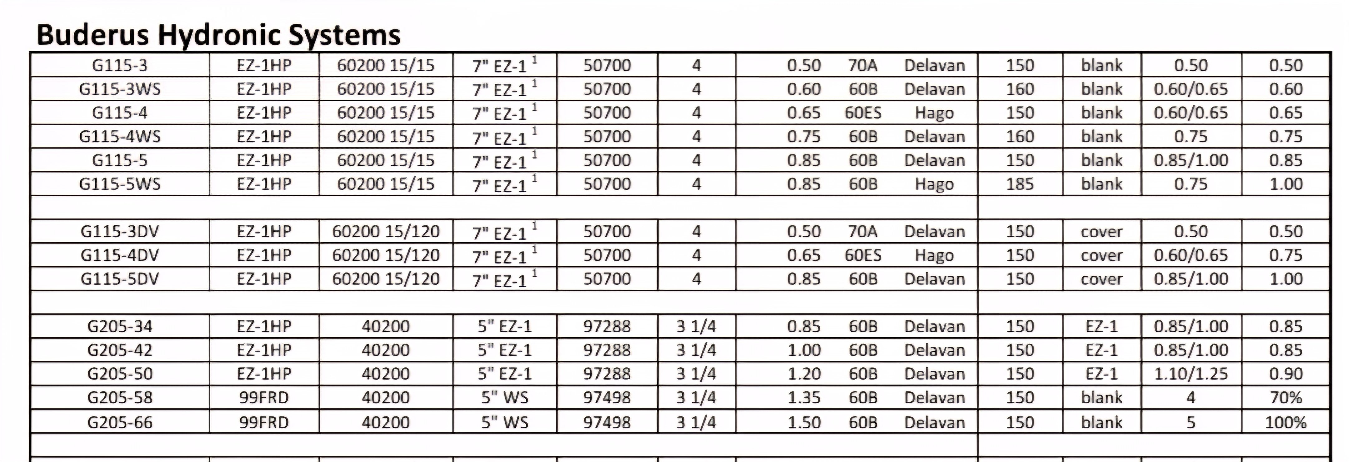

I’m using an ex1 with 7” tube. Going to set it up as recommended by the Carlin burner tables. The flange is welded to the tube.

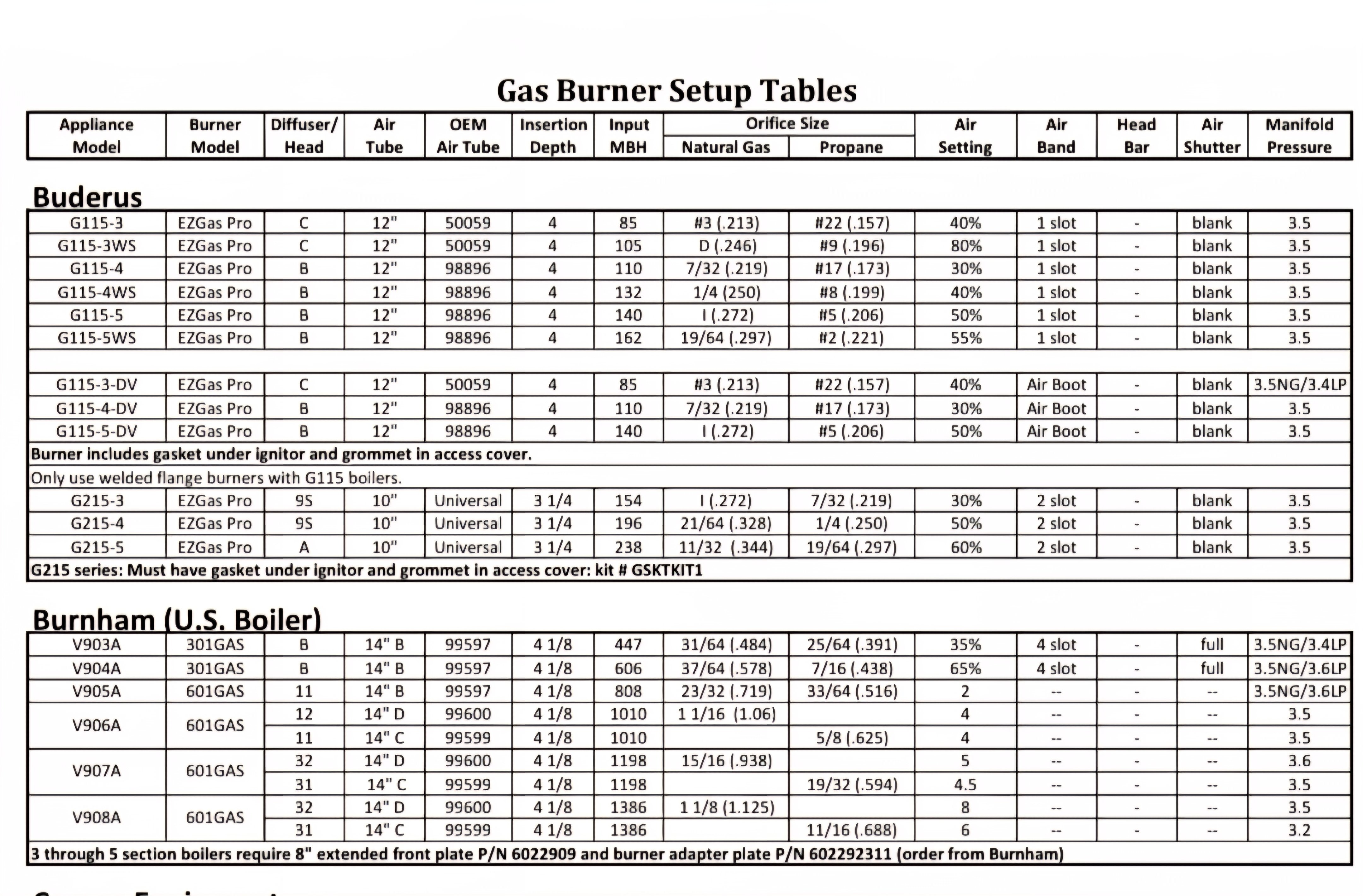

Ok, unless my Carlin OEM manual is wrong, they want a 12 inch air tube with a 4 inch insertion. Are you a licensed contractor?

Wrong chart that is for gas. This is oil right?

Ohh, that's different. An Emily Litella moment.
Never mind.
