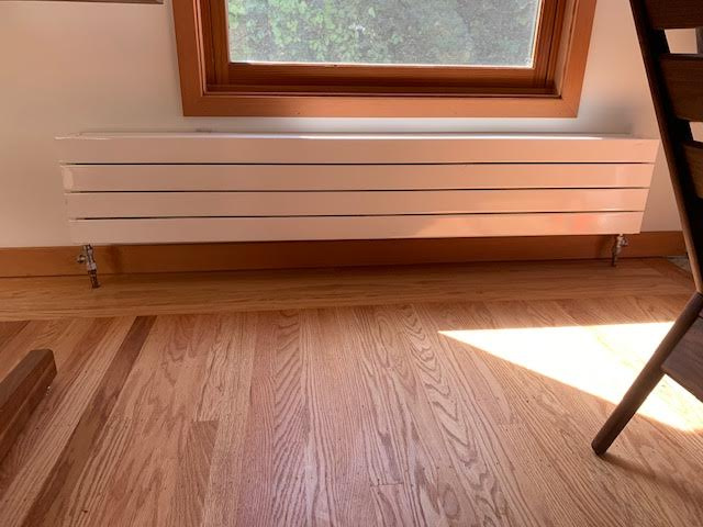

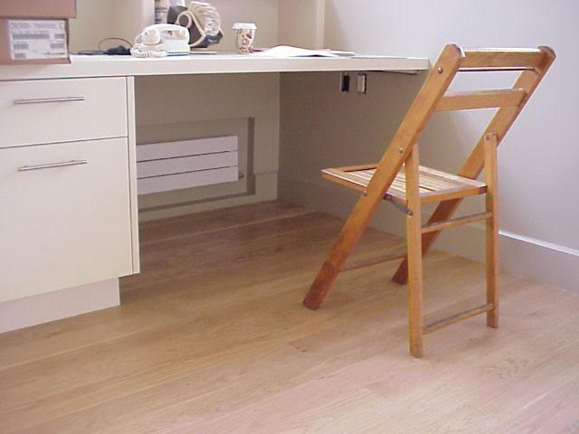

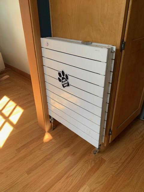

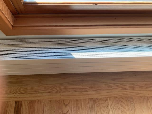

  • Baseboards are ugly, fall apart after a few confrontations with the vacuum cleaner and dust collectors. Output is limited: 500 BTU's per foot.
    Panel rads are pretty and output is vast depending on size and thickness. They are also expensive.
