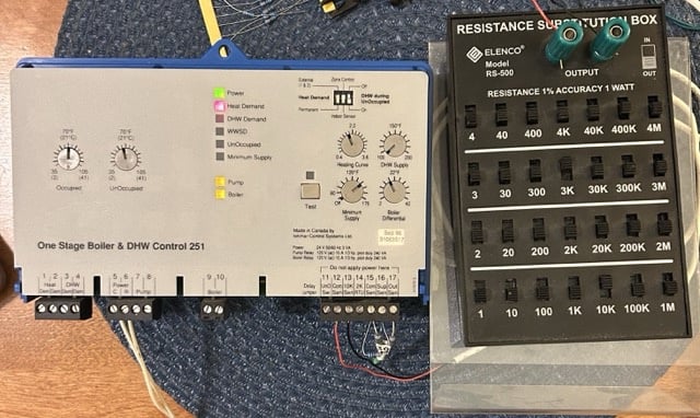

Hi everyone,
Sharing a little project I set up to better understand the older TekMar 251boiler control.

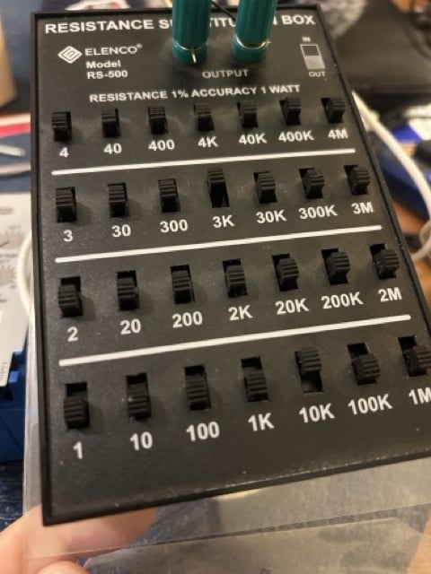

I simulated the following using resistor values:
  • 32F outside temp (using 30K resistor)
  • 140F Supply Pipe (using 3.3K resistor)
  • Variable room temp simulation using a resistor substitution box.
This is teaching me how the device responds with different sensor settings.

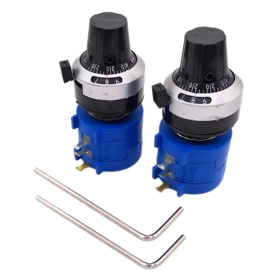

    Since a real live operating system is more dynamic than fixed resistors, I probably would have used 10 turn potentiometers instead of fixed resistors. Depending on what you want to learn you could automate the process.
    One variable resistor example.
    US Stock 2 Sets 100K Ohm 3590S Potentiometer 10 Turn Counting Dial Rotary Knob
    https://www.ebay.com/itm/401564815576
    AlwaysLearning2024
  • Thank you @109A_5 ! Great idea!

    Yes if you know the sensor (thermistor) resistance range you want, you can refine the variable resistors used and use fixed resistors to more closely define the variable range.
    The numbers on the scales on the simulator seem odd.
    109A_5 Posts: 4,759
    109A_5 Posts: 4,759
    OK I think they are fixed values of resistances representing specific temperatures and not variable like a potentiometer. A thermistor would be variable. I guess whatever works best for whatever you are trying to achieve.
    there usually is a chart for the thermistor values in the manual. you could use a pot and fixed resistor in series to simulate normal temps. looking at those temp values you might need a log taper pot.
    109A_5 Posts: 4,759
    I doubt a log taper or audio taper pot would match the curve of a thermistor, I would think using the "Counting Dial Rotary Knob" it would be easier to track the resistance of a 100K Pot, 10K per turn and the knob has 100 count indexing.
