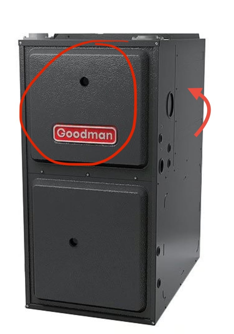

  • A bit hard to describe, but focusing on the furnace cover I circled and then side panel where I drew an arrow. I guess envision the act of breathing: The furnace cover looked like it was pressing into unit as if it wasn't tightly bolted in, I have it bolted on pretty tight. And then a tiny section in the side panel flexed a little—imagine bending inward—into the unit and then 'popped' back out in a split second.

    is the combustion air piped directly in to the burner or is it open to the inside of the cabinet and the burner is sucking from inside the cabinet?
  • It's the latter, the outside air intake pipe comes into the top and is open to the inside of the cabinet.

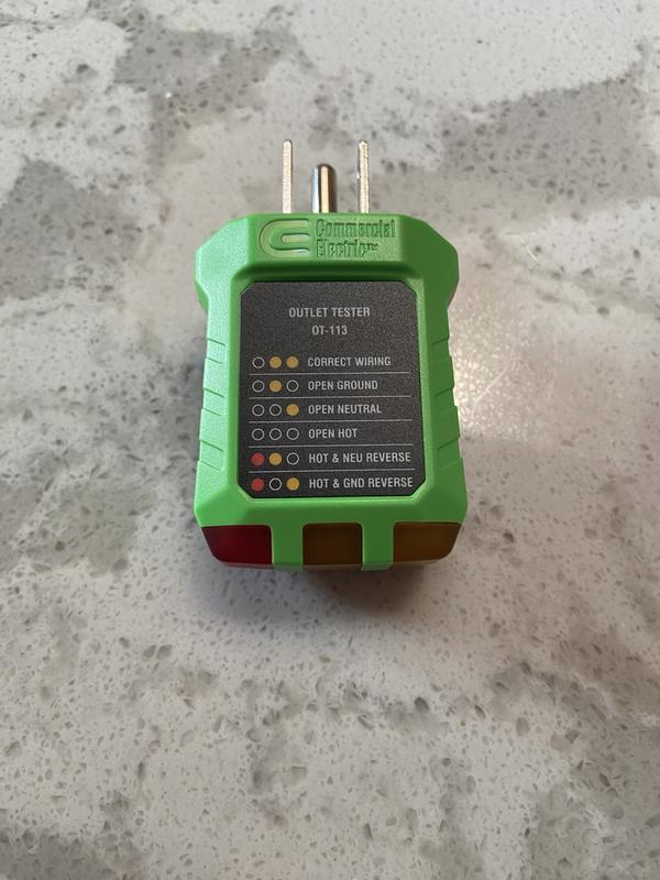

    "reversed 115 VAC Polarity error code" I would want to verify the polarity of the receptacle that the furnace is plugged into. Available at Home Depot. (Electrical Polarity Tester)
    If the polarity at the receptacle is ok, it's possible that the wiring of the power cord connection in the furnace j-box is reversed.

  • Has anyone checked to make sure you are not drawing products of combustion back into the intake vent? I'm speaking of this happening outside of course. I have seen what you are describing with the cabinet sucking in and every time it is due to recirculating flue gases.
  • Tech blew out the intake and there was no blockage. Running it with cover off does help slightly, but system still cycles on and off with the pressure switch.
