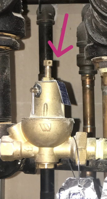

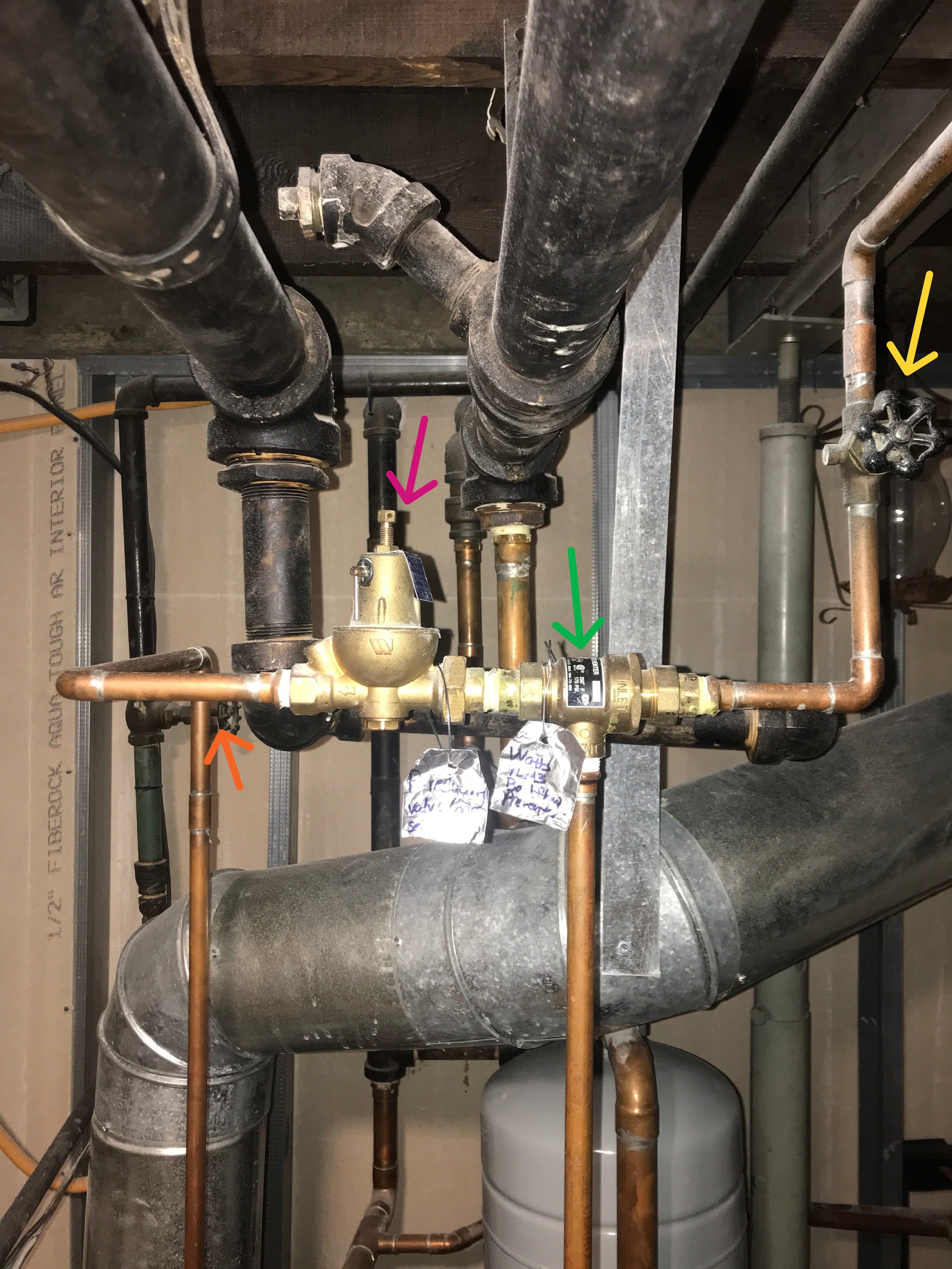

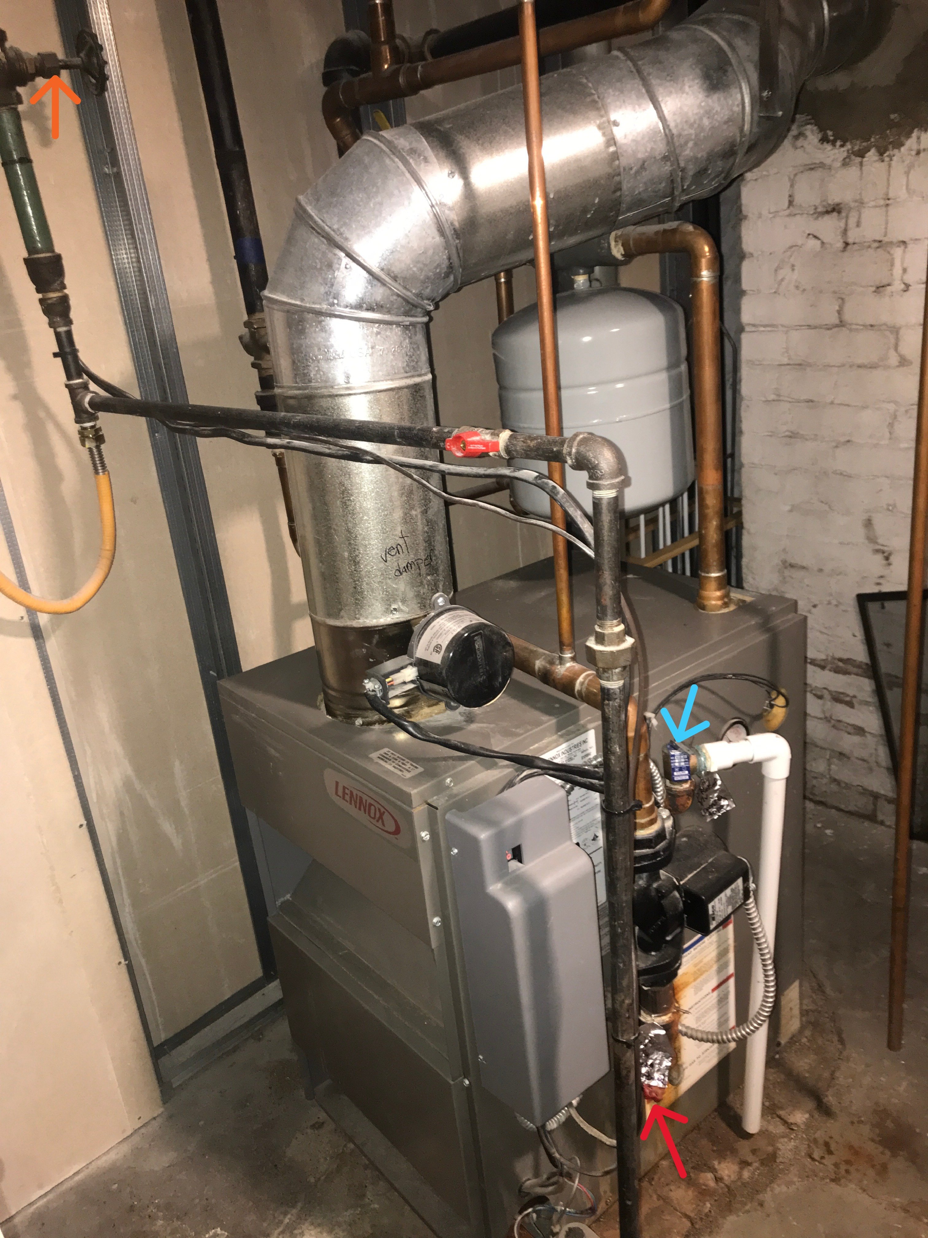

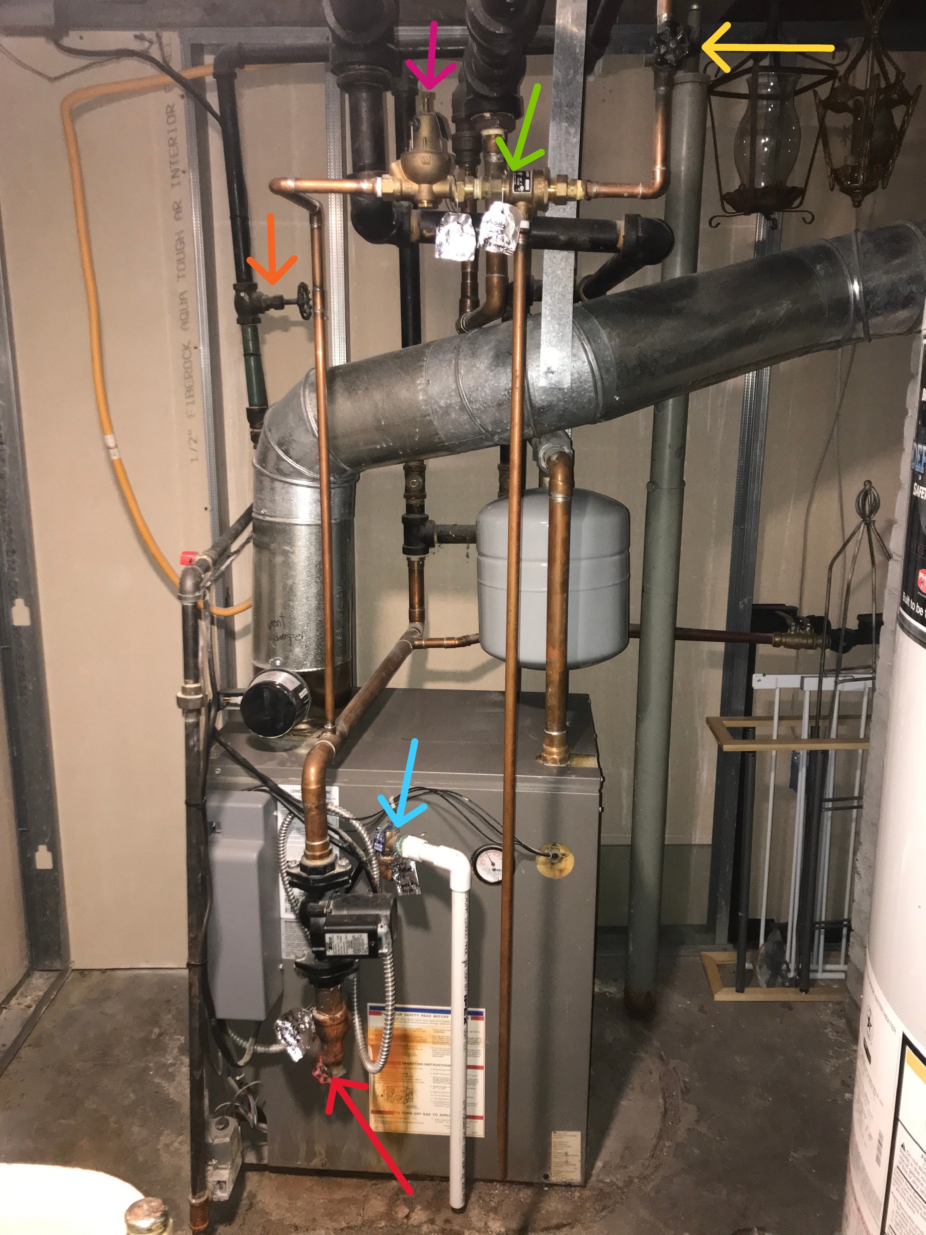

    Pictures (from a bit back) to get the whole boiler and piping in. Or as much as possible. A diagram would help as well. Does the fast fill valve work? If so you can fill to the desired pressure about 20 and run the circulators. Depending on the system the air might come out on its own.

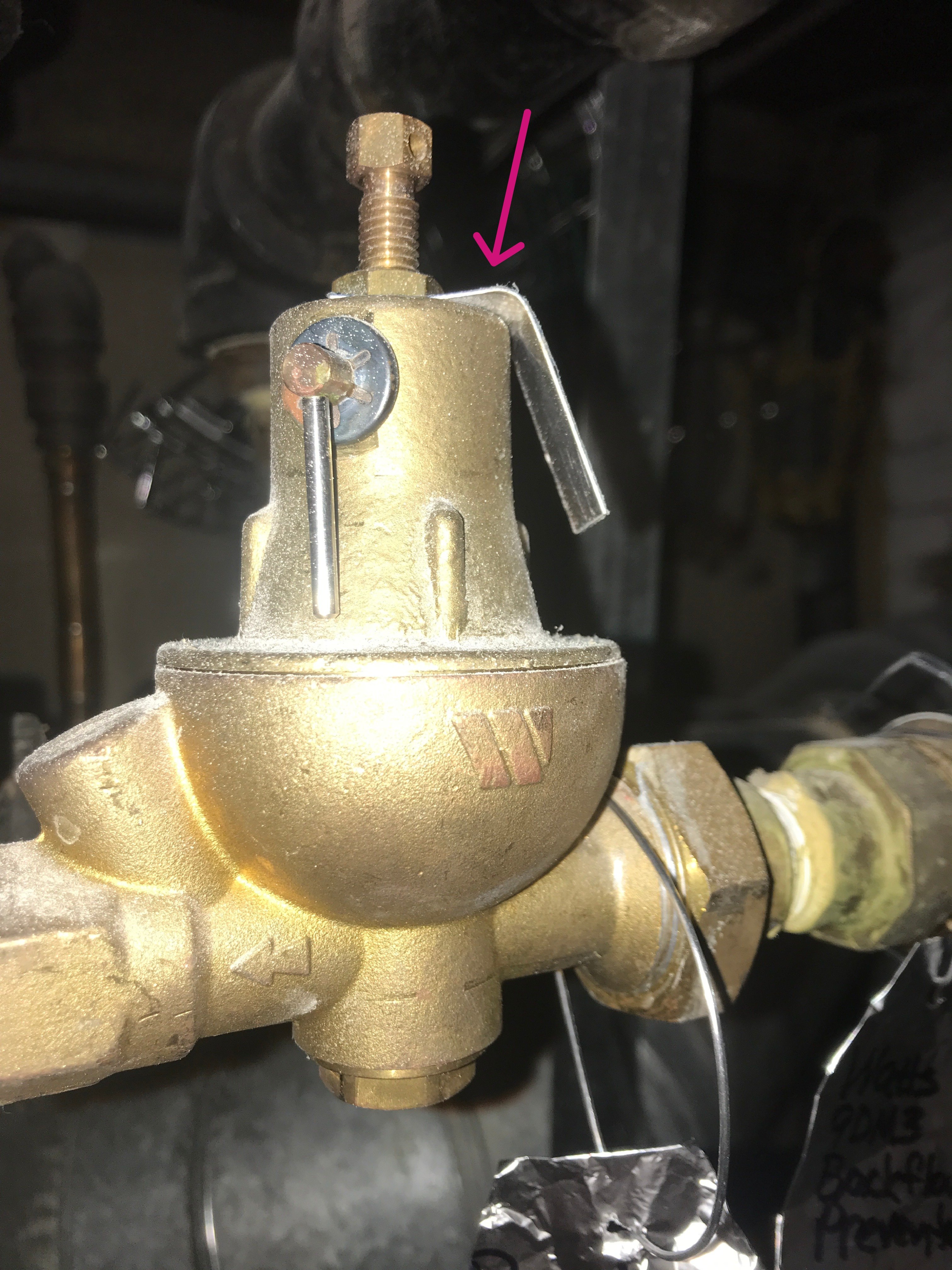

    I don't know if fast fill valve works — would i just lift the lever and listen for water flow to find out? I did wonder if I could just fill and skip the draining part as a 1st try but the videos seemed to emphasize the draining so wasn't sure. If I can fill-only, wondering if the mystery valve still needs to be identified and closed…

    You don't need to do anything but lift the fast fill. If the PRV is not working on its own it may need to be replaced. Make sure any valves between the cold water supply , through the PRV and into the boiler are open. Pictures may help if you have a backflow preventer before the PRV that could be the issues.

    it is not uncommon for a fill valve to over pressurize if it has not been used in awhile. Stay under 25 psi.
    So keep an eye on pressure as you engage fast fill
    Be prepared to shut off a manual valve at the fast fill

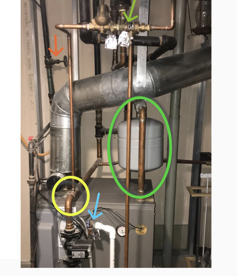

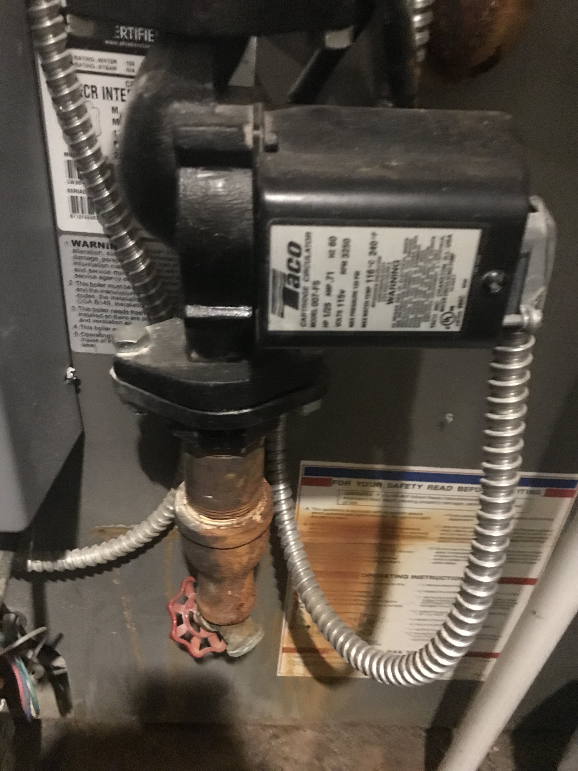

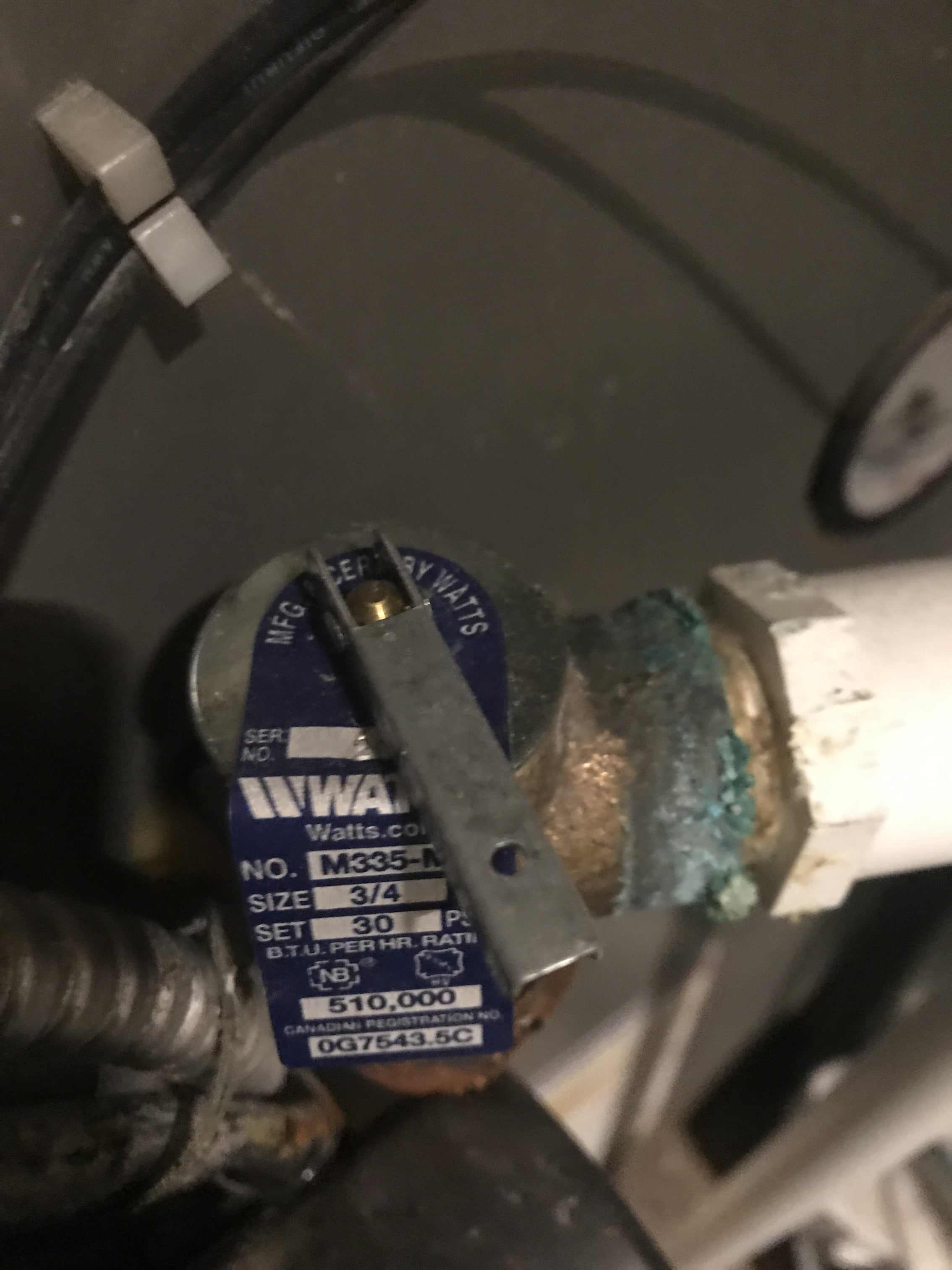

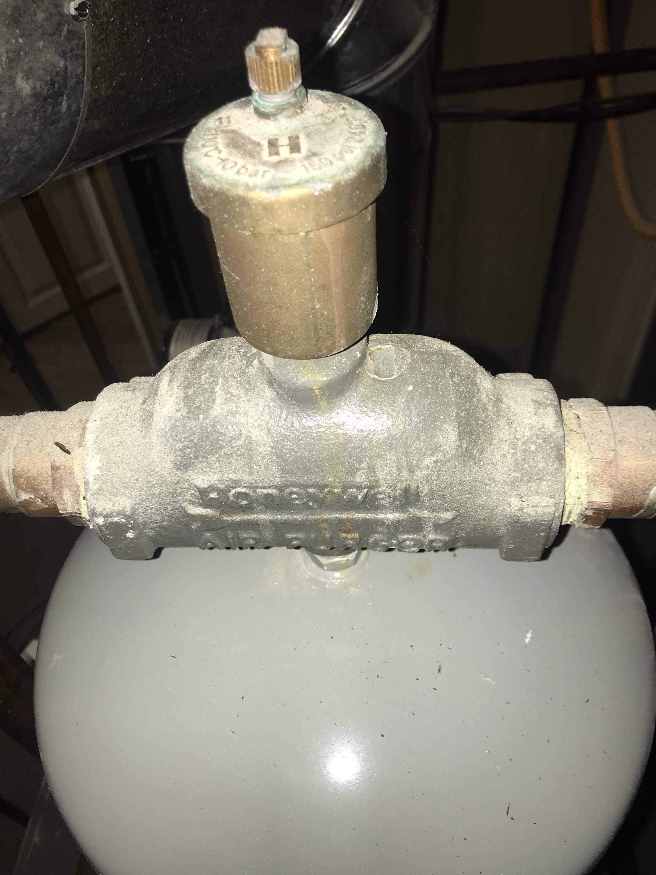

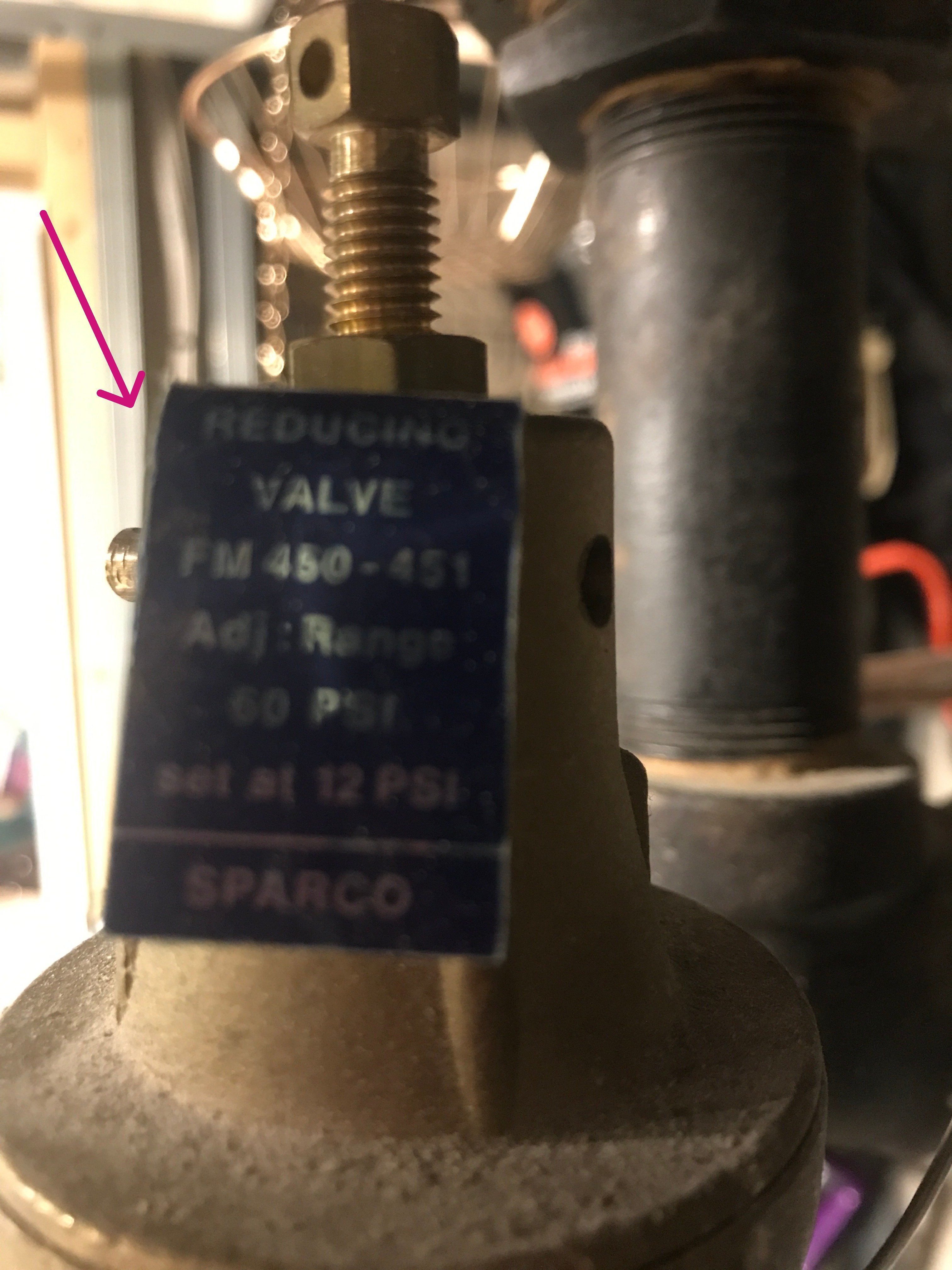

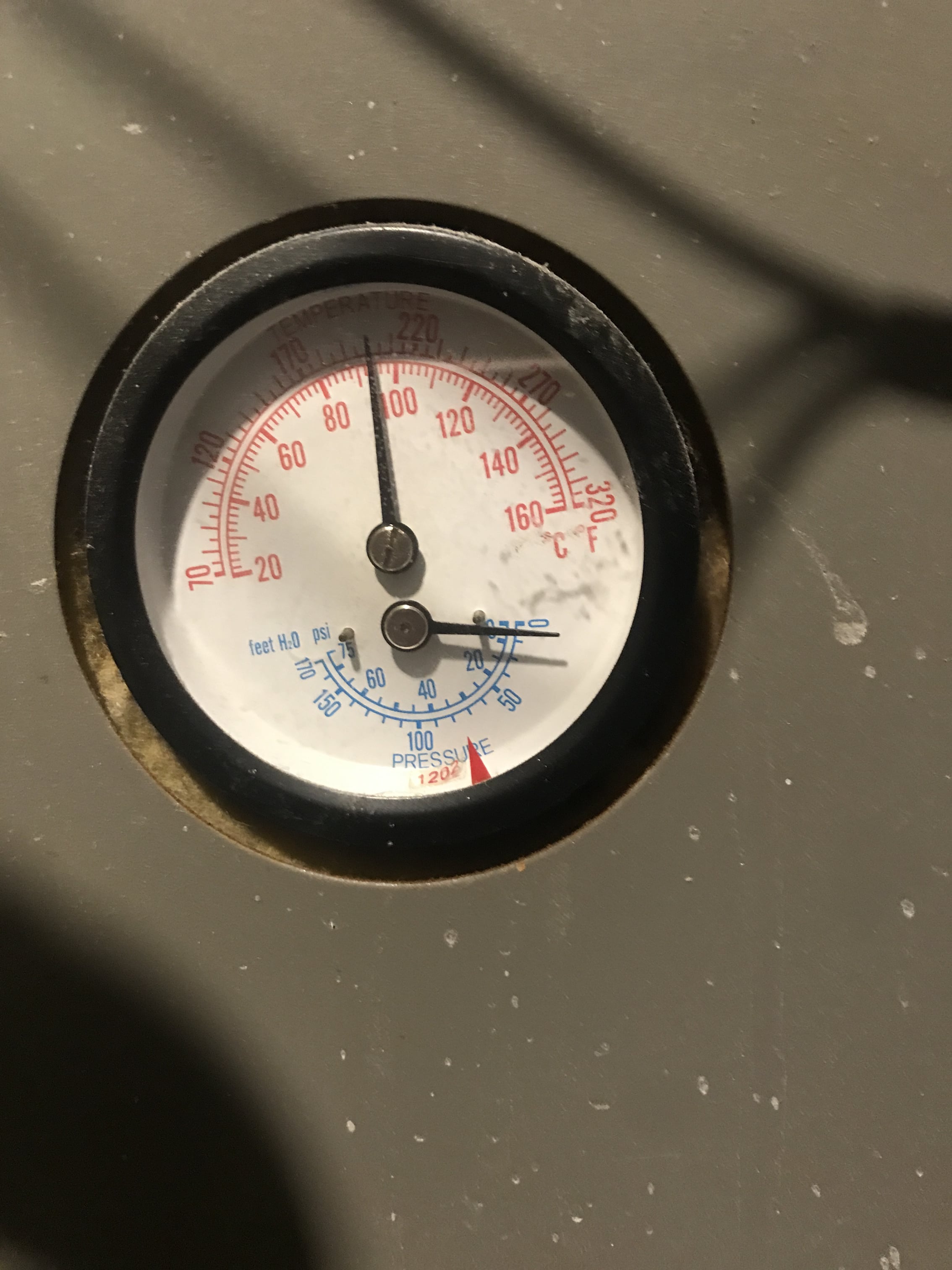

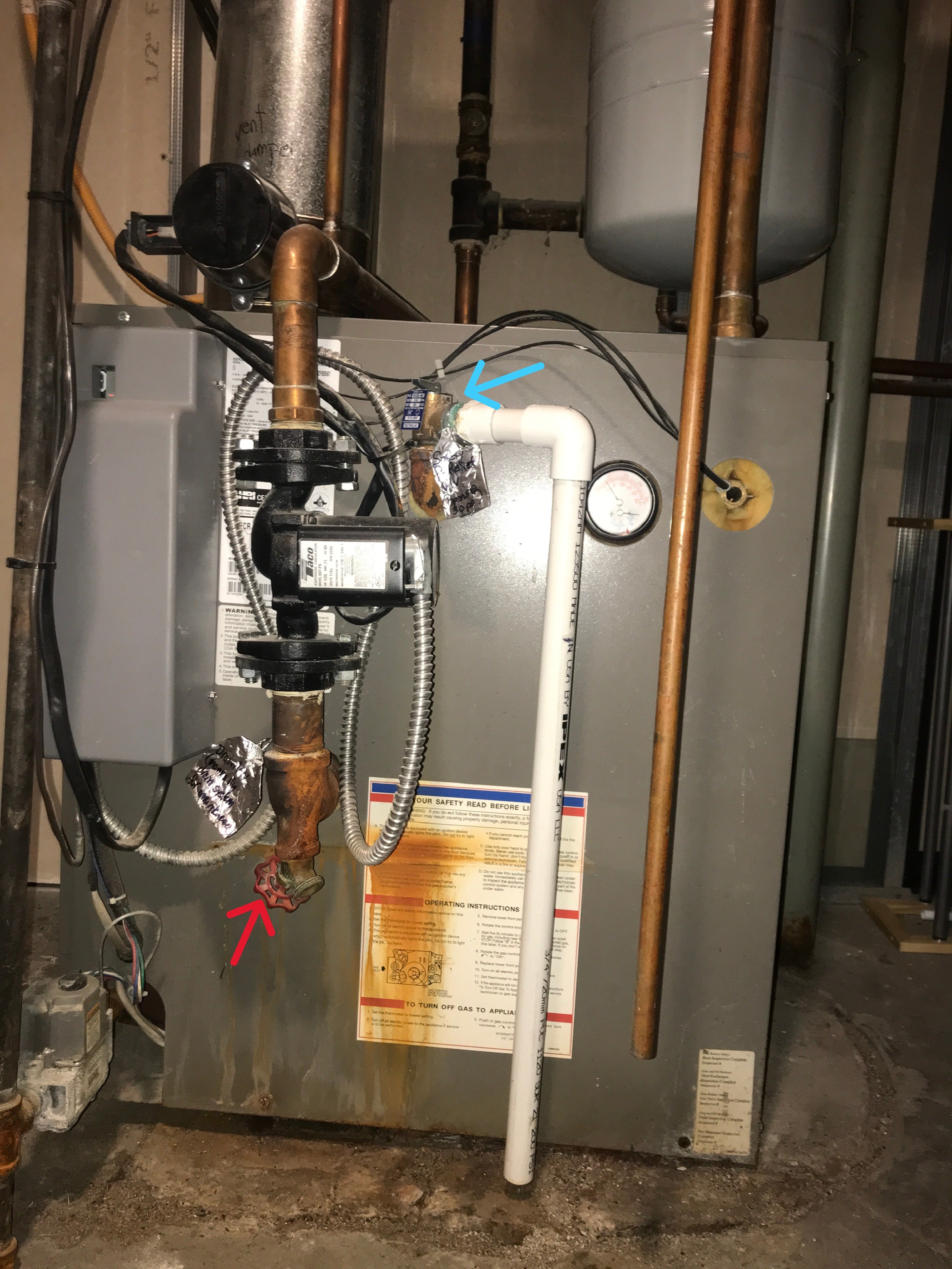

    Struggling with a diagram that makes any sense but let's see if these pics work. Color code (arrows) is: yellow = valve from water main. green = Watts 9DM3 backflow preventer. pink = FM450 P reducing valve / fast fill combo. red = drain valve. blue = Watts M335 safety P relief valve. orange = valve on pipe going to radiators (isolation valve for maintenance?).
  • Bungalowgirl228
    Bungalowgirl228 Member Posts: 18
    Sorry if this is too many pics, and please ignore my homemade foil tags!

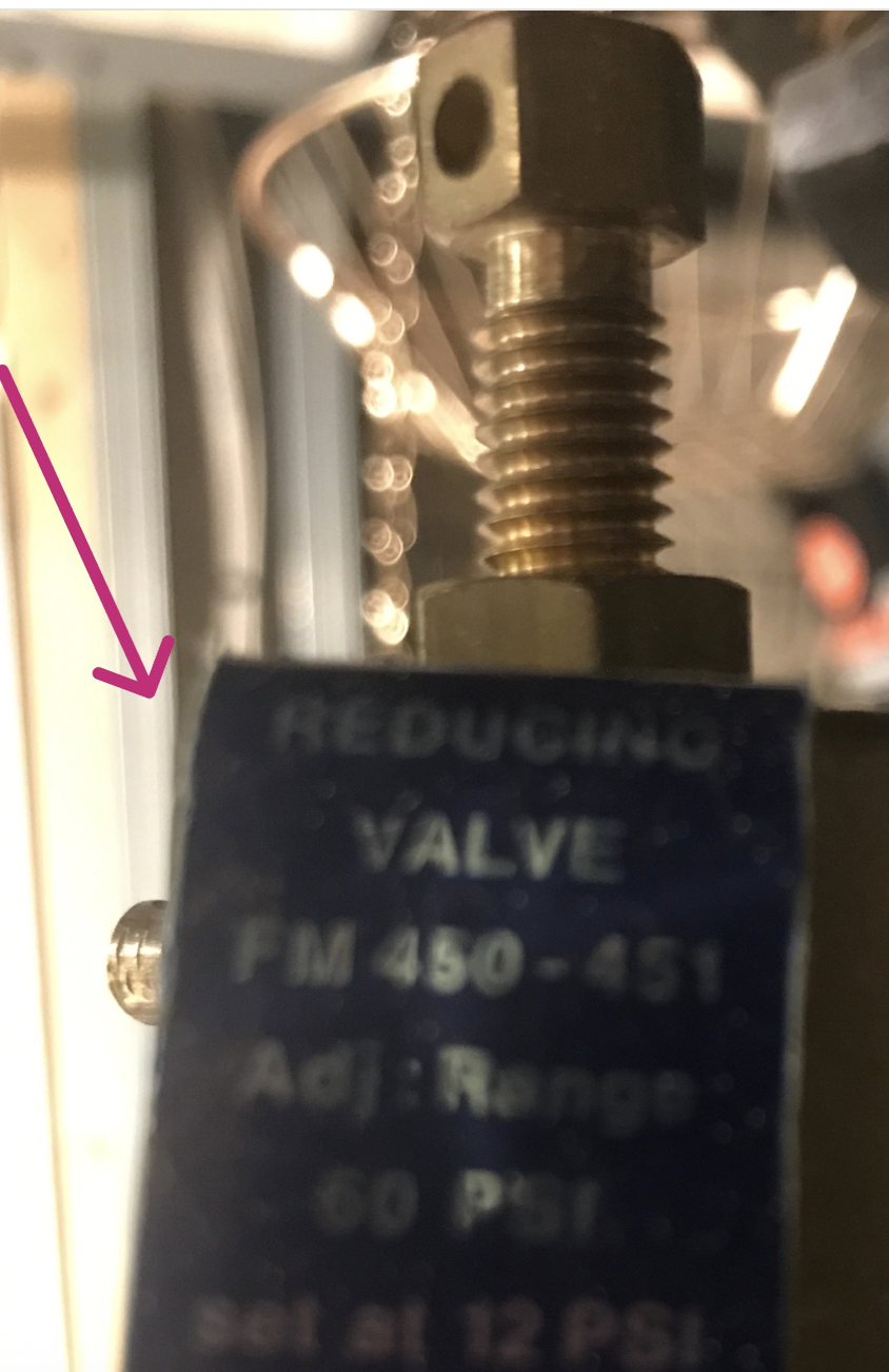

    loosen the bottom jam nut, turn the upper hex clockwise to increase pressure. Slowly

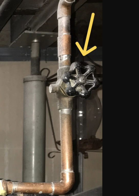

    Assuming that wheeled handle valve upstream is open fully CCW?

    \The lever on the side is the fast fill enable, flip it to fast fill. But to increase permantley, the nut and bolt on top

    Well, here's some maybe key info: that black handled upstream valve is turned fully CLOCKWISE (so closed, correct?). Is that ever normal? If it's been closed then there's been no access to supply water, correct? (I certainly didn't close it, this was to be my first attempt at anything on the boiler. It would had to have been done the last time it was worked on, a couple years ago.) The system is on now b/c it's cold out but should I just turn system off, let it cool and then turn the black valve totally CCW / open and see what happens?
  • psb75
    psb75 Member Posts: 1,153
    Correct. Black valve was closed. Open it so that the automatic fill valve can add the proper amount of water to whatever pressure setting it is preset for. 14-15 psi is normal. This should be done whether the boiler is running or not. If you are certain the auto-fill valve is working properly, let the system run a proper cycle and then bleed any air out of the system manually if you have bleeder valves out on the radiation system, baseboard etc. There should also be some automatic air bleeding mechanism near the boiler. Noise of air sloshing in the pipes is an indication that you need to fill and bleed. Also if there is no heat in the pipes during a call for heat to the boiler that also means there is probably no flow and somewhere the system is "air bound"— often at the circulator.

    I am not aware of an auto air bleed mechanism near the boiler but if someone provides direction, I'll try to locate it.

    Let the boiler cool to 120 or so. Then open the manual valve (counterclockwise) you should here water running into the boiler.
    Sometimes the PRV valve may leak by. You want the pressure around 15 psi. If the PRV leaks by the pressure will go up. If it get to 20 shut the manual valve and have the prv replaced. You can run it , bleed it fine just control the water pressure manually until the prv gets changed.. Keep in mind that the water pressure will vary as the boiler heats and cools. When the water is heated it may rise to 22 psi or so. This is normal as long as it doesn't continue to rise

    3. watch pressure gauge; since PRV is set at 12 psi (per the tag, though I guess could've been adjusted since then), system should stay (on its own, even with water supply valve open? so in other words, is that the correct default setting for this valve?) near 15 psi, correct?
    4. continue to watch P gauge; if it goes up to 20, may indicate PRV is leaking so close water supply valve and get PRV replaced

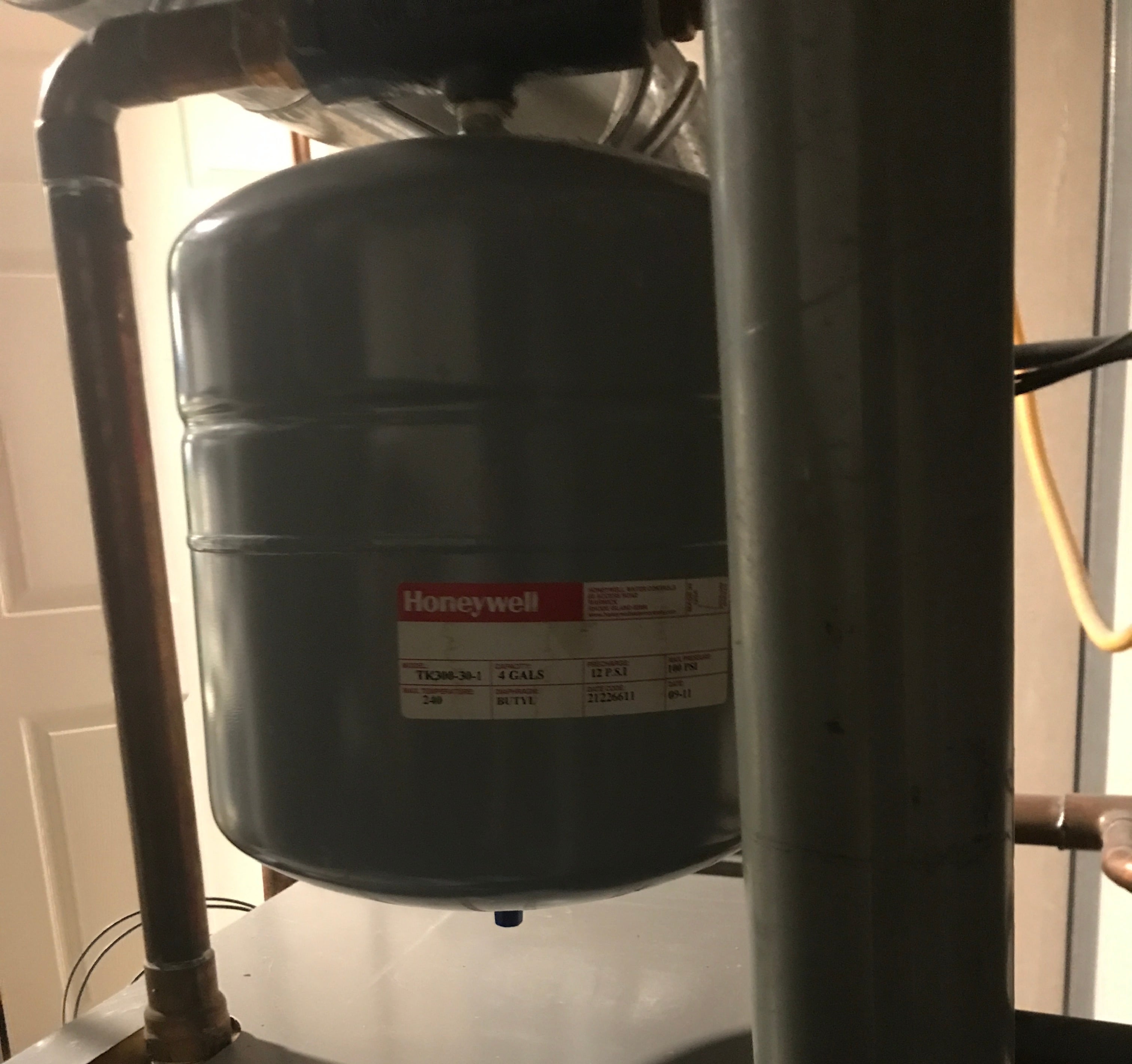

  • neilc
    neilc Member Posts: 3,196
    while the pressure is as low as it is,
    check the expansion tank air pressure, and check no water comes from the schrader valve, set the air pressure to 12, 14-15, that you want your water fill pressure to be,
    check the tank before you add water pressure to the system.

  • Bungalowgirl228
    No water dripping from schrader valve but tire gauge is indicating no air pressure in the expansion tank, which shows an installation date of 2011 so…probably time to call in the pros, but with much more knowledge and confidence than I'd have without you. And I'll now watch what they do and understand, ask questions and (probably) understand the answer.
    I can't thank each of you enough for all the info and patience, it's amazing to me that you are 'out there somewhere' and willing to take the time to help people like me. Thank you for what you are doing!
    mattmia2 Member Posts: 17,433
    with no water pressure in the system take a tire pump or compressor and fill the tank to the cold fill pressure of the system. the air tends to leak out of the schrader and maybe diffuse through the bladder over a coupel years and it needs to be charged every once in a while.

    Update: Pumped with bike pump into the expansion tank until tire gauge read ~8 psi then decided to get the compressor to finish. By the time I got back to it a couple hours later, tire gauge on expansion tank once again read zero. Current questions:
    1. Does this likely indicate a bad bladder / need for new expansion tank, so leave it be, or OK to try again with the compressor?
    2. Given how low the pressure is, OK to still open the water supply/feed valve and allow some pressure to build up, to see if it helps the 2nd fl heat a bit, or would that be detrimental if the exp tank is faulty?
    As ever — thank you!
    try some soap on the schrader to see if it bubbles, it might just need a new core. it should hold pressure if you put the cap on tightly even if the schrader is leaking. the bladder also might have been stuck and got unstuck and released the pressure. With a good bike pump it shouldn't take much to pump it up. I'd try the compressor and see if it leaks from the schrader or if you can't build pressure before condemning it. Is the system open so that the pressure can escape from the water side if it is leaking out there?
    if it is bad you will get water on the air side eventually if you re-pressurize the system. Ideally you wouldn't run it with a bad tank but you could run it enough to keep the house from freezing up until you can get a new tank if you keep an eye on the pressure and make sure the relief valve is working.

    Update:
    Soap on expansion tank Schrader valve did not bubble. Also, tapping on tank's side, sounds seemed to indicate hollow/air on the valve end of tank and not hollow on the connected / bladder end of the tank. So maybe tank is OK?
    Recharged tank with bike pump to ~13 psi and put cap on tight. (Gave up on new compressor for now: purchased air hose with plastic connectors where I expected brass, like compressor itself, and never did get the right air-hose-to-Schrader connector, but bike pump worked fine.) I could hear the bladder groan ever so slightly when I inadvertently pumped to just over 15 psi; I pressed the Shrader valve core until it came back to 13 psi.

    Is there a way to know where in the system the automatic air vent is located? Not important, I guess, would just like to know.

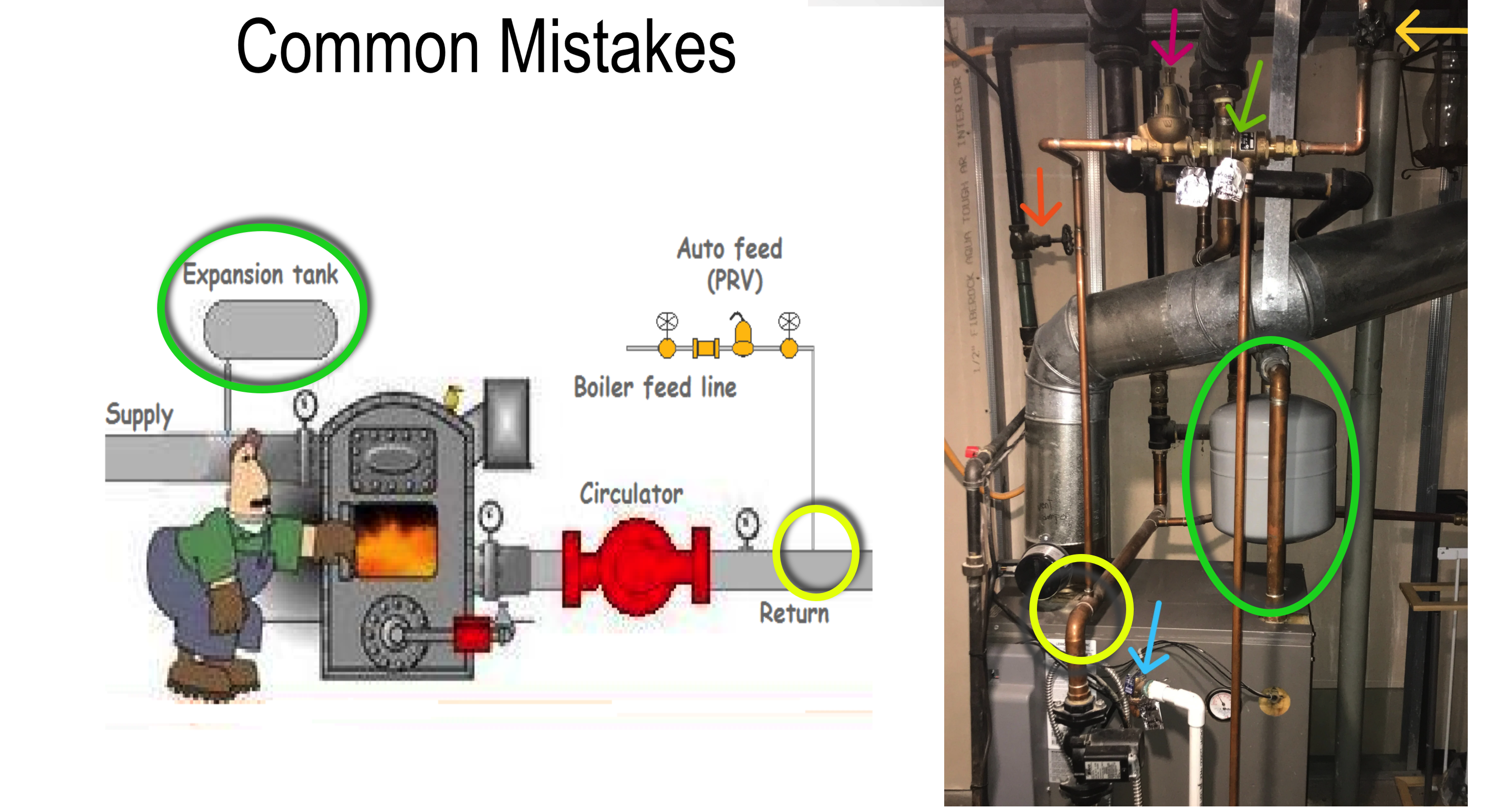

    EdTheHeaterMan Member Posts: 12,492
    edited November 2025
    I have read this entire thread and have some observations:
    • You have a classic design flaw that was causing a problem from the date of the original install.
    • As a result of this design flaw, there may have been all kinds of attempts to resolve this problem.
    • Since each tech that tried to resolve the problem didn't understand the problem, all the attempts have been unsuccessful.
    • The final answer was to just close the manual boiler feed valve (black handle Yellow Arrow) and hope for the best. Screenshot 2025-11-24 at 10.21.02 AM.png
    • As a result of this "Fix" the auto feed valve no longer feeds water and over time may have failed, or may just need to be exercised to get it back working again.
    • Set the auto feed pressure to 10 PSI and let the problem design add the pressure gradually.
    • Then vent one radiator each day after the pump operates and the pressure will go back to 12 or 15 or whatever the pump differential pressure causes the pressure to increase.
    Common Mistakes explained:
    If you look closely at the “Common Mistakes” slide I used in my one day Hydronics seminar, the Auto feed (pressure reducing valve) is connected to the inlet side of the circulator pump.  And the expansion tank is located on the other side of the boiler.  When the boiler was filled that very first time the pressure in the expansion tank was 12 PSI and the auto feed was set at 12 PSI. and all in the world was good.
    But at some point the circulator pump comes on and then $#&T stuff happens.  The pump needs to have a pressure difference (T) to move the water thru the system.  Now let's say that T is 6 PSI.   And since the expansion tank is the point of no pressure change (PONPC) Google it, When that pump runs and pushes water thru the boiler and it comes out at the other end where the expansion tank is connected the pressure must be 12 PSI there.  Now if we account for some pressure drop thru the boiler, (like 0.5 PSI) then the outlet pressure of the pump can only increase to 12.5 PSI.  Since the inlet side of the pump needs to be 6 PSI lower than the outlet of 12.5 PSI, the pressure on the inlet side of the pump MUST drop to 6.5 PSI to circulate the heated water thru the pipes from the boiler to the radiators.  And everything in the world is good.
    Except the pressure at the inlet of the pump is 6.5 PSI and the auto fill valve is set to 12 PSI and it is connected to a pipe with 6.5 PSI water pressure.  What do you think might happen?  You guessed it… the auto feed will make the inlet pressure to the pump 12 PSI and the discharge pressure from the pump will be 18 PSI.(6 PSI higher).  To do that the Auto feed added water.  Since the system is full of water and there is no place left to add water in the boiler or radiators, the water goes into the air space in the expansion tank.  This makes the cold start air pressure in the expansion tank 17.5 PSI.  This only happens once, the first time the pump starts, and the system will operate at this elevated pressure forever, (or until someone vents some air or water from the system).
    Now that the expansion tank has extra water in it, there is less room for thermal expansion of the hot water in the system.  And since the cold start pressure is now almost 18 PSI when the water expands as a result of heating up, there is less room in the tank for expansion.  The hot operating pressure may increase above 20, above 25, maybe even above 30 PSI.  Oops that can't happen.  Above 30 PSI = relief valve discharge.  Now we need to replace the relief valve because it is leaking, right?  Wrong!!!
    You need to reduce the water pressure in the boiler so the relief valve does not need to discharge. So just close the black handle valve (Yellow Arrow). The correct thing to do is to move the circulator pump to pump away from the expansion tank. But that is a subject for another book. https://www.heatinghelp.com/store/detail/pumping-away-and-other-really-cool-piping-options-for-hydronic-systems/
    But for now, just set the boiler pressire at 12 PSI after you have all the radiators blead.

    hot_rod Member Posts: 27,811
    The tank pre-charge needs to match the cold fill pressure.
    If 12 psi is what you want to fill too, pre-charge the tank to that, BEFORE you fill the system to 12 psi.
    Once pre-charged properly, It is the size of the tank that determined how much the system pressure will rise as water is heated. Do not try to change tank pre-charge to change tank acceptance.

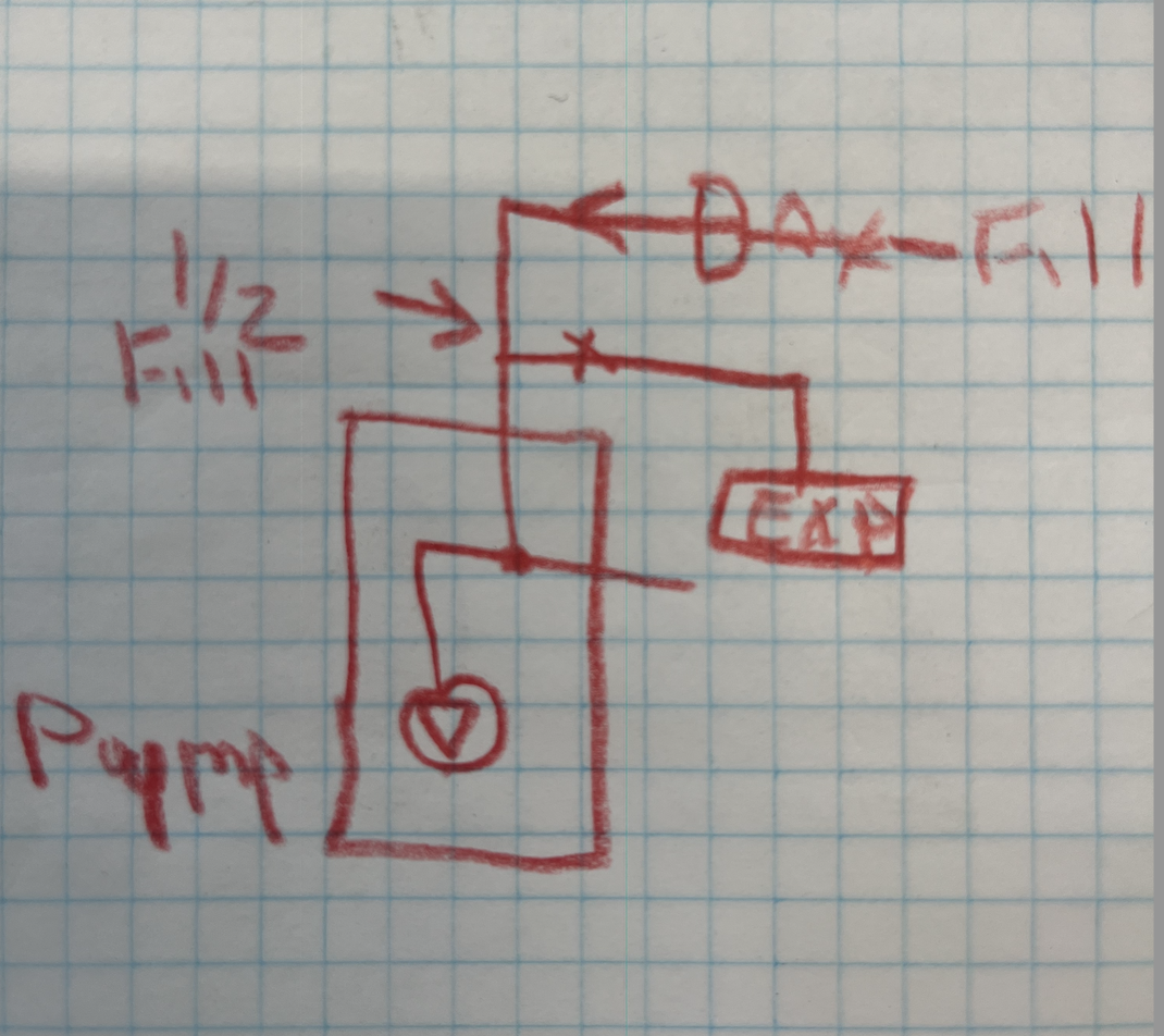

    The tank is not in the very best location in the system piping, but systems like yours are not uncommon and will work properly.
    Two things if you do repipe.
    The tank needs to be on the inlet side of the circ, somehow. And the fill valve connection needs to be at the tank connection, not elsewhere in the system piping.
    A simple fix to change the PONPC is move the expansion tank connection to the 1/2" line that comes down from the fill valve. Now you are pumping away.
    Air purger stays put.
