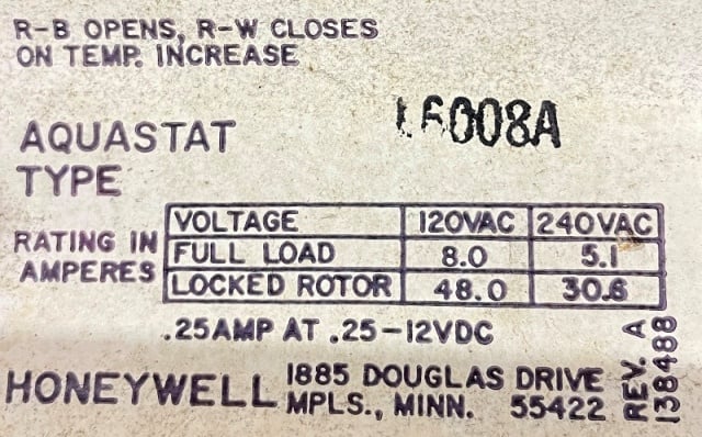

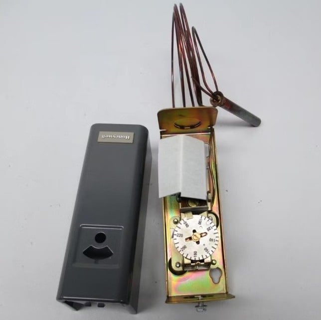

I have a HydroTherm residential hot water boiler which has an outdoor temp sensor with an aquastat control. Is it possible to test the sensor and determine if it is working correctly?

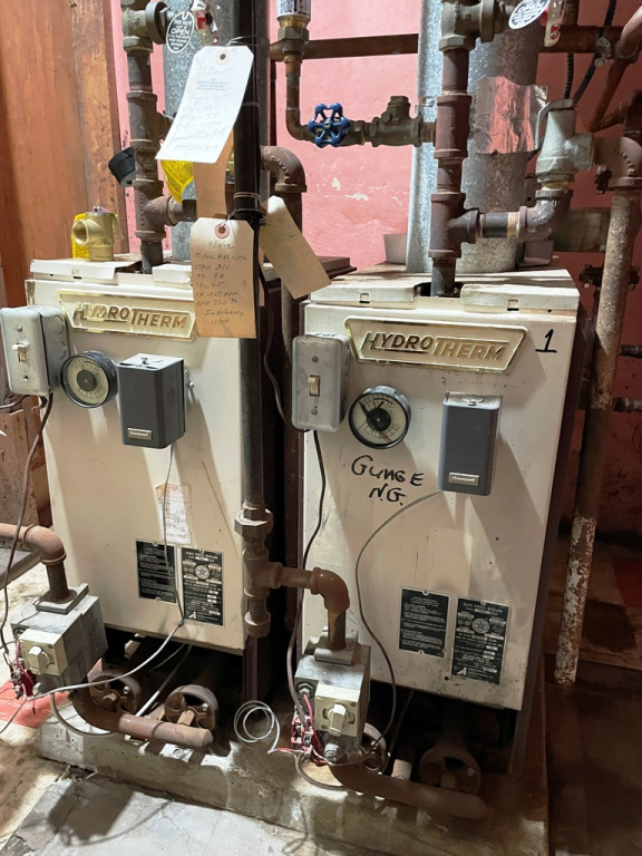

The house is a large tri-plex in a Minnesota. I have two boilers and two sensors. One of the boilers heats the house most of the time and the secondary (identical) boiler only heats when the outside temperature is too cold for the main boiler to keep the house warm. Each boiler has a separate outdoor sensor and control.
A heating company came to replace a pressure relief valve and after replacing the valve they looked at other things and said that one of the sensors was working fine and the other sensor was not working. Both sensors were working fine last winter.
I understand that I could put the bulb in ice or dry ice but is it possible to test the ohms or adjust the control and see if the boiler fires. I had a second heating company come out to determine if the sensor was bad and they charged me $200 to tell me that it was not possible to test if the sensor was working or not. The sensor in the image below costs $60 and I could easily replace it myself and wire it exactly the same as the current sensor and set the control the same as the current sensor.
Below is a link to the same sensor and control that I have.
https://www.motionsurplus.net/sensors-transducers/23916-honeywell-l6008a.html

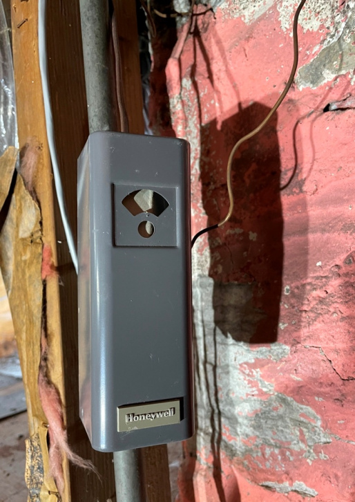

IMG_4849_v2.JPG IMG_4848_gd.JPG IMG_4850_gd.JPG IMG_4859_gd.JPG IMG_4861_gd.JPG
    What you have is an aqustat used to sense air or water temperature. Is that what you are calling a sensor? It is really an outdoor air control.
    The control has 3 terminals R, w, and B.. All it is is a single pole double pole switch that works on temperature. The "R" terminal is the common . It will always be connected to the w terminal or to the B terminal but not at the same time. It will be connected to one or the other depending on the tepm at the sensor bulb and on where the dial is set.
    So using this for an outdoor air control for a boiler I would think you would have two wires one to R and one to B. If the outdoor air at the bulb is at 60 and your set to 60 The r & B circuit would open above 60 (to shut the boiler down) and close below 60 to start it up.. it. This is not exact as the control has a differential built in. You can usually here it click when you turn the dial.
    You can put an ohm meter across the terminals to check it. Measure the temp near the bulb and the control should work and you should here a click when the dial is sset and turned near the bulb temp

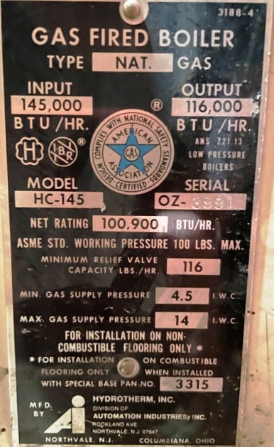

    how old is the boiler. I don’t find any info online for that name? Highly unusual.

    I'm calling the outdoor temperature sensing bulb a "sensor" because that's what the heating guys called it. I describe the "control" as an aquastat because that's what it says on the label inside the cover. The "control/aquastat" is the part inside the house.
    The picture is from a brand new aquastat/sensor that I found online. It is the same model number as the one connected to my boiler. I did not take a picture on the old one connected to my boiler.
    The boiler was in my house when I bought it 25 years ago. I think the boiler was old back then. Both boilers work great and I will not be replacing them. I think the name of the boiler is ThermoKing but I'm not sure. I will check in the morning and post back with the name and model number of the boiler.

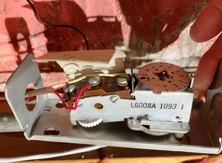

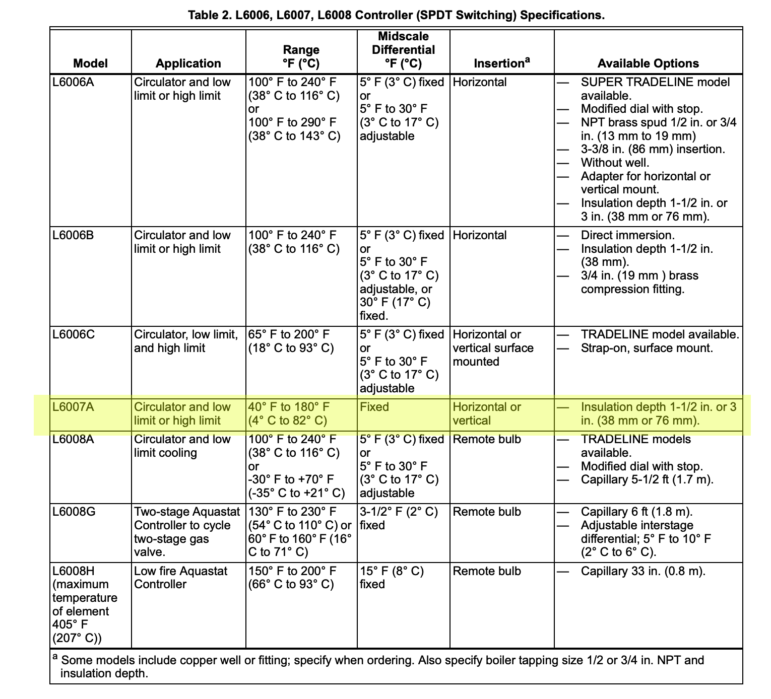

  • After this many years it is possible that you have a L6008A cover but not a L6008A control. I have seen this happen. it is possible yopu have a L6007A with the proper temperature range.
    If a cover gets lost and a customer a asks about the missing cover, I would look in my truck for a old cover that might fit, even if the label on the inside indicates it is for a different model of the same type control.
    The model that you need that has the proper temperature range may no longer be available. If it is available, it would most likely ge a special order and would cost more than $60.00. Not recommended is a way to change the. range by turning the dial past the stop on the control by bending the stop down and turning the dial. then bens the stop back up. The increments and numbers on the dial will no longer be accurate but it will do the job if that is the last resort. I would opt for an outdoor thermometer that was designed just for that purpose. But that is also a more expensive control.

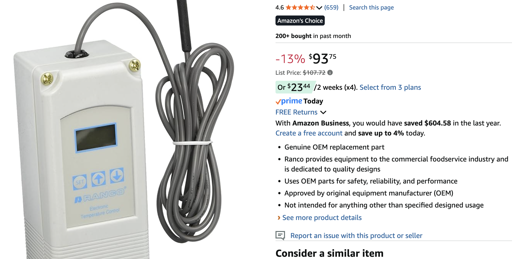

    If you do need to replace that control, consider an electronic setpoint control. It's digital reads temperature and has a lot more control settings.
    Honeywell, Penn, Ranco, Johnson Controls are other brands. Should be less $$ compared to the old technology cap tube controls.

    Thanks for noticing that. I will post another picture of the control that shows the model number.

    hot_rod: sorry, my mistake, I should have checked instead of guessing at the name of the boiler. You are correct, that was not the name. The name is HydroTherm. I posted additional pictures including the boiler(s) with the name on the front. Thanks for catching that.
  • RC947
    RC947 Posts: 9
    Thanks, yes you're right. The correct name of the boiler is HydroTherm. Thanks for the advice about the pics. I just posted additional pictures including the rating plate. It's a residential gas boiler.

    It appears that control had been replaced by L6008 A1242. the $60.00 will not work for you. You will be hard pressed to find a discounted low temperature Remote bulb Aquastat like the one you have.
    If you have to replace it the correct control is a Honeywell T6031A1029. Supply House.com has them. $170. Temp range is -30—+90
