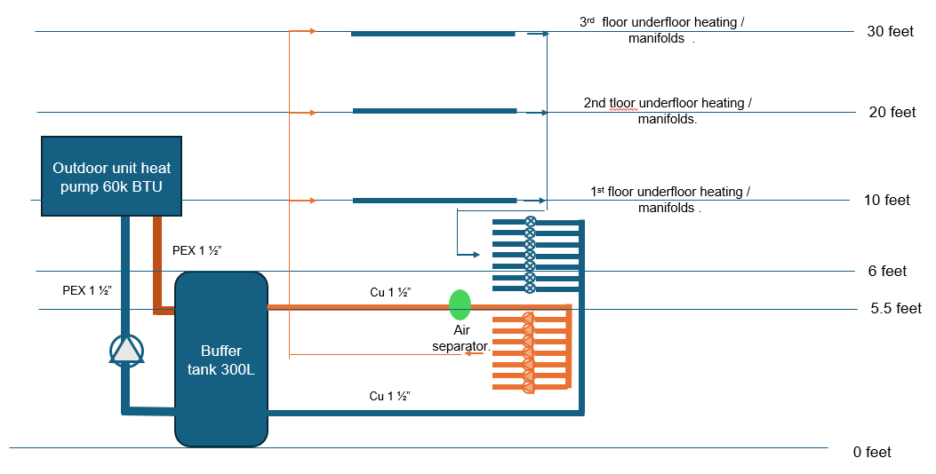

I am pasting below a sketch of the system including vertical distances. I am less worried about removing the air from the underfloor heating loops (I believe I know the process well). My main issue is how do I remove air that is trapped in the top of the buffer tank - it does not have a vent valve at the top, and the in- and outflow ports are approx. 8 inches below the top of the tank. Second how do I make sure the supply and return piping to the outdoor air-to-water heatpump is fully vented.
The system has an air separator installed on the warm / supply side for the underfloor manifolds. (Caleffi 551041A, however in the mean time it seems Caleffi updated the design (?). I have a version that looks different than what is being sold under this model number right now). I believe the layout is according to classic recommendations and manufacturer specs.
Any thoughts on how to vent the buffer tank fully and any other recommendations would be much appreciated!

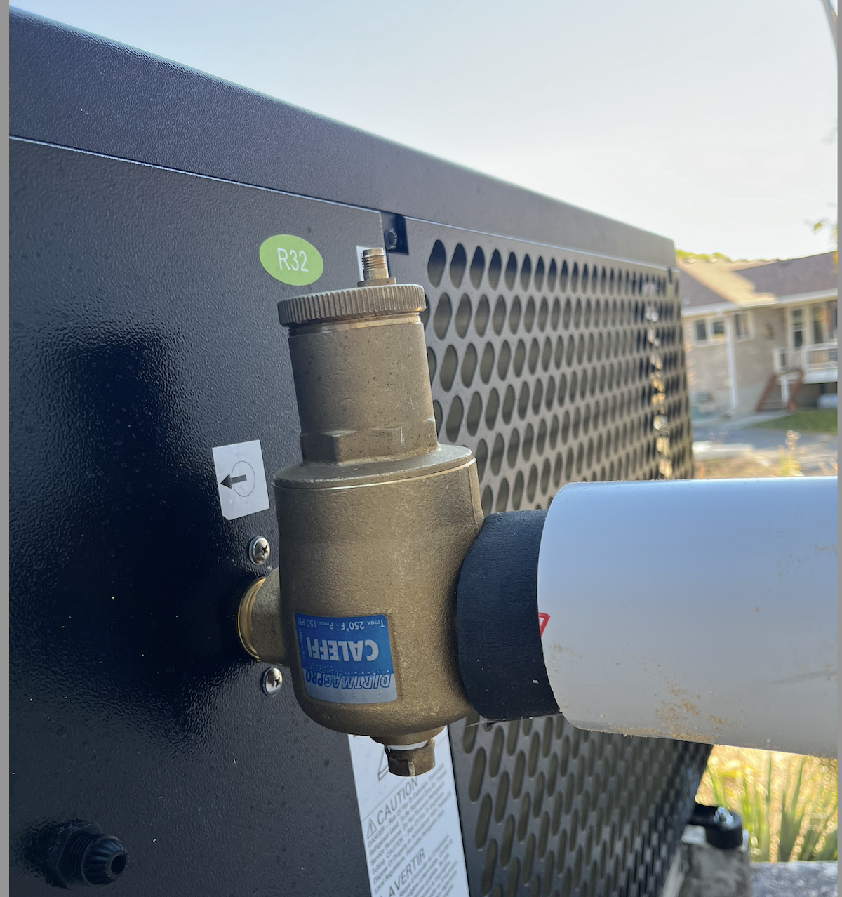

    is the heat pump mounted above the buffer? There should be an air vent in or on that. A manual vent is fine my Viessmann shipped with a Caleffi 551 to mount at the unit

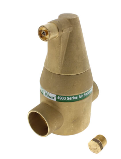

  • Ok I have a Taco 4900 air separator

    The primary pump should be mounted near the bottom of the tank. The tank needs an air vent at the top as air will always collect there and get into your secondary loop.
    If you are doing re-pipe, a 3 port buffer works much better with air to water units as you get less mixing inside the buffer tank.
    P.S. Looks like you are also suffering from wall of pumps syndrome. You have to be careful with that type of setup with AWHP units as you can over-pump the secondary loop. This has the effect of mixing the emitter supply down with the return water which reduces the COP of the heat pump. With all pumps running, the secondary loop flow should match or be slightly less than the primary loop flow.

    Viessmann HP has you put an air sep right at the outdoor unit. Discal insulate jacket added after pic was taken

    I did it a little different than their drawing and put the relief valve inside. Their piping is a bit cluttered and would be hard to insulate.

    No harm in having a purger at the HP and on the secondary side of the buffer.
    Not all buffers have a place for a top air vent, mine doesn't. So dual air purgers should do a good job.

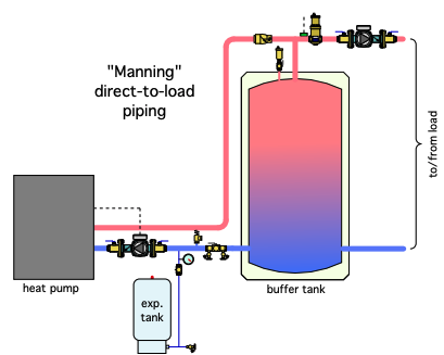

    If a tiny bubble traps at the top of the buffer, not a big deal, it will stay there.
    If you find a buffer tank with a large top connection pipe the air purger up there, then it is both a purger and high point vent.
    Three pipe buffer for reference. Return from system crosses bottom of tank to hp for lowest return temperature.

  • Good point - My graphic is not correct, I have 4 variable speed Taco 0013 e3s (not 8 as shown), one for each floor, hydronic separated via closely spaced Ts… I am optimistic that should avoid "wall of pumps" issues.
  • This make sense. I take it these Caleffi air separators are fit for outdoor use? I see you installed it on the supply side.

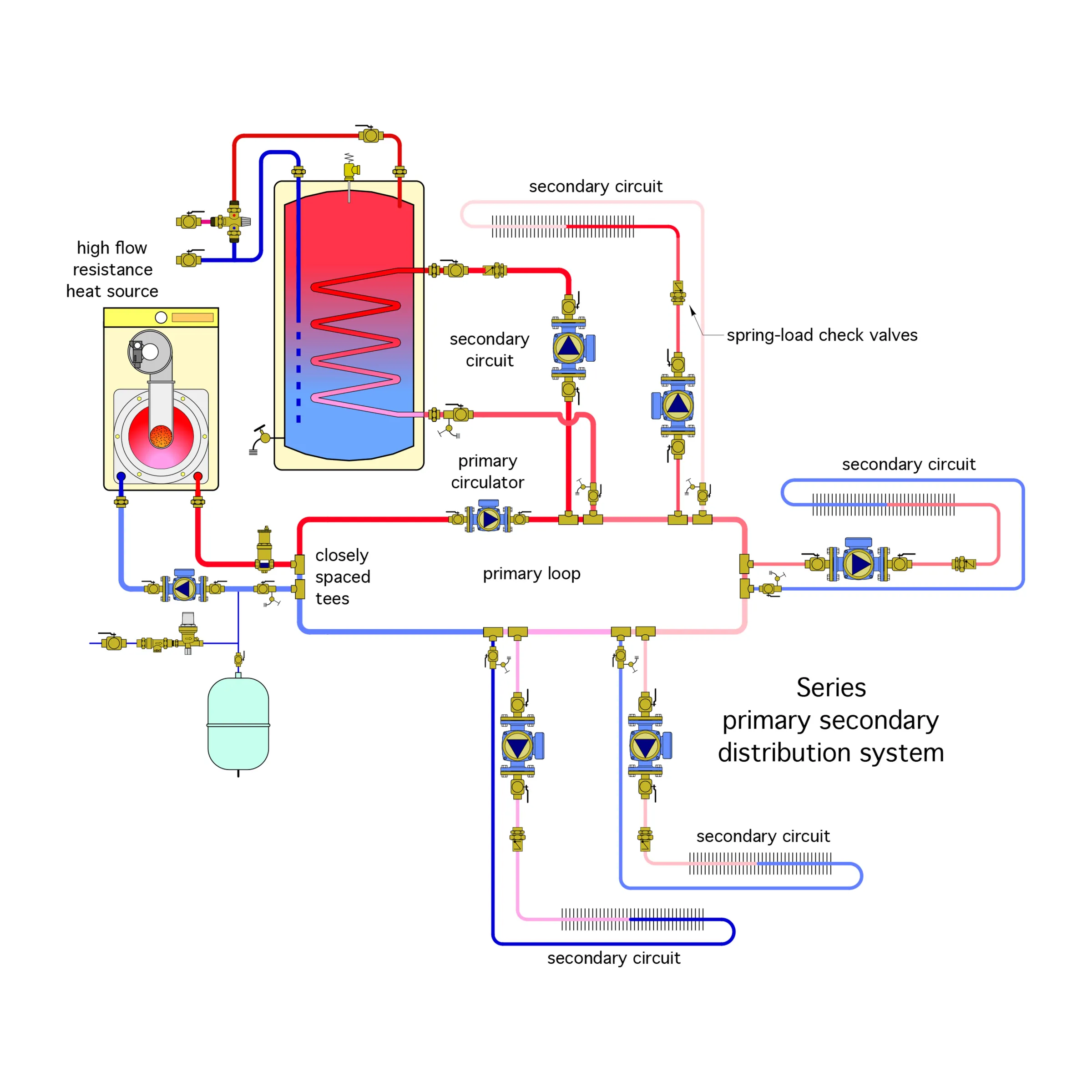

    Check if your heat pump has a built in auto vent. Mine had one by the plate HX that I had to open to purge air during initial fill.
    Four 0013s are pretty big pumps, that doesn't feel right, are you sure about the part #.
    In either case, exact pump count and size aside, you want to check the flow meters on all your manifolds with all zones running, sum them up and you want to make sure that total flow matches your primary loop.
    By closed spaced Ts, I'm assuming a bunch of Ts to feed the pumps from the main 1 1/2" copper pipe. There isn't a set of closed spaced Ts like this:
