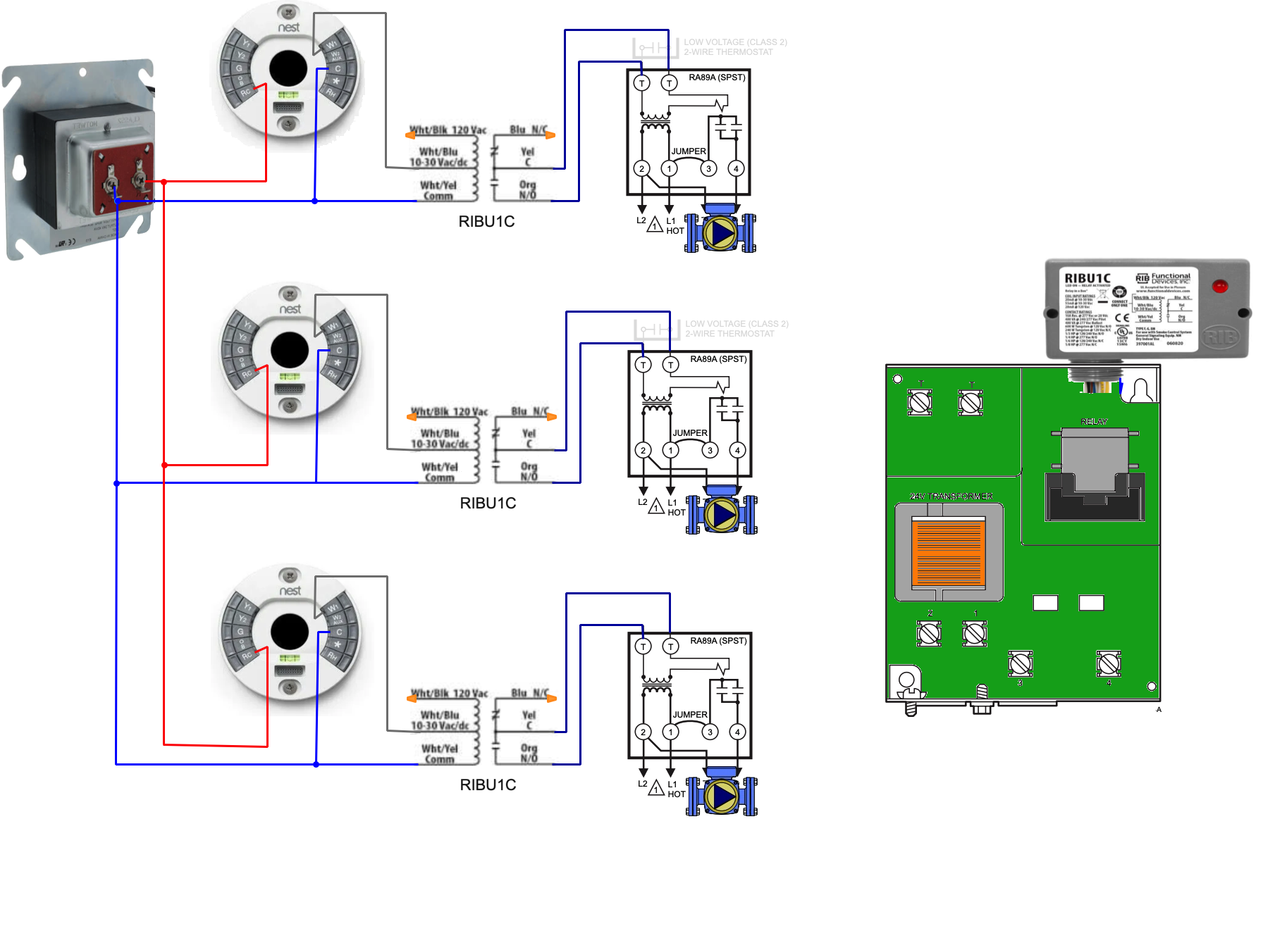

    So for one of the zones. If I install a transformer, I would connect w and c to the 24V coil of a relay. Then I would connect T and T to the normally open contacts. The r and c for thermostat would just go directly to the transformer. Does that sound right
  • @HydronicMike
    Thats a good idea thank you
    109A_5 Posts: 4,761
    edited November 2025
    Yes that sounds correct one appropriate sized transformer could run multiple smart thermostats and buffer / isolation / switching relays.
    However a Taco SR503 or a SR504 may be more practical solution and retire or repurpose the RA89A relays elsewhere.
    heatguy34
    109A_5 Posts: 4,761
    Three SR501 switching relays would work also. They do have a 'C' terminal, but I can't find a specification on the transformer size.
    3 rib relays and 1 transformer . about $100
    What brings on the burner when there is a call for heat?
  • @HydronicMike
    Just to clarify. The 4 zone switching relay transformer should be able to handle 4 ecobee with no issue?

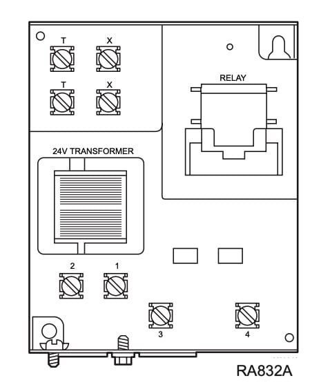

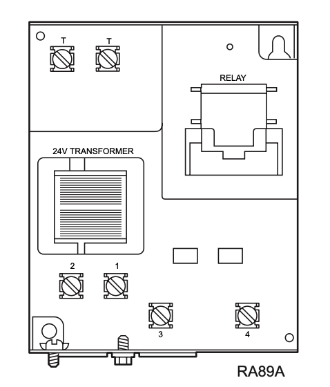

    How? this diagram of the RA89A does not have a way to do that.
    Unless you have a different relay with a cover from a RA89A (that cover fits many other relays like that) like a RA832A There are not X X terminals or other switching terminals on a RA89A to operate the boiler.
    What does the inside of your control look like?
  • I guess I was mistaken with the model number because the pump relays have X X terminals
