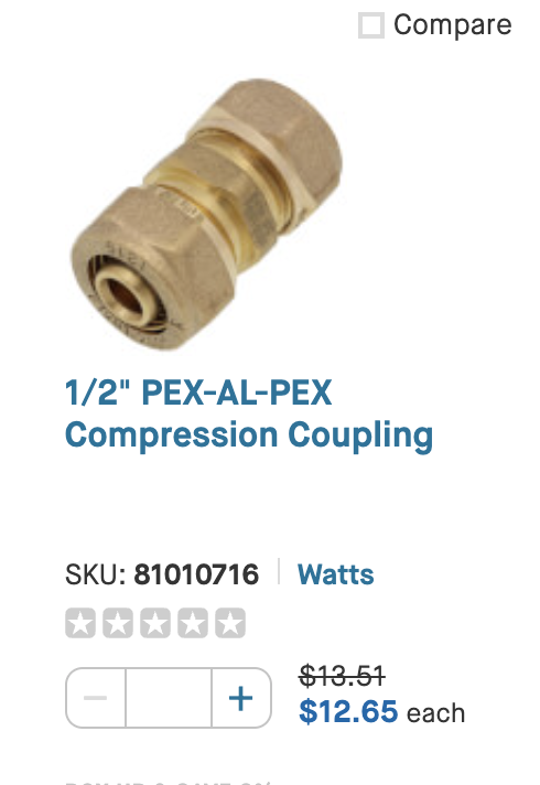

Anybody know where I might find some fittings for 1/2" multicor ? couplings would be nice
Crip or compression? I think SupplyHouse has both. It should take a standard PAP fitting.
Living the hydronic dream0 -
I already bought two of the watts and two Mr. Pex from supply house . Jan told me a few years back the 1/2” multicor size is not the same as other manufacturers pap . Mr Pex fitting does not work and I tried the Watts compression coupling (less any lubricant) and the first o-ring was not fitting in … I am using the chamfering tool . Thought I’d ask here before I grease it up and go for it . It is in my house sooooo
