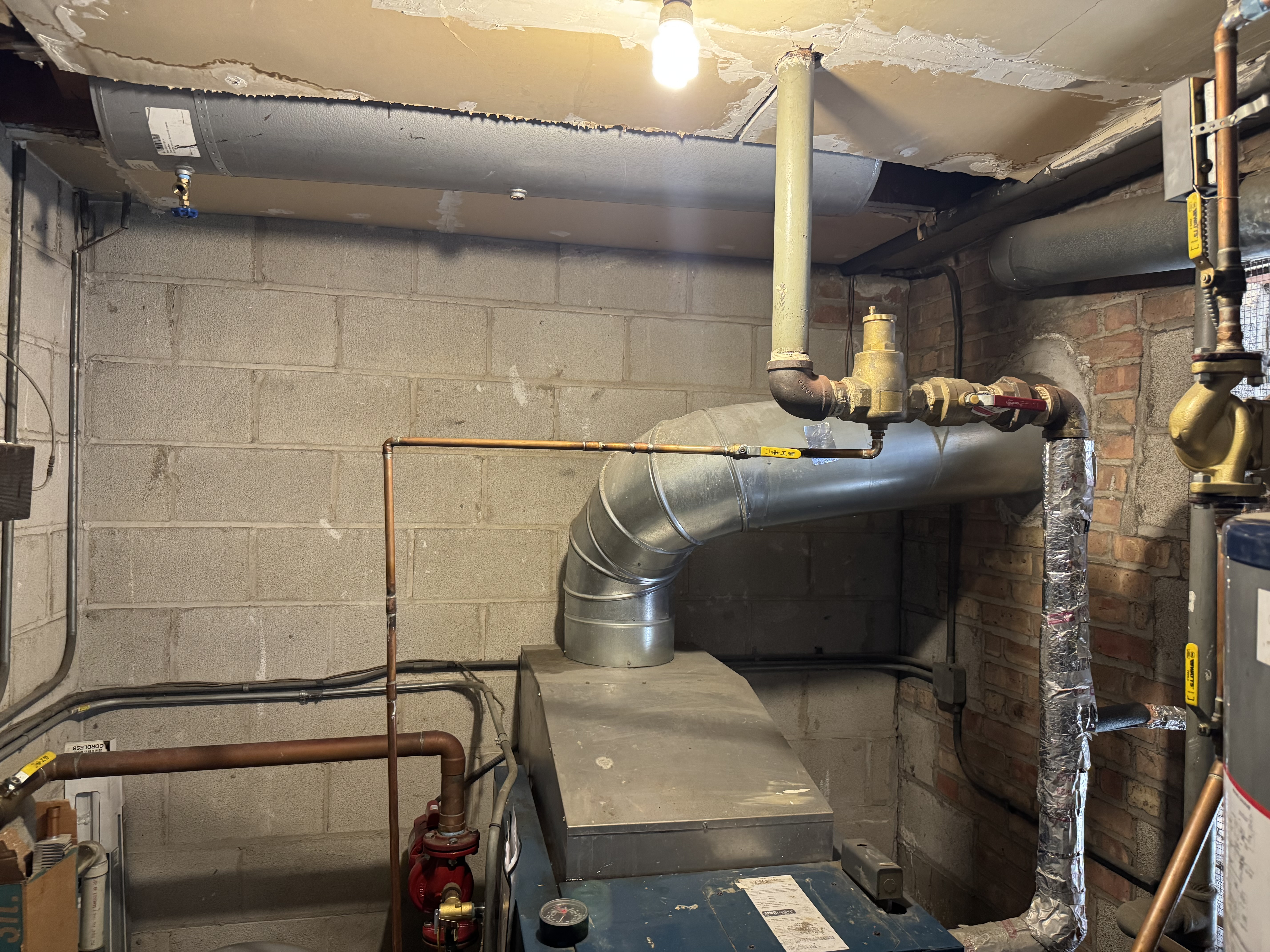

Hello everyone! I have a real head scratcher here in Chicago. We’re looking at a Dunkirk 500K BTU hot water boiler for a 12 unit apartment building that’s 2 stories. It’s all copper fin baseboard with 12 taco zone valves for each unit. We also have a B&G 102214 1/6 HP pump on the return and a 27.7 gal Extrol tank. There is an air separator on the 2” supply with the tank tied into it. So yes, we are pumping towards the tank

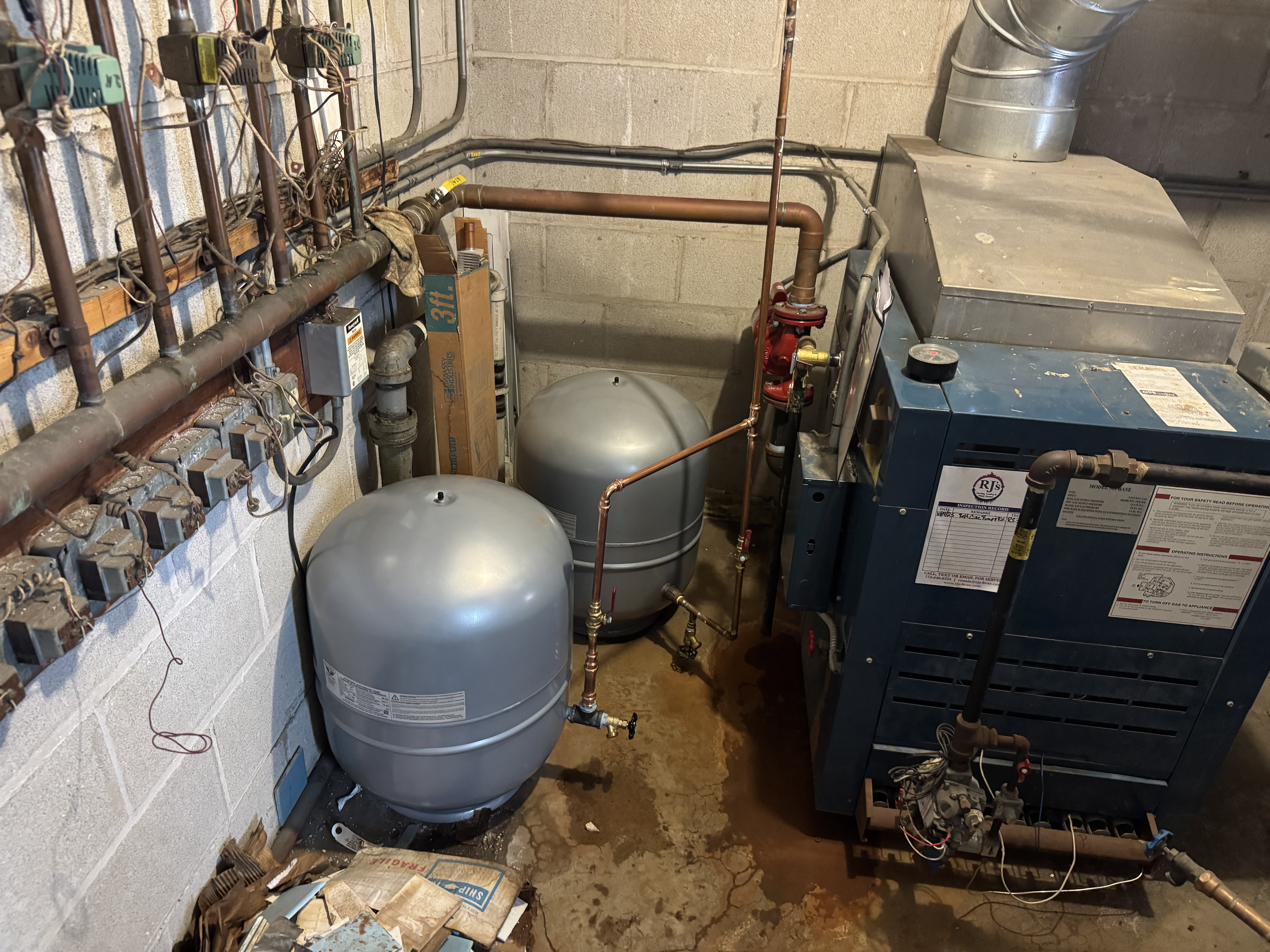

The pressure keeps raising to over 30 psi and popping the relief valve. I’ve testing this system in multiple ways to rule things out. I shut the cold water supply off to rule out the feeder bleeding through and left it for a day. It still opened. At that point, I assumed the bladder failed in the 1 year old tank. I T’d in a new tank to the existing one and put isolation valves on them. Ran the system with the new tank for about a week. Went back and the pressure was up again and popping the valve. Not a bad bladder in the existing tank at that point. I then opened both tanks and let it run. Guess what? Same issue.
A little more backstory is that a company initially came out and found the older expansion tank in the ceiling had a leak. They replaced it with the same monster type, and that’s when the problems started. The customer called and said there was an issue so then that company decided they don’t work on boilers anymore after that. From there, that’s where the Extrol tank came in. The Extrol was sized to the system. Not only by the contractor but our local old school boiler distributors.

was the pre-charge checked and adjusted on both tanks?
What was the capacity of the old compression tank?
Did water come out of the air stem on. The tank that failed? That is an indication of a failed diaphragm
Has the pump been changed? Looks like you are pumping at the expansion tank? Pump on the return, expansion connection on the supply? Where is the fill valve connection?

is that an indirect water heater or is it separate from the boiler?
there shouldn't be any automatic air vents with a compression tank, was the discal added after the bladder tanks?

Decent size boiler the EX tank could be too small 12 units in a two-story building is pretty big. That system holds a fair amount of water. What is wrong with the compression tank in the ceiling? That is brand new correct?
If the tank in the ceiling is good get a garden hose and a female connector and connect the compression tank to the boiler drain and try it temporally just to see what happens.
The diaphram tanks will be about 1/3 the size of a plain steel tank, typically. A partial or full acceptance style expansion tank would be even smaller.
Keep in mind with a plain steel tank you are adding water volume to the system, so more expansion space is required.

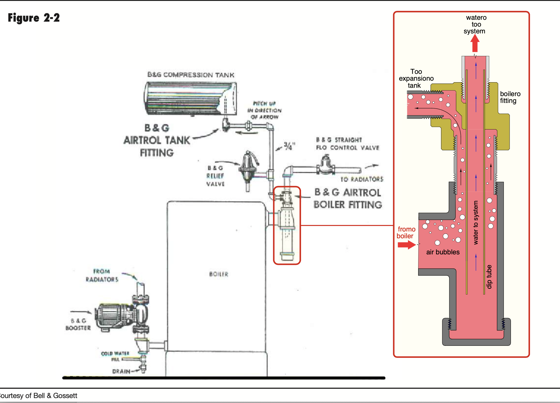

Compression tanks should have the appropriate fittings to work as intended, these B&G Airtrol for example.
