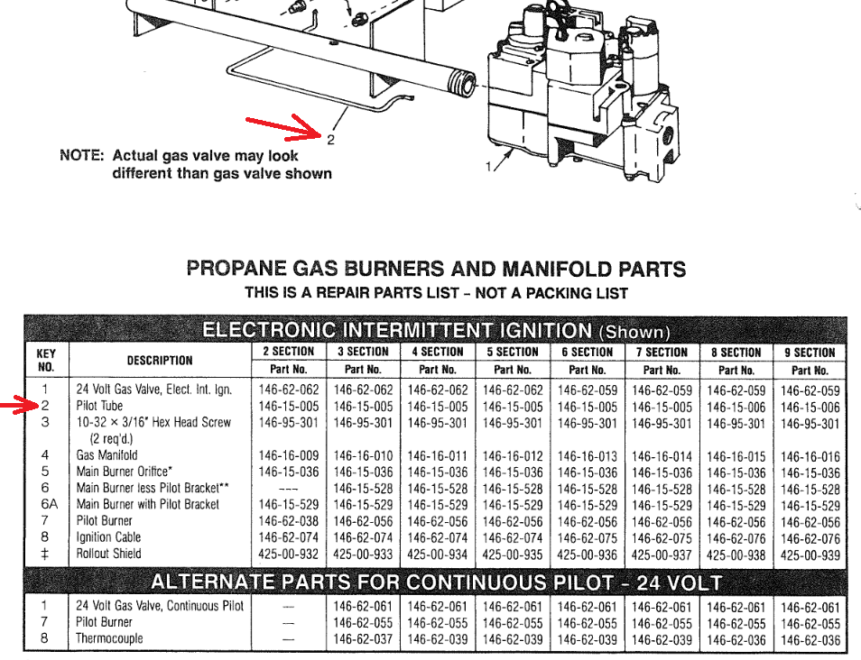

I need a part number for the little gas supply line from the fuel control to the pilot light. Mine is 2 feet long. The tube is shown as part of the pilot light assembly in my Crown manual schematic but not the Supply House schematic. Latest part number for the pilot "nozzle" is Q314U1001. My boiler is a Crown, Aruba series, Model ABF-SPD. Old P/N is 146-62-092. Thanks Everyone. Never mind. The kit comes with replacement ends for that tube

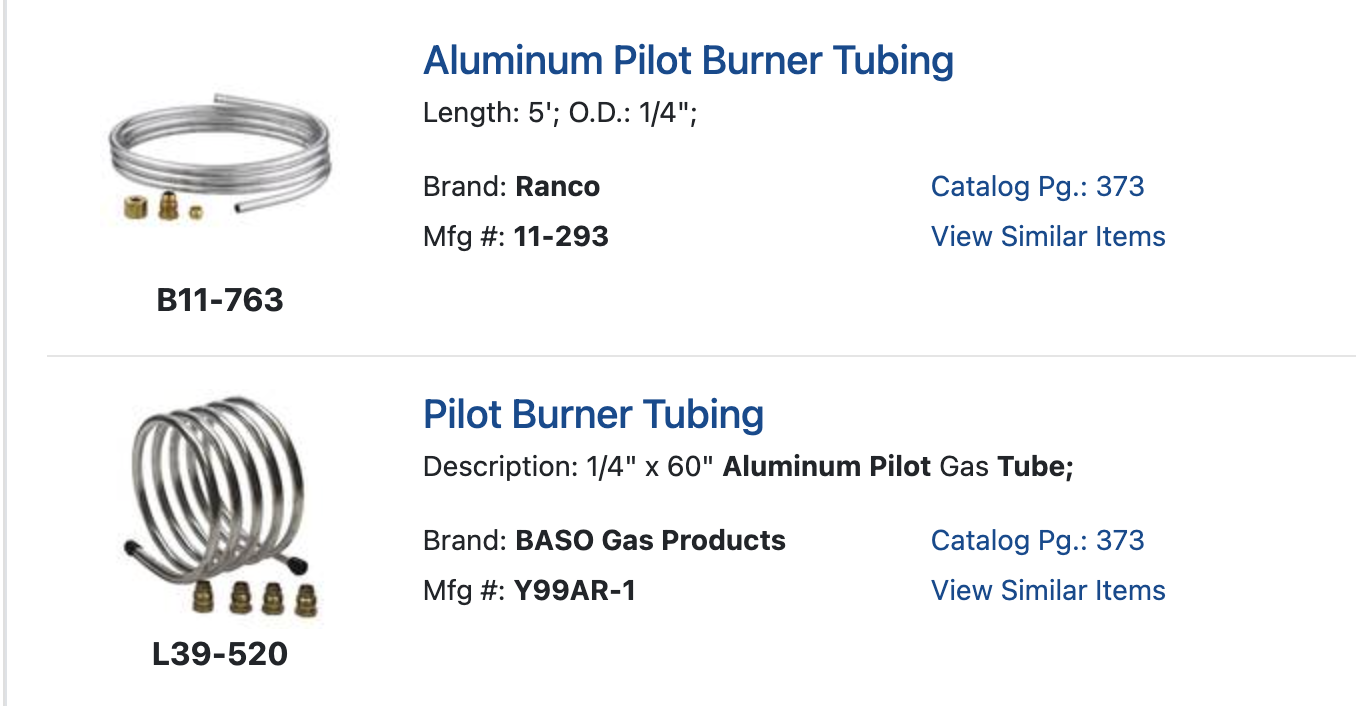

    Usually that is 1/4" aluminum tube with compression nuts on both ends.
    There are kits available to cut and make your own.
    Johnstone Supply is one of many sources. It may be less $$ and easier to find than the original OEM tube.

    Many other boiler manufacturers use the same part. Just bring it with you to the local plumbing supply company and see what they have that matches. you can use a longer one and just leave it coiled up. here is one that Weil McLain sells Pilot tube 560-742-865. it is about 3 feet long. Dress and act like you know what you are talking about. A 3 piece business suit is a dead giveaway that you are not in the trade. Clean running shoes are also not plumber attire.

    Supplyhouse 146-15-005-70 may work depending on your boiler size.

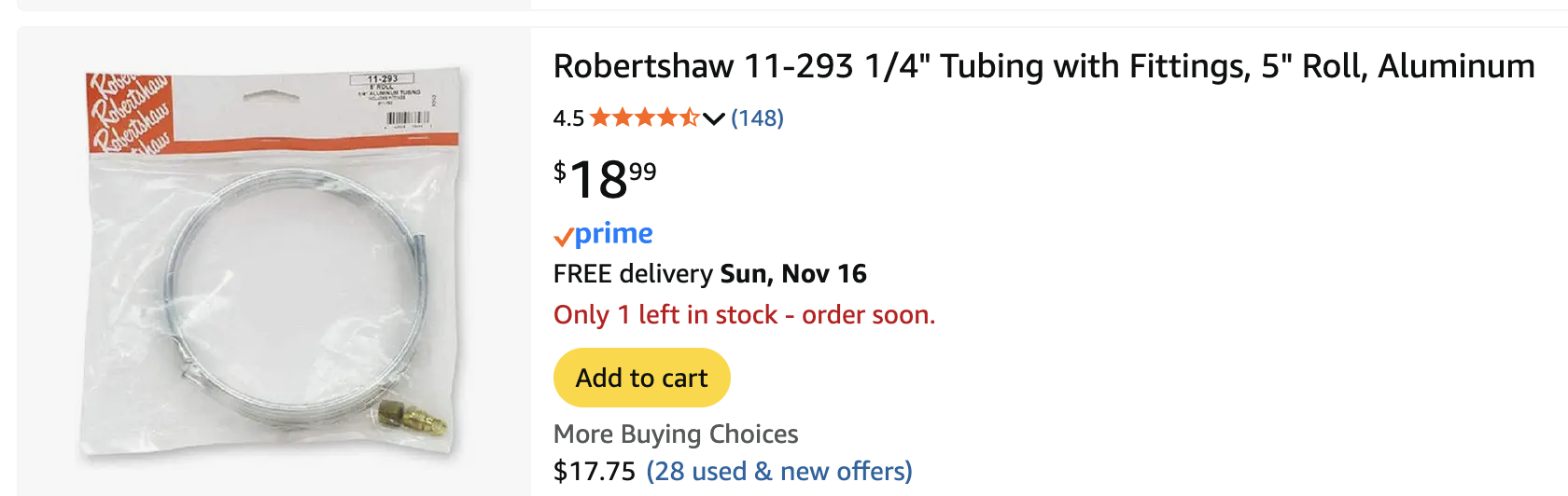

    Do you have a Johnstone Supply or Graingers nearby? Those tube kits are typically on the shelf. Or any HVAC/ plumbing wholesaler.
    Probably find them on Amazon if you are a member maybe even get free overnight shipping.
