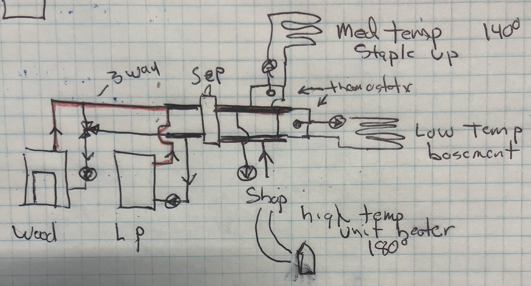

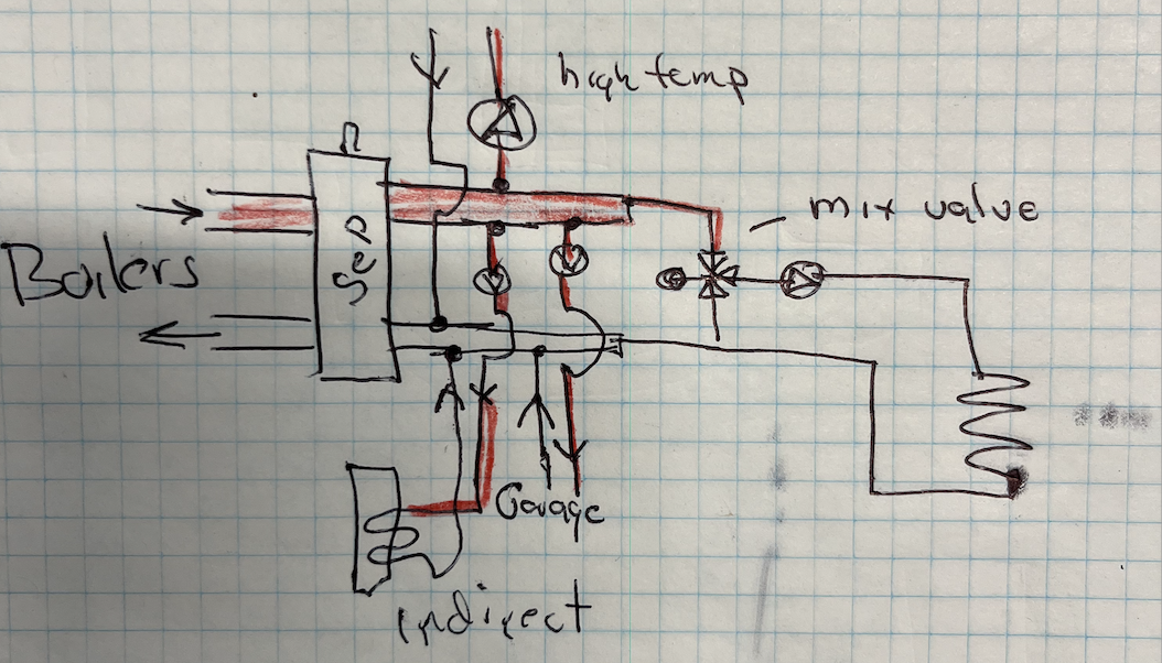

    Here is a piping option using a hydraulic sep to connect all the boilers and loads.
    The sep 4 gives you air, dirt, mag and hydraulic separation for both boilers, the entire system really.
    Showing 3 temperature.
    Highest to unit heater in garage
    Medium to staple up
    Low to in slab.

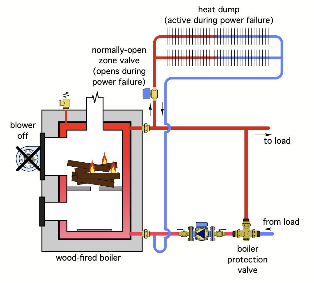

    A simple 3 way boiler protection valve at the wood boiler.
    Control could be a simple as one or the other, you manually switch back and forth or a temperature controller to make the switch.

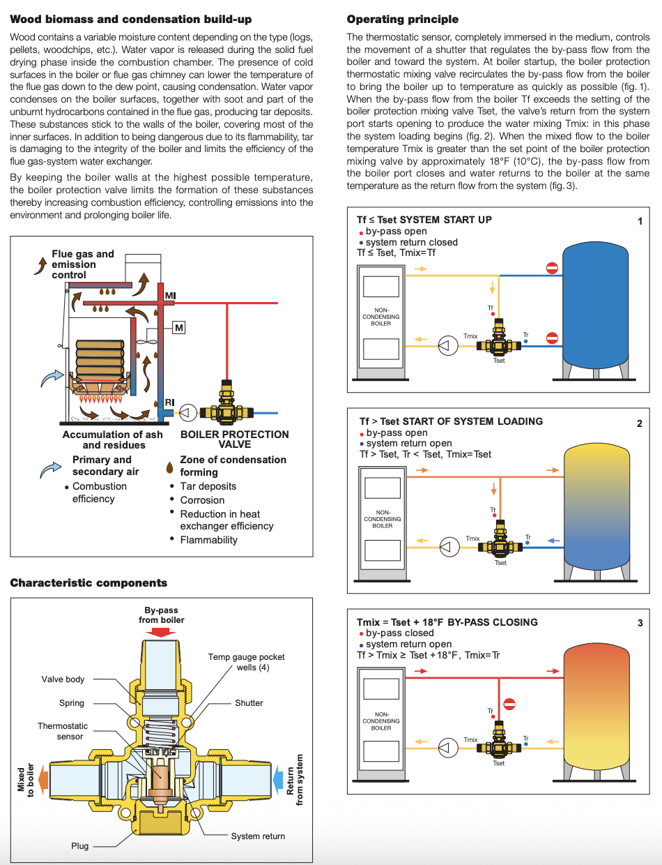

    Also info on how a boiler protection 3 way valve works. It's basically a fixed temperature thermostatic 3 way valve, high flow rate.
    \You could maybe use the indirect as your dump. I'd look at how large the firebox of the boiler is, how much energy you would need to dump in a run away condition. If it is a small indoor boiler you may not need to dump much?

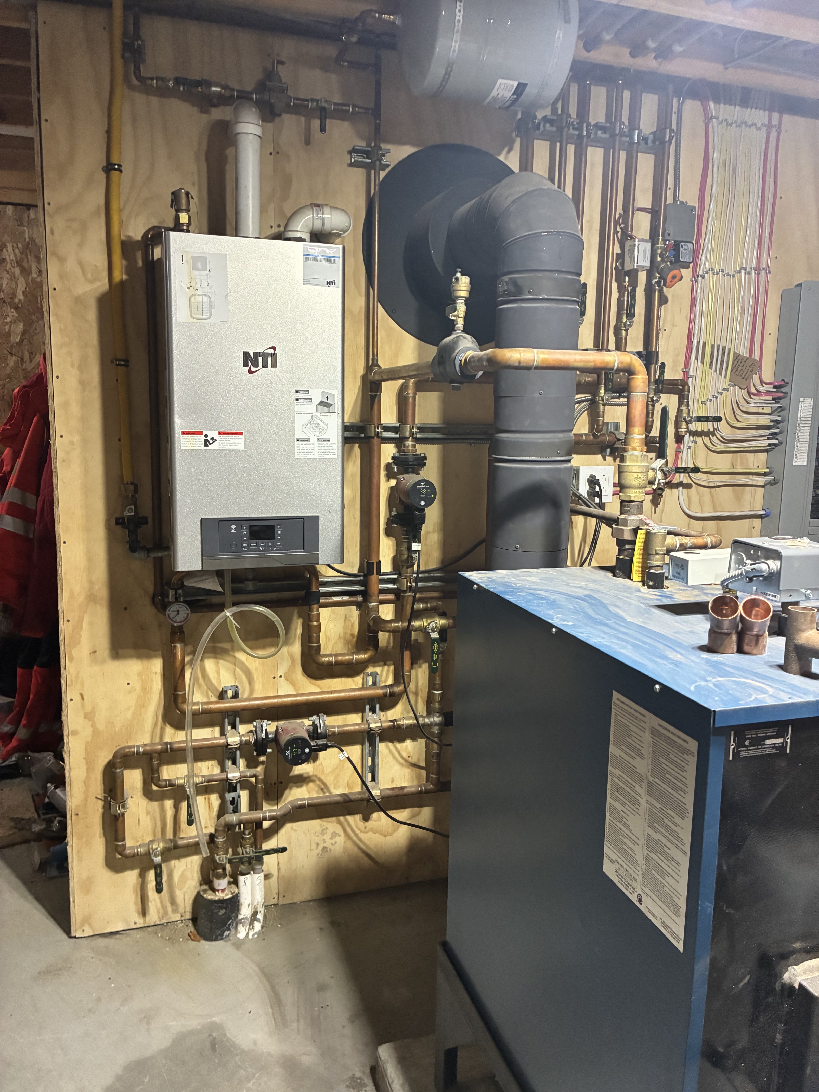

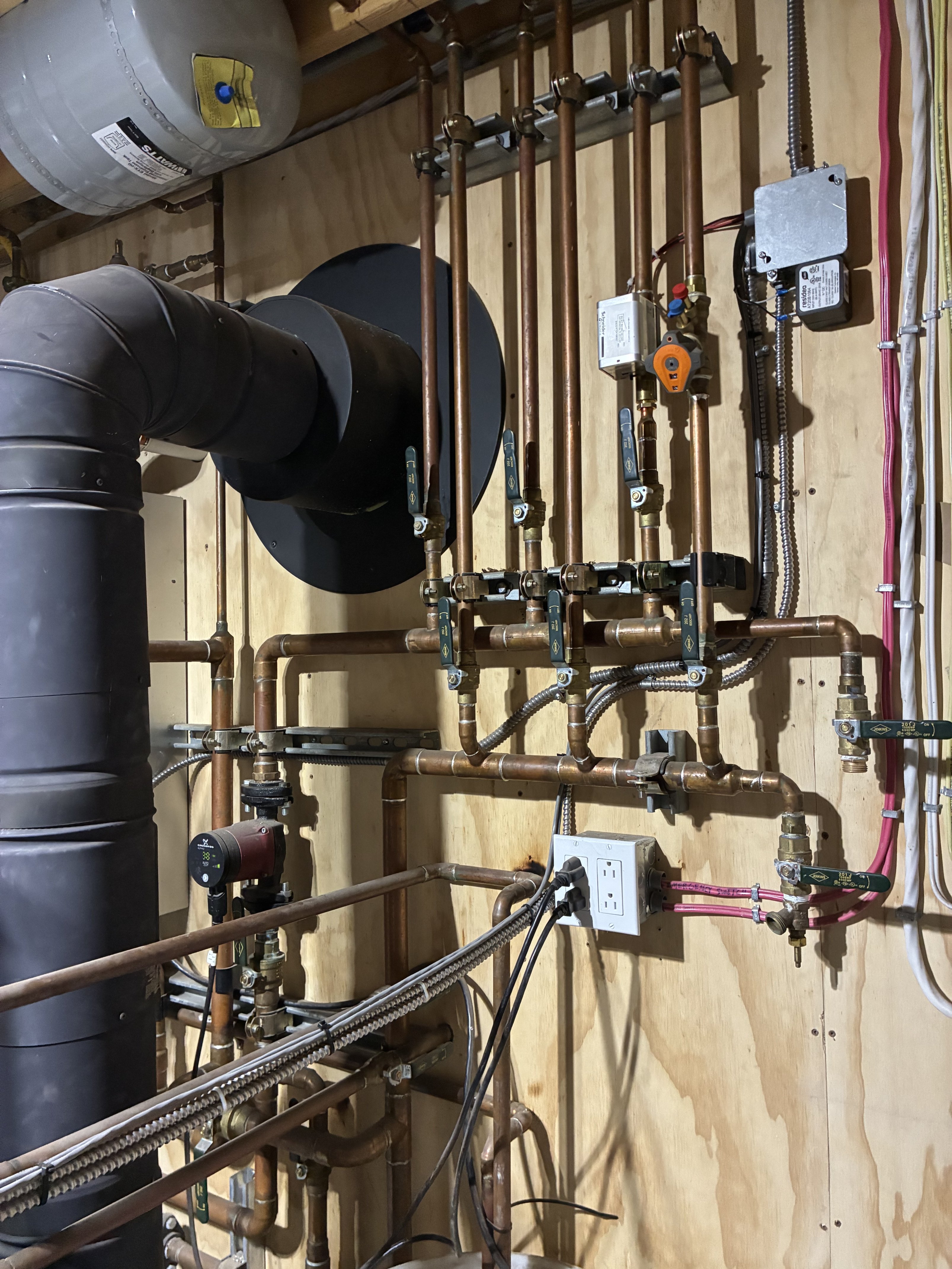

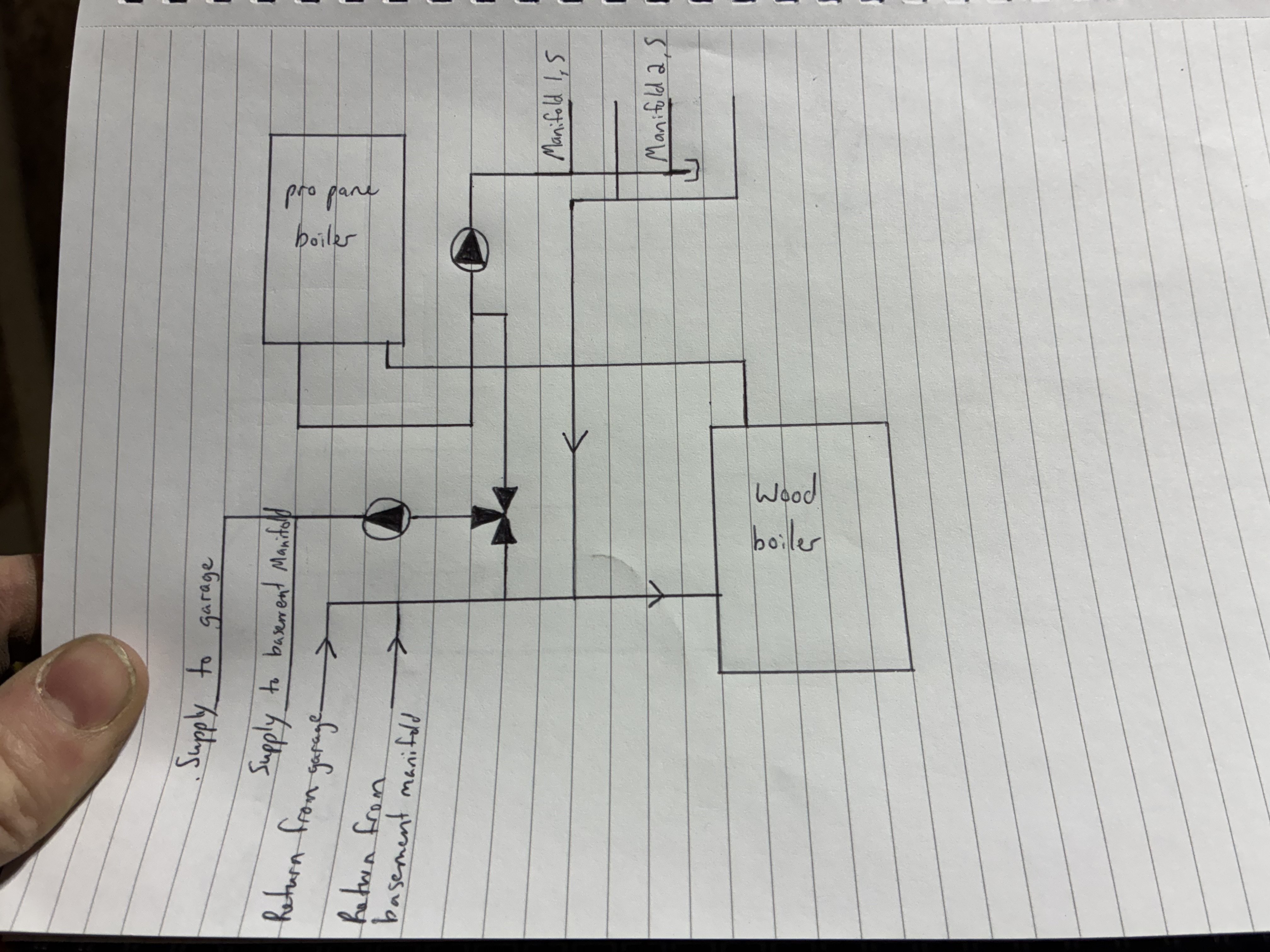

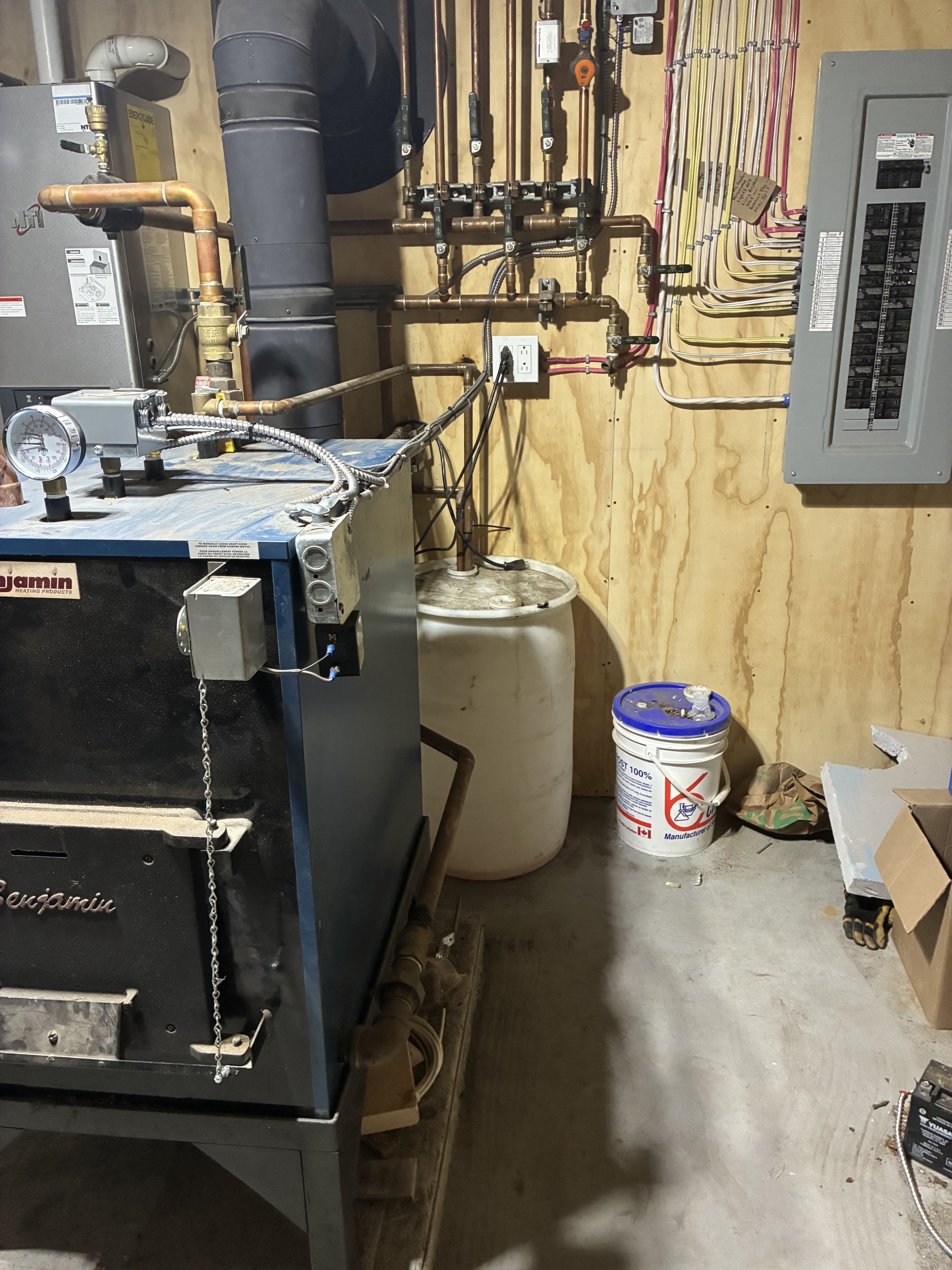

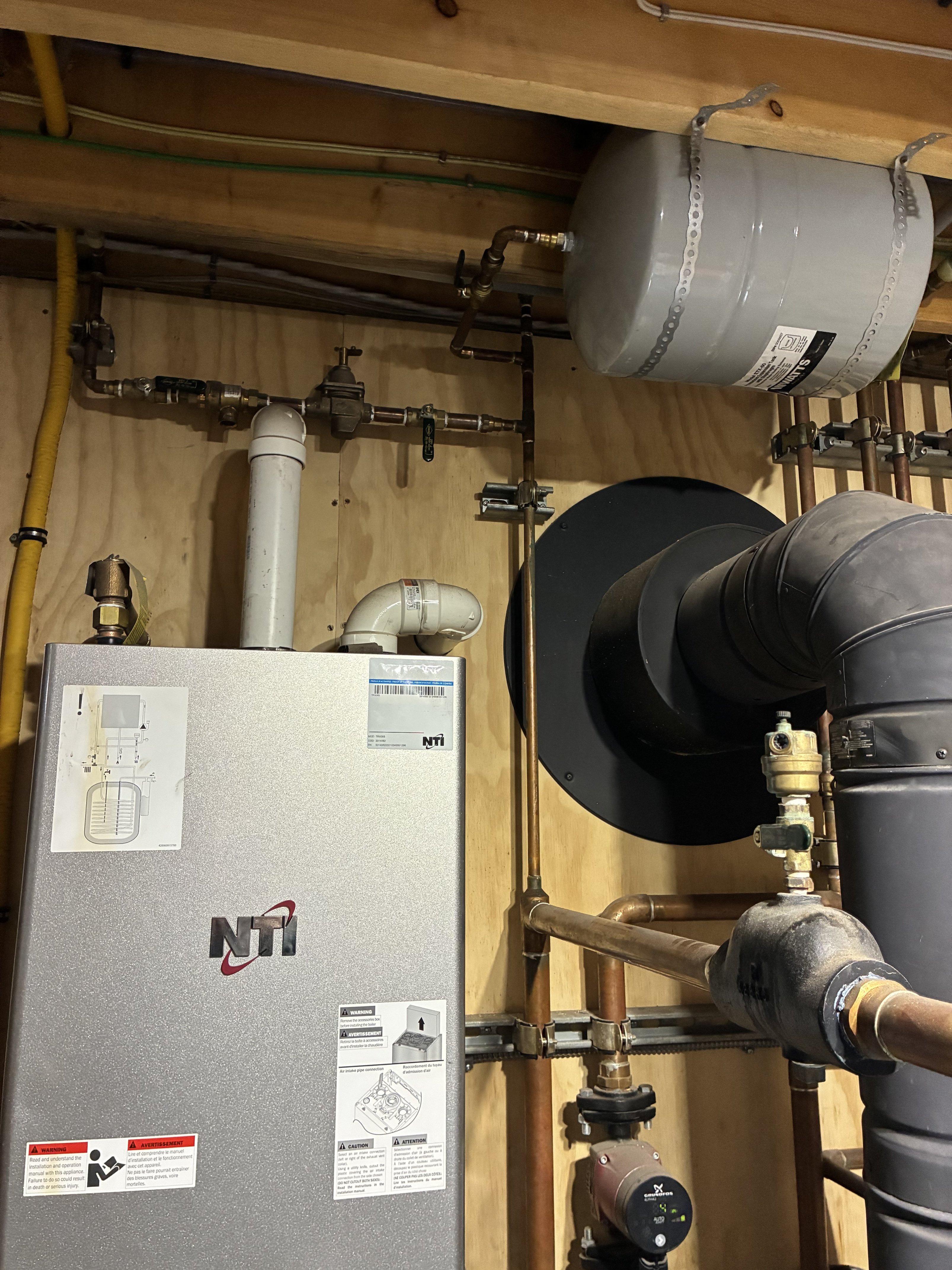

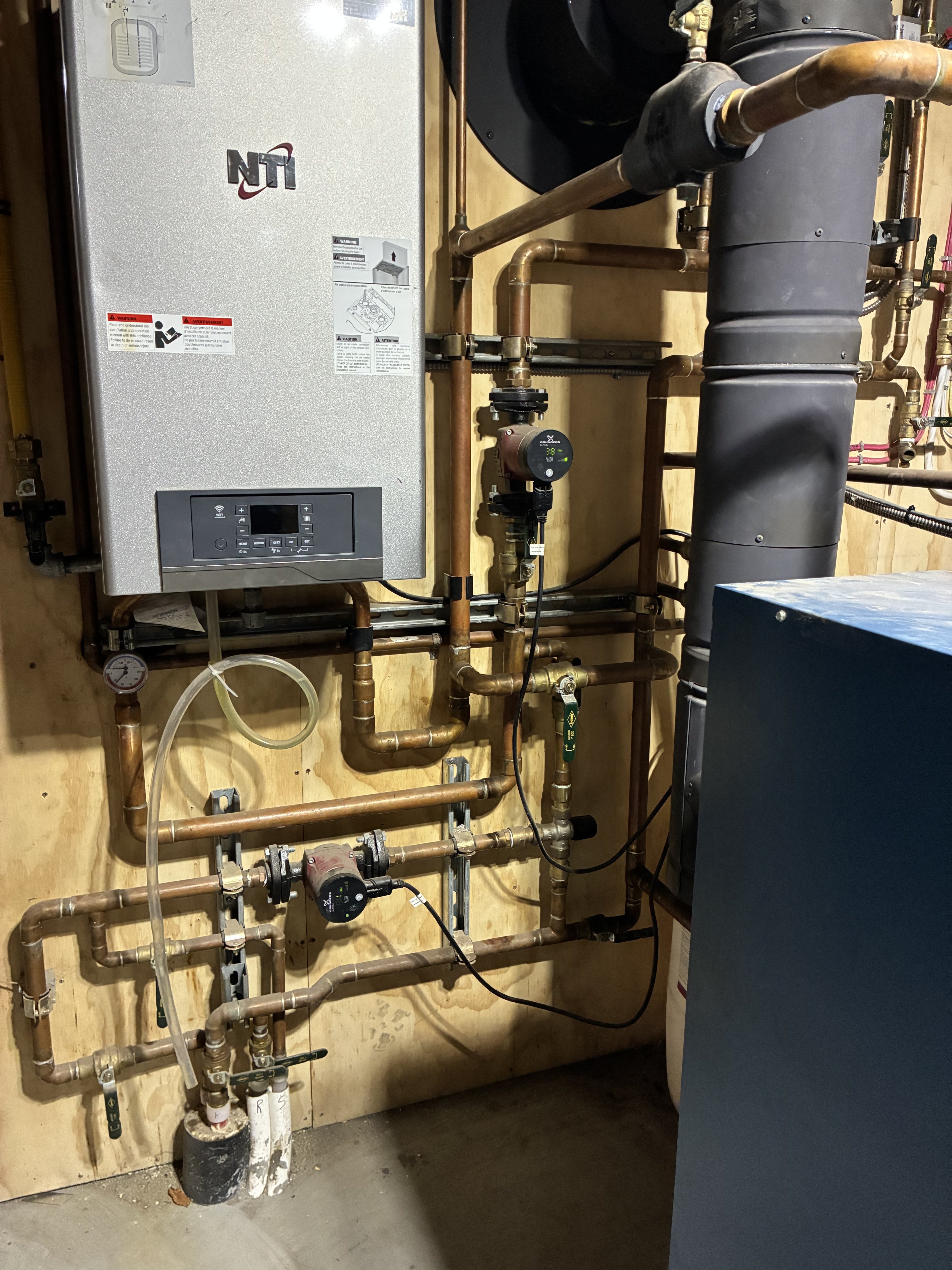

  • it’s a Benjamin heating products DO110 model. It’s not a gasification boiler. It holds 31 US gallons. I already have the house filled with glycol / water mix as my dump is in the patio outside and I have enough glycol to add to loop of garage anyways. Is there anyway you could sketch up a schematic as to the way you would pipe it in parralell? Here’s some pics of how it’s piped now.
    IMG_0353.jpeg IMG_0355.jpeg IMG_0357.jpeg IMG_0358.jpeg IMG_0356.jpeg IMG_0359.jpeg

    How often do you go to dump? If you get the fire management dial in it should be rarely.
    If it does need to dump often consider dumping into an indirect or a zone in the home or garage where the heat is more useable? You paid for that energy, may as well use it.
    A row of fin tube can often be adequate as a dump. And there are options for a dump in the event of a power outage and a pumps can run. Either with a swing check or normal open zone valve.

    Next question is how many temperature zones do you want. You probably send a high temperature to the shop for a unit heater, 140F or above. Maybe 110 to the radiant.

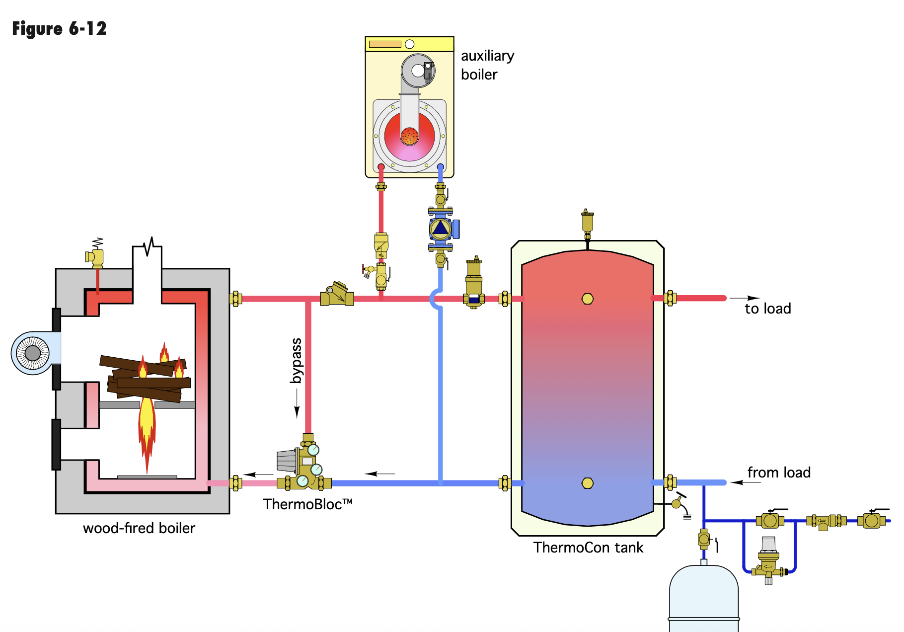

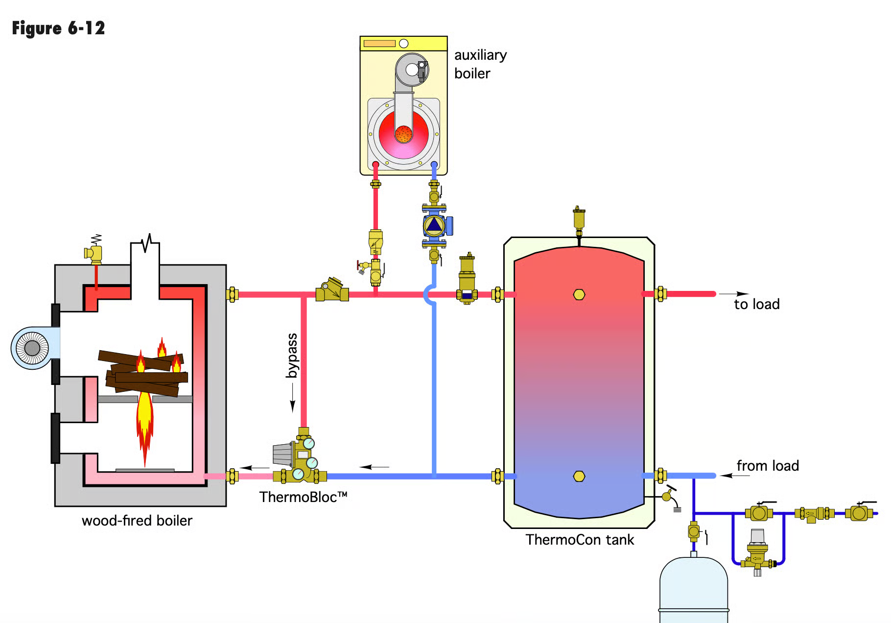

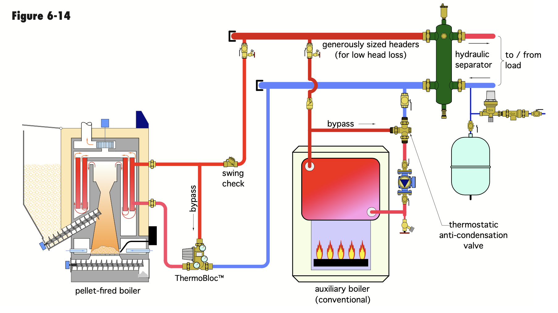

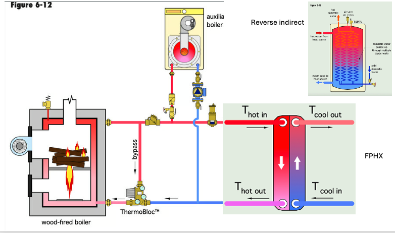

    6-12 shows a buffer tank, but that could be a hydraulic sep instead, same 4 ports, much smaller.
    Then pick off the various loads on the right side of the sep.
    so more similar to fig 6-14 but with the NTI which doesn't need a protection valve. In 6-14 a swing check allows thermosiphon to dump to the sep, then pick the load you want to pump that dump excess to.
    Then the sky is the limit for what you can do off the other side of the Sep. Pumps, zone valves, multi mix temperatures.
    This shows all the zone possibilities off the sep. Maybe a high temperature zone, an indirect zone, a garage zone, then the mix valve for the radiant.
    You have a lot of the components to be used, but it will be a major repipe.
    A patient person could disassembe, clean and reuse a lot of the copper fittings. I made some wood jigs to hold the pipe or fitting without squeezing it out of round, so fittings come off easily. Copper tube and fittings are crazy expensive now.

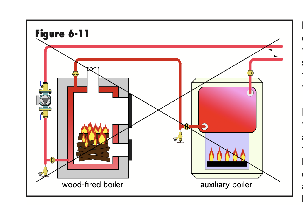

    You really do not want the two boilers in series as the NTI (auxiliary) is just sending heat up the flue of the wood boiler, keeping it warm, plus jacket loss to the room.
    In your drawing the returns all go through the wood boiler to get back to the NTI.

    There are two main issues with your setup.
    The modcon is getting hot water from the wood boiler which means when the modcon fires when the boiler is still hot, you are giving up efficiency.
    When the modcon is running you are circulating hot water through the wood boiler so you have additional flue losses.

    Also does your modcon have a built in pump? I

    If you did want to keep the glycol out of the wood boiler (30 gallons) and associated piping, a reverse indirect is an option that adds more buffer capacity, but more glycol. A $$ tank however.
    Everything pipes off the B side as show above.
    Or a plate heat exchanger which would be higher efficiency and not much additional glycol.
    Both sides of heat exchangers need air and expansion components, maybe a fill tank also to maintain pressure on the glycol side.
