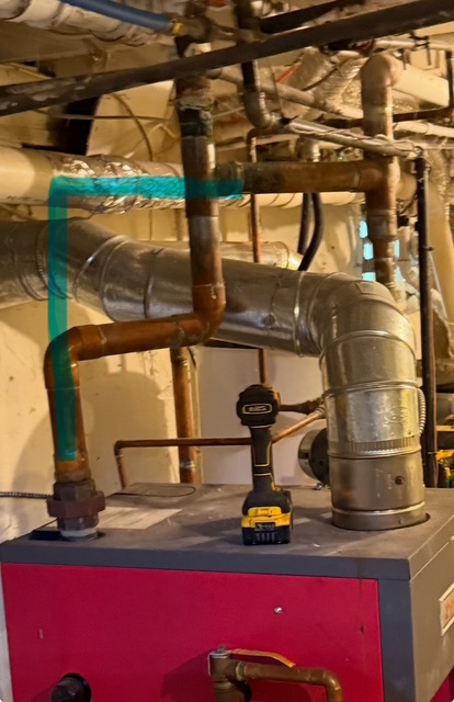

steam main repair
Coolmen
Posts: 24
By flipping the tee is all I need to do to correct this main? is the other main ok in its location. Thanks in advance.
no. the mains should connect with 2 tees in between the connection to the equalizer then a section of horizontal pipe should head toward the equalizer. it should be threaded black iron both for less expansion and so that it can move independently of the boiler.
I will repipe in black iron with new tees .Thank you.
get the manual for that boiler, it is detailed in there.
