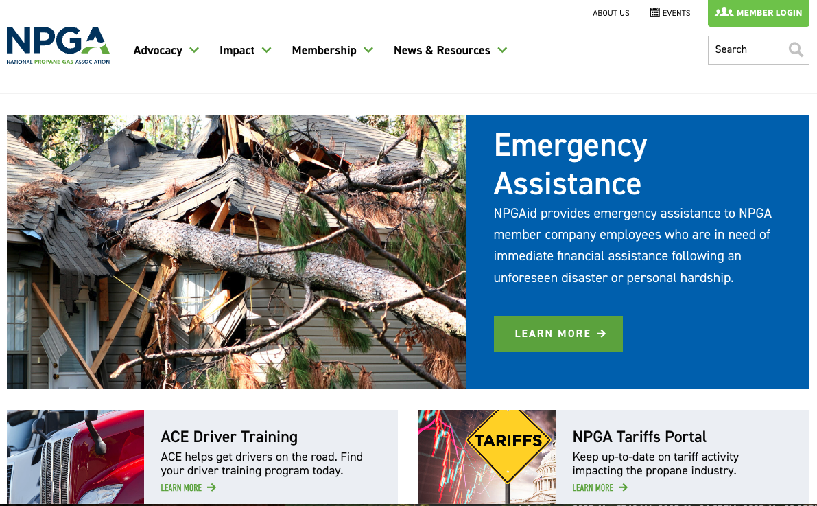

    This site may have a listing of various state requirements. Or send them a question about tank regulations, maybe.
    https://www.npga.org/
