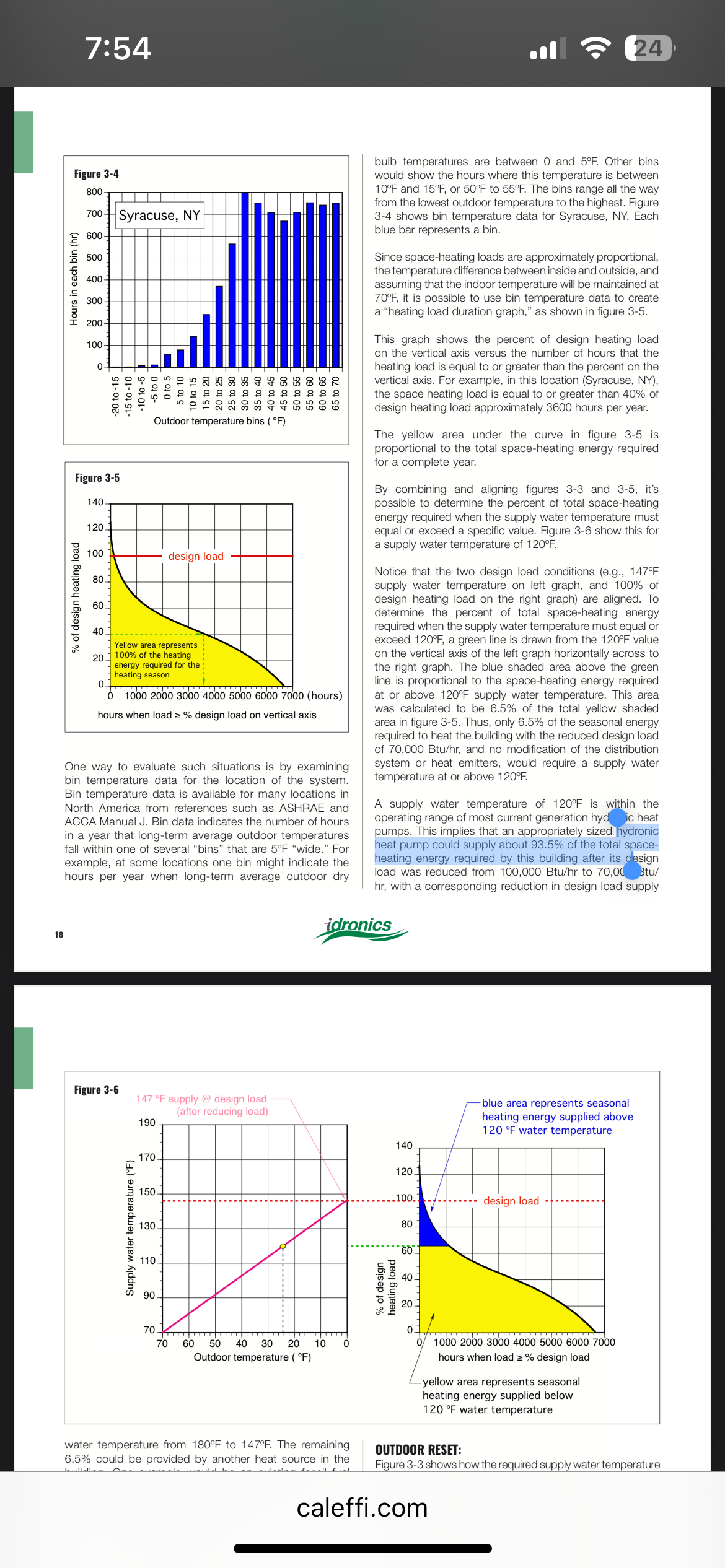

    I was playing around with my Manual J calculation, and if I'm doing this correctly (happy to share my math in more detail, but didn't want to waste anyone's time). Looking at the BTUH ratings for Slant Fin baseboard for a given water temp and back calculating based on design temp, it looks like outdoor temps < 40F would require water temps >130F, meaning I would run in condensing mode if its >40 outside, and non-condensing at < 40. Does my logic check out here? I'm in Northeast Ohio for what it's worth.
    My understanding that the efficiency gain of the mod con comes into play when it is able to run in condensing mode. If we run it at non condensing temps, it is the same efficiency as a CI?
    You had mentioned the ability to adjust water temperature such that it would run continuously. That makes sense based on the math I was doing above, but are there other savings here other than the condensing/non-condensing efficiencies? In my head the boiler is running more consistently, but it is still converting the natural gas to BTUs, just in spurts with CI, and consistently with mod con.

    it’s the return temperature that enables it to condense. So 140 swt, 20 delta puts you in condensing mode. Lower SWT or wider delta gets you there
    Fin tube charts are going down to 120 in some cases to show low temperature output
    Collect some data and assemble a graph like this to answer questions Idronics 25
    The modulation is a big deal, especially on a zoned system
