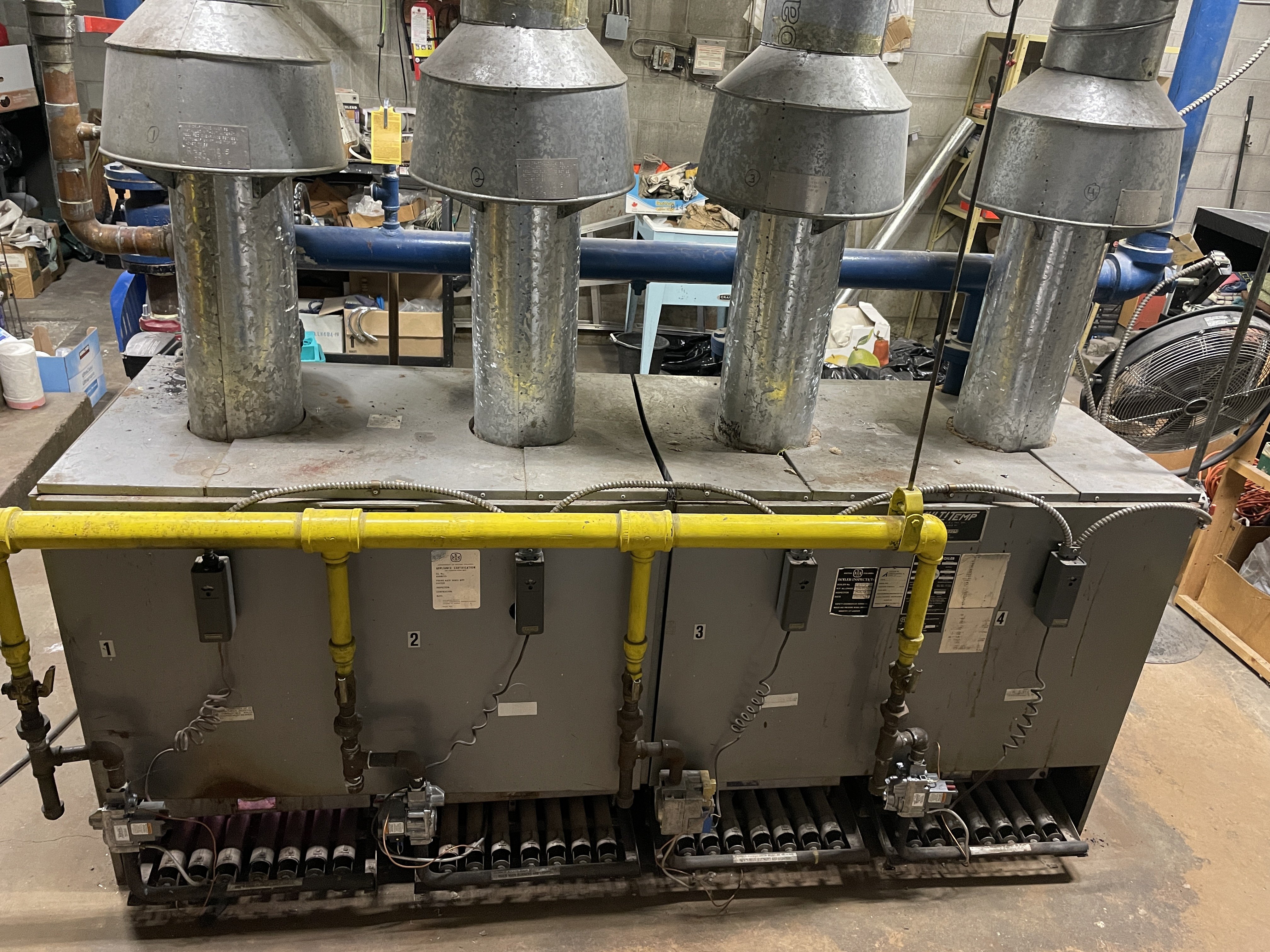

A2W heat pump as primer for 4 bank hydrothermo ( 864,000 btu )
57 unit building - 1969 construction, wood frame, few energy upgrades.
152F supply, 127.2F return ( 25F delta T) at start of heating season.
I am wondering if we could add an air2water heat pump to prime the water on the return to reduce the amount of time that the boiler spends heating it.

    I'd be pressed to install high efficiency boilers in your situation. You might save $2,000 in fuel costs, but that savings will get eaten up by repair costs. And you'll be replacing those boilers every 15-20 years as that's how long they last. There are exceptions; Polaris comes to mind.
    Love those Hydrotherms.
    walnut
  • walnut
    walnut Posts: 47
    Thanks - that is definitely a worry! Is it still possible to replace the hydrotherm units? If one of the four fails?
  • I haven’t seen a new HydroTherm boiler in years. My local dealer lost the line ages ago.
    I would look to replace it with a Burnham cast iron boiler or even a Peerless. Quality American products.

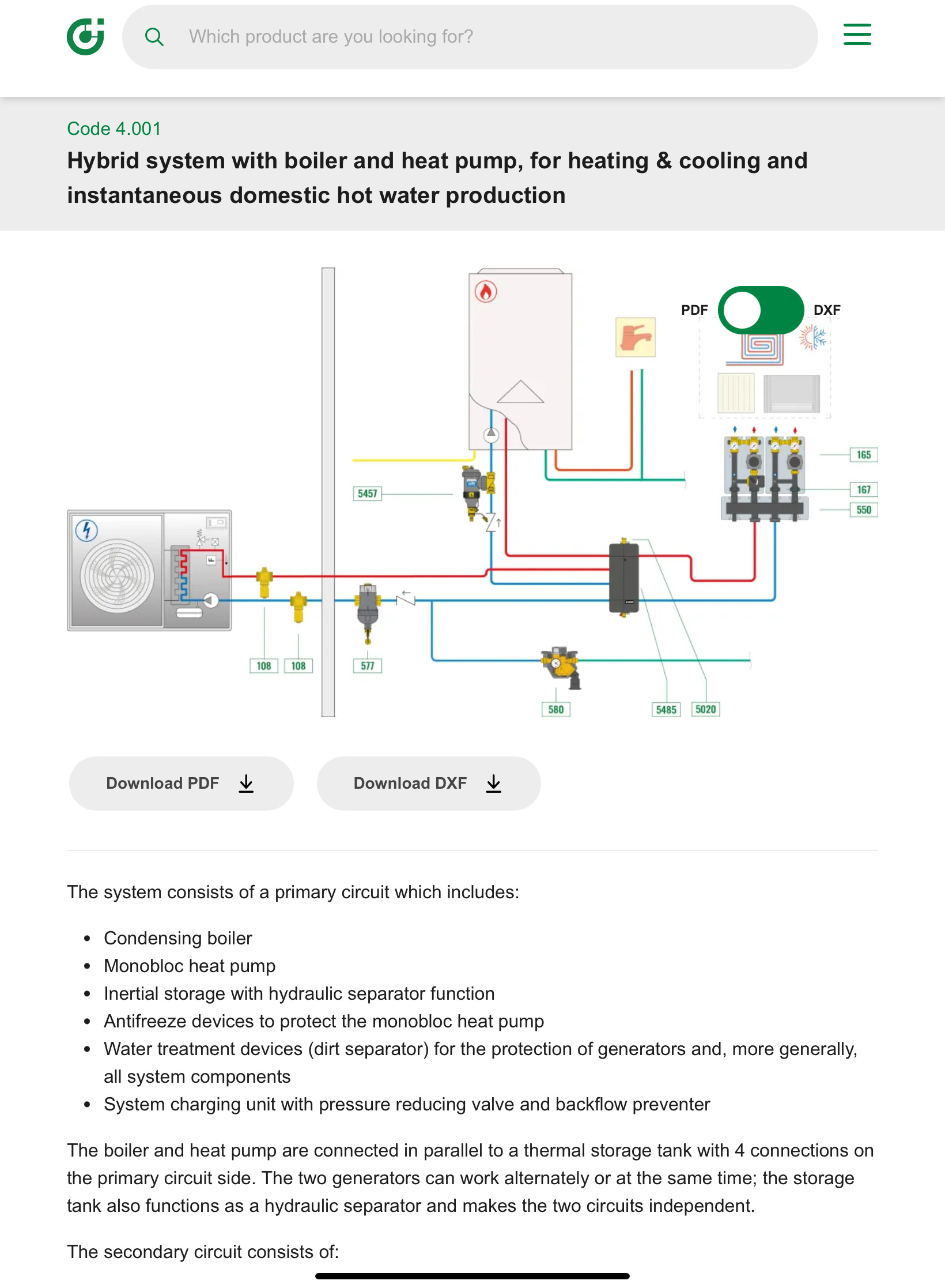

    hybrid pipingisa good option for a system like that.
    We do it with hydraulic seps all the time.
    Mostly with mod con boilers and conventional boilers. This explains the concept.
    But also with A2WHP now. An assessment of the heat emitters would tell how low of a temperature is possible. If there is a cooling option, with air handlers, then a hp makes more sense

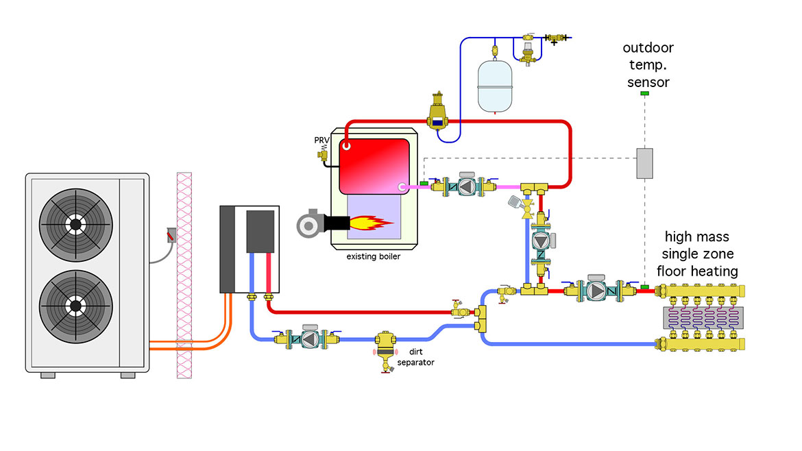

    As for piping, @hot_rod I think this is the better option here
    This puts the two heat sources in series and controls is pretty simple. Heat pump runs all the time, boiler runs only if the supply to building drops.
    I think in case of the OP, the better option is to figure out a way to stage the boilers so only one needs to fire in the shoulder season (thus higher efficiency and less wear) and can pick up a bit of extra efficiency with a flue damper kit to reduce stack losses.
    The above diagram would also work with a modcon pre-heater. You could install a big residential modcon which are cheaper and have it run all the time. This would provide a decent fuel savings without a big cost plus gives you backup in case a hydrotherm or two fails.

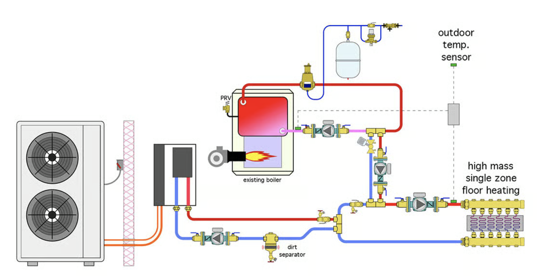

    Another good piping option.

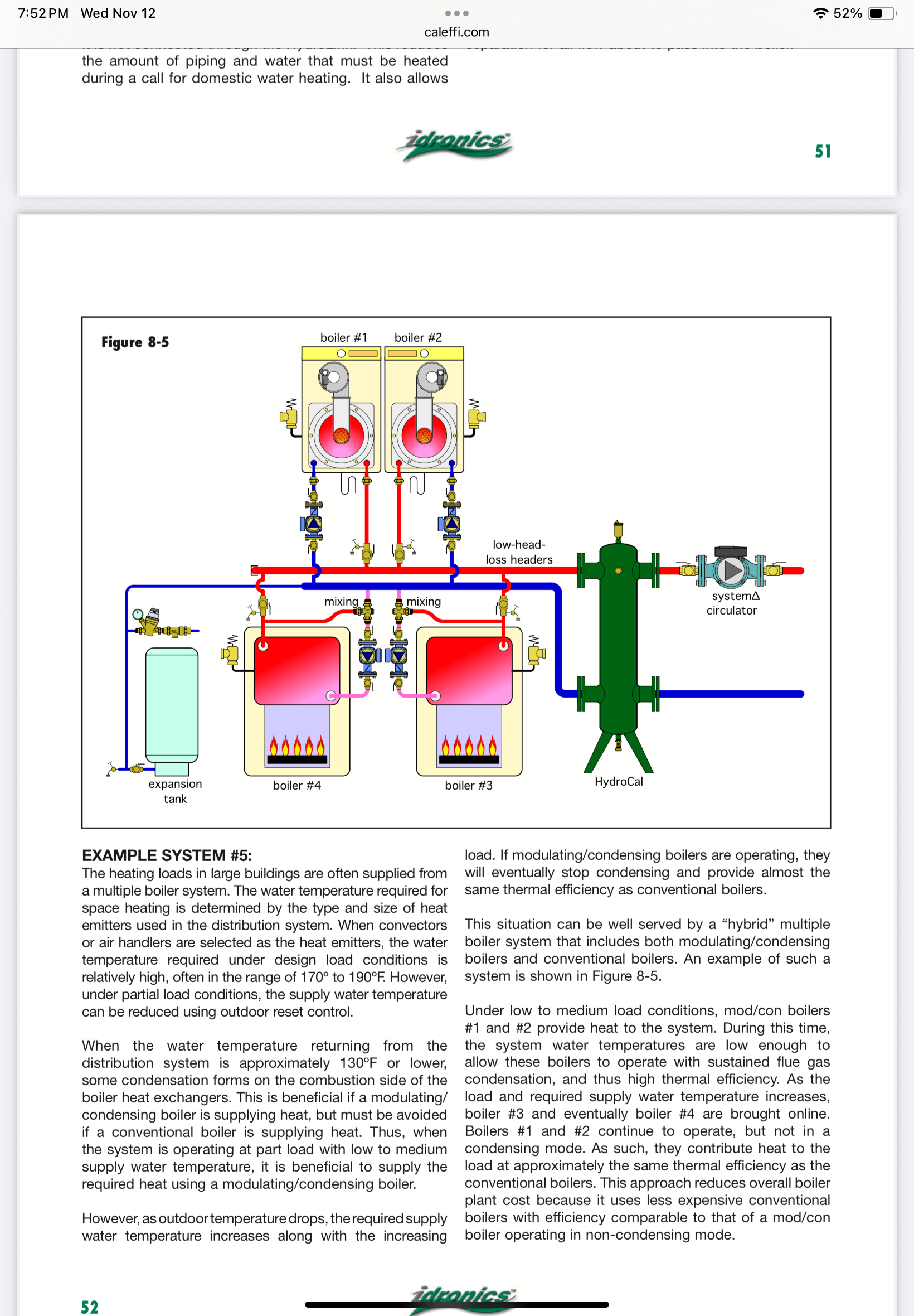

    That was showing a HP addition to an existing system that had injection piping used on a cast boiler/ radiant system. That was a common method in the early non condensing boiler/ low temperature radiant installations.
    If starting from scratch a sep or small buffer could make more sense.

    @DCContrarian With a series setup, this is not an issue, you need slightly different reset curves on each unit. One on the heat pump (or modcon) that is say 5F higher than the one for the boiler.
    If the AWHP is targeting 130F and the boiler is 125F, as long as the heat pump is SWT is 130F, the boiler won't run. When the AWHP starts loosing steam and say output drops to 120F, the boiler will fire. This will bring the loop temps up to 125F and return will rise a bit. As long as the return doesn't go above the AWHP setpoint, the unit will continue to run. My AWHP runs at max power with a 10F delta, so as long as the return stays bellow 120F in this case, it will continue to supply full power even with the boiler running.
    Most AWHP units can be set to shut off bellow certain outdoor temps. You can set this at the cost crossover point.
    @hot_rod The issue with a standard hydraulic separator is that it will make controls difficult as now both units operate in parallel and there is a high risk of mixing flows. AWHP efficiency tanks with very hot return water, something you avoid completely with the series closed spaced Ts. Even though not floor heat, I also think with cast iron boilers, the injection loop is a good idea as it lets you run a much more aggressive outdoor reset on the heating loop without condensation risk.

    I'm not sure how often a boiler and HP would run at the same time? That would need to be defined. Or maybe avoided?
    Injection mixing adds some $$ cost to the already expensive HP installation. The schematic you showed was for an application of HP to a system already in place with boiler and injection setup. Just another retrofit option.
    If the the combined flow rate of a HP and boiler into a parallel header, off a sep, exceeded the load flow rate, then yes you have blending.
    In your schematic with the HP upstream, if flow is greater than the load flow in the primary loop same thing happens and the HP return is increased. My HP flow is varied by the onboard control. And from what I have watches the HP circ never turns off, just modulates down. So I don't have a static flow to work with.
    So you still need to put some numbers to the flows, to design around and avoid this if maximizing the HP is the ultimate goal.
