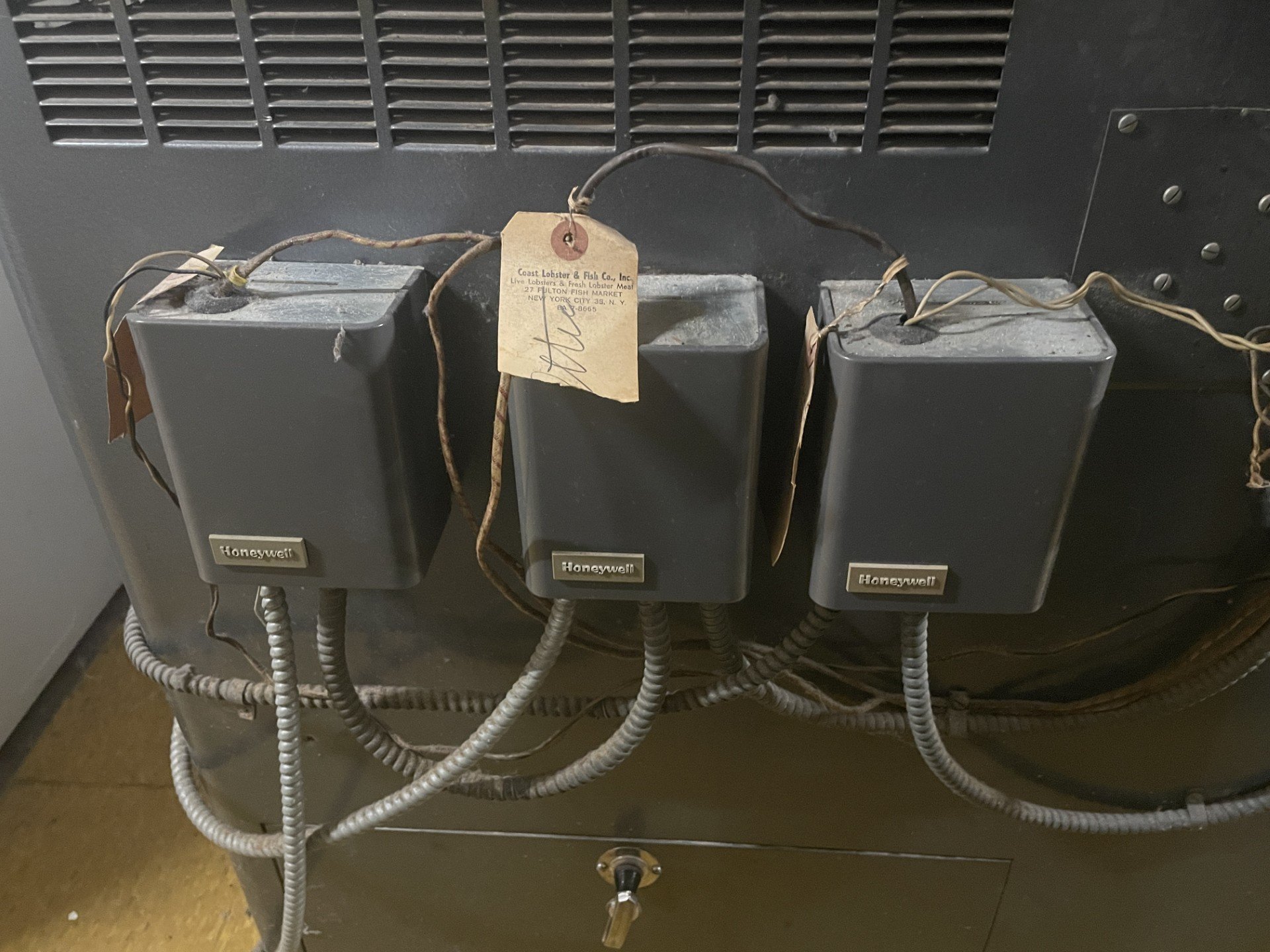

Hello all,
I came here hoping some of the professionals might be able to help me figure out why my gas boiler won’t fire up consistently.
When I raise the thermostat above room temperature, I hear the relay click at the boiler, so it’s definitely getting the call for heat — but the burners don’t ignite.
Here’s what I’ve done so far:
  • If I cycle the boiler’s power switch off and back on, the burners ignite and the boiler runs fine until i lower the thermostat below room temperature (not sure if that was coincidence).
  • After lowering the thermostat to normal and trying again later, the burners fail to ignite again.

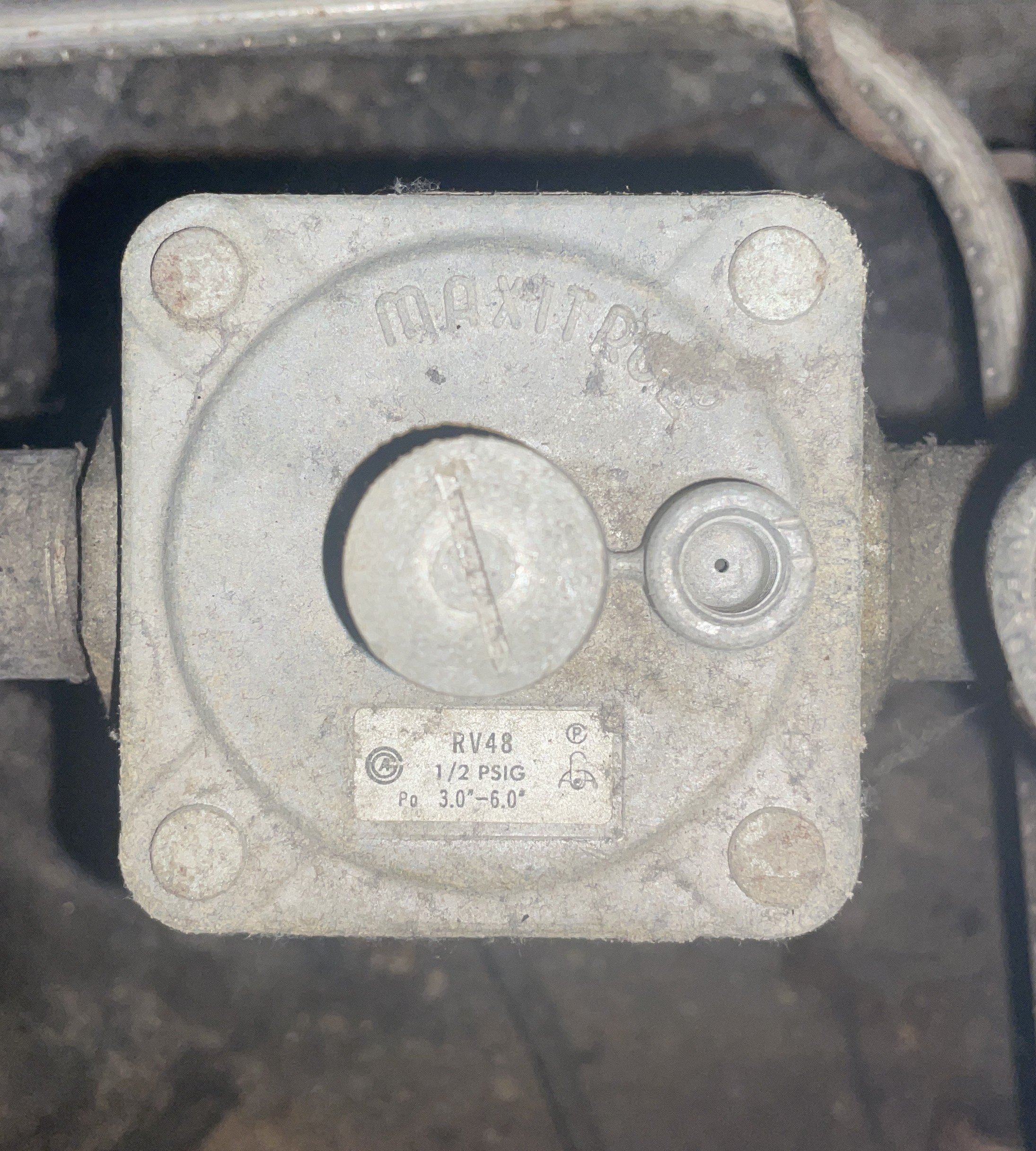

  • I lightly tapped on the White Rodgers 2509-256 solenoid gas valve, and the burners ignited immediately (not sure if that was coincidence).
  • I drained the expansion tank and bled all the radiators.
  • Pressure on the gauge is 12 PSI cold and about 20 PSI when running.
  • Water temperature reaches around 145°F when running.
It seems like either the gas valve or something in the control circuit isn’t engaging every time. Any insight, tests, or next steps you’d recommend would be appreciated.

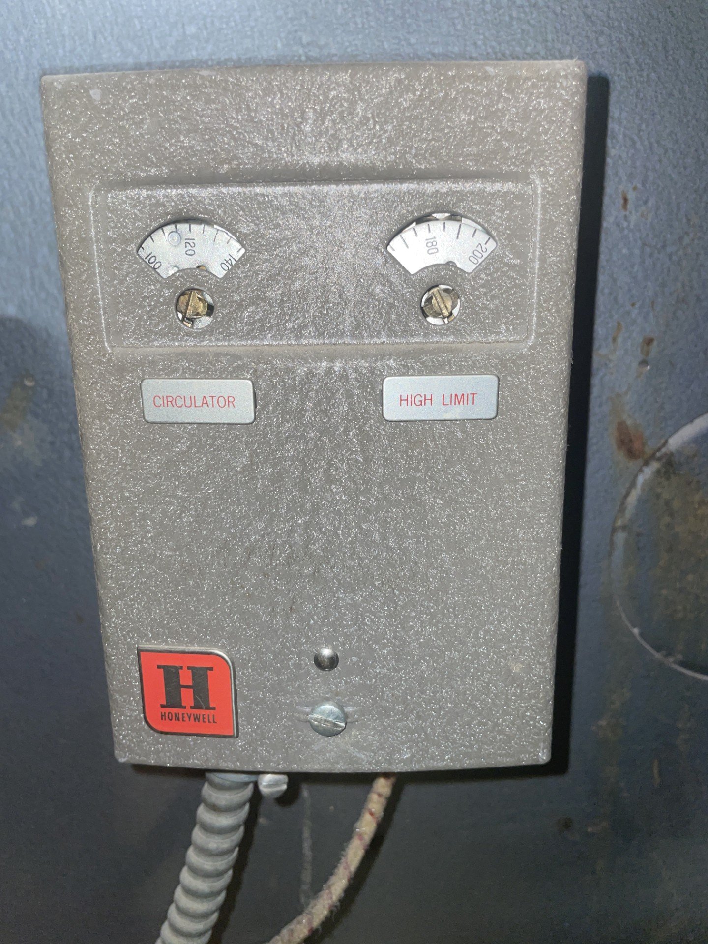

I've included several pictures of what is on the boiler, any receommemdation would be appreciated. I plan on cleaning up all the wiring cause it bothers me. Also as far as maintenance what are the recommendation? any susggestions of upgrading these old parts. Please note this unit has been workign flawlessly for 20 years.
Please feel free to ask all the questions, I have tried to give as much informations as i can and sorry if i left anything out.I cannot thank eveyone enough in advance.
Honeywell Aquastat relays.jpg Honeywell Aquastat.jpg Model Plate.jpg White Rodegers 2509-256 Gas Solenoid.JPG Maxitrol RV48 Gas Regulator.jpg Switch.jpg

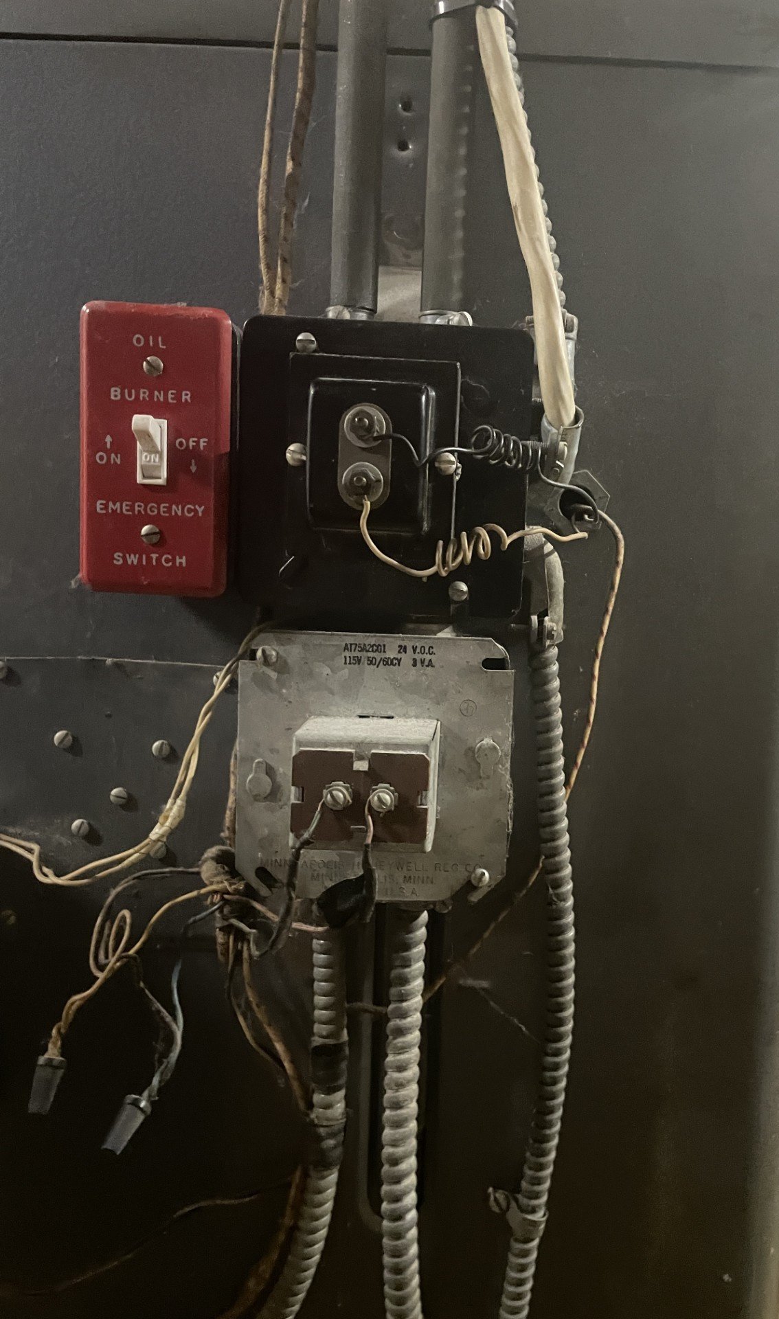

    You have an old system. Over 50 years old. I wonder if there is a wiring diagram attached to any of the panels that are removable? The dual Aquastat marked Circulator / High Limit indicates that at one time there may have been a tankless coil for DHW. Where do you currently get your hot water? a separate tank perhaps.
    The three identical boxes with "Lobster Tags" (center one indicating Attic) would tell me that you have 3 circulators and three thermostats
    Tapping on the heater making the burner start indicates you have a relay that is being powered but is not getting enough power to pull in the solenoid or relay, but with a little percussion adjustment (like the Fonz at the juke box) will get the job done.  This could be indicative of a failing transformer, dirty electrical contacts or a failing coil on a solenoid gas valve or relay clapper.
    Can you post photos from farther back so I can see how this is put together.
    EDIT: the 24v. 3 VA transformer indicates that at one time there may have been an old Chronotherm clock thermostat like the TM850 that required a separate 24v. power supply.

    I ask because of the control marked circulator. There would be no need for a circulator limit control with a standard boiler that does not have a tankless coil for Domestic Hot Water (DHW) when equipped with switching relays for each circulator pump.

  • Hi all,
    Thank you so much for all the help so far — especially @EdTheHeaterMan for the detailed explanations .
    To clarify a few things: yes, this system originally had the old Chronotherm clock thermostat, and there’s a separate gas-fired water heater for the domestic hot water (not tied to the boiler). You were also correct — the system has three separate zones with three individual circulating pumps.
    I began testing all the circuits for proper voltage and found what I believe was the main issue:
    The lower transformer was shorted on the 110V feed side, which in turn appears to have burned out the Aquastat and transformer.
    As I dug deeper, I noticed the wiring wasn’t really up to par with the components installed. For example, one zone’s thermostat (T-T) was connected to the old external 24V transformer (the “silver one” that failed).
    To clean things up, I decided to rewire everything from scratch, eliminating the old cloth wiring
    • Rewired all three RA832A relays correctly,
    • Wired each Nest thermostat directly to its relay’s T-T terminals, and
    • Confirmed the boiler switch hot and neutral were spliced to feed all three relays and the Aquastat.
    I also ordered a new Aquastat L4081B to replace the fried L4010B.

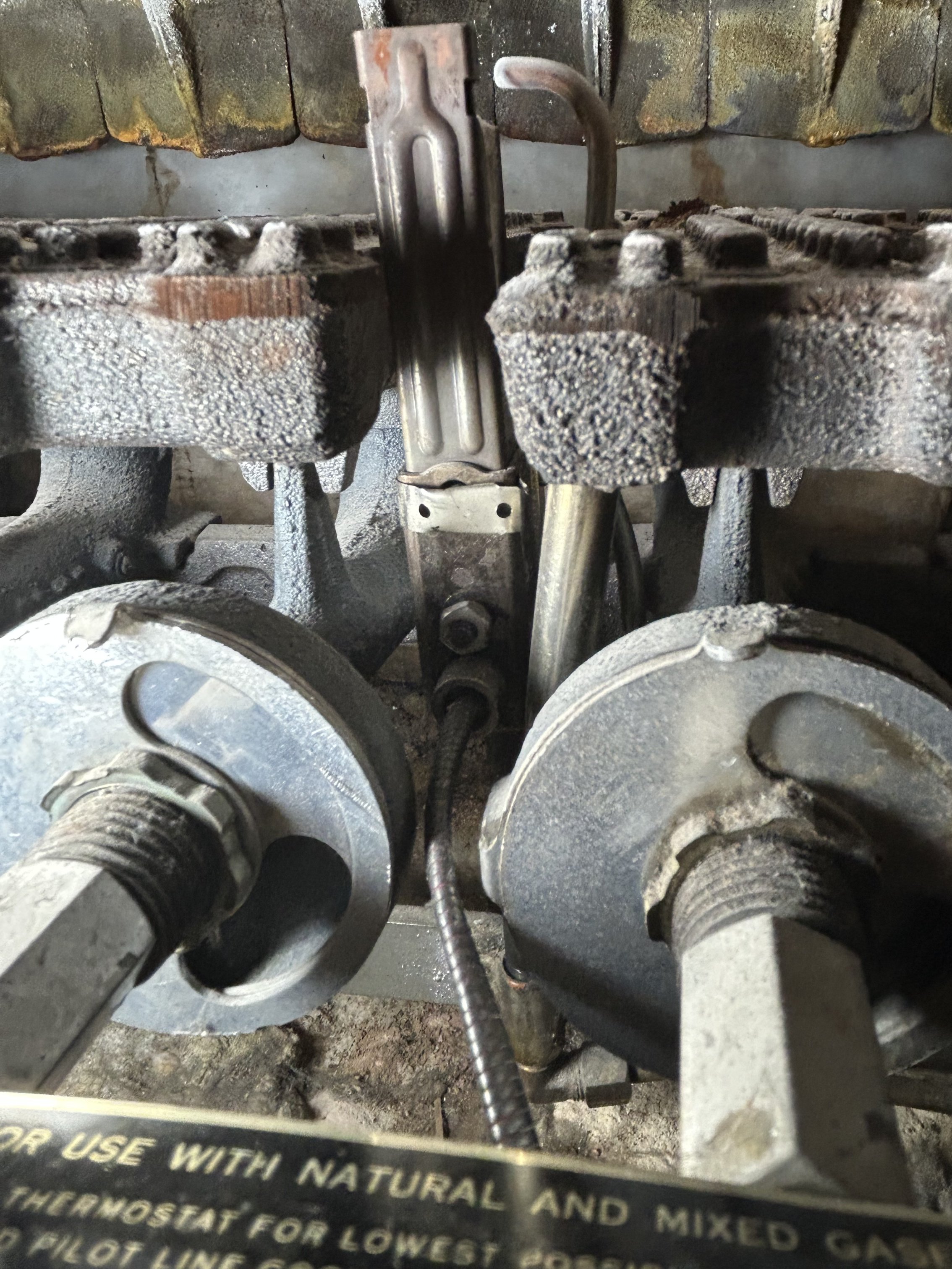

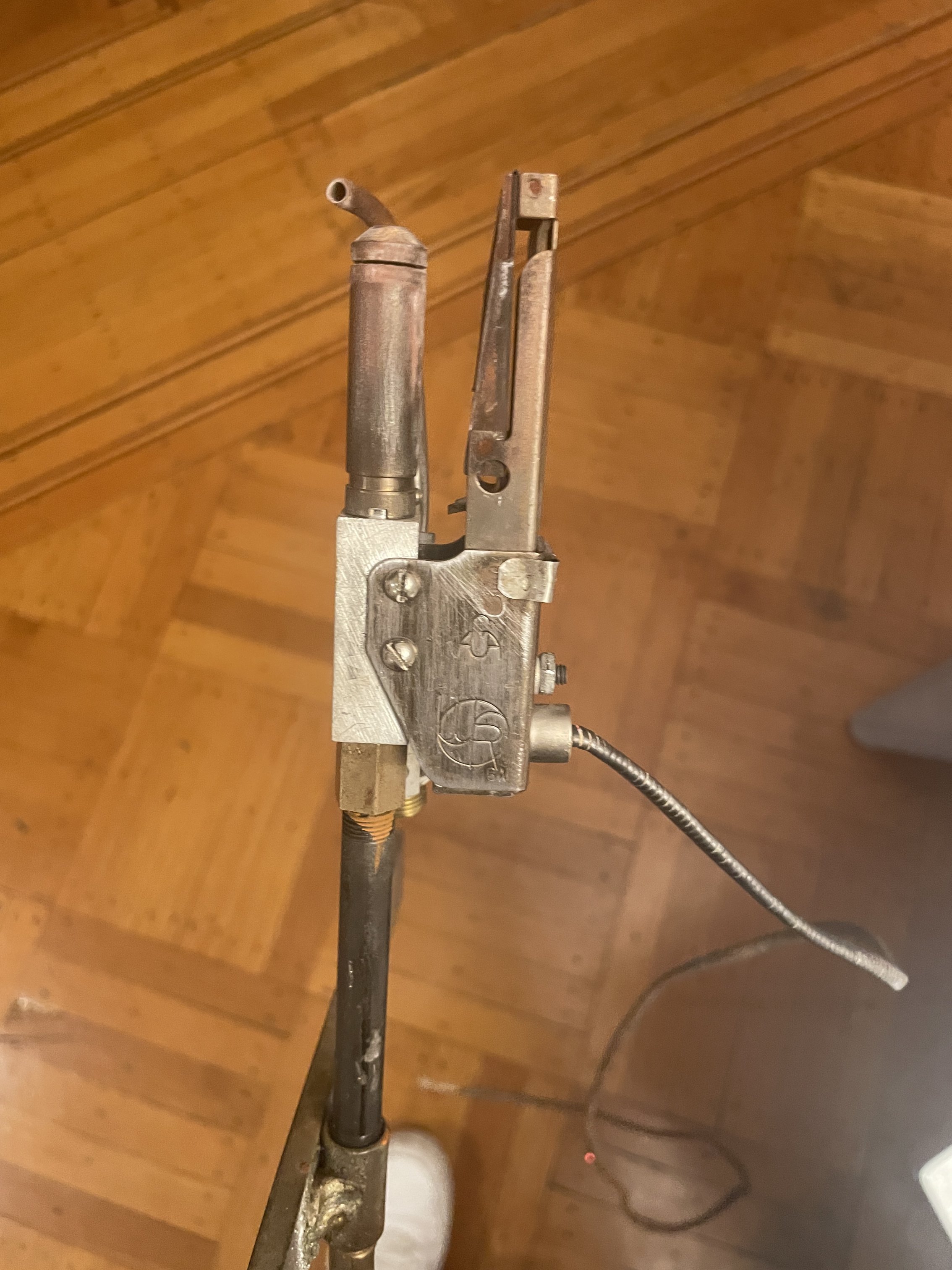

    I am guessing you have a pilot safety switch usually made by BASO although I don't see it in the picture. Can you show us what the metal flex cable goes to? Baso is still in business if that is what you have.
    Also are your Nests wired with a two wire cable or three wire? Do you have a wire to the C terminal on the Nest?
  • Hi
    In the picture it is the rectangular piece that sits between the burners rhe pilot flame sits right in front of it
    It was connected in series red wire to one leg of the transformer 24v and the white wire was connected to one leg on the gas solenoid valve
    I dont know how to test it to make sure it is bad or good
    I have it disconnected and checked the continuity of the sensor and shows open
    My three nest thermostats are 2nd generation which are only connected cia 2 wires W1 and Rh
    I believe that is a thermostatic pilot safety switch. long ago obsolete. not sure of the safety of it but you'd have to replace it with a thermocouple and baso switch if you replace it.

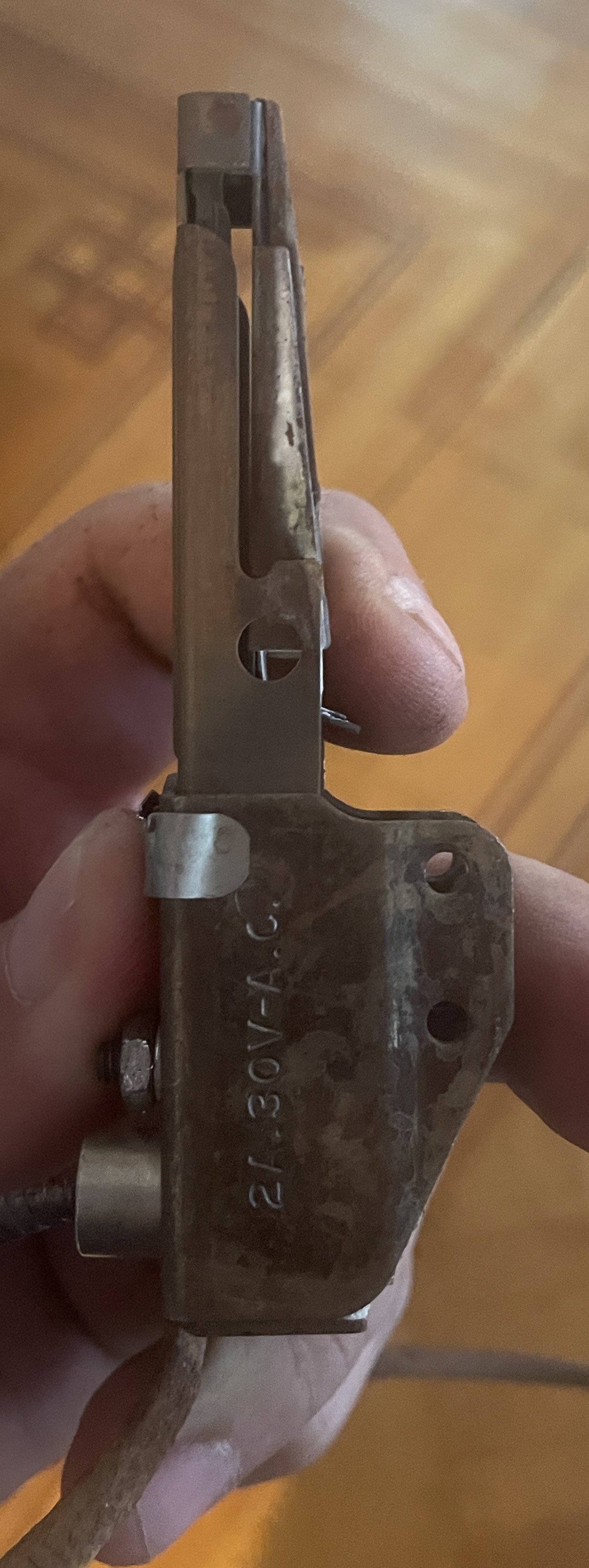

    is there a transformer? does the valve say 24vac or something like 750 mv? does that device have continuity with the pilot out? what if you light the pilot and wait a minute?
    looking at the picture of the valve i think it says 25v?
    if so that is not a thermopile, it is a thermostatic switch
  • Yes, there is a 27.4V transformer, it reads 27.4V coming out of the transformer.
    i measured the unit’s continuity while the pilot was on and it read OL.
    edited November 2025
    The replacement is this(wait for a second opinion from someone that knows old gas controls better but i'm pretty sure that is just a switch heated by the pilot burner):

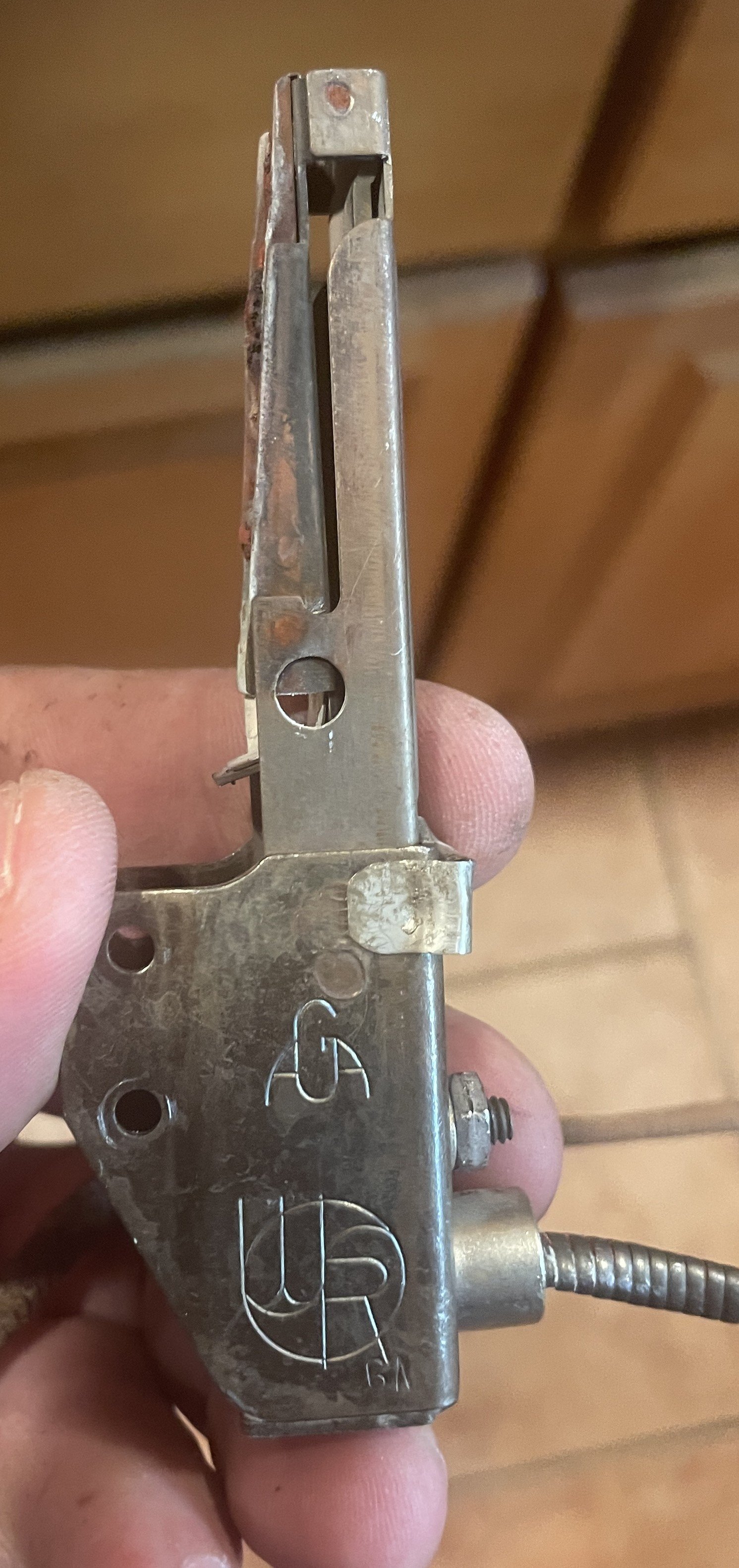

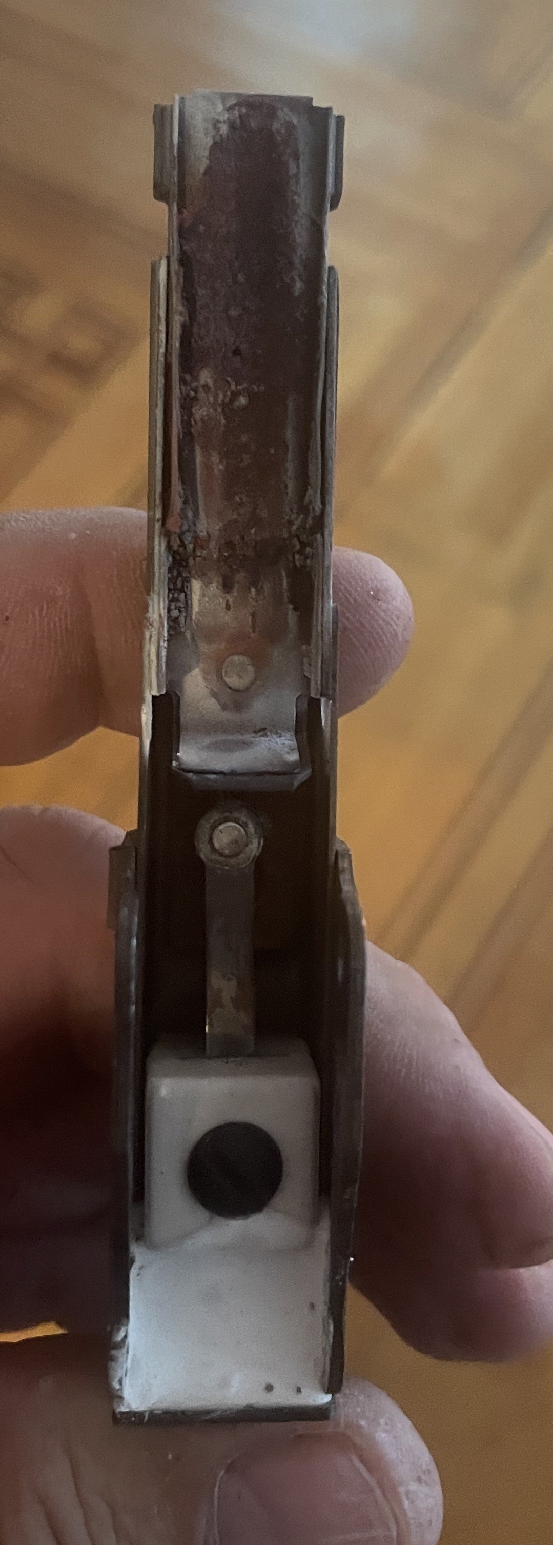

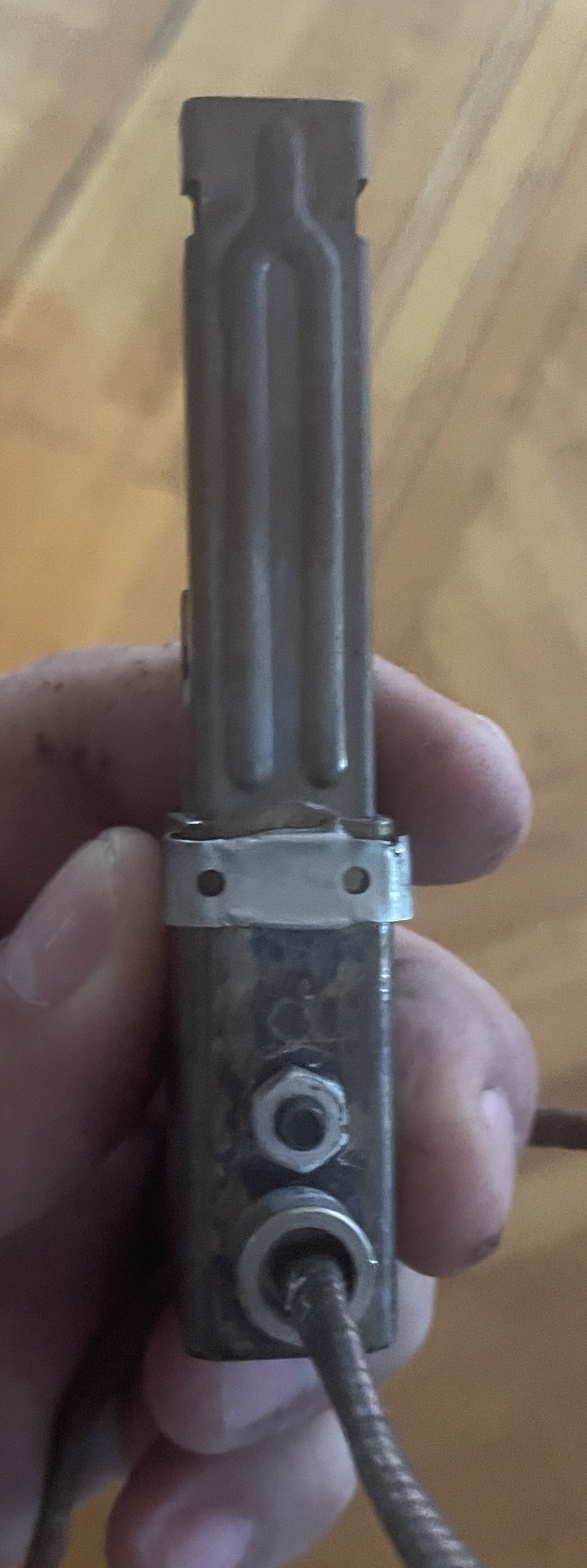

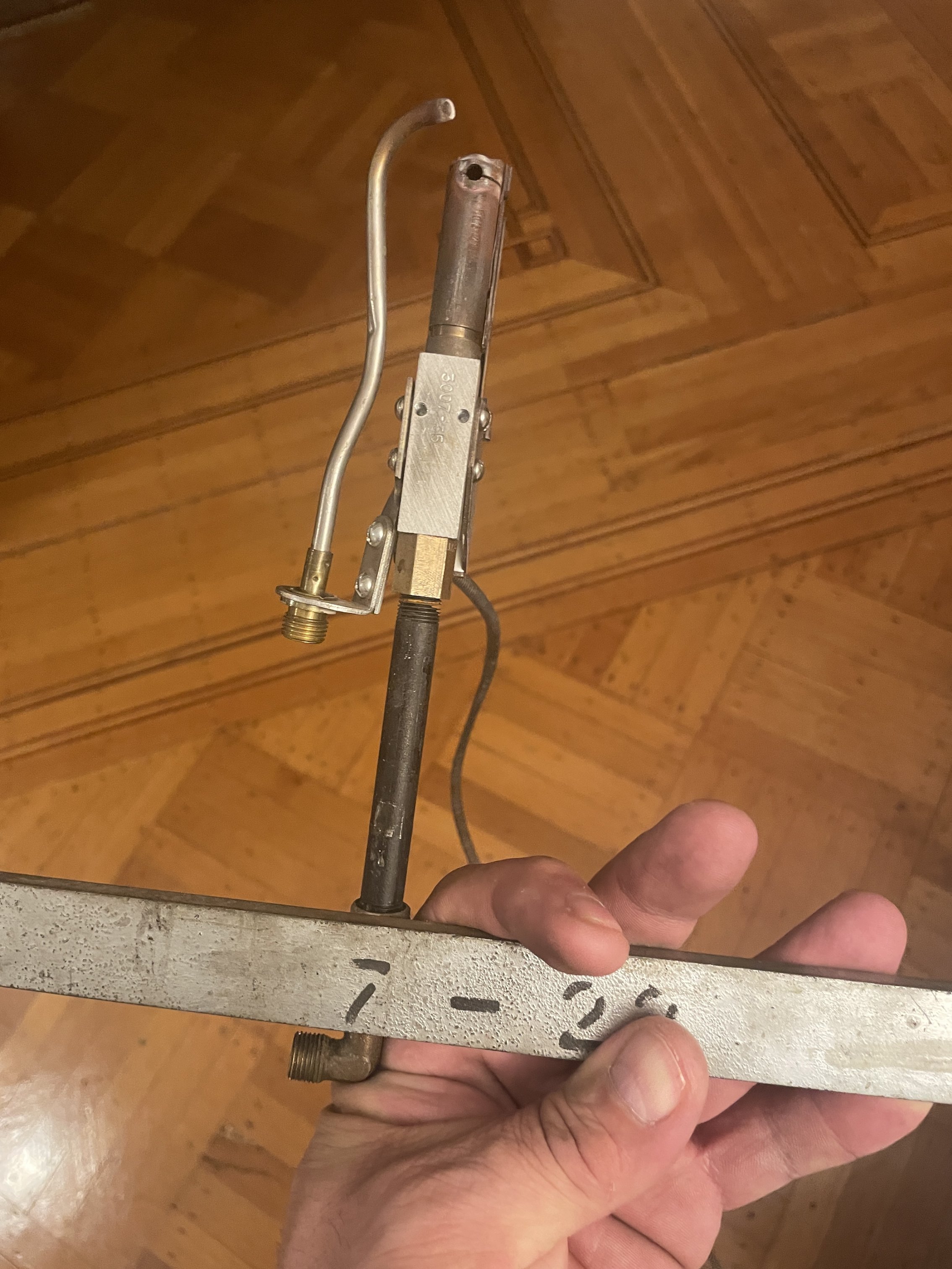

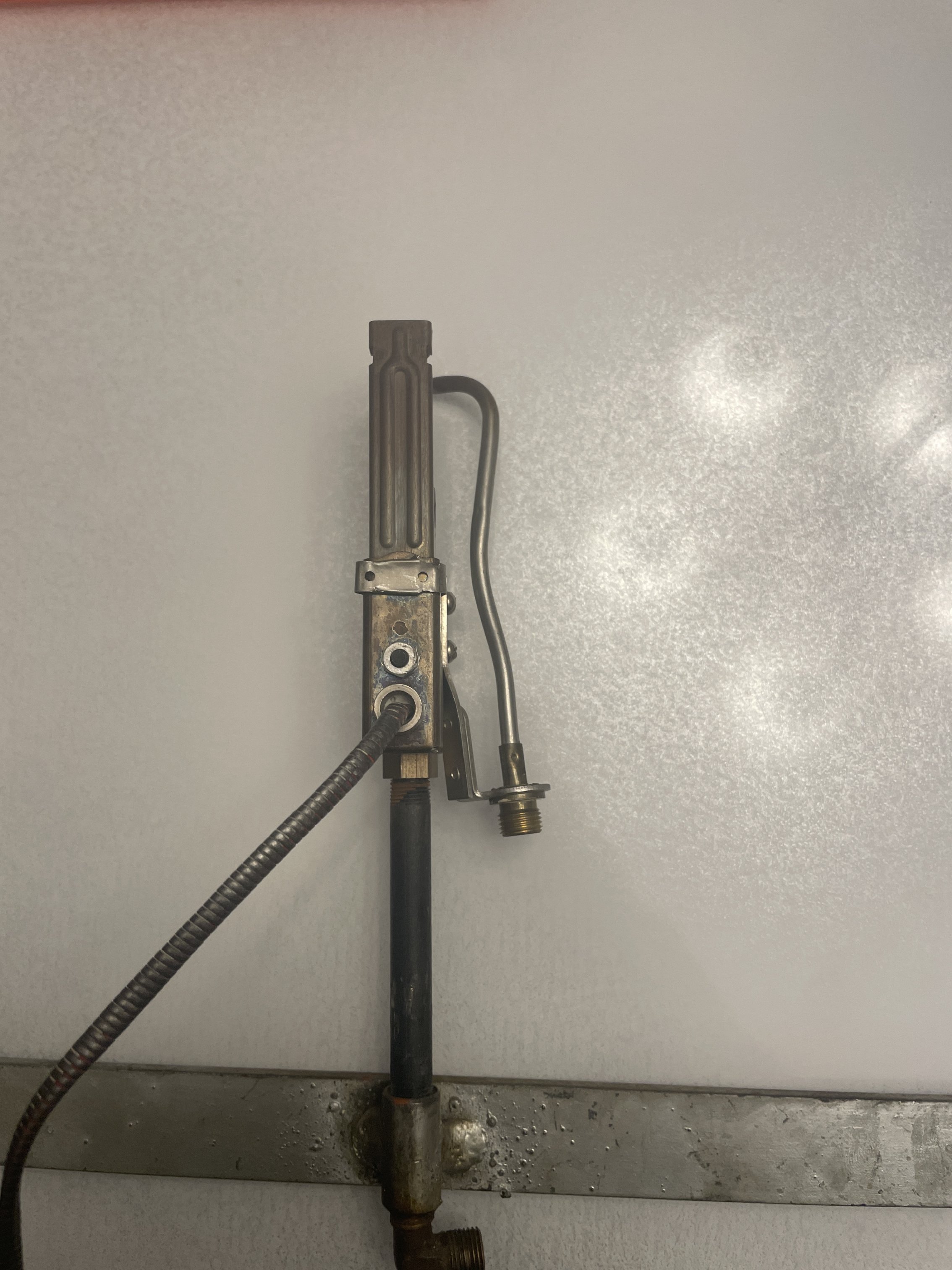

  • Thank you for all your help I finally got around to taking this whatever it is called out so i can take better pictures, was hoping to find a number.
    Please note one lead was connected to the 24V transformer and the other lead was connected to the one side of the gas control solenoid.
    Now Assembled with the Pilot
    it is a thermostatic switch that proves the pilot. i don't believe that they make them anymore.
    you would have to replace it with a thermocouple and a baso switch.
    or a baso valve and thermocouple.
    or a combination valve
