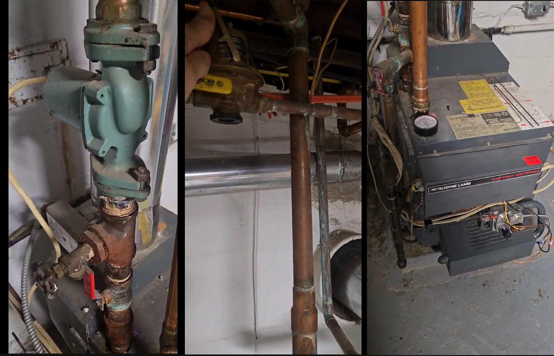

    From the video
    I think this is a copper water tube boiler?  …and it sounds like it is kettling from lack of water flow thru the Copper HX.   Probably want to get a pro in there to determine if the circulator is not operating or if the system is just air bound or is there a blockage keeping the water from moving freely thru the system.
    mattmia2Joannie
    water tube boilers do not like lack of flow. In fact I think laars requires a bypass in the near boiler piping.

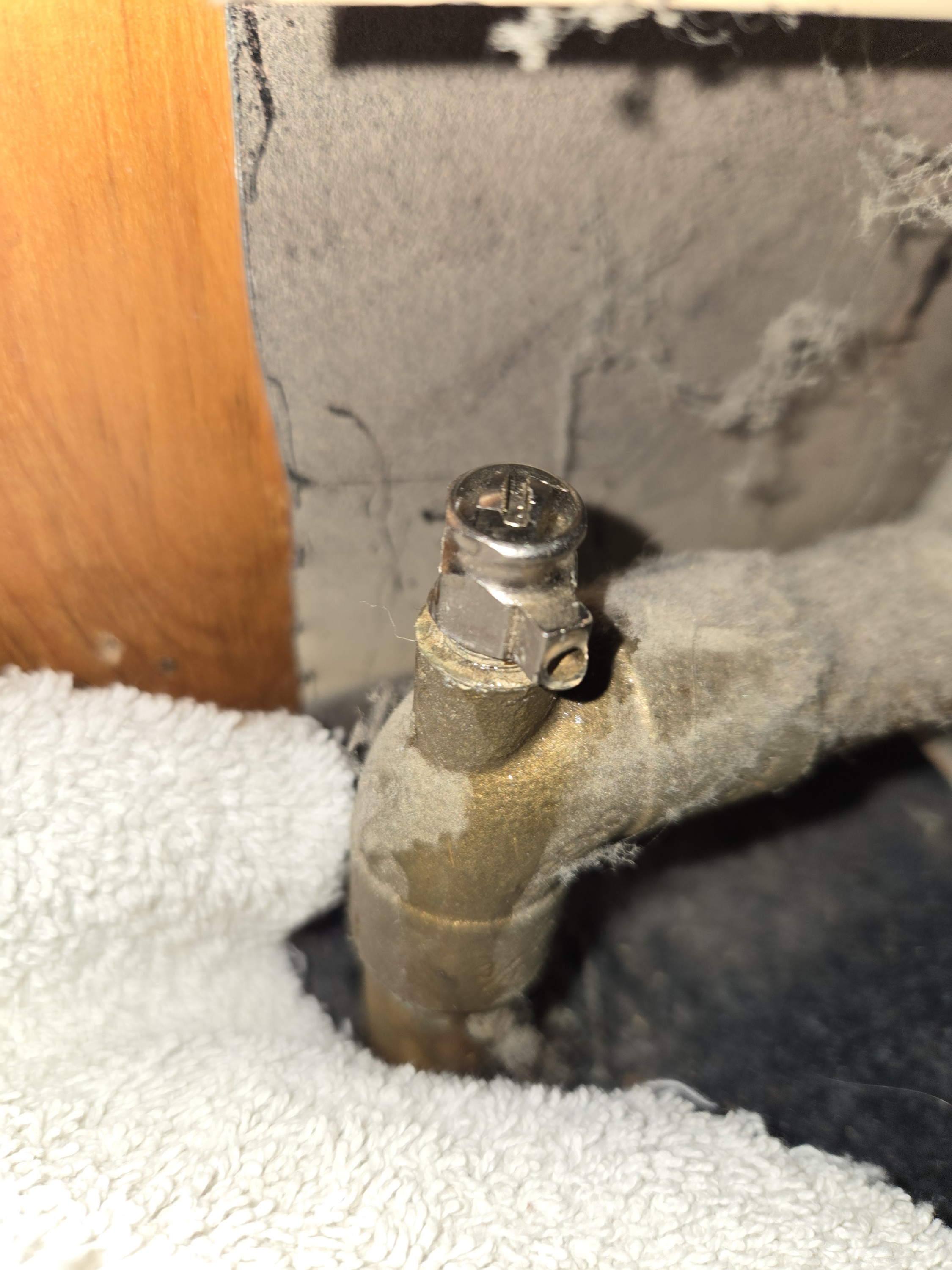

    Edtheheaterman, i opened this vent ( i believe it is what you mean. No air released, only water.
