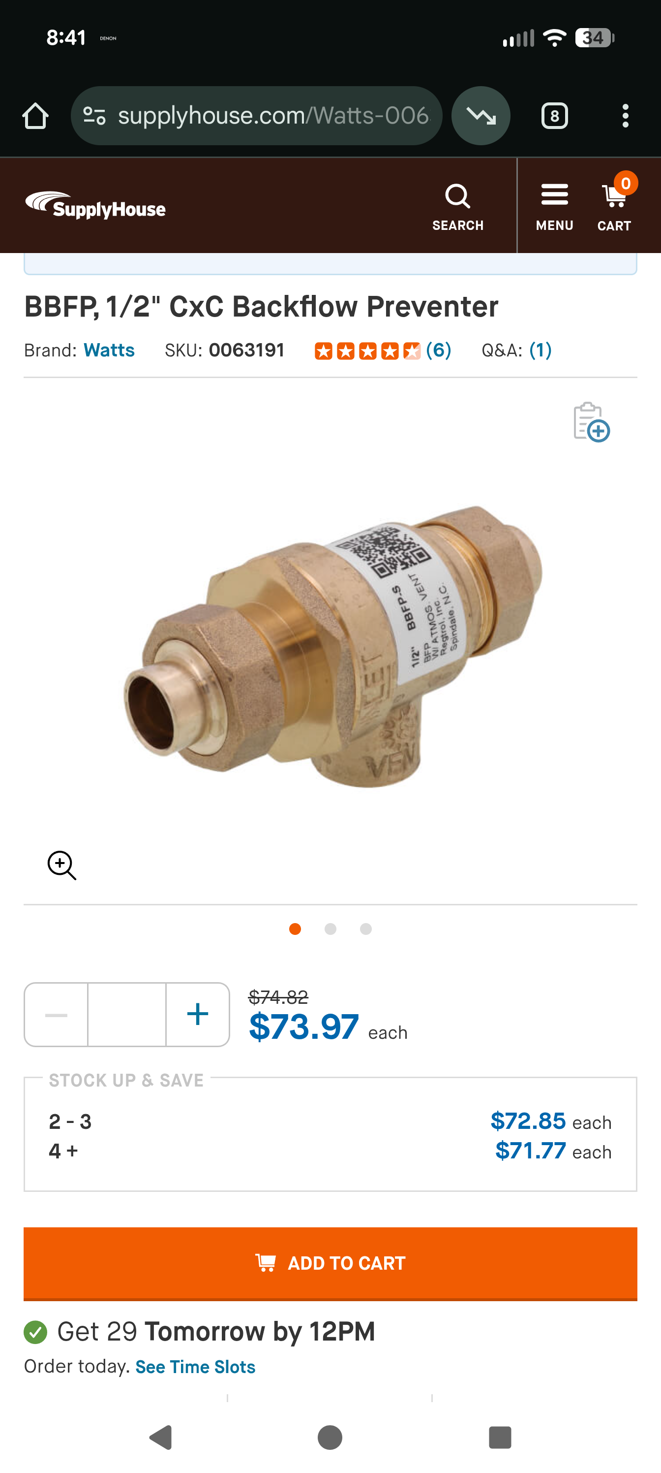

    This is what I'm using.

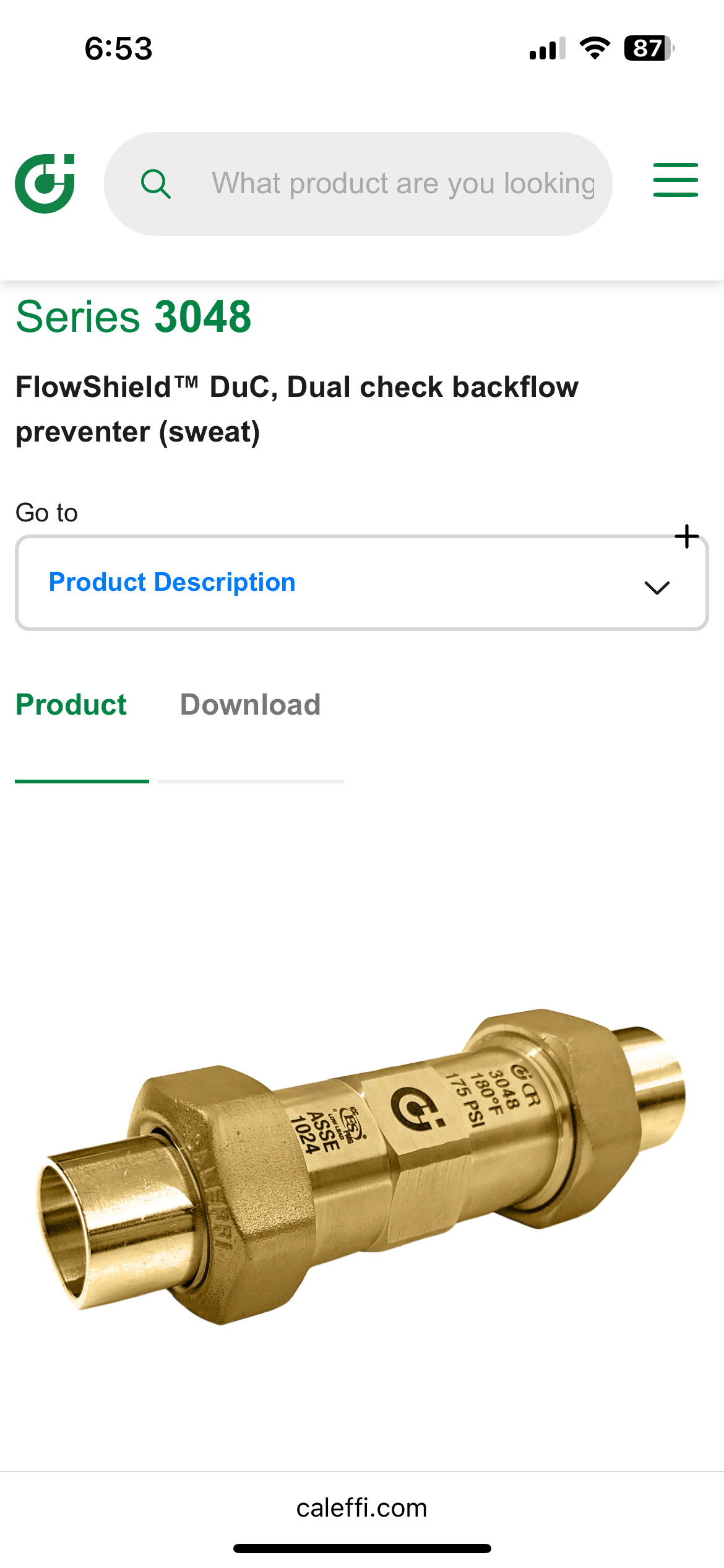

    hot_rod Member Posts: 27,904
    Is your location under a State adopted code? Which one?
    There may be local codes that require a specific device
    In some areas if the country a non vented dual check is accepted.
    This non vented BFD has an ASSE 1024 listing, for example
    Your local plumbing inspector should know and be the final say?
    ChrisJIntplm.
    Intplm. Member Posts: 3,088
    This ^^^^^^^^ is excellent if allowed by code. It's less problematic and will not leak like the RPZs that we are installing for boiler feed. Would very much like to see these approved, and why not as a combination auto-fill and BFP?
    it comes down to how the inspector classifies boiler water. If it is filled with potable water, no chemicals, that could be considered low hazard. The ASSE 1024 is for low hazard applications.
    Mainly the inspector would be concerned about someone adding a cleaner or chemicals down the road.
    Then a BFD with a higher hazard level might apply. Either a vented dual check, or an RPZ with test ports.
    Lot of interpretation in accepting BFDs by AHJs. It is rare to see a code book site a specific BFD number.

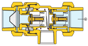

    A 1012 will be a dual check with atmospheric vent.
    Intermittent BFD spit can be cured with a swing check upstream, often.
    When a fast closing valve creates the shock that causes the BFD to flutter, the swing check catches that force and tends to cancel it.
    Of course you will hear that check slap.
    A water hammer arestor at the quick valves can help.
