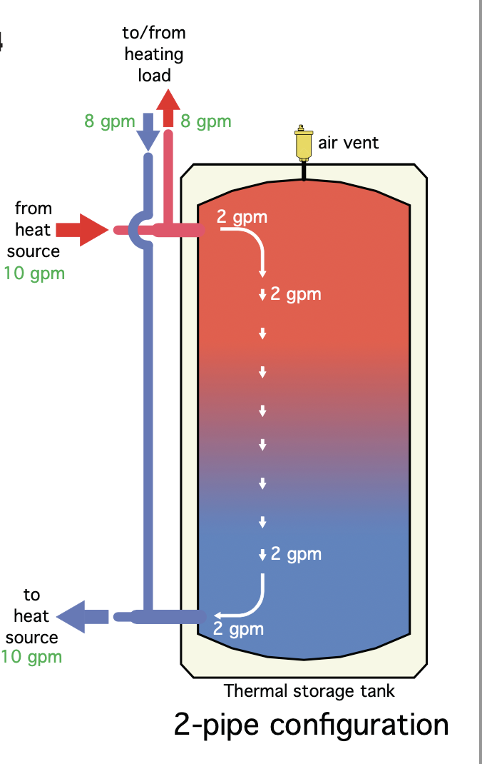

    hot_rod Member Posts: 28,078
    Pipe is always sized by the amount of flow you intend to move through it.
    When doing headers for multiple boilers, loads, the pipe sizes for the total gpm at around 2 fps.
    If you do a 2 or 3 pipe buffer, the connection at the tank needs to be sized up, as it is the hydraulic separation function. In this example at least 1-1/4" for the 10 gpm requirement.

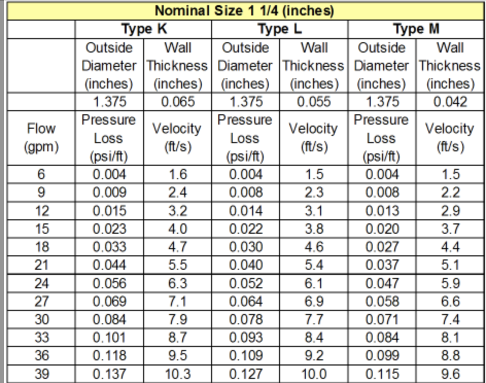

    The EngineeringToolbox has good flow sizers. for
    e
