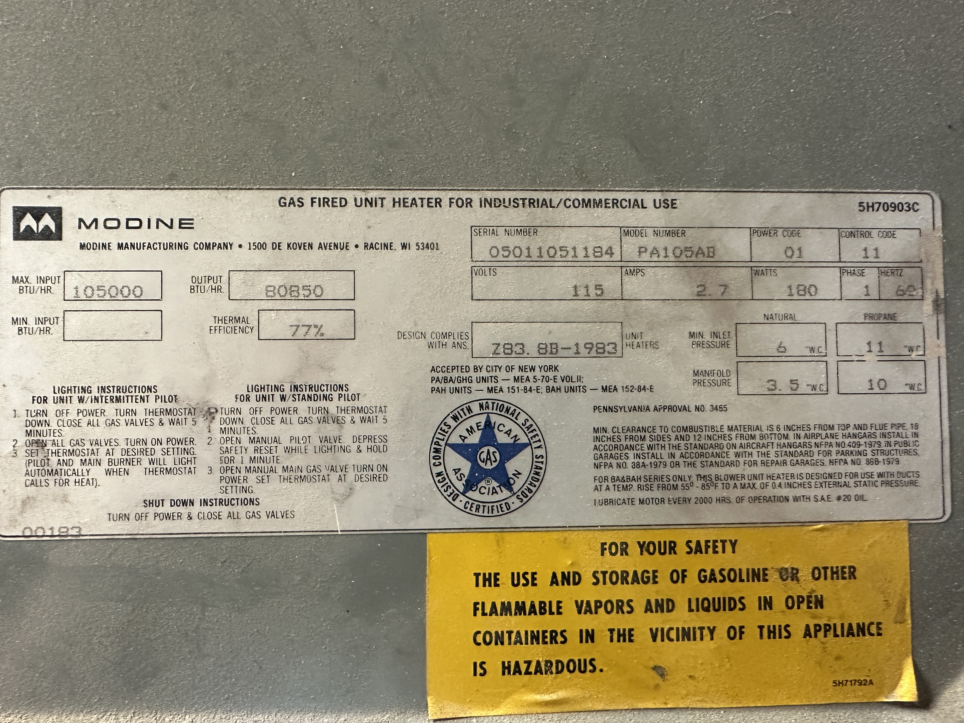

Hello There! Need help finding a replacement valve for my Modine Shop heater unit. It is a standing pilot system and a picture of the sticker on the side of the unit is attached. Hoping for a direct replacement that I can just swap out. Any help is appreciated. Please let me know if there is any other specifications I should list. If anyone can provide a link to the replacement product that would be great!

    You would need the make and model of the gas valve. I looked on Modine web site but couldn't find a parts list for this older unit. You could try calling Modine or find a wholesaler in your area that sells Modine.
    Other than that, you could give Supply House.com a try and see if they can help.

    Thanks for the info Ed. I'll look to see if I can find a serial number listed anywhere on the valve.

    Basically what has been happening is the heater blows itself out periodically. Sometimes heater will stay lit for 2-3 weeks sometimes 2-3 days. No real trigger or correlation can be found, seems to happen at random. It happens in dramatic fashion sometimes (blowing off the light cover about 2 ft away from the face of the unit). The valve also seems to leak a little around the pilot knob when being turned. I Had a HVAC company come look at it, he said it wasn't dirty, all the pressures were correct and the only thing he could think to do was change the valve as he thinks it's probably very old and not functioning properly. Only problem is he wants to charge me $2,000 to swap out the valve. Seems pretty rich for something that can just be swapped out and doesn't seem overly complicated. Just need to find the right part.

    you need to check the pressure and do a combustion analysis and adjustment after you change the valve.
    what was the voltage out of the thermocouple?
    were any crossover tubes or ports in the burners clear and in place? was the inlet pressure steady? was something changed that overloaded the piping? is the service regulator failing? was the pilot burner the right size and in the right place?

    all of the pressures were steady and the correct readings according to the HVAC service guy. Everything was operating exactly as it should be according to him. He tried multiple times over an hour and a half to try and reproduce the heater malfunction to no avail. It's random. He checked the regulator, the pilot, the pressures and cleaned everything as I have already done in the past. The pilot stays lit until what I'm assuming is excess gas blows itself out. I assume this means the thermocouple is operating properly since it stays lit.. He pretty much indicated nothing was wrong with its current operation and the valve must be periodically malfunctioning. Which is why that was his only suggested fix for the unit.

    Hi, This sounds like an ignition problem which might be fixable with tweaks around the pilot assembly. I'd certainly start there.
    Things I'd consider:
    Cleaning burner assembly
    Checking size of pilot
    Checking pilot flame/ thermocouple contact
    Checking thermocouple electrical connection and output
    Checking placement of pilot flame re main burner
    Checking thermocouple when main burner is running to see if overheated
    No doubt there are other things, but this is a start. It wouldn't be much fun to replace the gas valve and still have the problem. 👹
