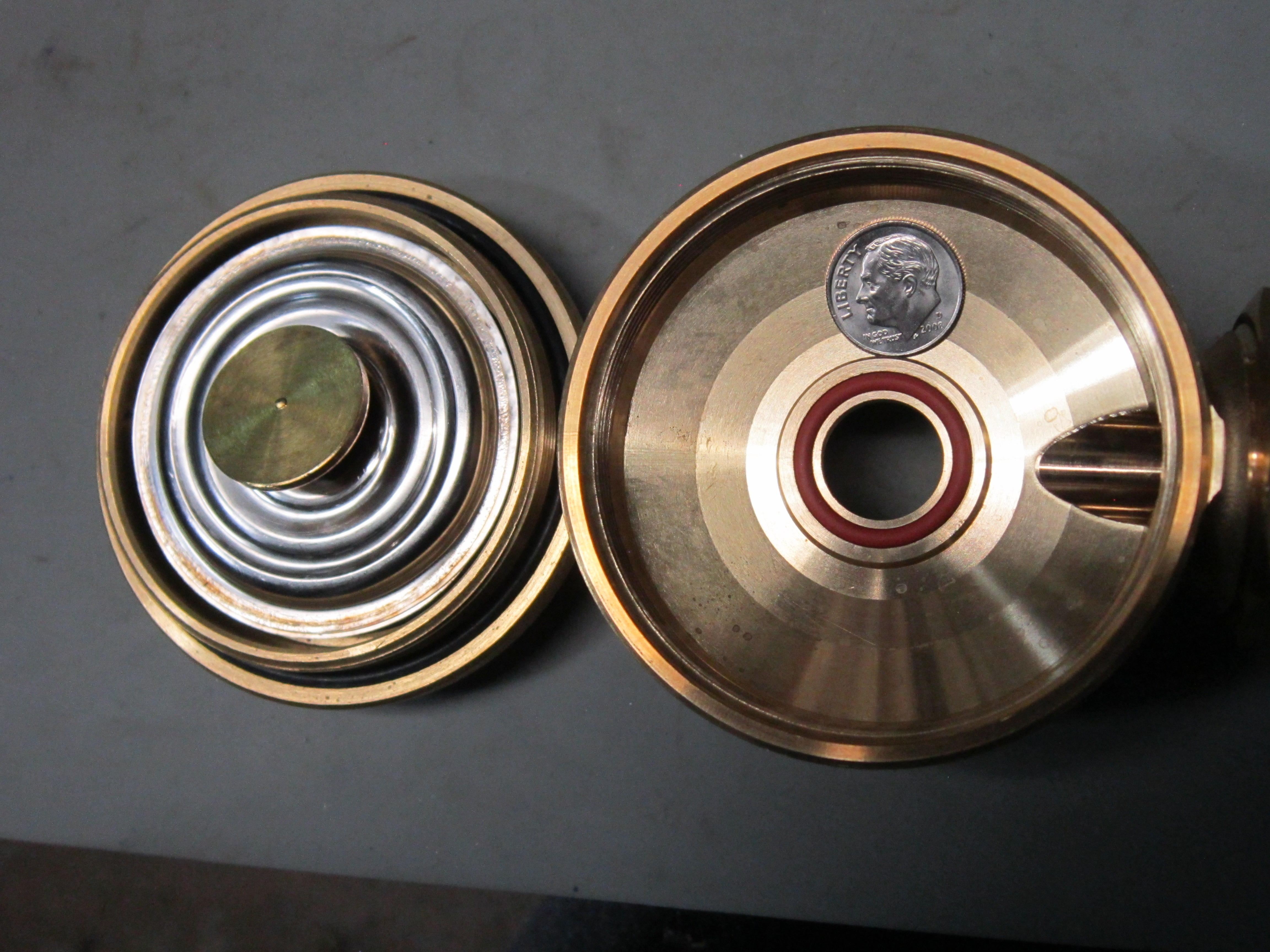

  • Curious. How are the capsuls in these big mouths? Do they last longer than regular trap capsuls?
    Bryant 245-8, 430k btu, 2-pipe steam in a 1930s 6-unit 1-story apt building in the NM mountains. 26 radiators 3800sqf
  • What i meant is: how do they differ from radiator trap capsules?
    109A_5 Posts: 4,759
    @guzzinerd When I had mine apart IIRC the capsule would spin, and the valve disk would also spin independently from the capsule. I did not try to remove the capsule, I assume it unscrews from the cap but not sure.
    Steamhead Posts: 19,007
    edited November 2025
    I think it does. That's not a "capsule" or "cage unit" per se, it's an old-style trap element.

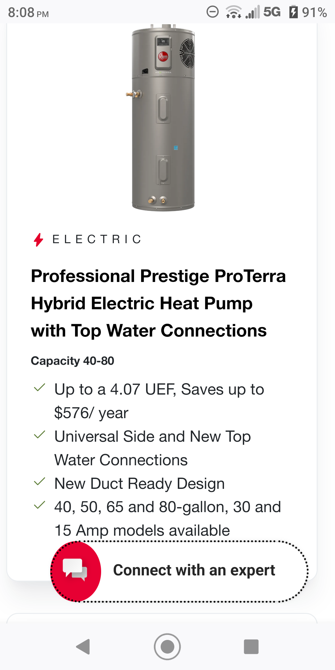

    That's the model I'm going with. And since it's only me living here 50 gallons will be more than enough capacity for a once a day shower and laundry once a week and occasionally running the dishwasher. I've talked to multiple people who have them and they are very pleased with them. Never run out of hot water and very efficient to run. The problem I have with the domestic coil is when the boiler isn't steaming and is at 180 for the hot water I do run out of hot water, water will be great for a few minutes then it gets lukewarm and then it takes another 10 or 15 minutes to get really good hot water again in the shower. However when she's steaming hot water is great. NPU is great to deal with. I only get electricity from them though. Where I'm at there's no natural gas city water or sewer.
    the hp water heaters fall back to electric if they think they need more demand.
    you could also heat an electric tank or indirect with the tankless coil so it is storing water but only heating the boiler when the tank needs to be heated
    another option is to bring the dhw through the tankless coil then to the electric/hp water heater but set the boiler to cold start so if it is running a heating cycle or still hot you heat the water before it gets to the dhw tank but you aren't running the boiler just to make dhw.

    I'm going to completely abandon the domestic coil, the house used to have a traditional hot water tank that lived in between the oil tank and boiler. I already have 10 gauge power to the spot where it would be installed. I think with me being here by myself, it would be very efficient running it either in energy saver or heat pump only mode. One of my friends his only costs him about $5 or $10 a month in electricity. I don't mind having the boiler as a cold start. I don't want to burn oil in the summertime just for hot water. Demand for hot water here isn't great at all. I would imagine in the winter time I would leave it in energy saver mode and then summertime switch to heat pump only. The slow recovery time of heat pump only mode wouldn't bother me at all in the summer time
