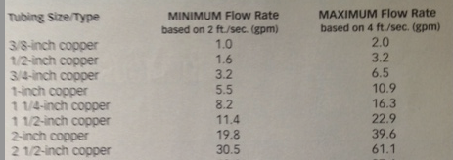

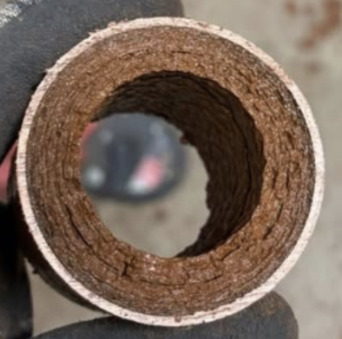

    There are a few reasons for maintaining a velocity however. One is to prevent lime scale build up in the piping.
    The second is legionella prevention. There is a movement starting to increase recirc velocity for a period of time every day to scour piping of the film where the bacteria lives and breeds. Taking flow velocity above 4 fps could accomplish that. In 2-1/2" copper you are looking at 60 gpm or more!

    Bottom liner. it sounds like the recirc line is grossly oversized for the job it needs to do. So you have a bit of a catch 22.
    You would like the minimum amount of flow to match the loop heat loss. But that large diameter piping could cause other problems.
