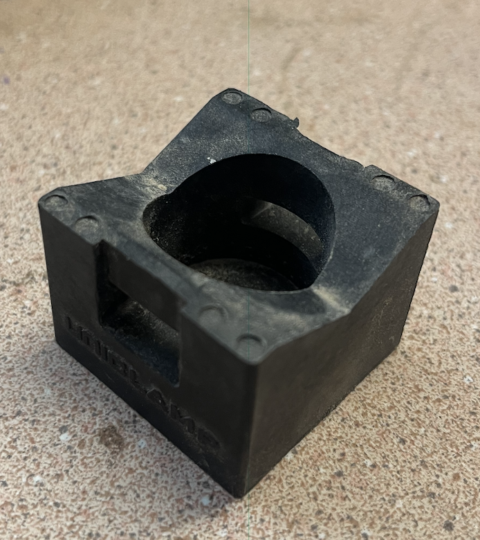

Composite clamps like this could Tapcon directly to the block, plenty of choices out there. If you insulate the pipe, get a clamp large enough to surround the insulation.
Uni brand with a wide base, uses a zip tie
